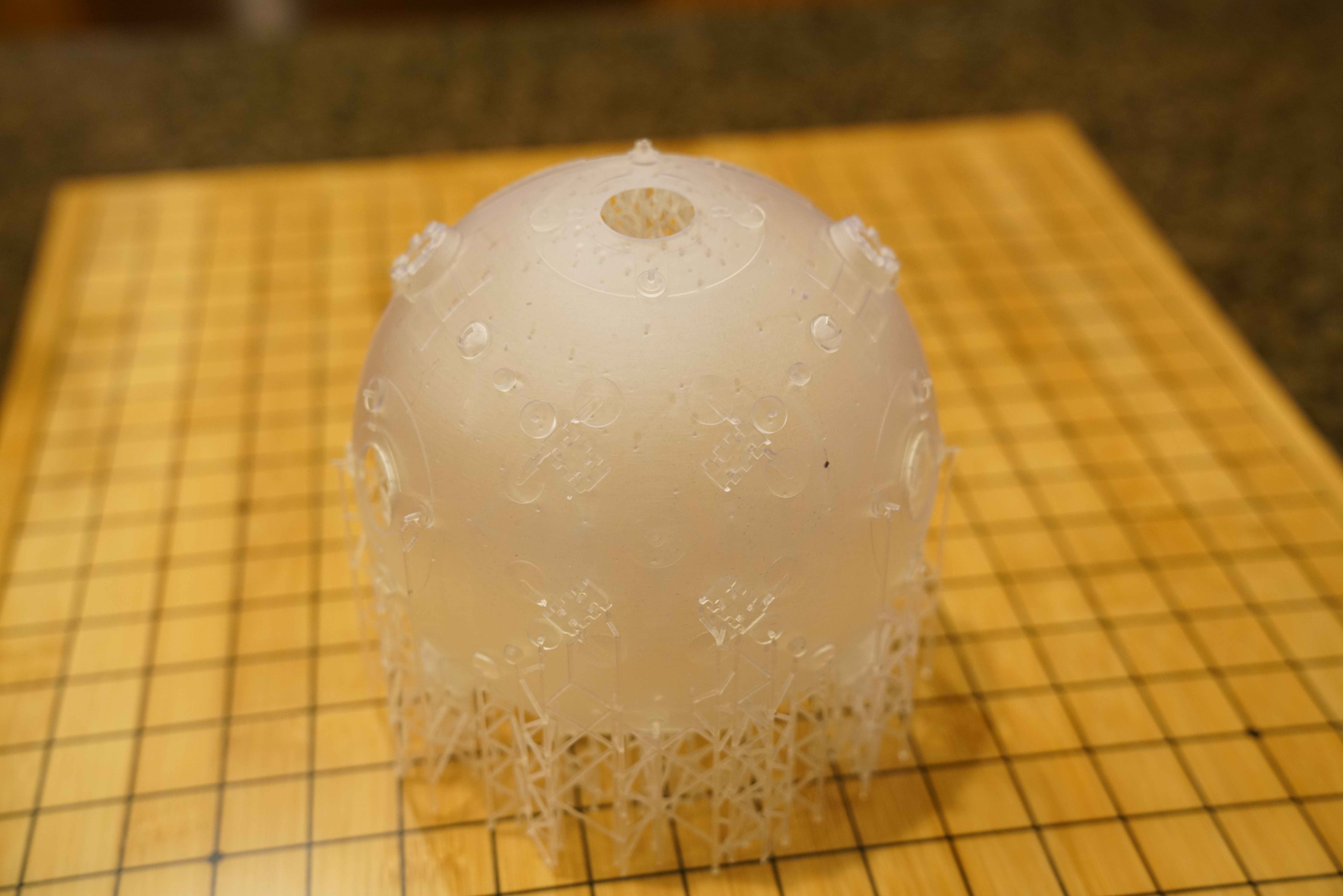

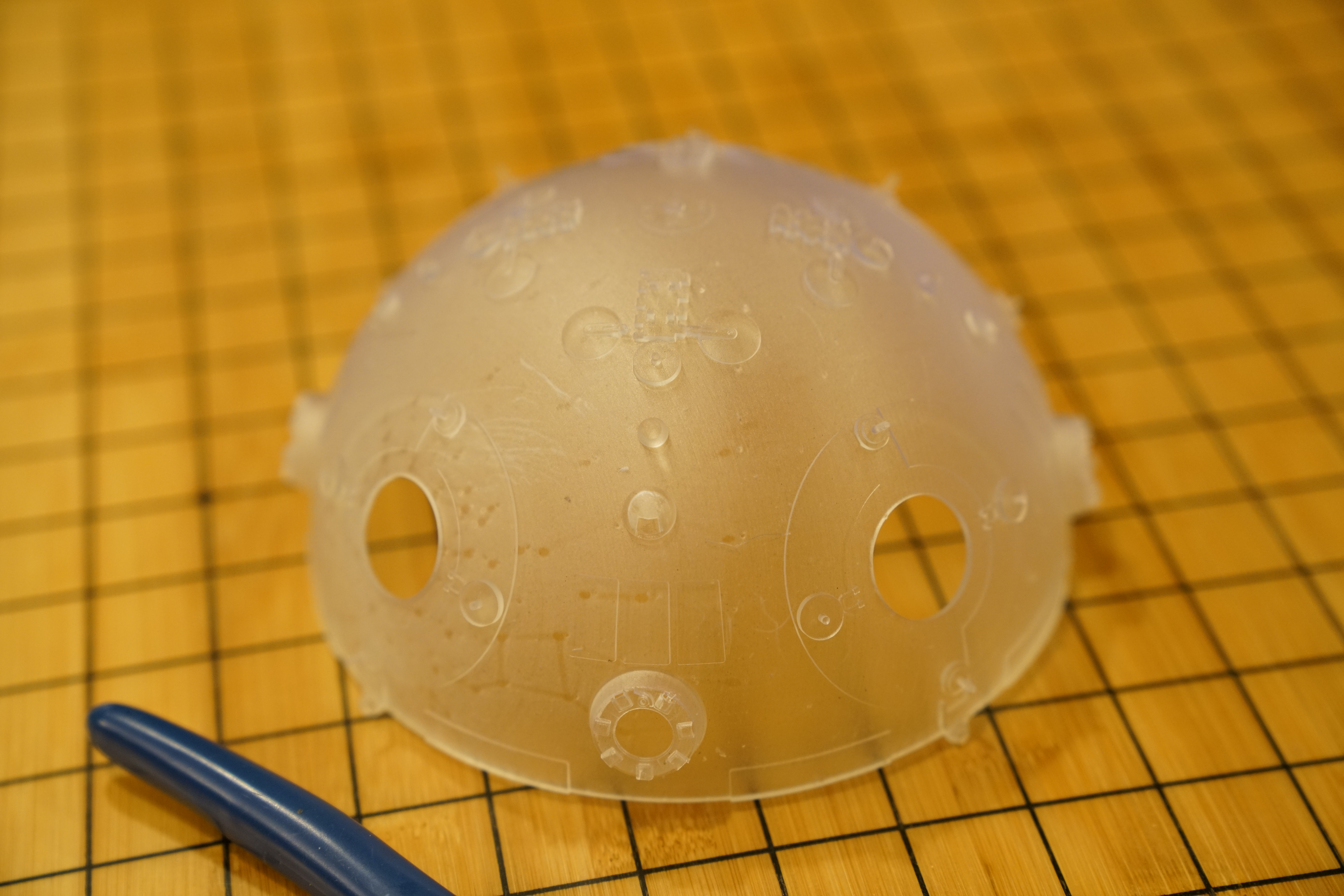

Got the second half printed:
thumbnail
If I was a Fraggle, I'd totally eat the support structures:
thumbnail
Hmm, it seems I have a problem. The glue I was intending to use (Testors Plastic Cement) just doesn't work on resin prints. :( Any recommendations? Ideally I'd want a space-filling, sandable glue that doesn't shrink or expand too much. I have a sneaky suspicion that the answer is epoxy, even if it's a pain to sand, but maybe someone else has a better idea?
