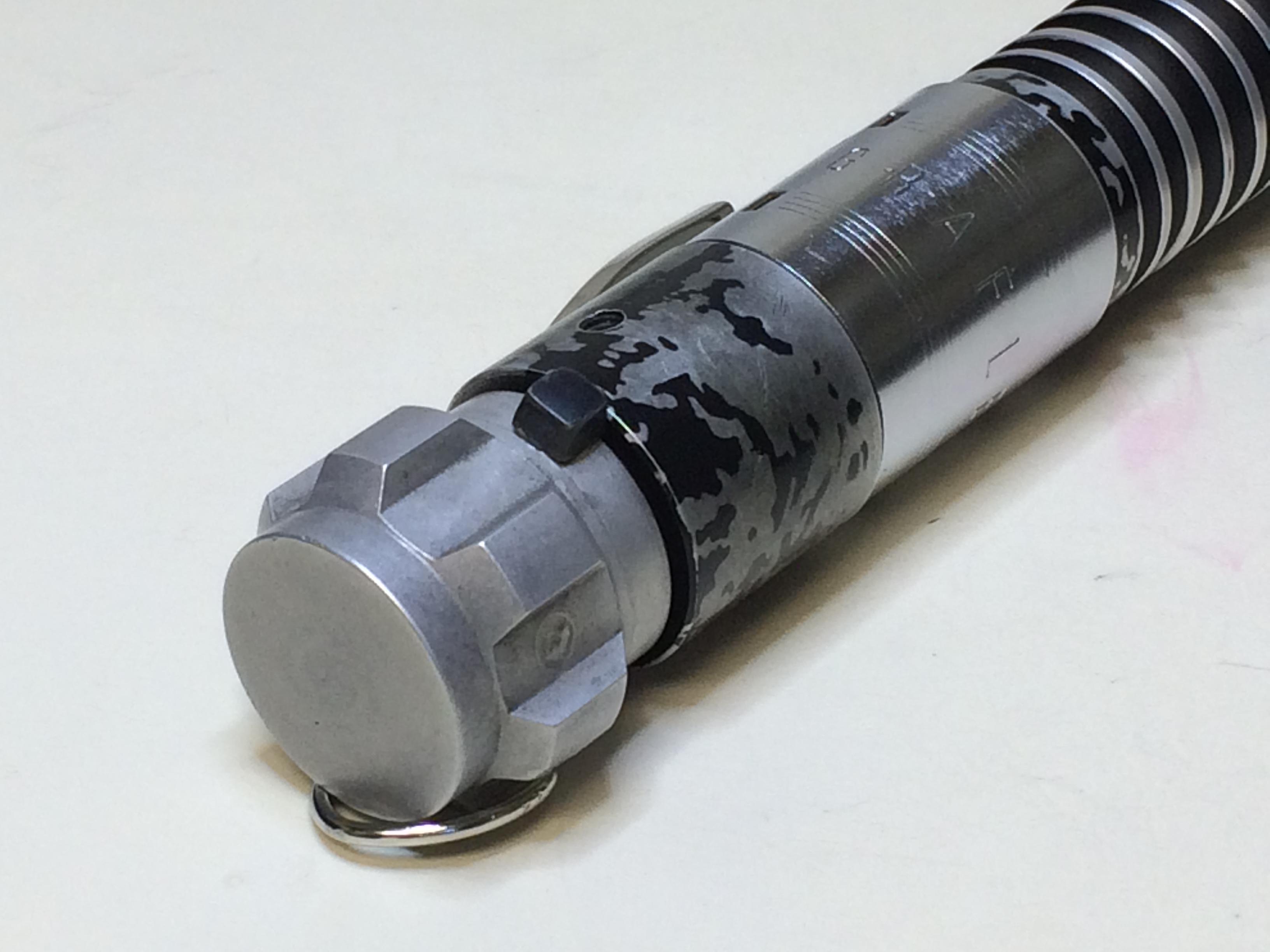

Posted this in another V2 thread, figured I'd copy it here as well....
What are the dimensions of the head of the square screw?
I took this from a barbell clamp. It's head is roughly .300" square.
The threading is definitely overkill for use on a V2. I can always chuck it up in the ol' lathe and trim it down/rethread with a die...
