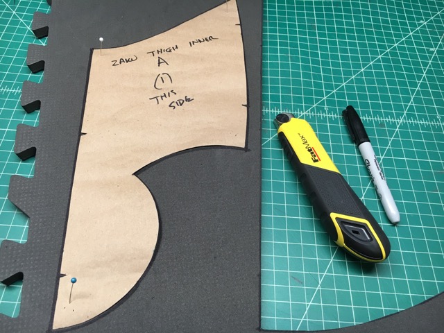

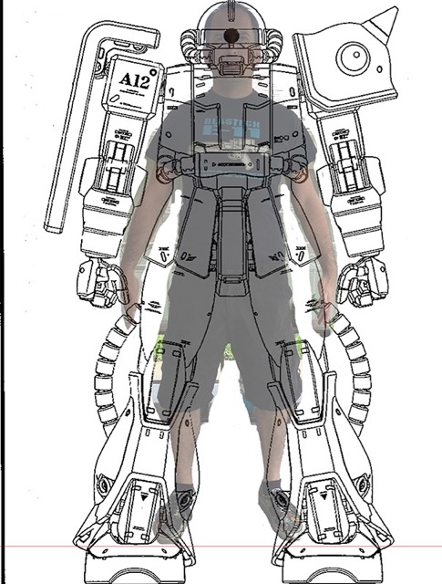

The other big advantage with these gundam models is that they have something similar to a blue print in the instruction manual... it's a line drawing of straight on front, one side, and back view. This IS perfect for developing your patterns. I taught myself sewing, so I work with patterns. I sometimes due stuff by eye, but normally I will develop a pattern first out of tin foil or paper and then convert it over to the foam. My thought is that maybe in the future I will possibly make these patterns available on this forum as wondersquid did for the cyberman (which I build and it's wonderful).
First thing I did was figure out how this thing was going to scale. With my model kit, I could measure it and then scale it up to the size I wanted. Basically, I decided I wanted it to be 7 ft tall from the floor to top of the helmet fin. The thing to understand about gundams is that they are not truly proportional. They have longer legs than humans and the shoulders are square to the body... etc etc. I'm 6ft tall, I'm going to add the extra height to the legs so that the rest of the body will scaled proportionally.
Next, I did a scan those B&W line drawings of the Zaku. Then I took a full body picture of me. Then I took those two pictures in photoshop. First we scale the picture of zaku to the height I want. To do this, I took them into photoshop and turned on my ruler function. Then we merge the two images together and I fit my zaku scan to be the size I want.
The red line is where the bottom of my foot will go... I know it looks a little weird... because it's impossible to get a perfectly head on picture. Anyway, this will start to give you a great idea of proportion. As you can see, all the additional height is going to come from some sort of lifts in the shoes...

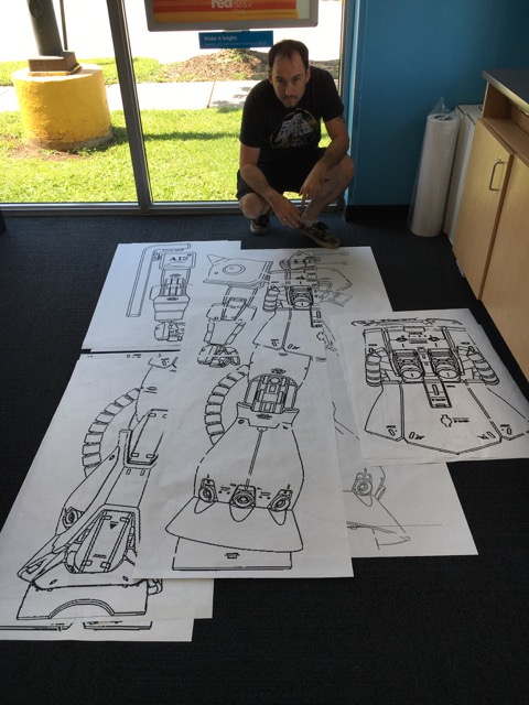

I took these properly scaled images in jpg format to Kinkos. They will print them out, life size, on there plotter. Ask for the cheapest paper they have... mine worked out be .80 or something a sq ft. So, printing full front, side and back view... then detail of each of the sections, arms, torso, and leg (front/side/back)... all in, it cost me about $70/$80. Quickly, we realized that this was a VERY worthwhile investment. Especially since I'm under a bit of a time crunch to get this turn around a 7ft full foam costume in less than two months!
We could take these print outs, but them against a wall and put me directly against it. With this we could fine tune the height.

I decided to start from the bottom up. Sorry, I didn't start taking pictures of my patterns until I got to the thighs.

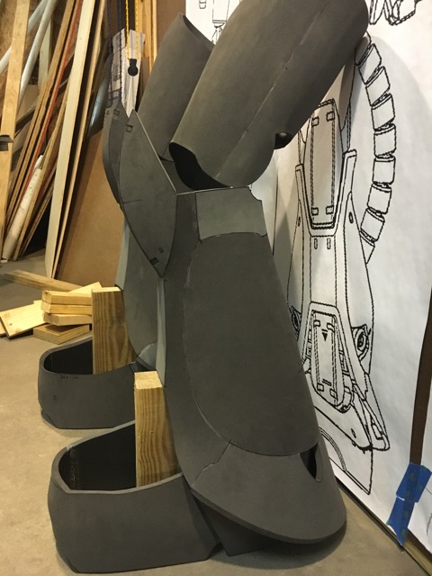

The legs mostly assembled, minus the top of the foot/ankle... the pattern pieces are done, but I just haven't had time to put them in yet because of my real job.
The other advantage of this resource is that you can place your finished products up against the line drawing to check scale (such an important factor to making the costume look right). It kind looks like it's loading the 3D costume from the bottom up. Heh.

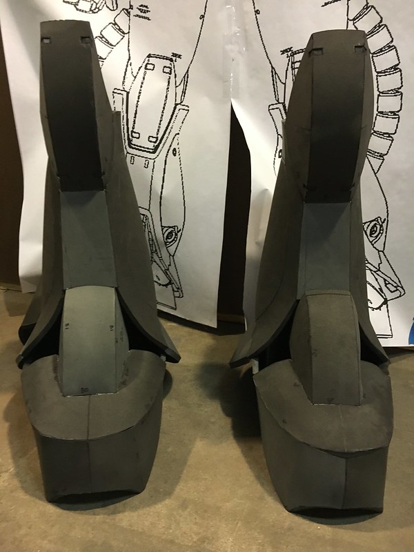

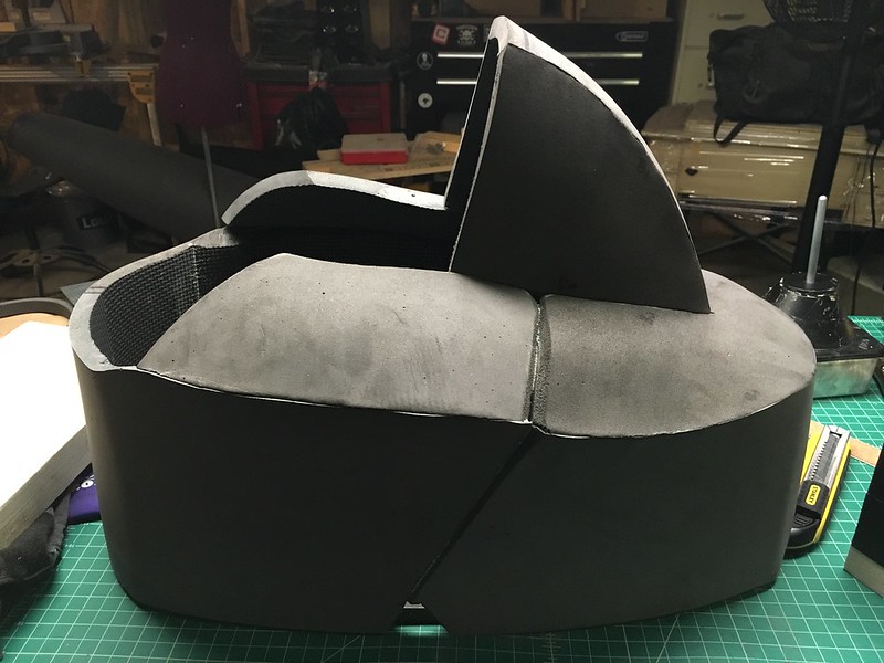

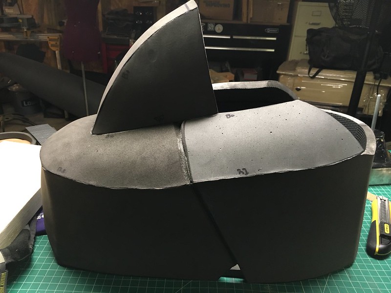

Today, after a long day at work, I was able to squeeze a couple of hours out to finish the feet.

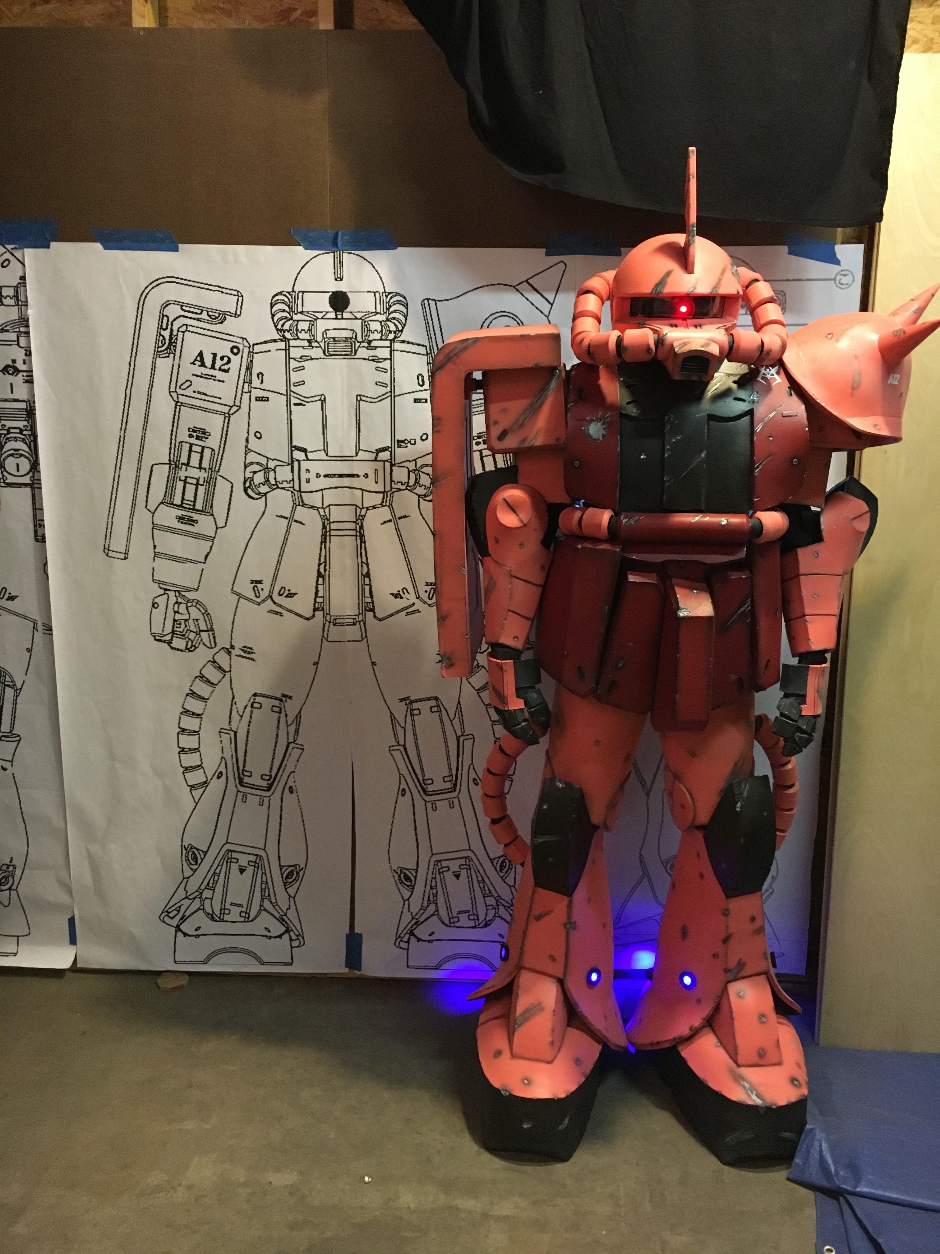

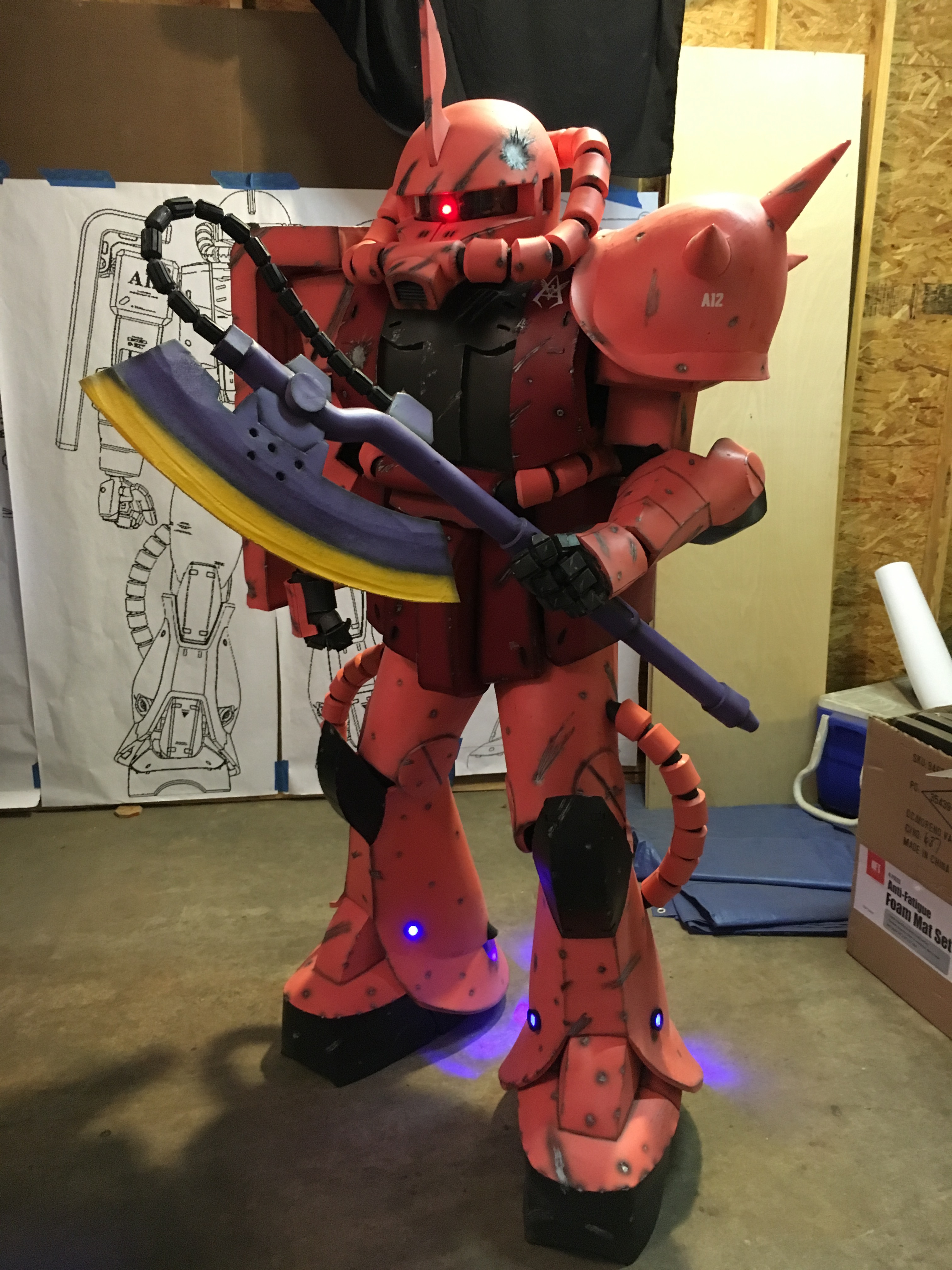

Sorry for the serious lack of updates but I've been slammed at work and then every free minute I have goes to trying to complete this costume in time.

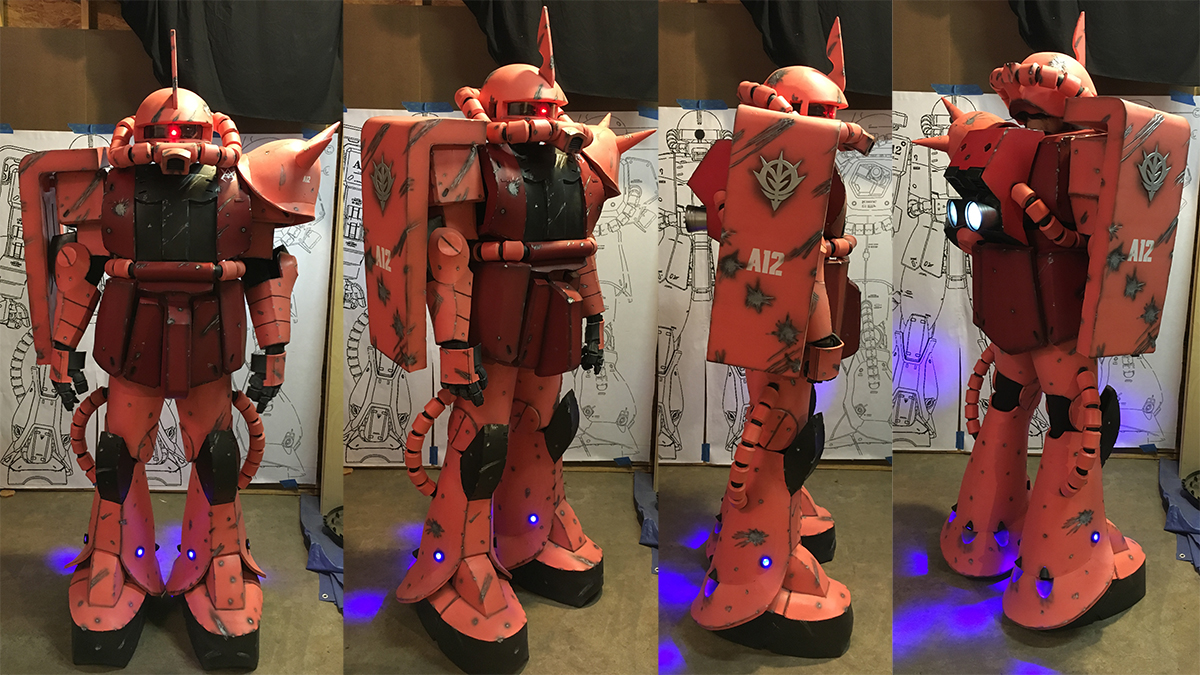

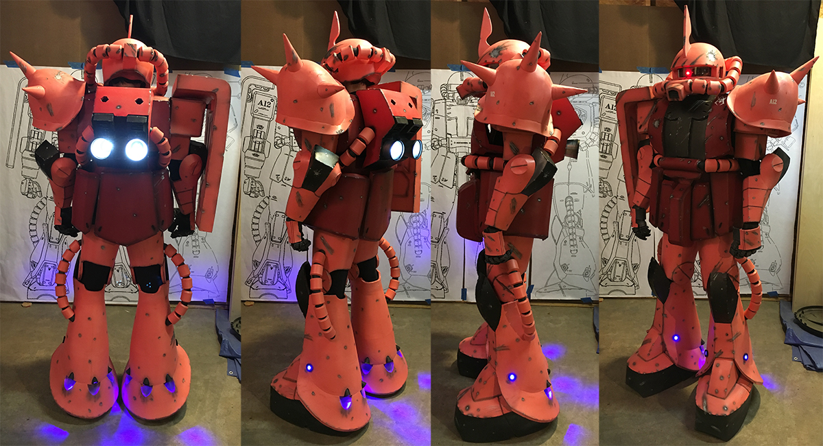

Most of the fabrication is done at this point and I'm on to battle damage/weather and painting. Some minor fabrication still needs to happen and I need to rig a system for the eye. Also strapping is still left... but anyway... I'll update way more with very detailed pictures after DragonCon.
Here are some pictures though:

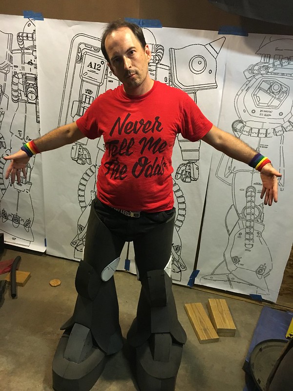

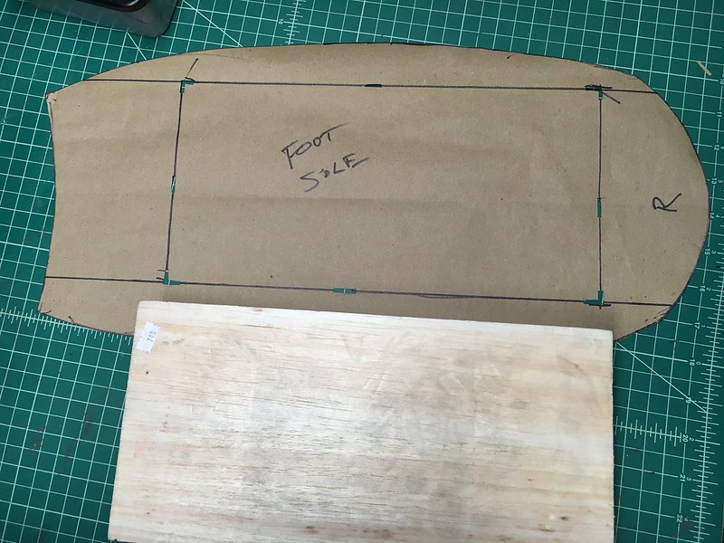

Let's talk about the feet for a second. This is the part I actually started with, so I figure it's a good place to start getting specific.
I calculated that I needed to be an additional 7 inches tall. Again, this is based on giant life size Zaku print scaled to my size. That puts my eyes in the correct place on the helmet.
I created the pattern for the shoes and extended them to allow for 7 extra inches of lift.
They kind of look like giant KISS boots to me, but hey, Zeon has good style. ;)
The really hard part here was figuring out I was going to platform myself and be stable enough to walk. There are MANY tutorials on this... I decided to ignore all of them bc I'm dumb. The solution my friend and I came up with was ::drumroll:: BALSA WOOD. So awesome... I ordered 8 2in x 12in pieces and 8 1.5in x 12in pieces... I didn't know the exact configuration I would need and it takes time to get them, so I didn't want to have to wait in case I miscalculated. You can get away with less if you just do the math.
Once I figured out how many I needed... with two sheets of foam underneath me and my shoes, I glued the balsa wood together with barge then reinforced the connection with gorilla tape. That stuff is crazy strong.
I then cut up another sole that fit the balsa wood perfectly. This will keep it from sliding and potentially killing me, if the barge that attaches to the sole comes loose.
I glue the shoes to the top of the balsa wood. Just a pair of old running shoes that I was going to throw out. I replaced the laces with quick laces so I would only have to mess with the exposed part of the laces. And done... these are solid and I can move amazing well in them. I can even sorta jog! I can also jump a few inches off the ground, even though I'm in these ridiculous things... but I tell you, I feel ROCK SOLID.
