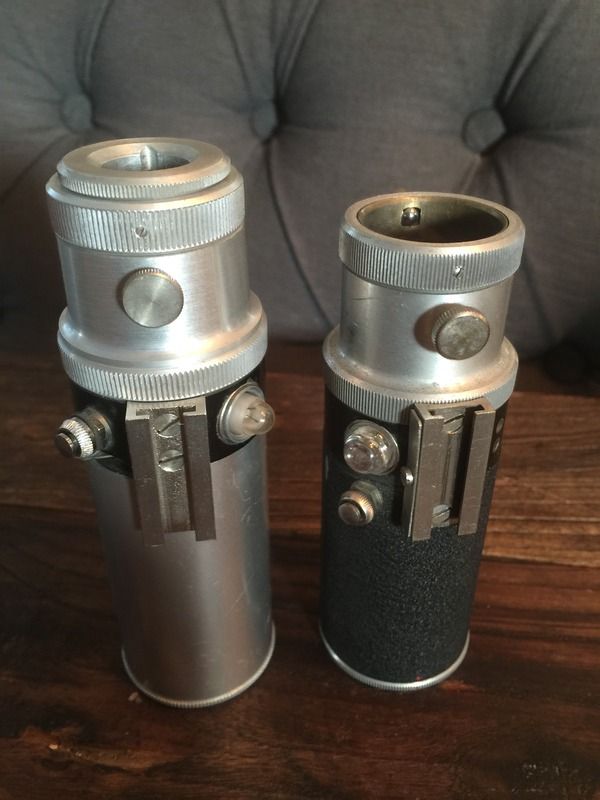

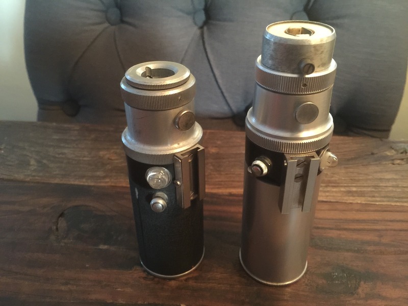

I managed to win a few eBay auctions for 2 Kobold flash units. They are quite different after receiving them. I'd like to use one for my Luke Skywalker costume and the other for my Jawa 1:1 prop. This is how I received them. Both tops are different, both flash hood tracks are different & mount different, buttons & bulbs are different & in different locations, neither have a knurled bottom cap, both have different top accessories, and only the silver one has the brass lever/switch? Any advise on the differences?
I'd like some help on the short Kobold - I know the Jawa DC used a top cap, which I have purchased from Cameron and I believe the D ring goes through the bulb. But I'm not sure this is even a correct Kobold because it's short, doesn't have the small lever/switch, and the bulb, button, & flash hood mount are different & in different locations.
The silver one I believe to be a correct Kobold for Luke or Han. For a Luke DC - Does it use the knurled cap on the bottom? What's on the top? How does it hand on his belt clip & does it have a D ring & where does the D ring mount? I'd love some help on these, thanks!

The smaller black Kobold seems to be a slave unit and is not STAR WARS related also wrong clamp for Luke's ESB D-ring ... still it could be used for a Jawa prop though :) The silver Kobold is more accurate for an ESB unit with some black paint added ... great score :)

The small one is nothing really accurate, but i wouldn´t be worried to use it for a Jawa. The silver is better.
For a accurate Han ANH you would need the black textured version, with a stepped top, and a knurled edge on the bottom plate.
For a accurate Luke ANH you would need the silver version, but with a stepped top, and a smooth edge on the bottom plate. Bulb cover used for hanging.
For a accurate Han ESB you would need the silver version, but with a stepped top, and the knurled edge on the bottom plate. No bulb or cover, but with reflector brachet
For a accurate Han ROTJ you would need the silver version, but with a stepped top, and a smooth edge on the bottom plate. With bulb cover, but no reflector bracket.

Thanks for the info Michael. So ANH Luke, the silver one is good with the stepped top like how I have it in the bottom pics? And no knurlings on the bottom "cap" that threads into the bottom of the Kobold?
It´s probably best for Han ESB, just need the black painted body, but doable for Luke, too (if it doesn´t need being TOO accurate).
For Luke the bottom should be smooth edged (hardest to find version), and another bulb/cover. Just made a pic, sorry for the bad quality, not the best lighting atm.
Lukes is the one on the lower tier in the middle, D-ring would be drilled through the plastic bulb cover - your´s looks glass, so better mount it to the bracket (or keep that original and replace it with one of Roys replicas for the D-ring).

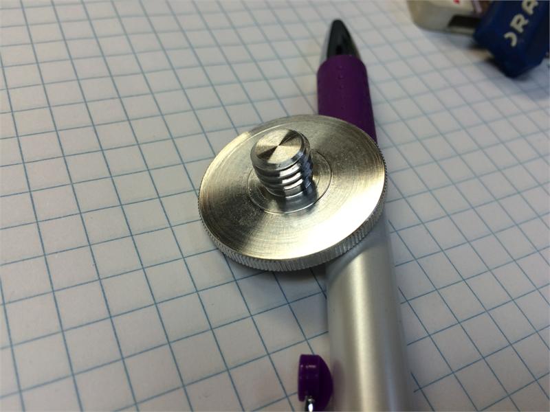

Michael, I didn't even know the unknurled ones existed! Also, I found a diamond knurled large flat/ thin mount screw for the silver, smaller mount holes. I hope this makes sense, if I was home I would take a pic. I picked up my large straight knurled flat mount screw from DEC, sometimes he lists a couple of them.
Here's a pic of what Im talking about:
Bad link Tom, can you post the actual pic? Thanks
