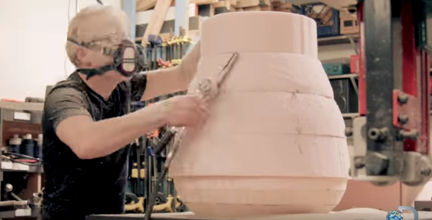

So on the Simpson's episode of Mythbusters they built a Homer dummy out of upholstery foam. I've done a fair bit of upholstery foam carving with an electric turkey carving knife and a bandsaw, and a bit of shaping with a die grinder but asavage had some kind of really cool wand tool to do some shaping. Looks like it might have been air powered. Any idea what it is?

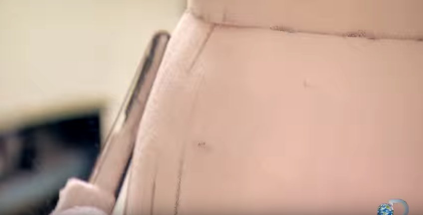

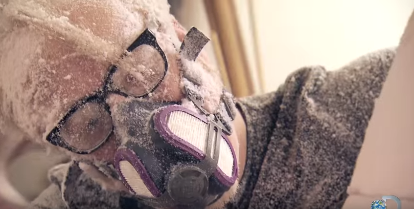

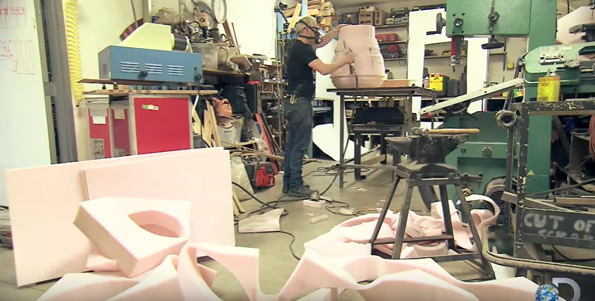

Here is a pic of the tool in question.
Screenshot 2016-06-23 20.52.45.pngScreenshot 2016-06-23 20.52.52.pngScreenshot 2016-06-23 20.52.57.pngScreenshot 2016-06-23 20.53.00.png

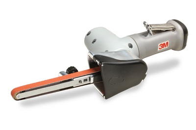

I used two tools primarily. The fingersander above. Which btw is a GREAT tool to have in your arsenal. Many versions. Inexpensive is pretty fine for light work. I also used an upholsterer's foam cutter:

I never knew you could use a sander on seating foam. I'm going into work shortly so I'll give it a go.
