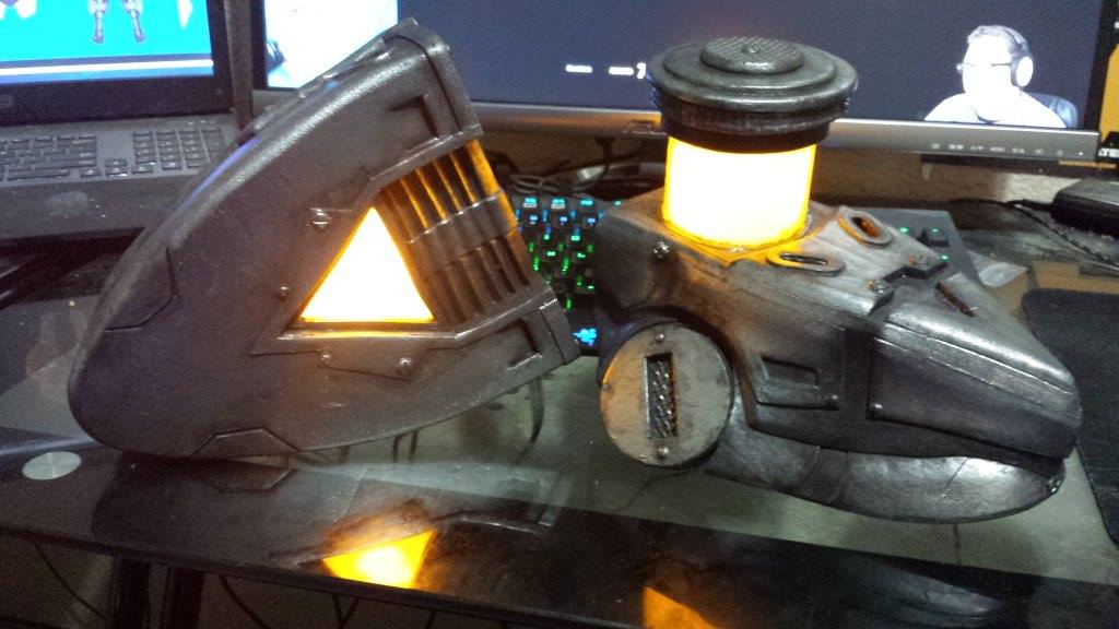

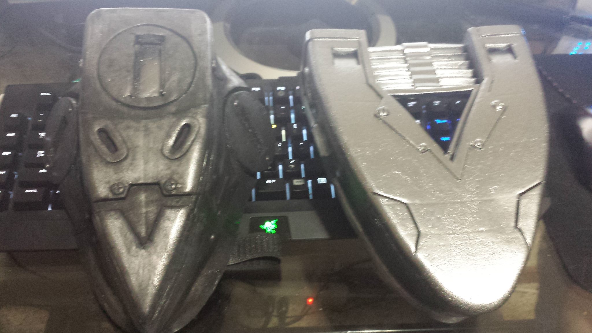

SHOULDERS
Although different in appearance, they were built roughly the same way. I measured out my shoulder/arm width and guesstimated with EVA shoulder bases until I made something that worked. After that, I built up the shoulders with thick/thin foam and detailed with craft foam and brads. For the light-up parts, the left shoulder used Transpa, the right used acrylic, and both were covered with yellow vinyl on the outside and toilet paper on the inside (Transpa's much easier to make curves with than acrylic). The lights themselves were mini-LEDs either wrapped around the battery pack (left) or glued together to simulate one big LED (right). For the left shoulder, the battery and LEDs fit snugly between the slot on the shoulder itself and the cylinder cap made of various kinds of foam. For the right shoulder, the battery pack is strapped onto the underside of the piece (it's almost entirely hollow on the inside).
I should also note that the ridged design on the right shoulder (above the light) was an early concept on the P:L splash art that was eventually changed. Personally, I liked the ridges a lot better, so I went with that version.

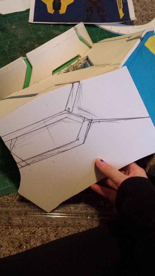

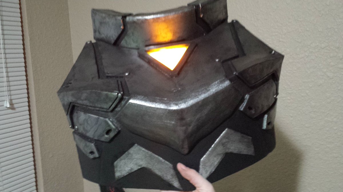

CHEST
After making the template using myself, duct tape, and marker, I put the pieces together with contact cement. Raised details were made with 5mm craft foam and scrapbooking brads. The chest light is mini-LEDs diffused with two sheets of single-ply toilet paper (yes, toilet paper makes a great inexpensive LED diffuser). The LEDs are housed behind clear acrylic covered in yellow vinyl, and the battery pack is (quite literally) strapped on the inside, right above my cleavage. To attach the chest piece, I used an elastic strap that connects the bottom corners of the piece, as well as magnets to connect the back half of the neck collar and back shoulder blade piece.

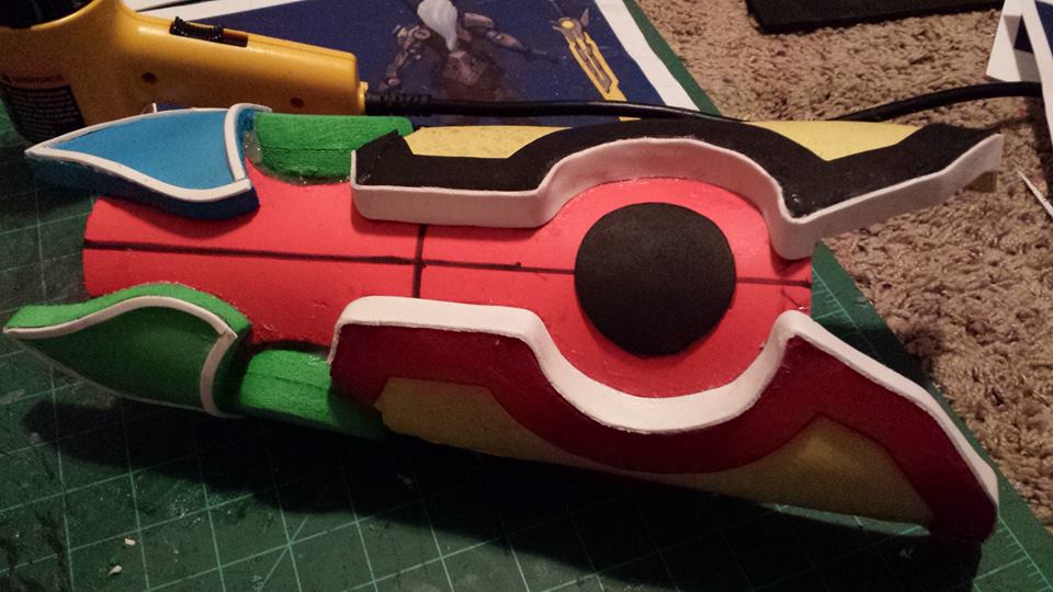

FOREARMS
Again, different in appearance with similar construction. The templates were made by wrapping cling wrap and painter's tape around my forearm and drawing the rough pattern. The base of the pieces is EVA foam mat, with details using craft foam and brads. While the right forearm is one piece, the left forearm has a built-in zipper covered by craft foam to help getting it on-off.
