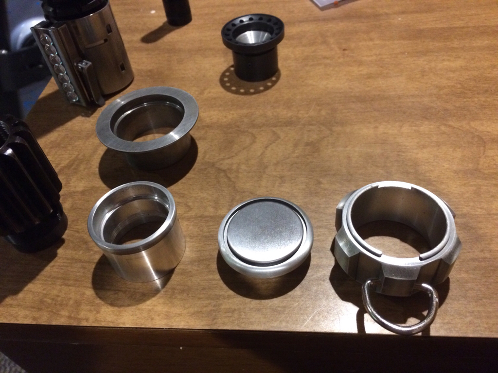

6 and 5 are just pressure fit, you could put a VERY tiny dabs of super glue on the inside lip of 6 but i would not.

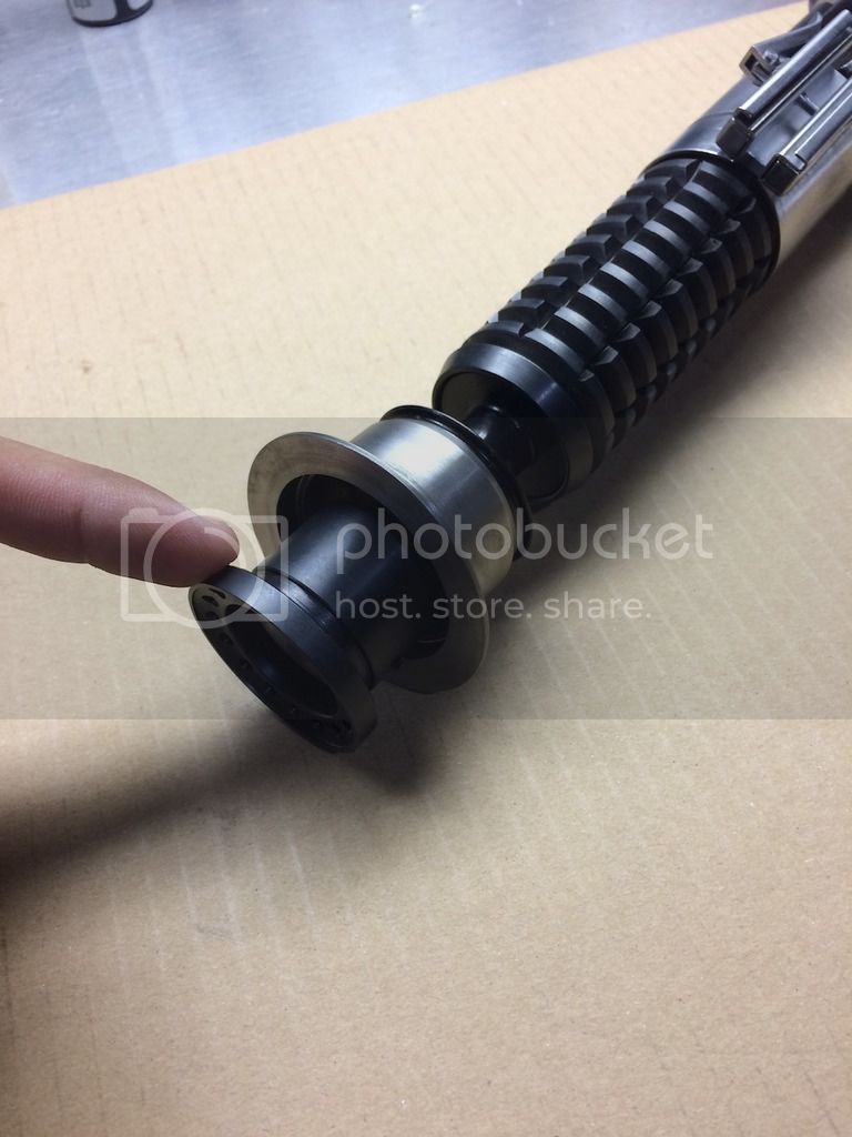

i have a quick question. i just received my romans static saber. my balance pipe isn't tight enough to fit correctly, if i stand the saber up, the balance pipe falls down. i see you said you dont like super glue to keep it together.
http://i1026.photobucket.com/albums/y323/lightningdan/Romans Empire OBIWAN/roman7.jpg
i was wondering if mine is too loose or if everyones is like this, and if so what everyone is using to keep the balance pipe together. i was wondering if e6000 do be ok? i know a lot of the r2 builders use it on all their aluminum parts, it also dries clear

Hey @halliwax ! There's a wee-little allen head screw on the outside of the balance pipe. Just tighten it in and you should be good-to-go!

Once the screw to hold the cone in place is to your liking, then a drop of superglue or e6000 will hold the outer part onto the inner part. You don't need much.

My Roman's weathered static was the same. Without careful handling the outer-emitter would constantly fall back onto the grenade neck.
I eventually used a thin 'smear' of 5-minute epoxy on the inner surface recess when the weathering was complete, since I don't envisage ever needing to separate the two parts again.
