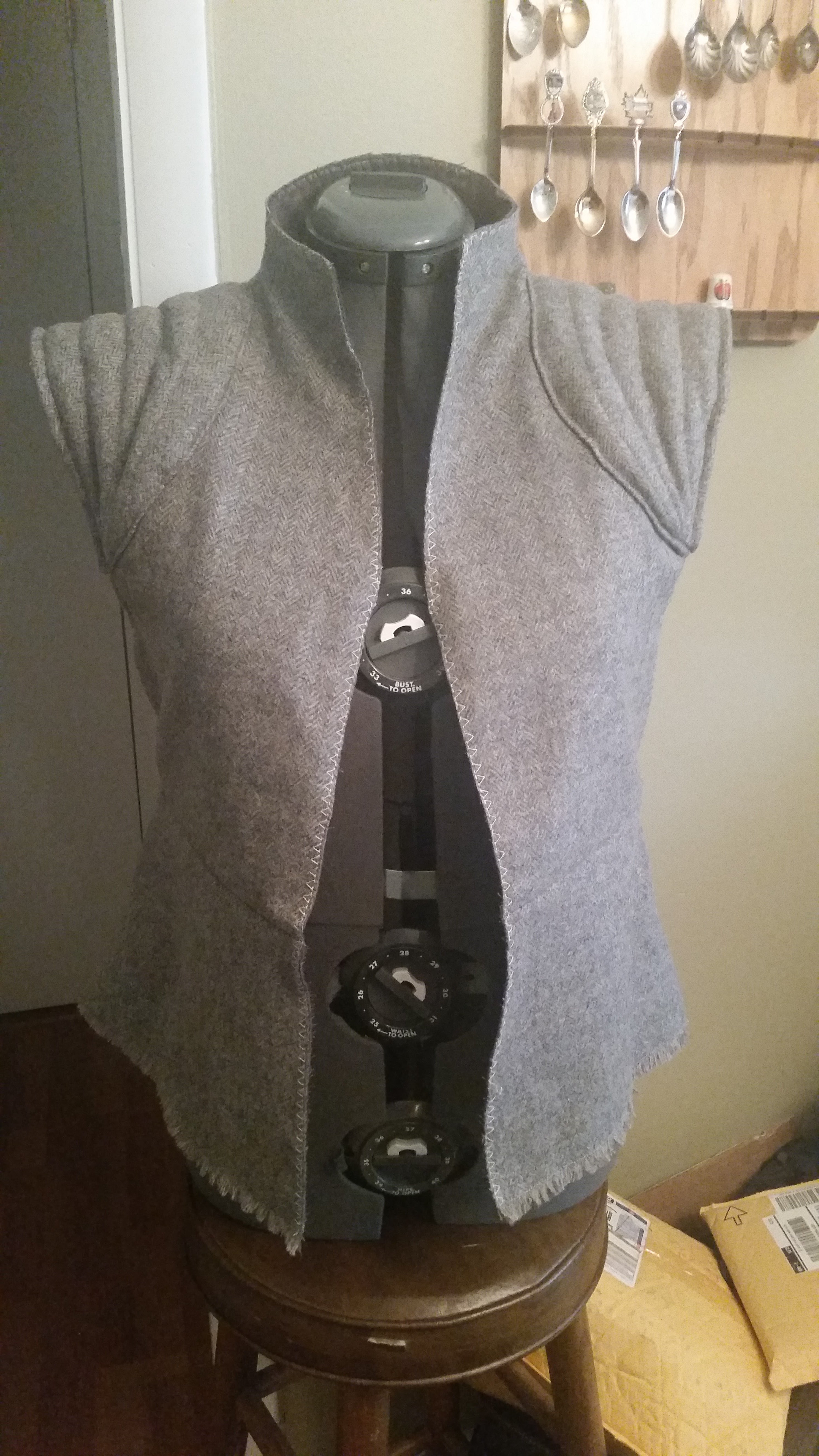

I cannot stress how much I LOVE Dorr Mill Store's wool!!! I didn't even need to felt it!!! Guys this is the closest you are going to get to screen accurate as you are gonna fine. AHHH!!! LOVE!!!
That's your best one yet, looks great!
Thank you!!! Yes, I think I'm finally happy with the result. Now on to the bag. Your write up was great and I'm using it as a guide. Already picked up and ordered my supplies for it. I opted to buy fabric and go without the Enfield sling, and just buy webbing.

Oh, it dyes and felts beautifully, but I recommend felting, making the whole vest, THEN dying it, so that it dyes evenly. If you are self lining it, dye the outside first, then the lining. I started lining mine in this super soft grey flannel and it looks and feels wonderful!

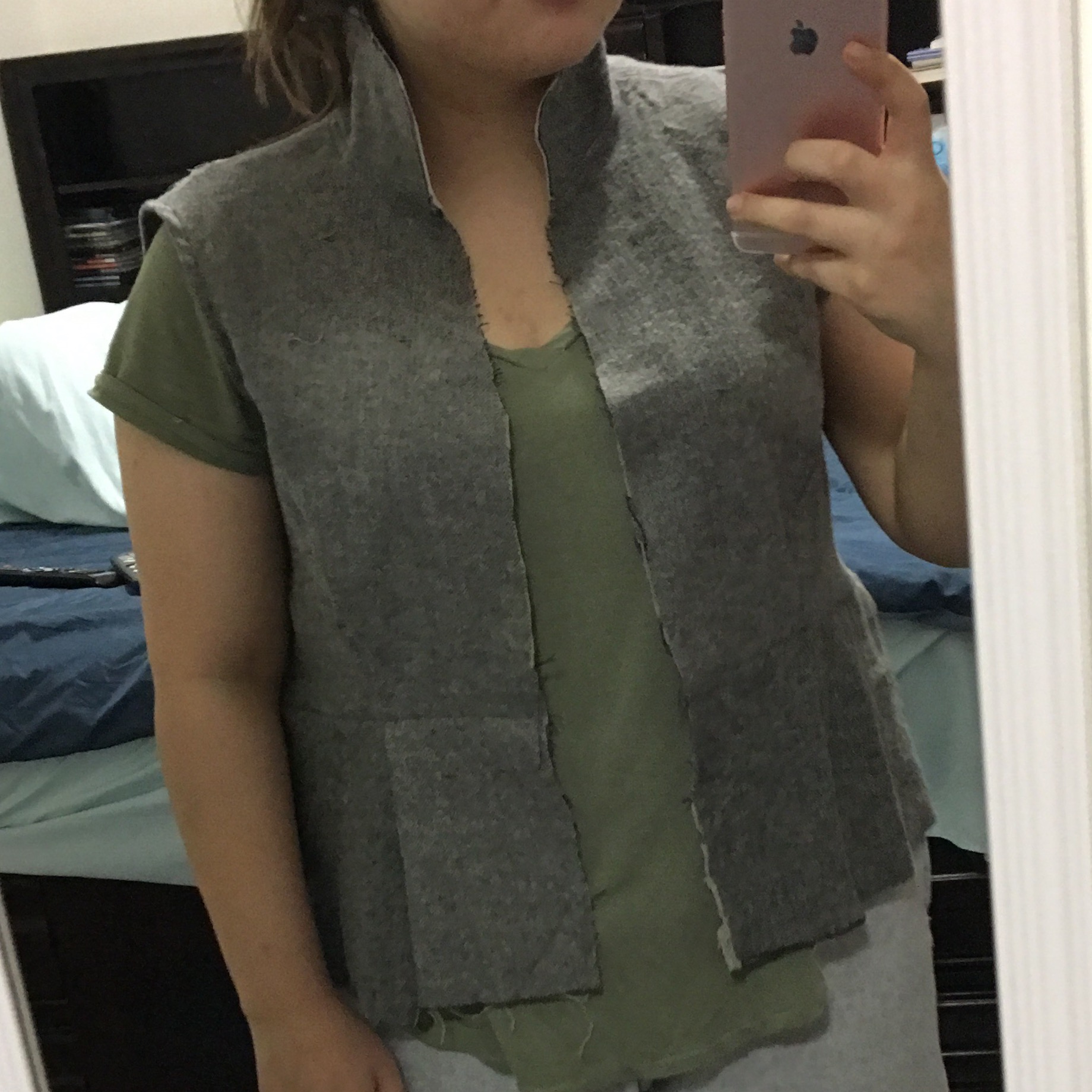

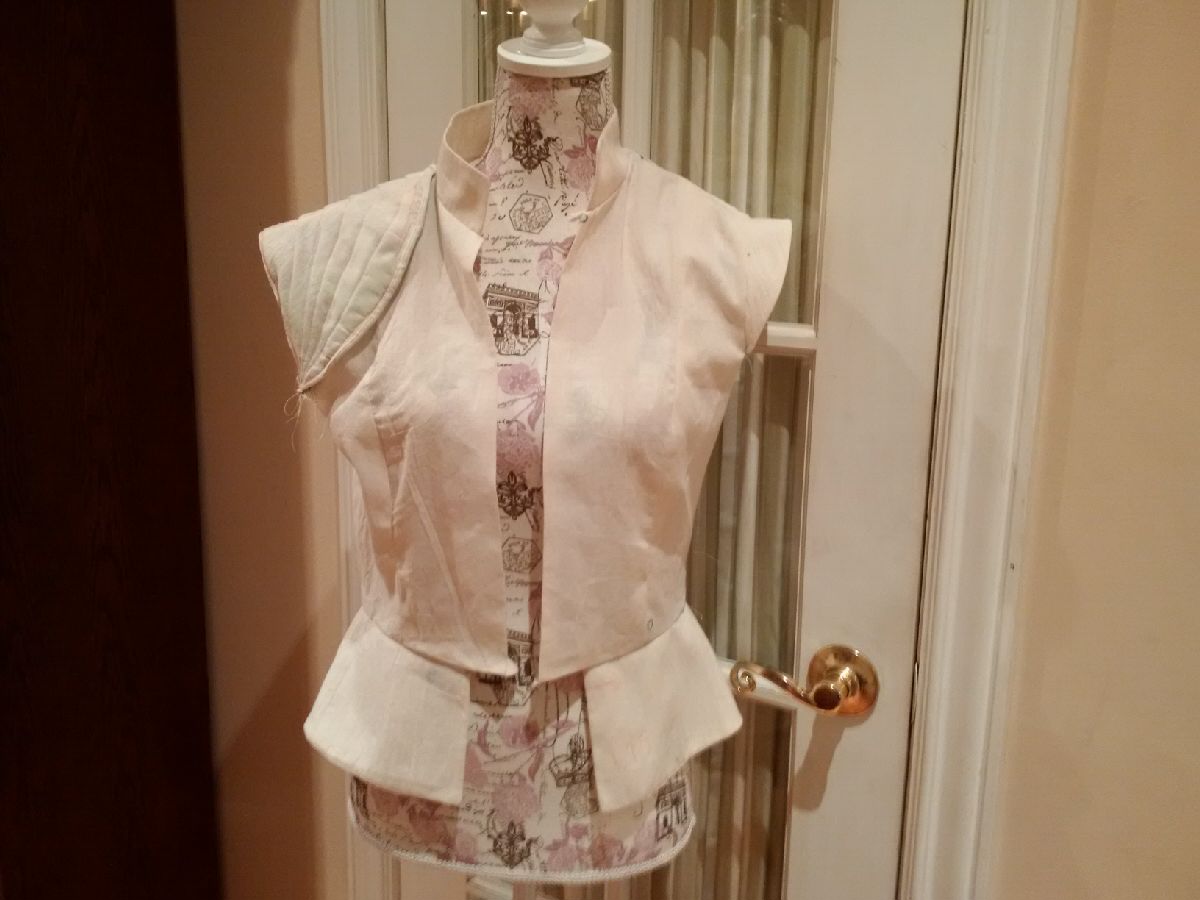

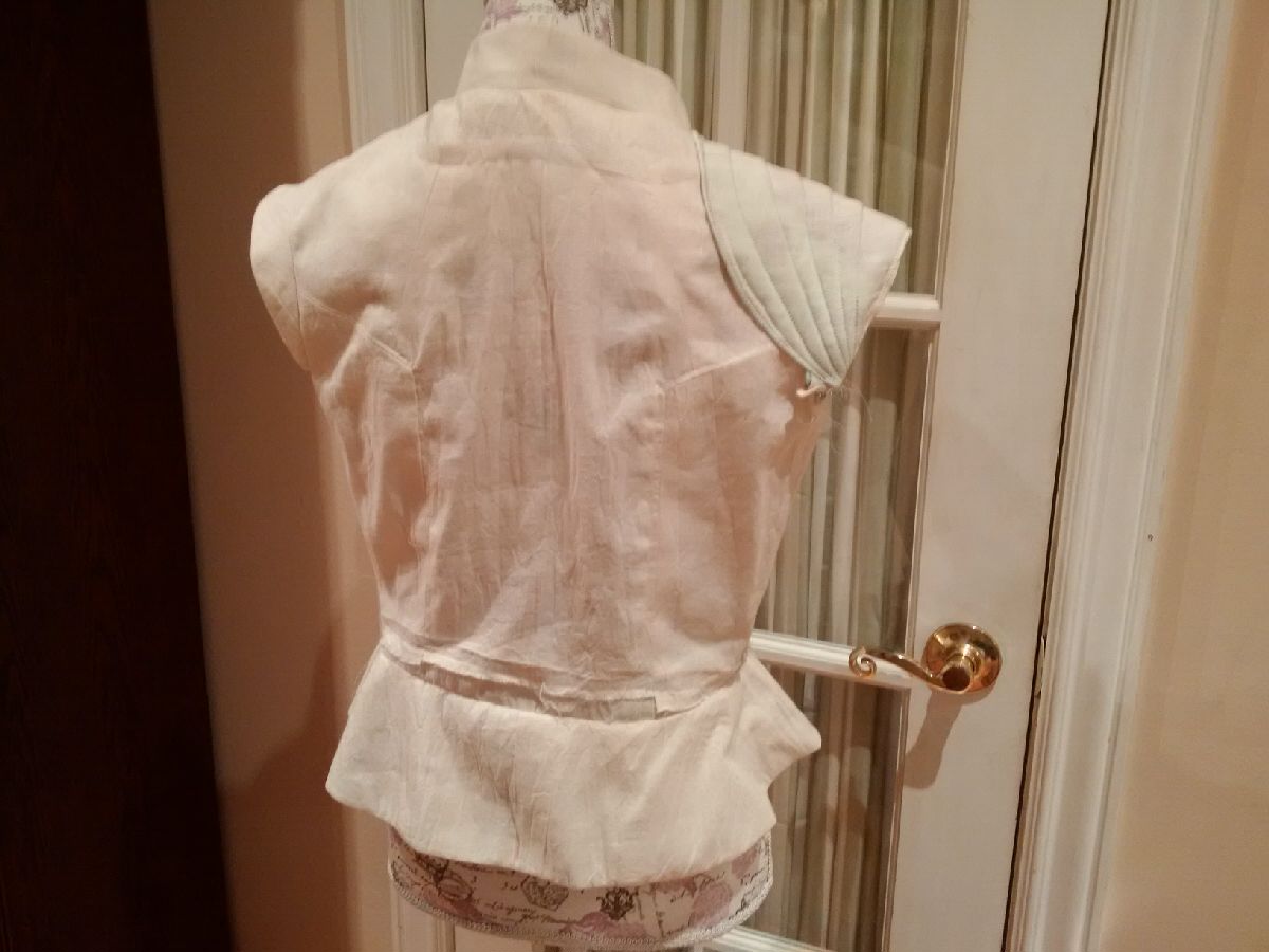

Well I wouldn't call my first franken-pattern attempt my worst work ever, but ... it definitely has a long ways to go. I guess for my personal process though, I need this step so I can see the shape coming together first, and then I can visualize it in three dimensions and alter and re-do from there. So yes it's a mess, but now I feel like I have a rough basis to create my own pattern. The peplum is about 2 inches too short, slightly too circular in the front, and I forgot to extend it in the front to match the bodice front opening, I made six shoulder ridges instead of five, the shoulder pads don't have the right curve shape, (it was so wrong I didn't even bother attaching the left one) my back seams are too angular --- I need to soften them up, I need to cut the bodice so the collar is attached and break up the collar at the side seams.
I don't know ... even in the example showing there's no princess seam, am I crazy that I still see it? Is it an optical illusion that I see it plainer than ever, a line going from the waistline into the shoulder? I have no doubt the very experienced experts here are correct, it's just that I'm just a bit stumped on the whole physics of it. How are the ladies here getting this to lay properly on their chests and still have the front opening line up without any kind of seam or dart? So curious how others solved this!
Still plugging away,... question for everyone who has made this: How long was your peplum? I cut a new one at 7" but that still seems off?

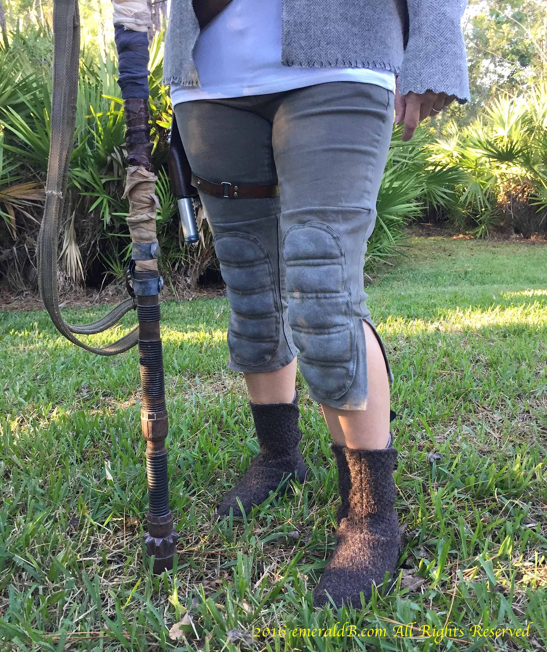

Redwillow, your pants kneepad pattern is fantastic! Thank you so much!

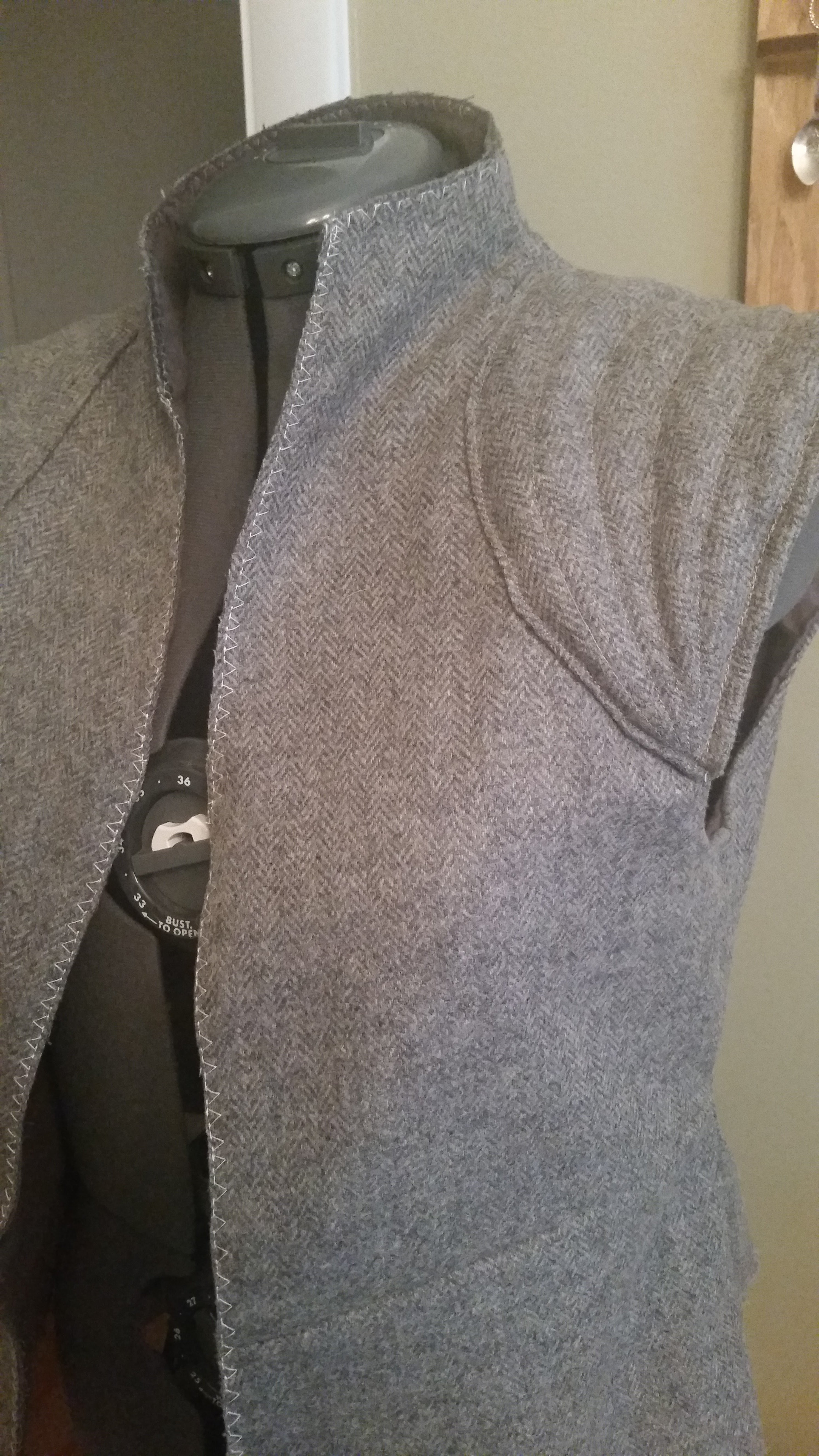

I finally got my shoulder pad shape and ridges looking right, before they were too rounded. I'm no drafter/graphic designer/drawer but the way I got the shape right was to think more of the old United Airlines "tulip" logo, rather than try to use a french curve. More straight, then swooped, I guess?

i used butterick 6104 as the base for my pattern. just cut the front opening at center front, bring up the waist line (i'm short lol), and maybe shorten the peplum (can't remember if i did). i still have to get muslin to figure out how i'm going to do the front peice without the princess seam but still have it lay the way it does now. other than that i can easily pattern out the seams in places there shouldn't be, fix the princess seam in the back, and add the collar seam. peplum came out to be 7 inches.
