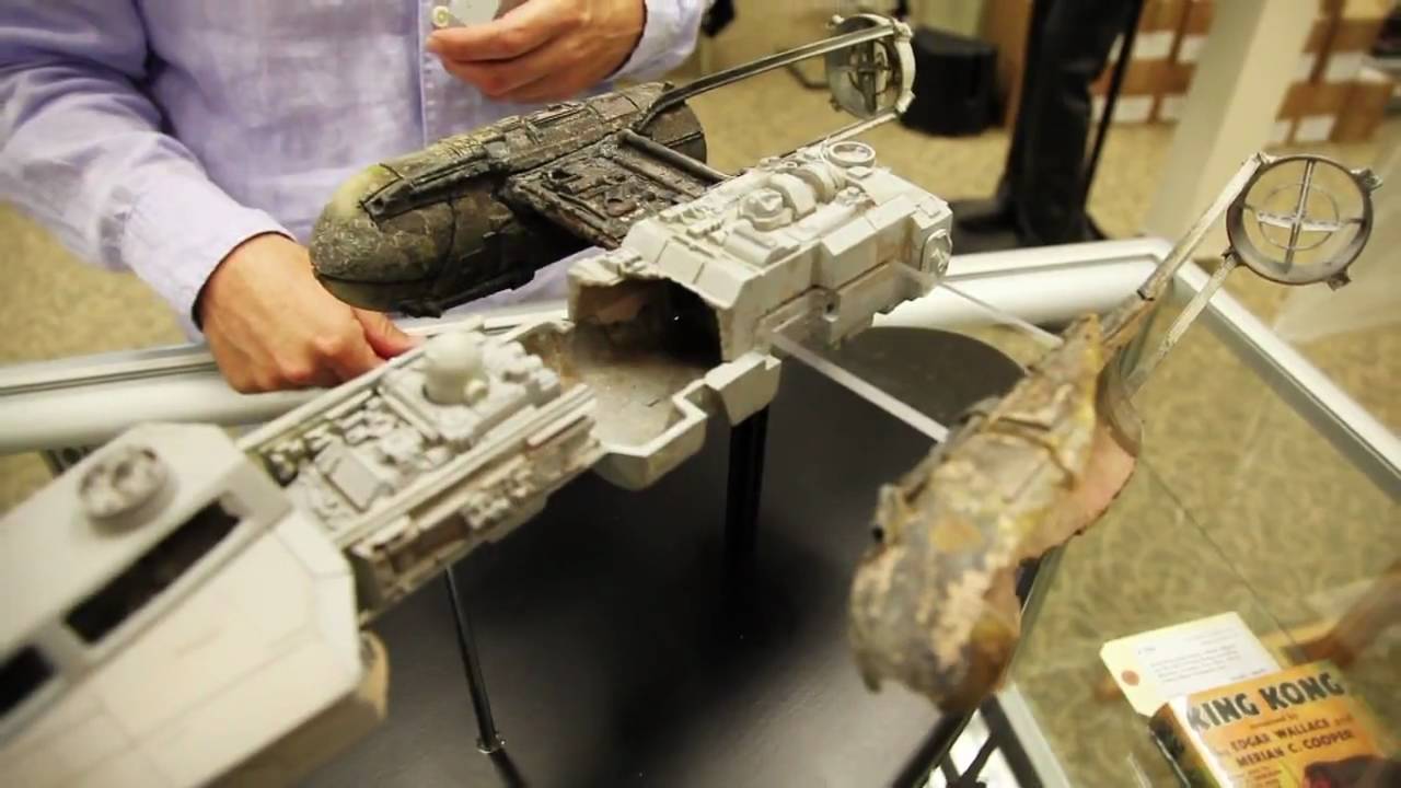

I've also noticed the yoke piece that fits on the bottom might be a little narrow to fit the 25 pounder piece that goes there. And on the original, it has a notch in it as shown in this pic:
Yeah the notch is to make room for the Hurricane assembly !
