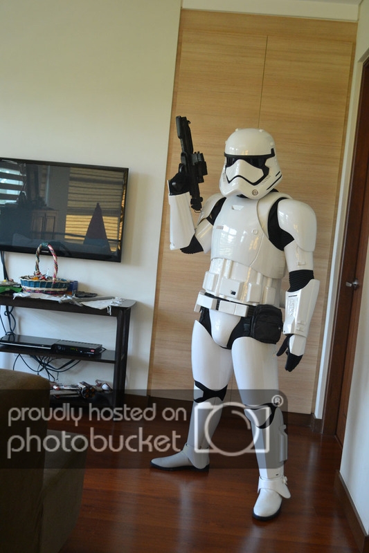

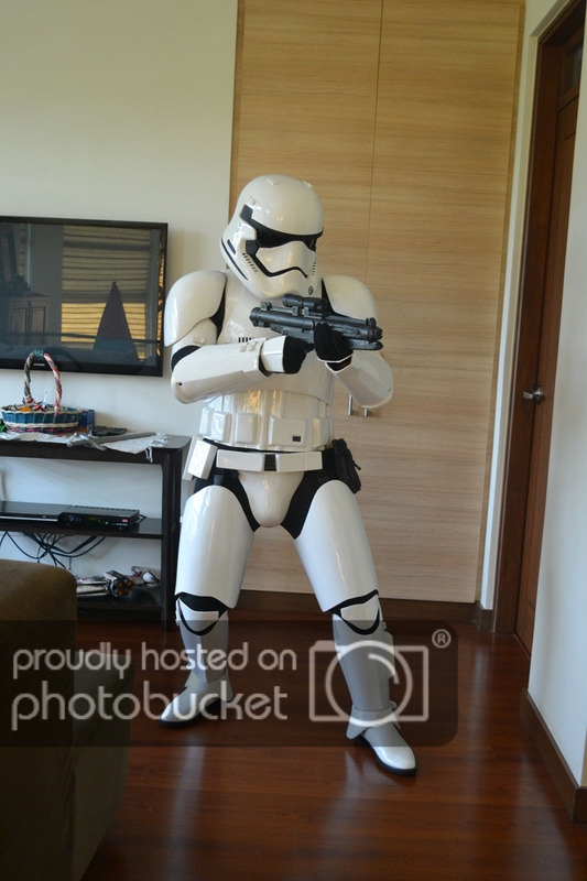

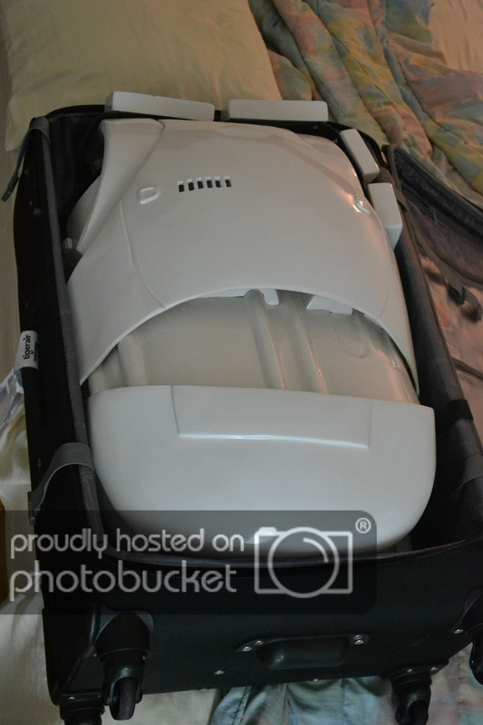

One more test run before packing it in for Force Friday. Movement is just excellent. If i trimmed the top of the abs a bit more as well as the back of the thighs and calves i could probably sit down in this armor no problem. I think i can probably bend down to pick something off the floor but my strapping might give way. This flexible stuff is just too awesome and seems very durable. I don't foresee any cracking issues during movement or storage. :) It may even survive airline travel in a softshell luggage. But i'd rather not take any chances. :)

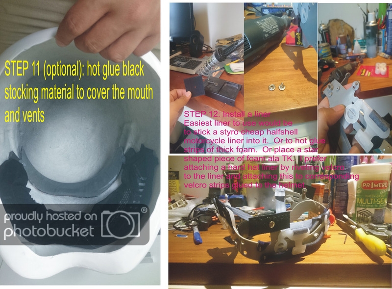

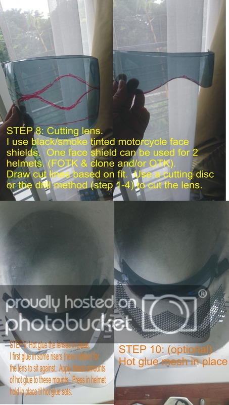

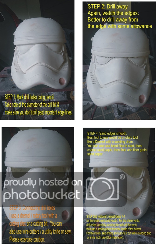

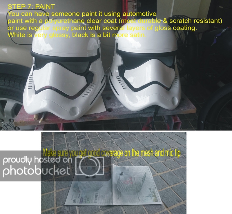

I thought i'd share how i assembled my helmet...
Re: TFA Stormtrooper Bucket & Armor...Old School Sculpting: FINISHED P.3
That looks absolutely amazing. Just stunning. Great tips on the final touches; I'd been looking into lenses and these look like they worked our perfect. Might use the exact same trick on my own helmet!

NachyoChez - Thanks! :) You can also try trimming a bit more from the inside of the brow. That way, when you attach the motorcycle visor, it will slant inwards / downwards and will simulate bubble lenses in some angles. Yeah, the standees do seem flipped.

What did you use for the hexagon mesh? I'm modding a helmet soon and it looks like a perfect solution!
Thanks! I used hexagonal green plastic gardening mesh. I just found it by chance at the local big chain hardware.

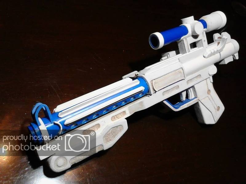

In the meantime, had a friend of mine commission a blaster build for me. All completely scratchbuilt in PVC and sintra by hand.

Do you have a source for the tinted visors?Are they flexible?
:):thumbsup Wow...great work.
Thanks! I just buy them (replacement face shields) from motorcycle accessory shops. They're go for very cheap over here.

Please pass my compliments on to your blaster-building friend.
That looks AMAZING!
