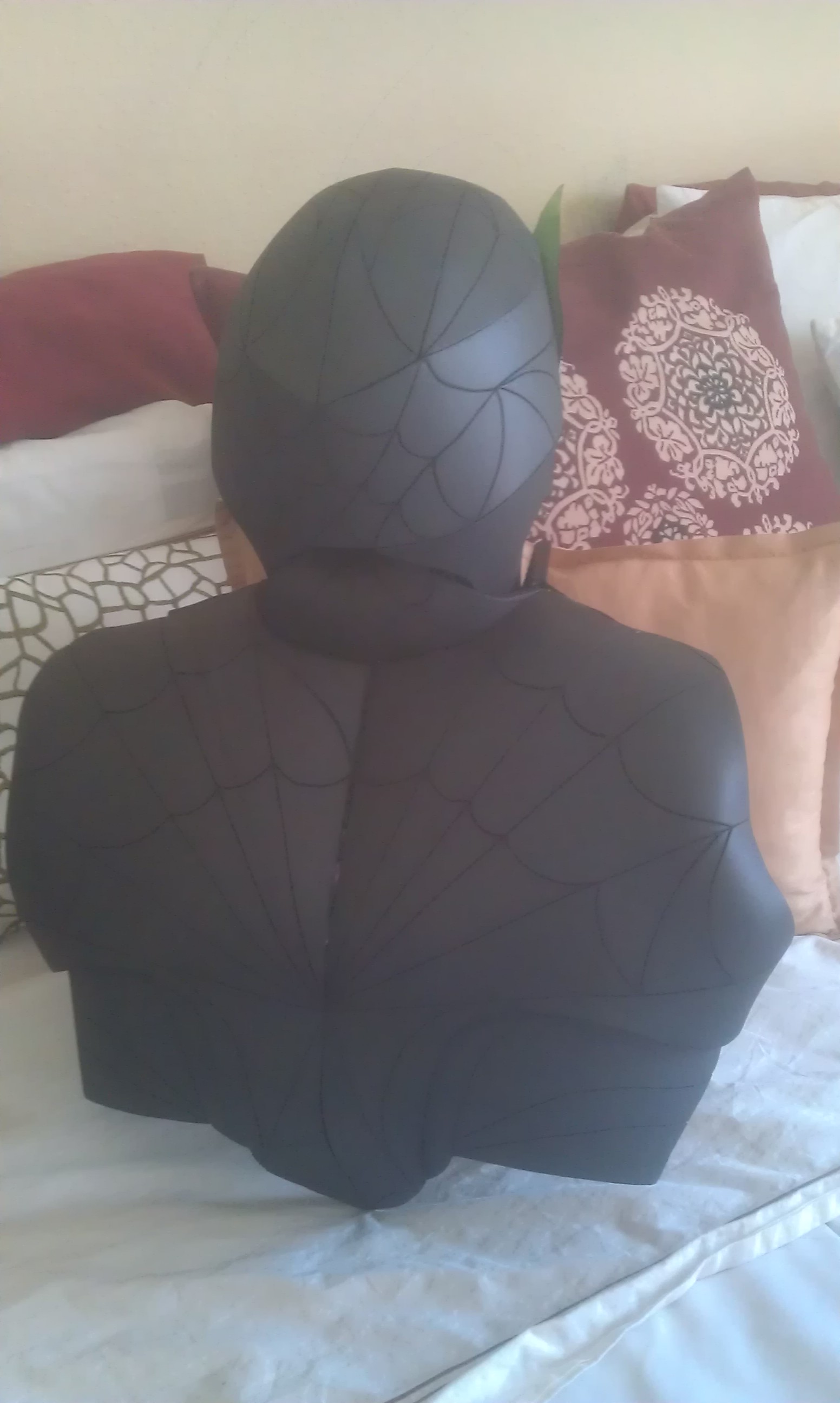

First Foam Build: Ends Of The Earth Inspired Spider-Man Armor (PIC Heavy)

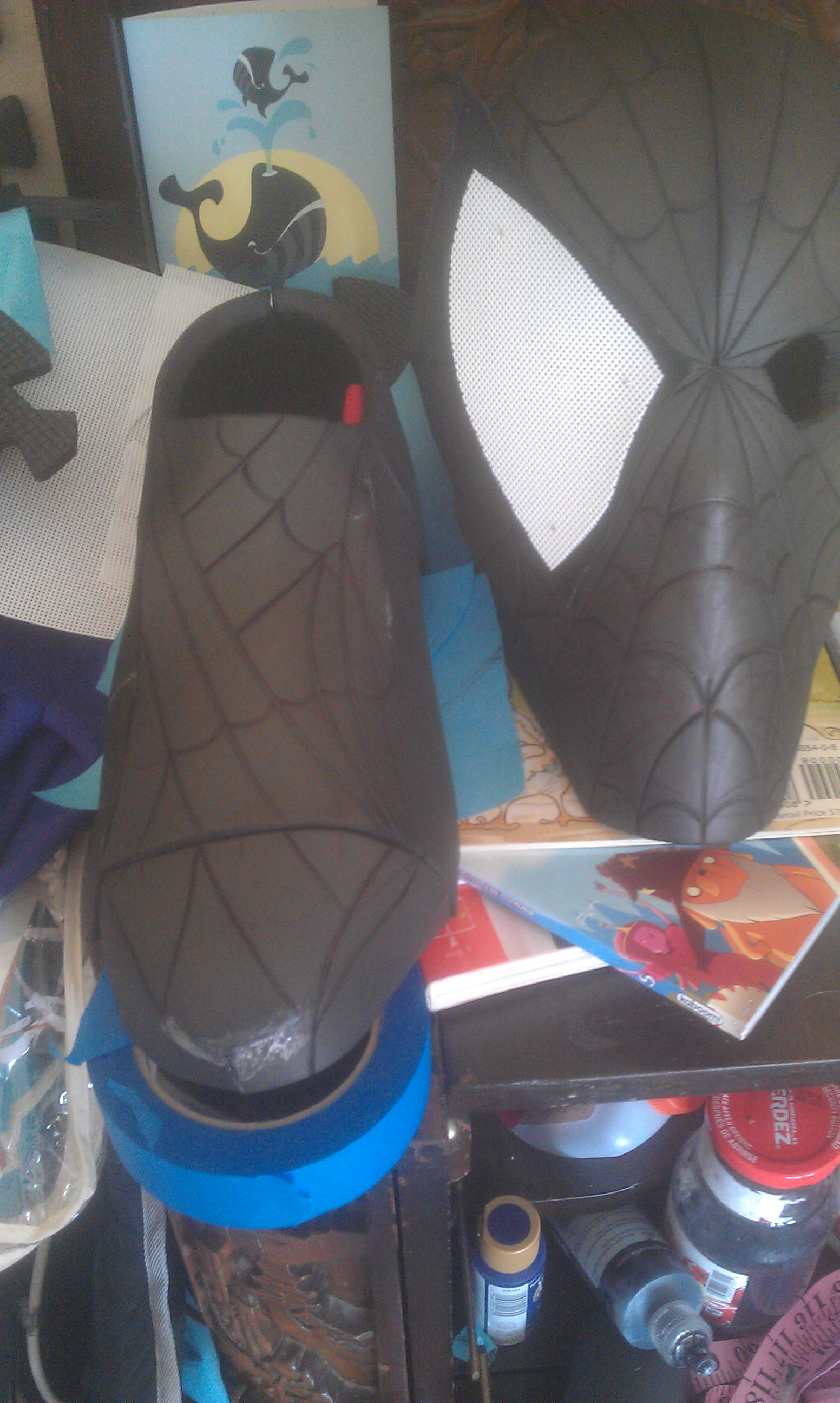

Bucket #2 is on the way

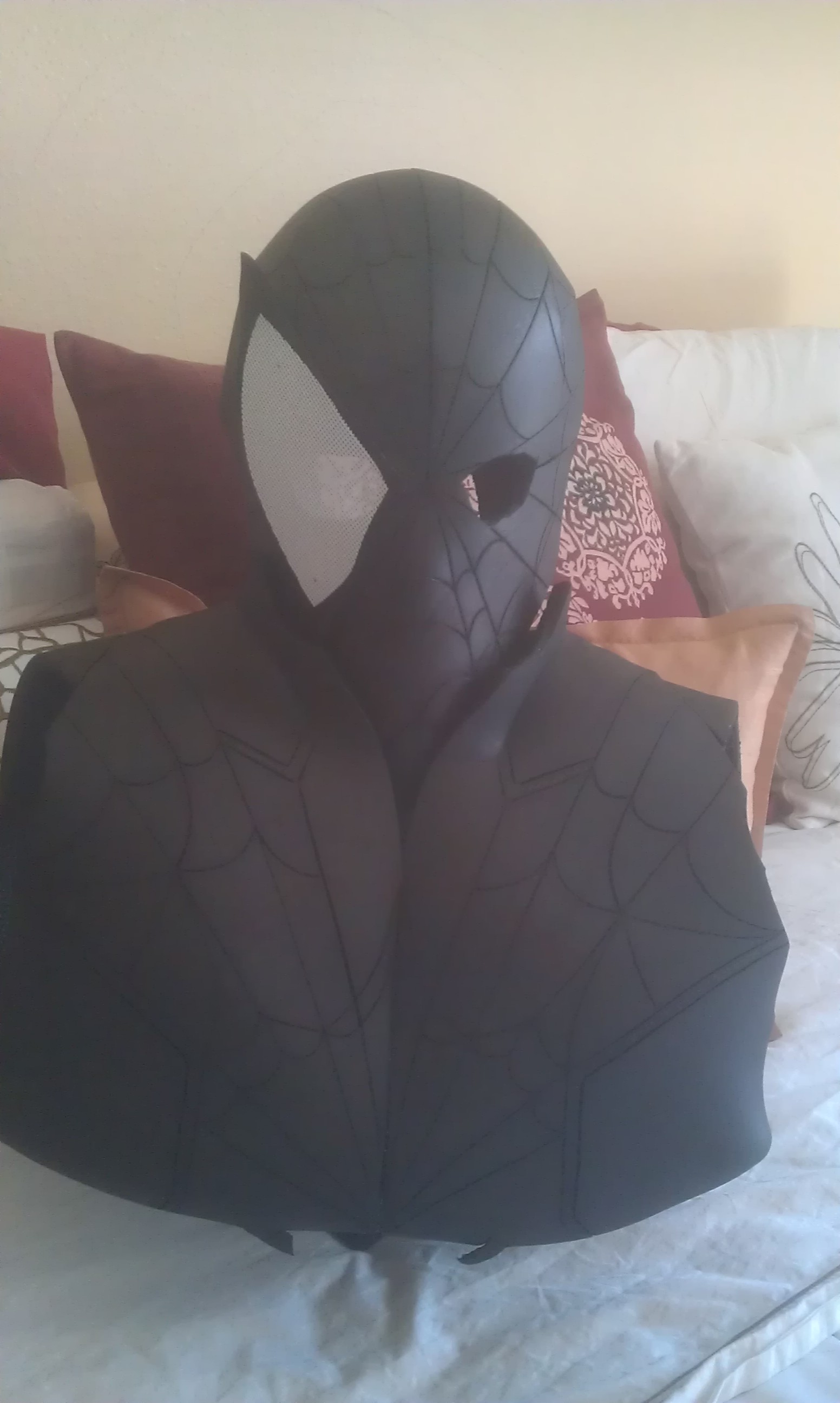

At the moment it sorta looks like Agent Venom

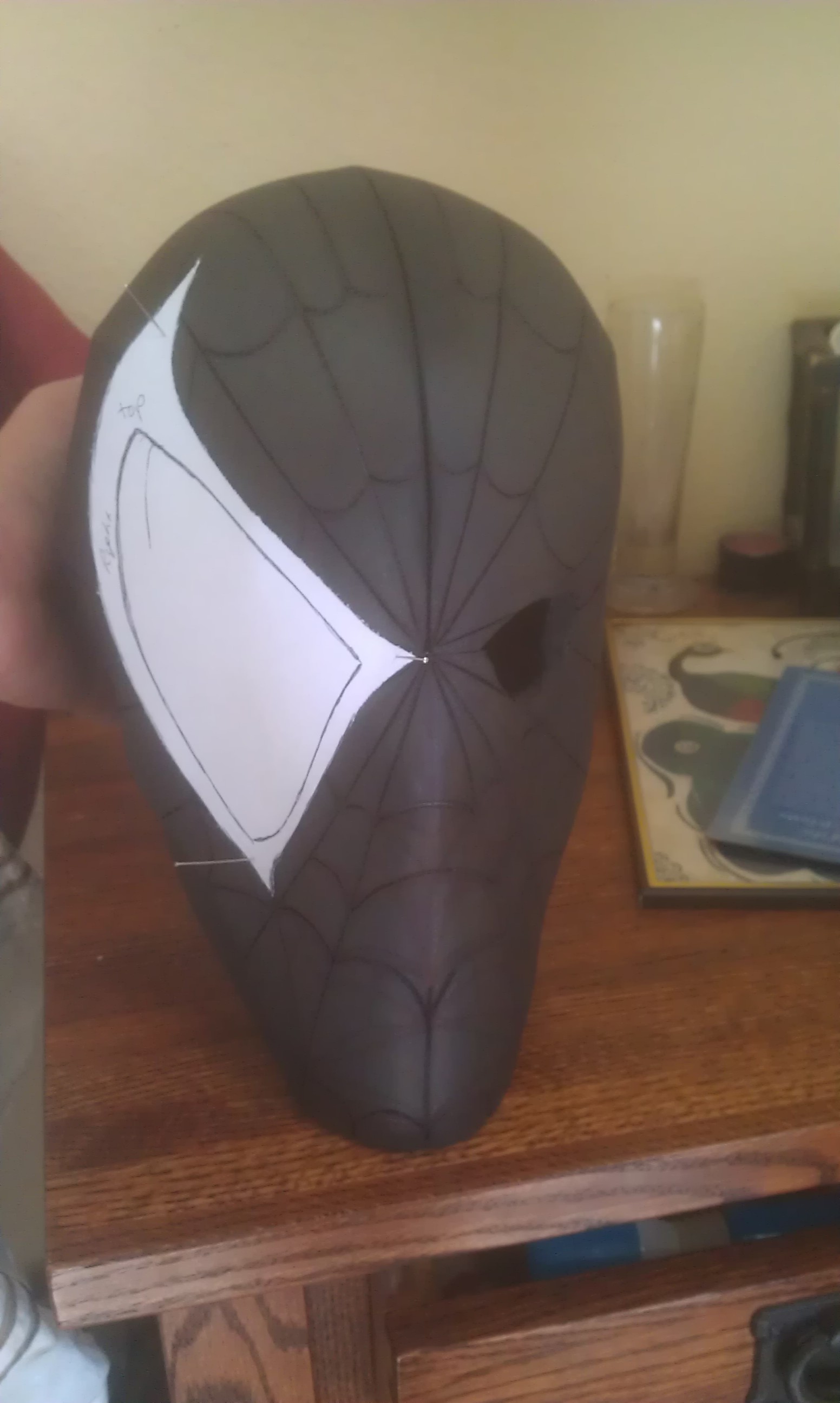

What do you all think of the web patterns?

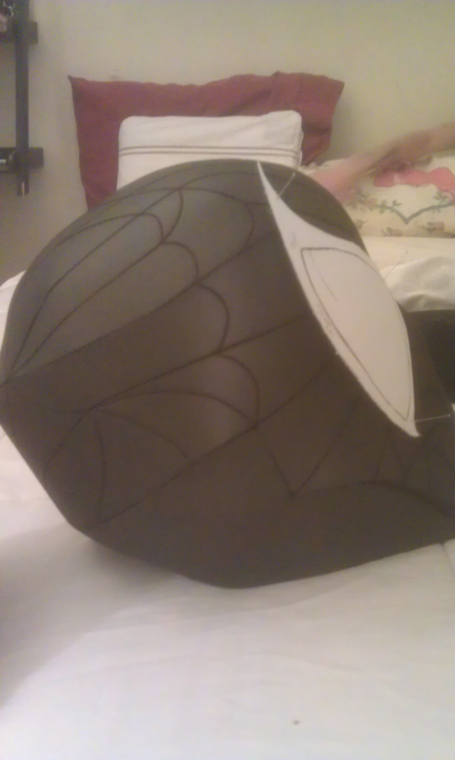

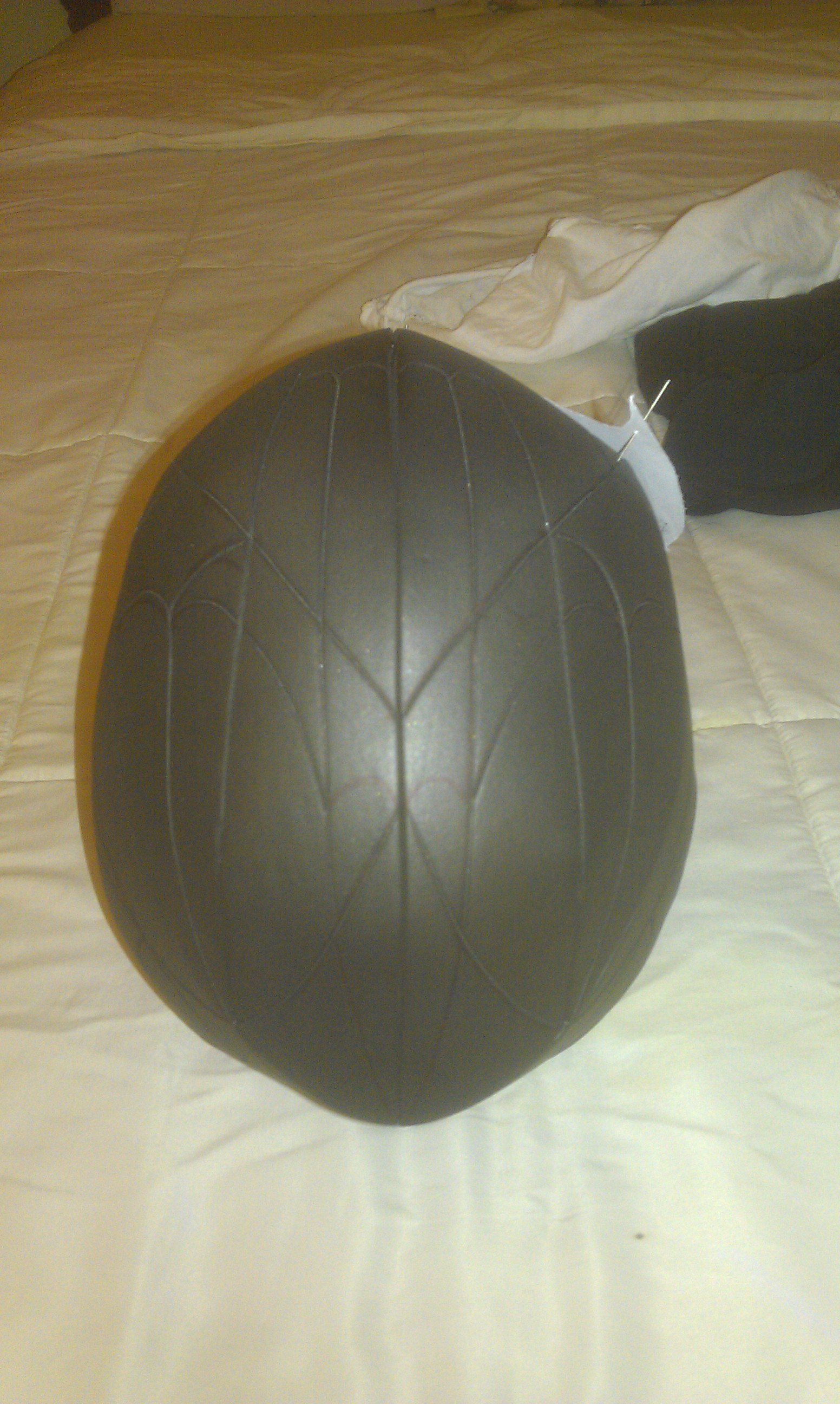

Here's the side, back and top:

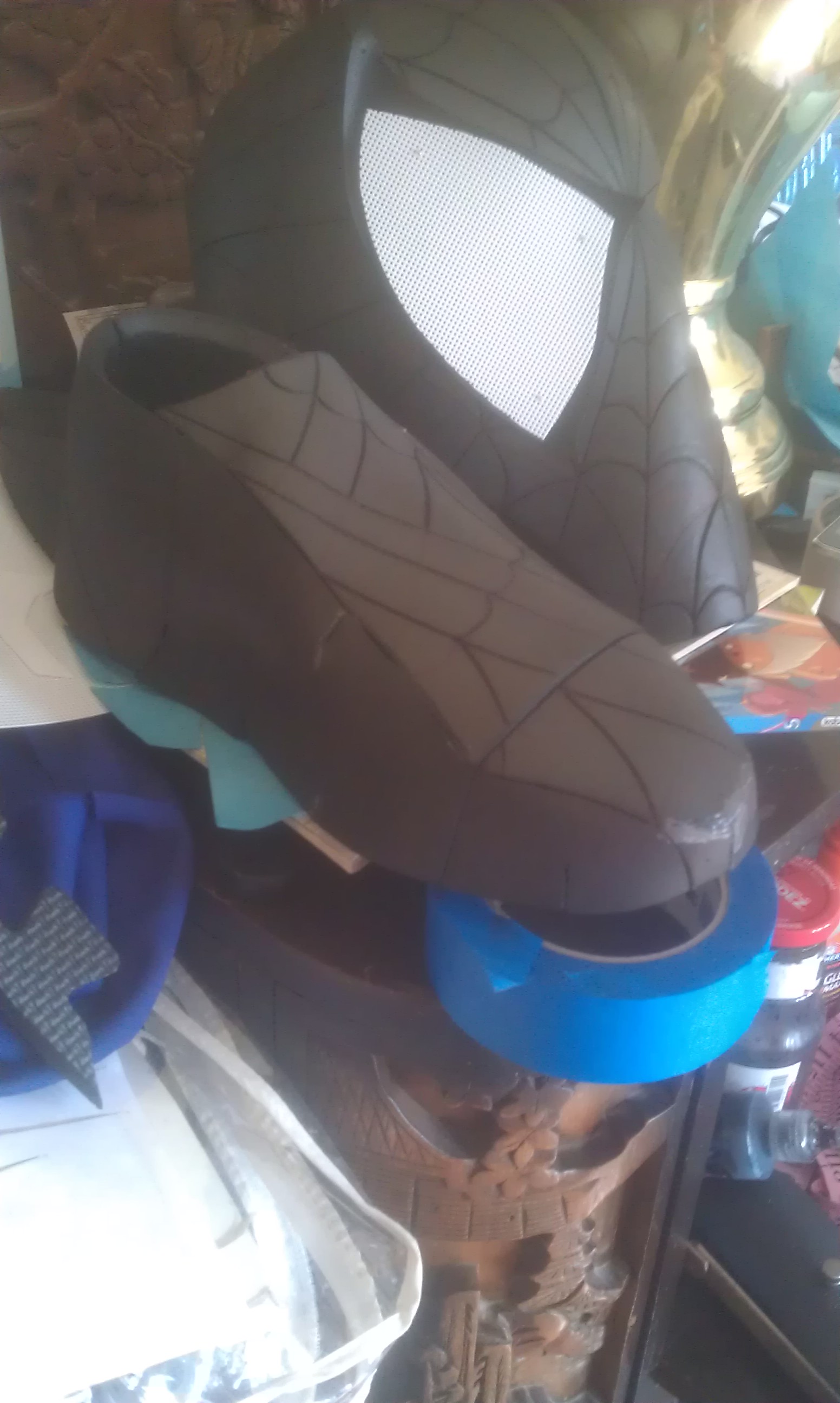

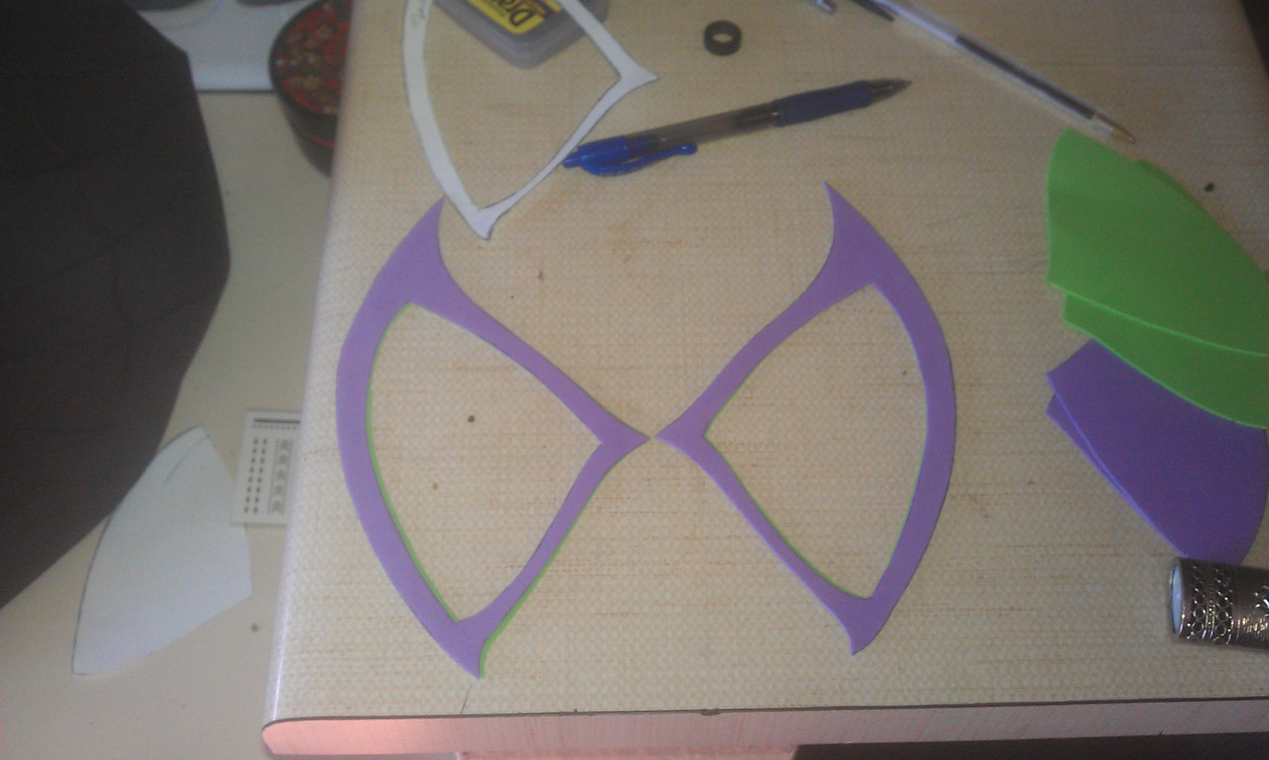

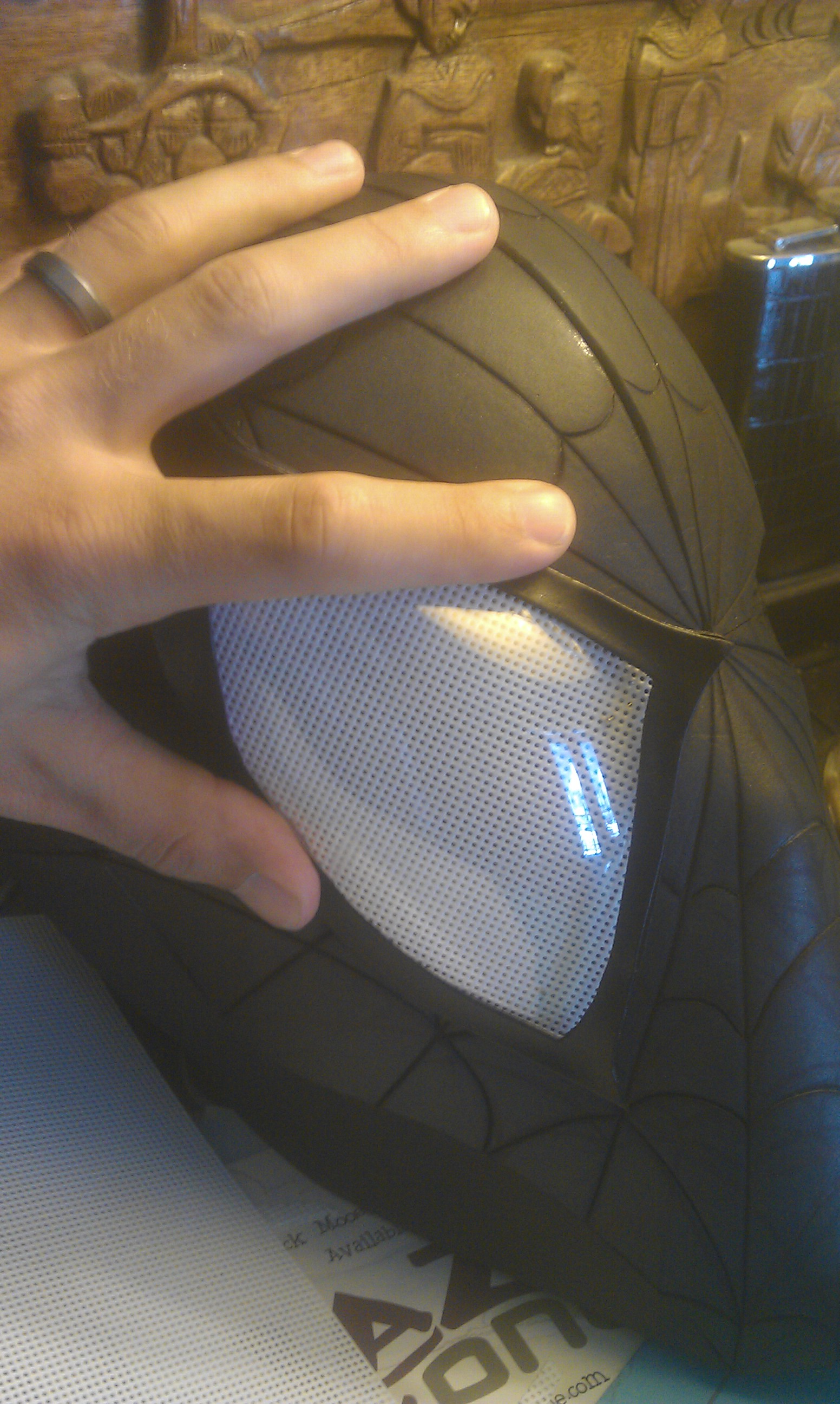

I'll be painting it red like the other bucket, then, along with the rest of the web patterns on the armor, I'll darken the webs up with black. The eye frames will be foam this time, and I'll use the same cross-stitch plastic for the white, then layer it with some sorta lens.
I think it'll look pretty cool... It'll be a minute before I have more paint tho. I'm short on funds for this project. Due to that, may not have many updates for a while

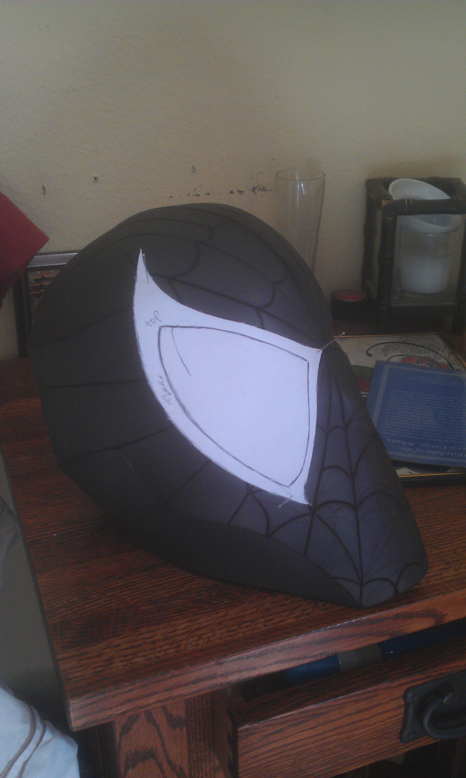

Any suggestions on what I should make the lenses out of? I want domed clear lenses. I'm thinking about making a cheap-o vaccuuform machine... Any other suggestions?
