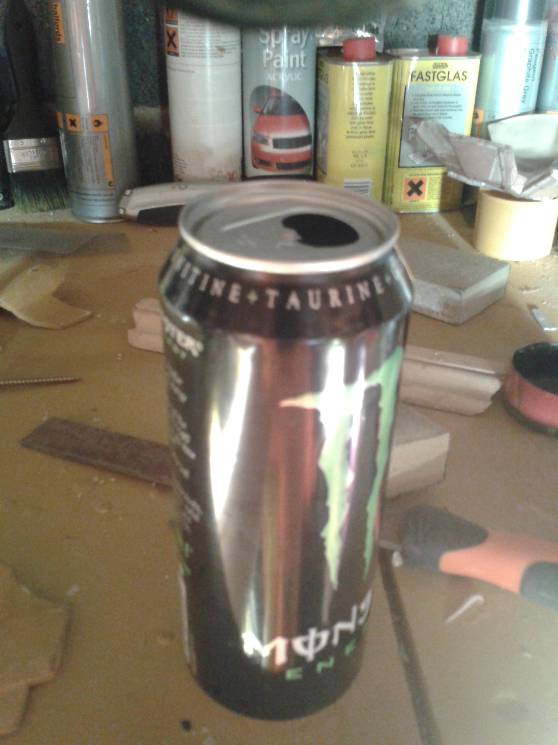

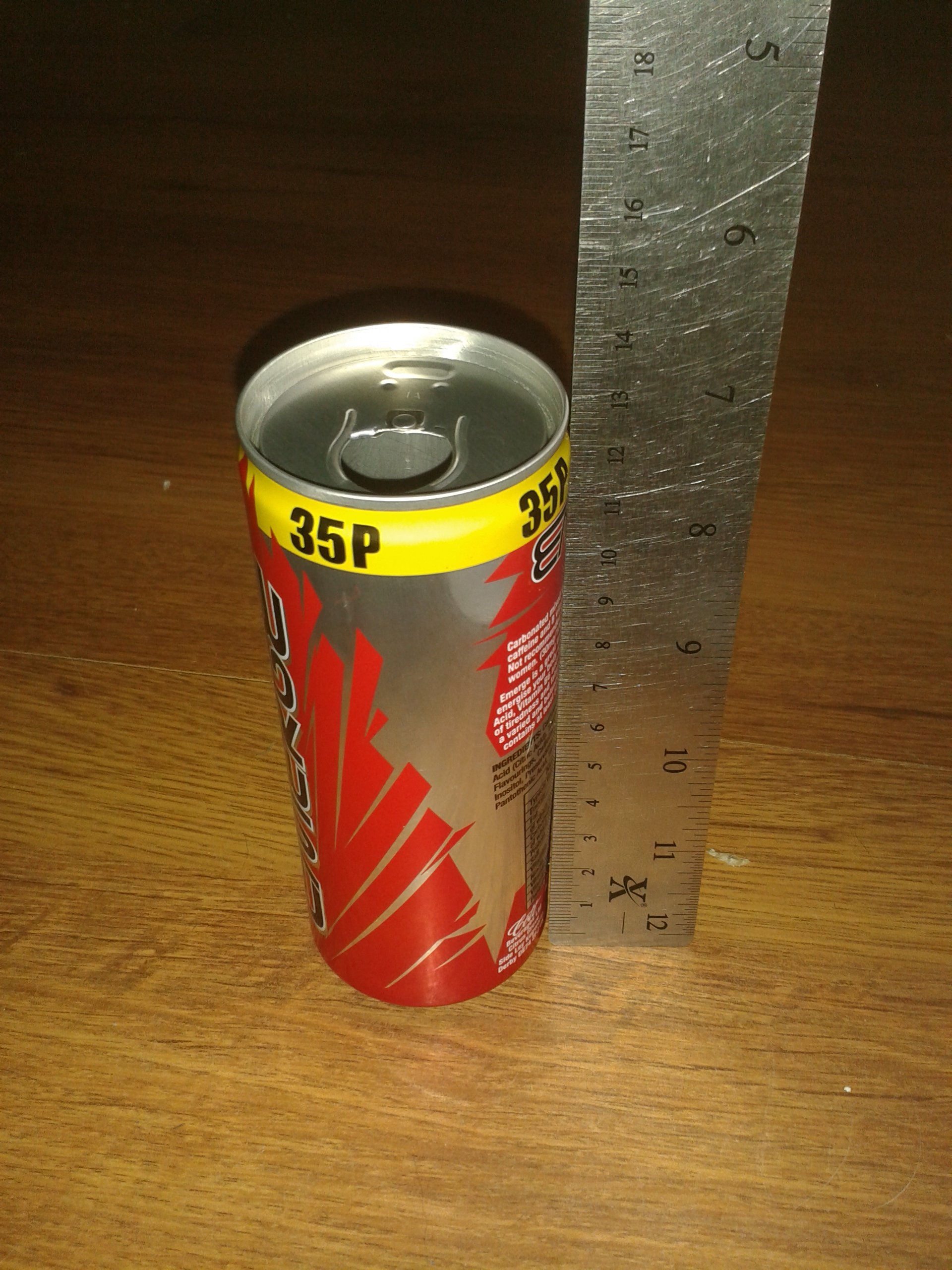

20150702_061408.jpgOk for some reason my images are not loading now, the second part of my update is that I am starting to look at the grenades, ive looked at buying some replica ones but they are a little expensve so instead of making them from pepakura I am going to try using a can of monster energy drink as a base and see how I get on with that, obviously the can on its own is not very strong so I plan to resin and filler inside to strengthen the can so it doesnt get crushed. Plus its probably not a good idea to travel through london underground nd carrying accurate replica grenades ;-)

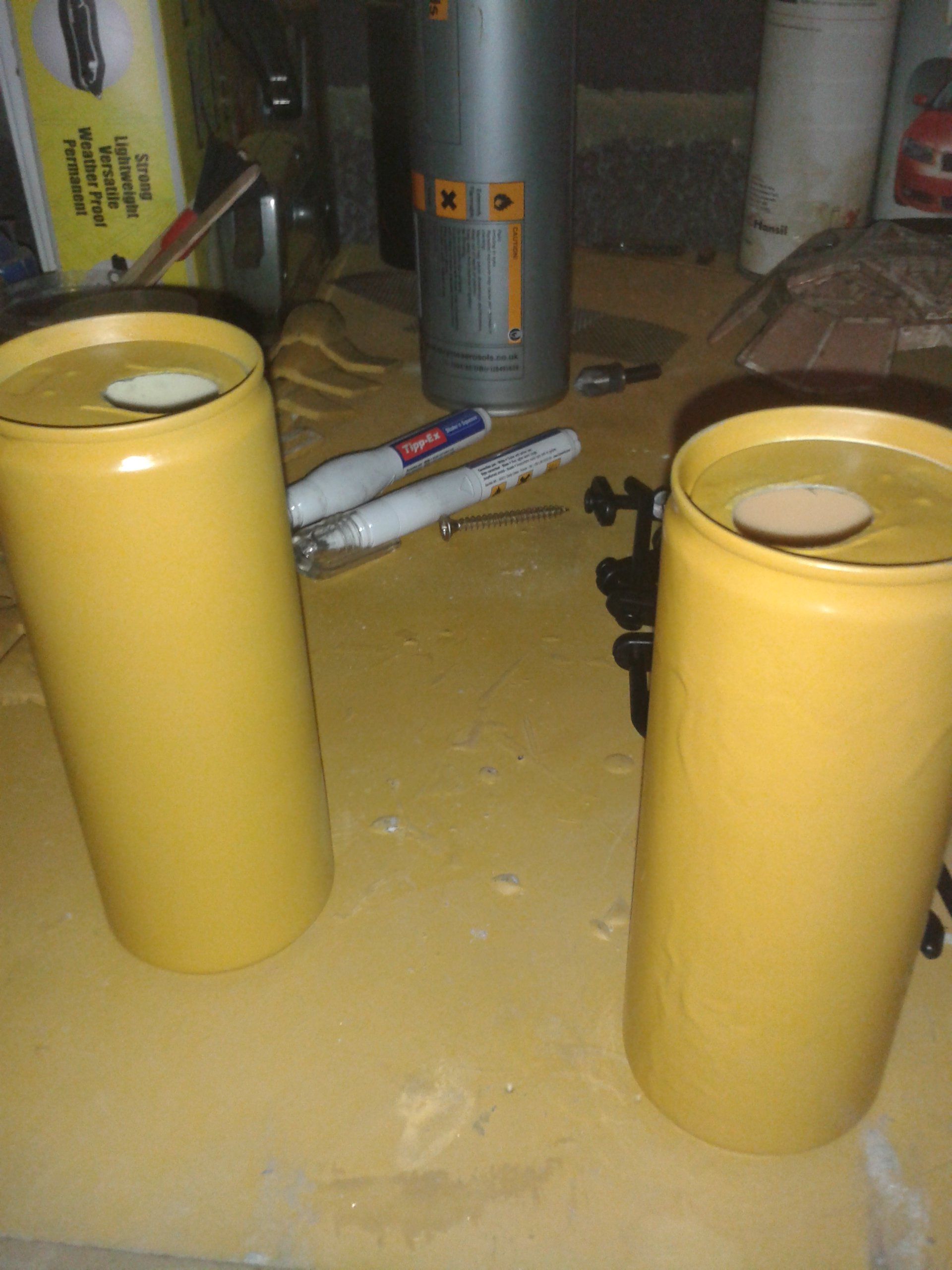

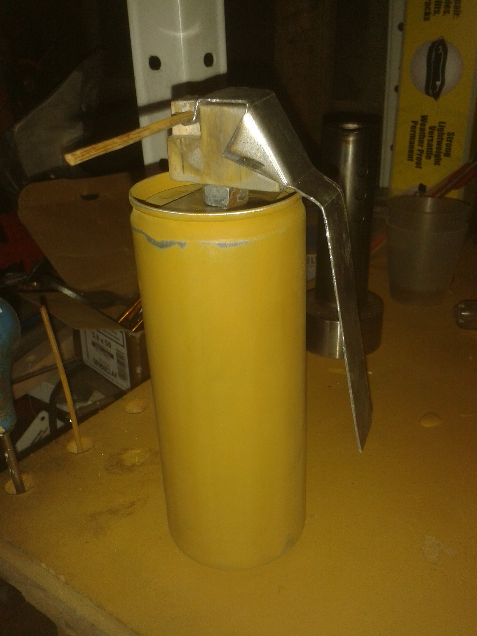

A little bit more progress, kind of. Ive decided on a smaller can of energy drink to act as the carcass of the grenade, which I will coat the inside of with resin filler mix to strengthen the walls

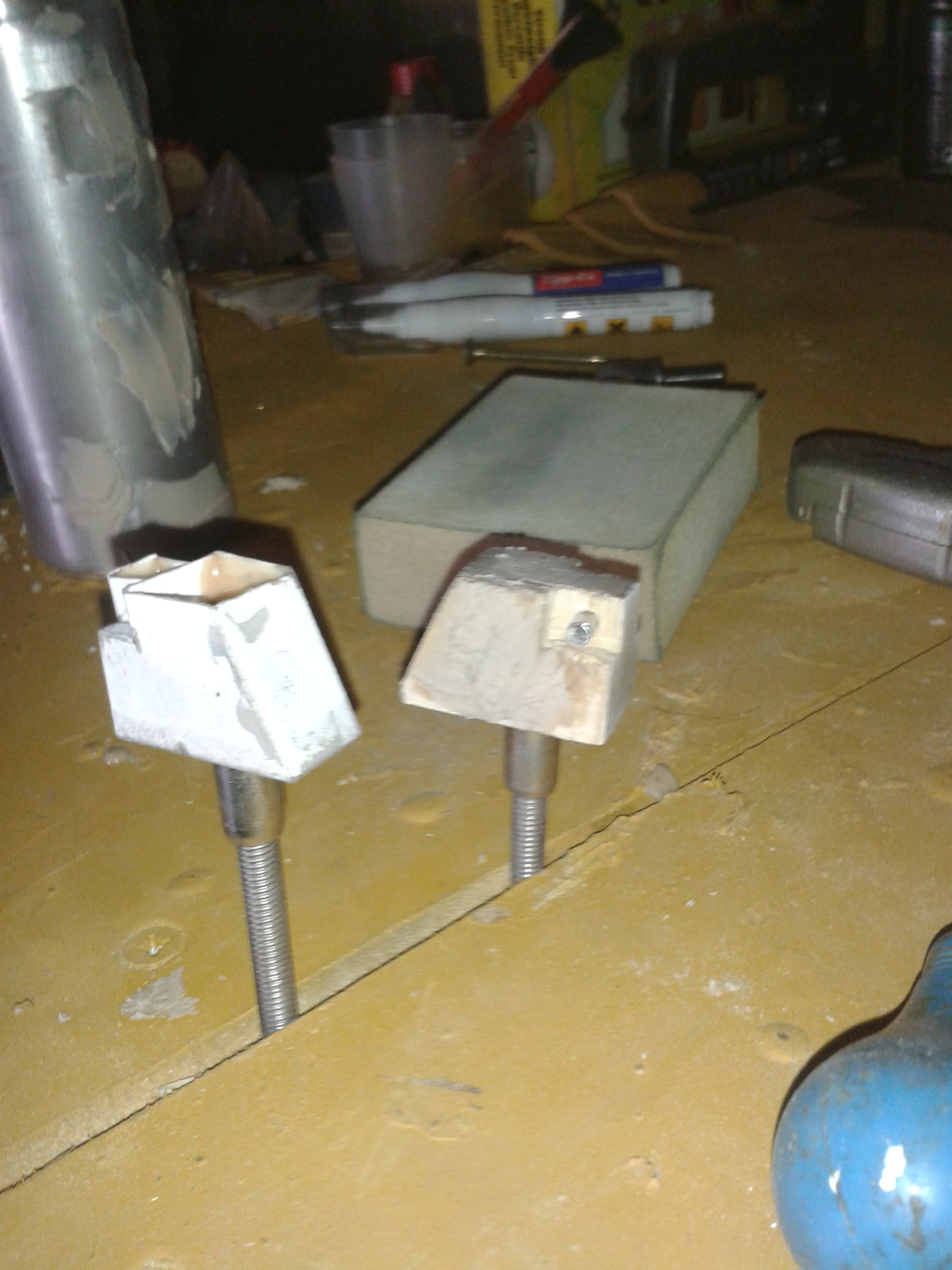

I couldnt sleep last night so decided to work on the fuse mechanism at the top of the grenade and came up with a basic model on 123D design

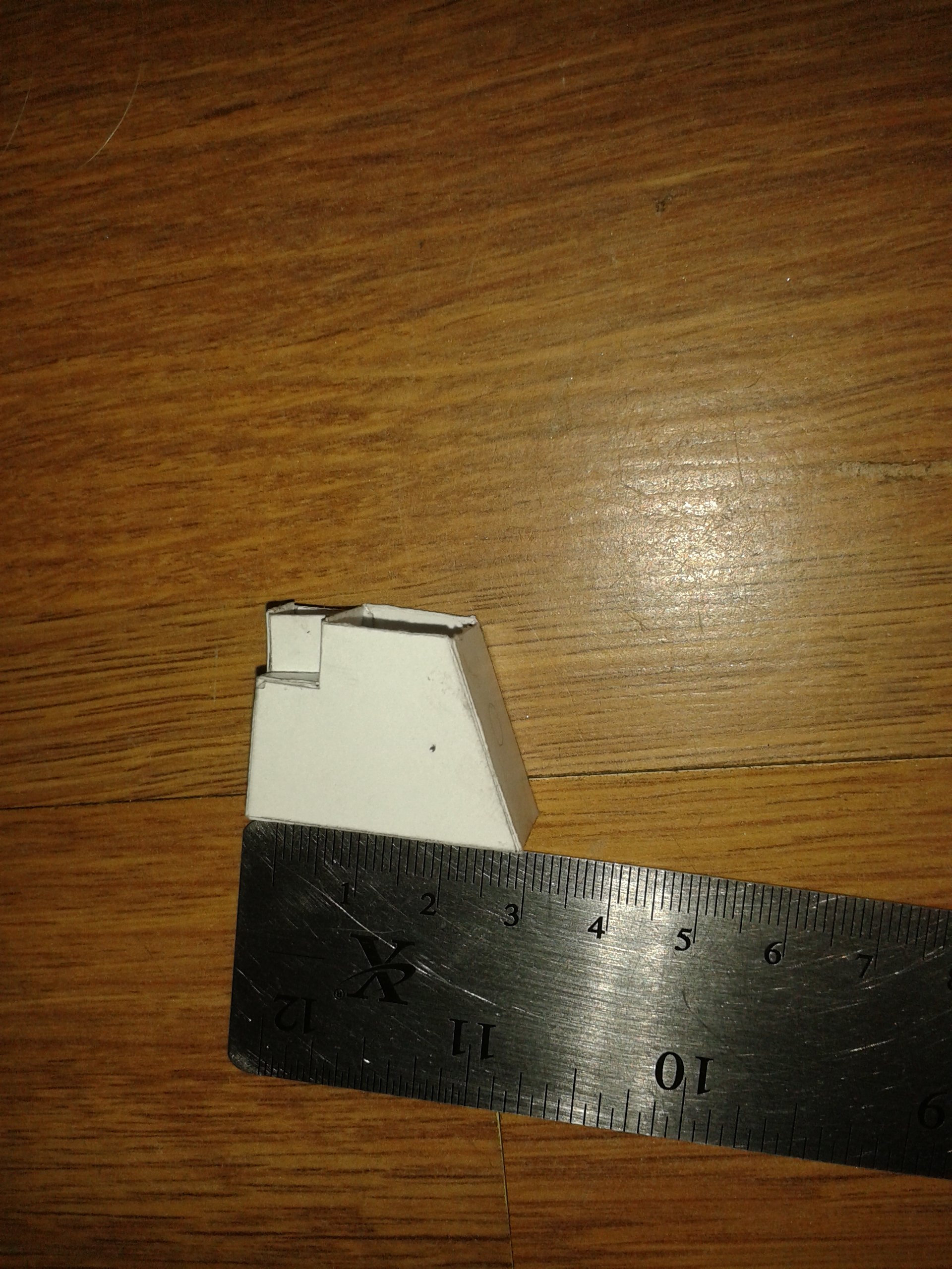

I transfered this to pepakura and then copied it out onto paper using the point to point measurement too (still have no printer) and managed to put an acceptable paper model together, I am thinking of making the final piece from some timber offcuts I have lying around.

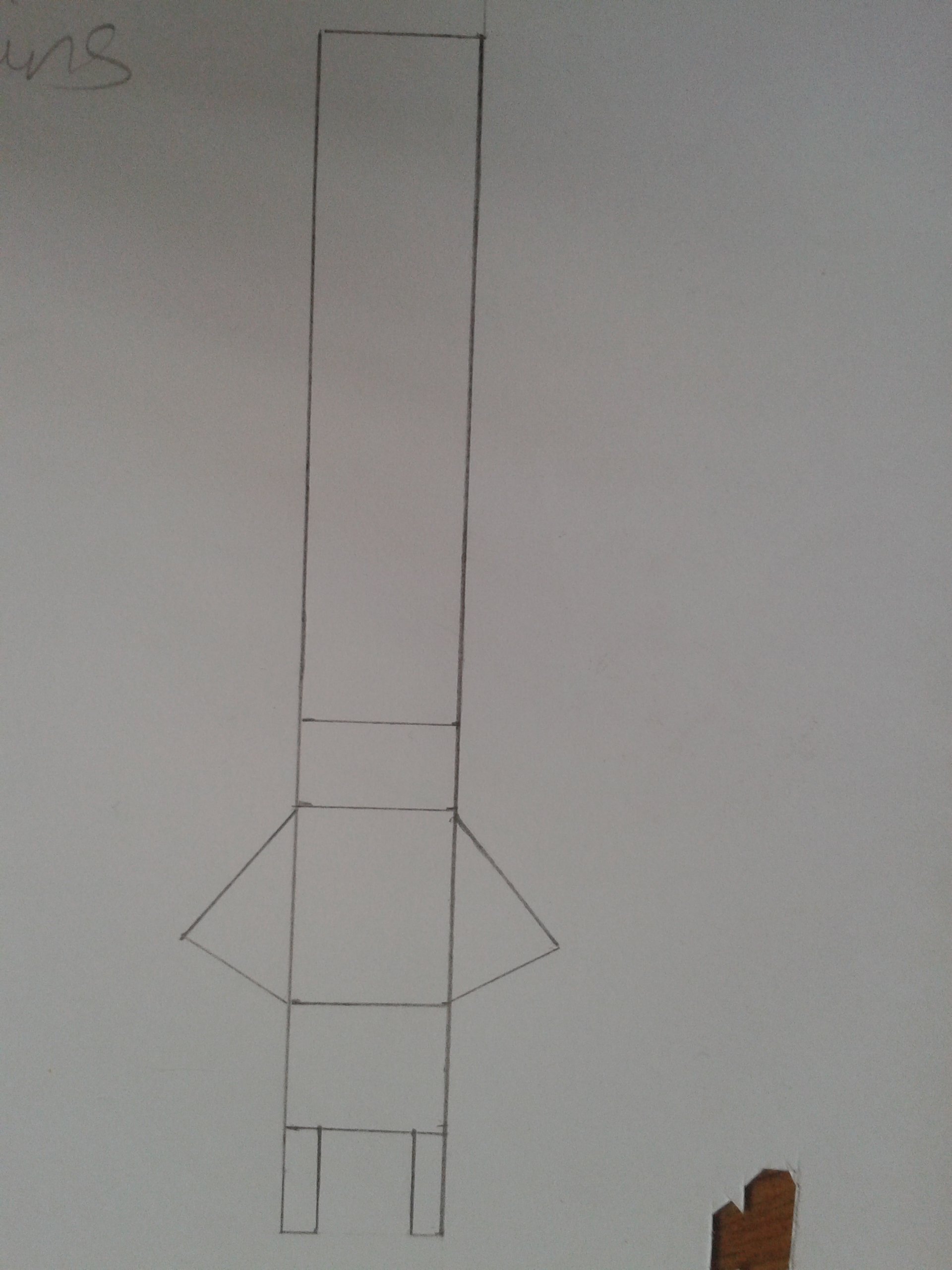

From the measurements of the can and fuse body I drew up a template for the trigger and pin that will be transfered to metal.
I will probably use a nail cut to length for the hinge and I have a few various split pins that should do for the safety pin and ring
With any luck when finished it should look like this
And another update, found some time so trimed a bit of timber to match the paper fuse mechanisnm and think it came out ok
I have both cans lined with resin body filler mix, once they had cooled down I sanded them down and filled most of the low spots sanded down again and sprayed with filler primer ready for a final sand

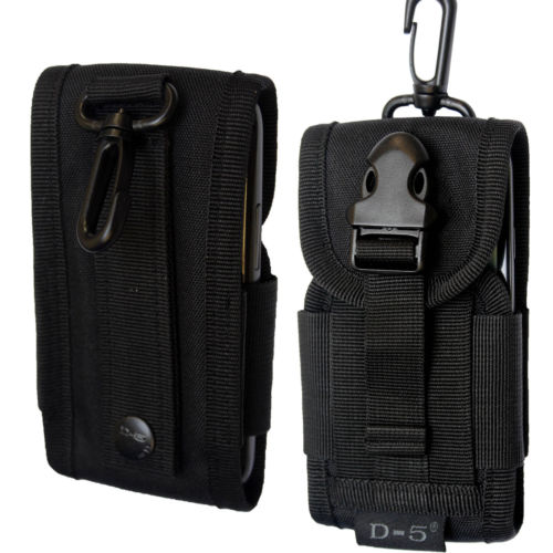

arkhampouch.JPGjust bought these for the pouches, i know they are not perfect but they are the right size i want and look good, and most importantly i can fit my phone in it.
Can you post the links to some of the stuff you've found? Like the jacket and the pouches? It just seems like a research thread should have the info available lol
pouches http://www.ebay.co.uk/itm/321208721...49&var=510159203369&ssPageName=STRK:MEBIDX:IT

Grenades - body ready for paint, fuse box being printed with the gauntlets, trigger and pin still to be finalised

the pouches arrived this morning, i ordered 8 of them but not i have it in my hand i think thats too many as it is a little wider than i thought so will probably only use 3 on each side, on the plus side though, not only does my phone fit perfectly even with the case on it, i can also fit my wallet and my camera in the pouches so now i dont need to worry about where im gonna keep that stuff.

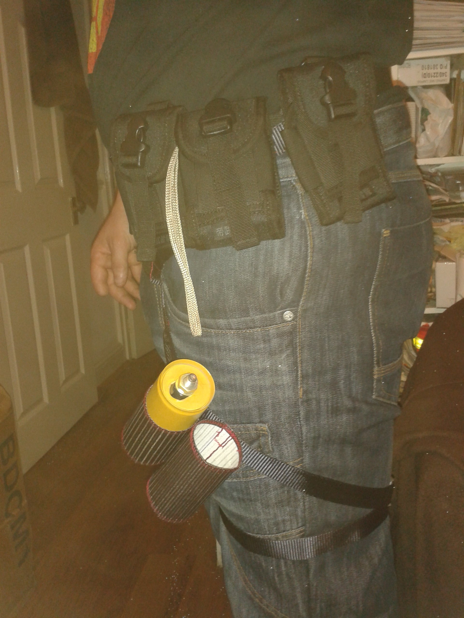

Managed to get most of the grenade holster done today, took all day as I had no help so had to keep holding parts in place and try to pin it together at same time, despite this impretty happy considering I havent used a needle and thread since I was at school a lifetime ago, still have to make the grenade hholders and attach them to the harness, should have it finished tomorrow so I can cross it off the list.

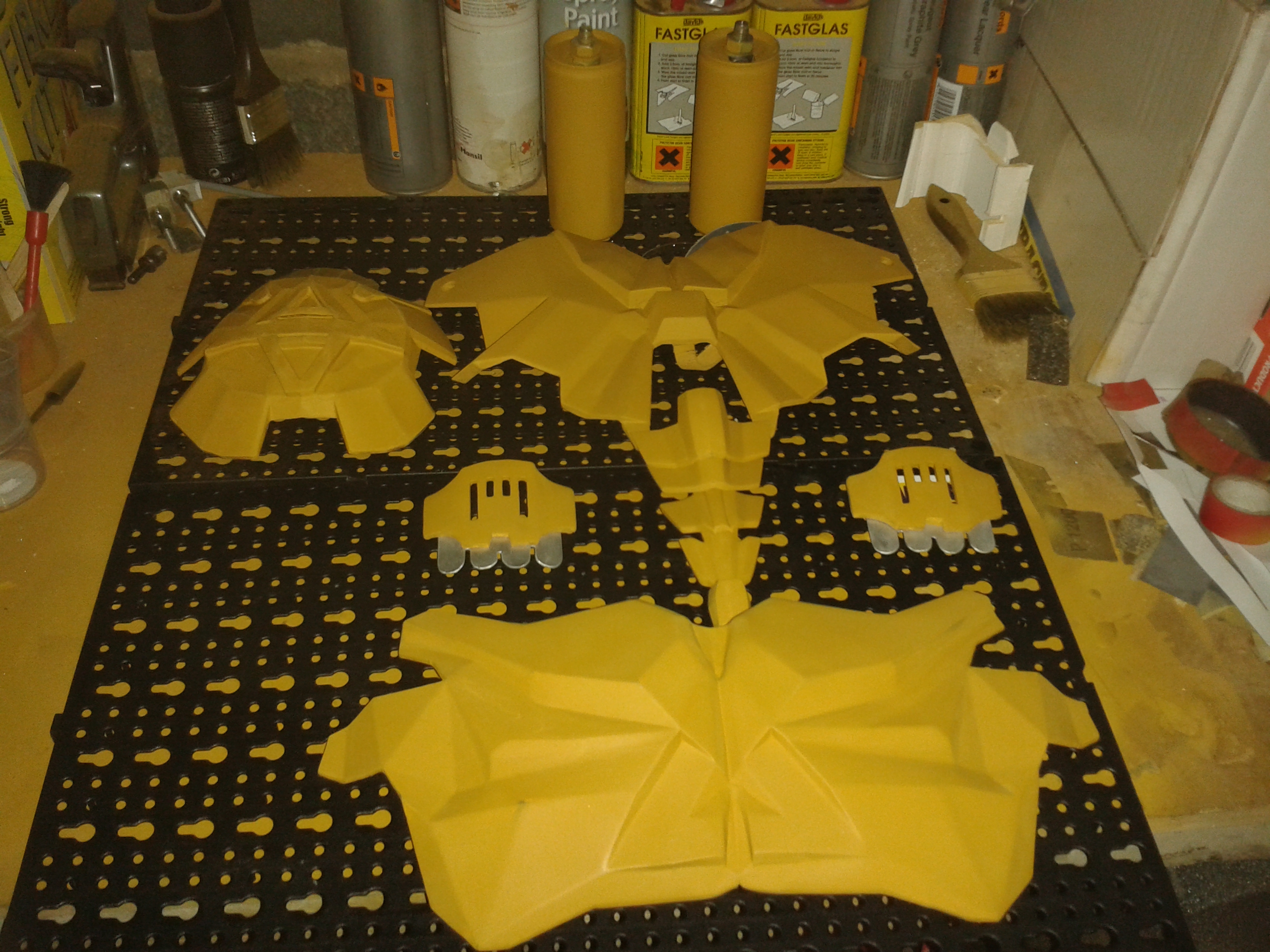

And as promised a pic of all the parts that are done ready for painting
