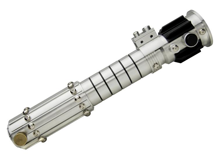

My reference is this one, the purple-pink lightsaber.

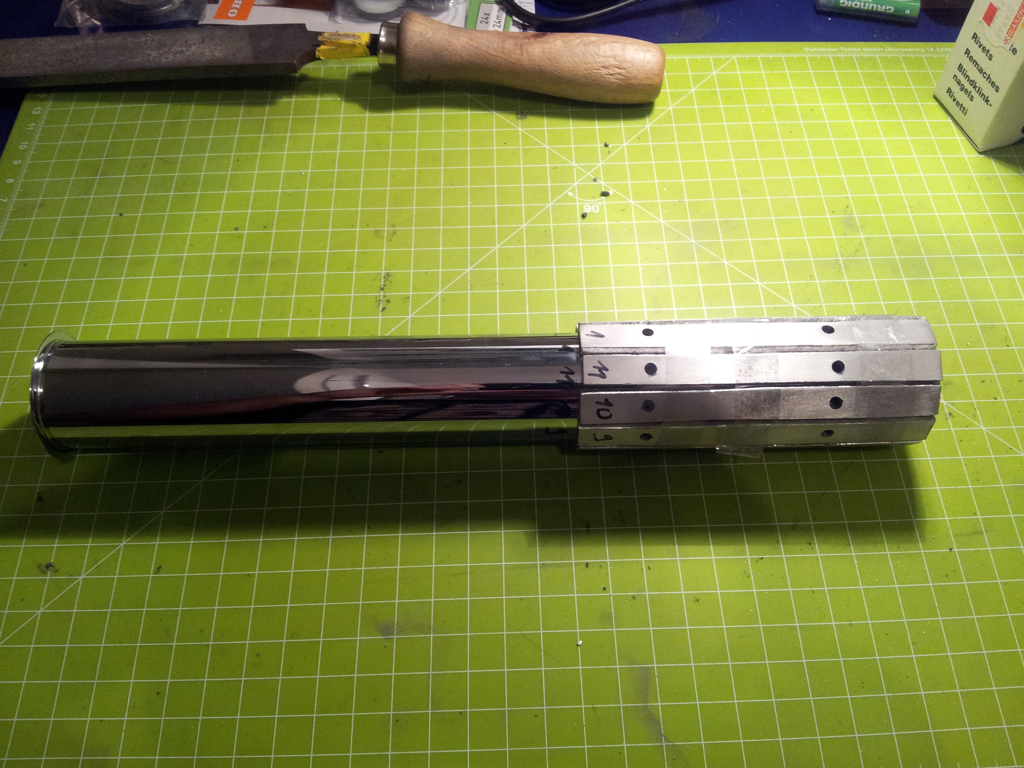

I started with some plumbing tube…yeah I know ^^

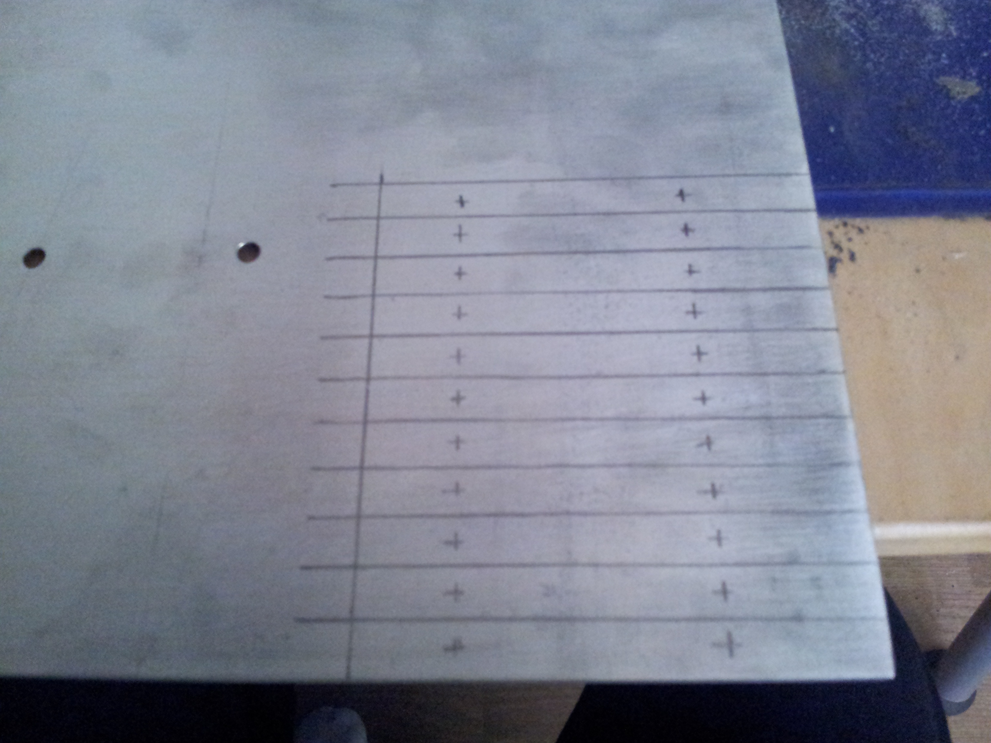

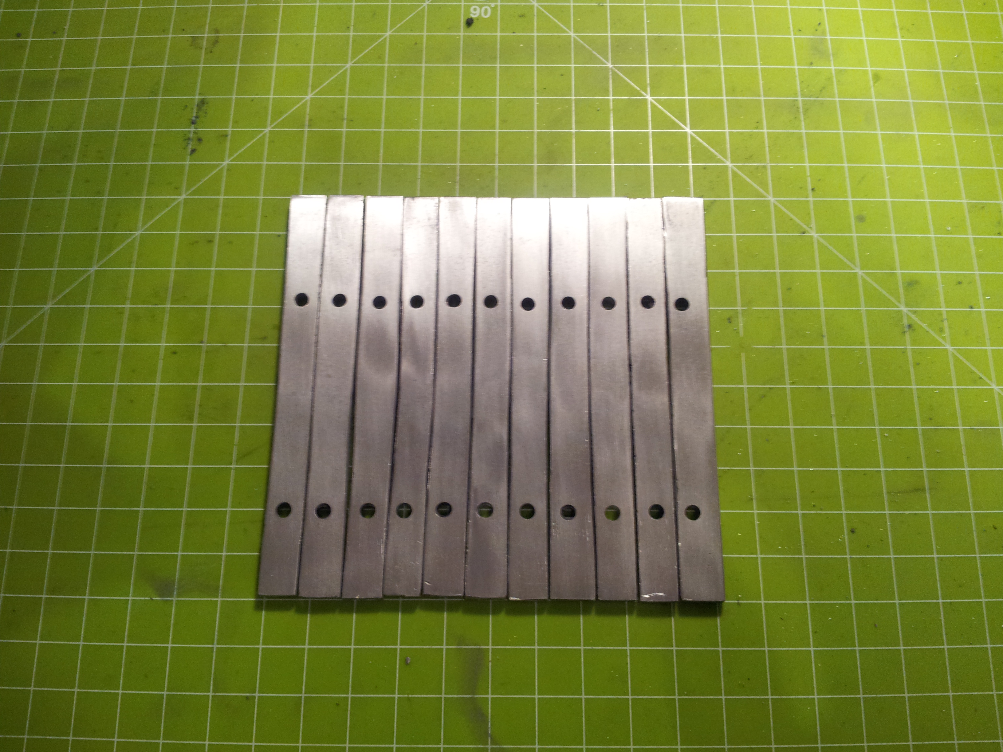

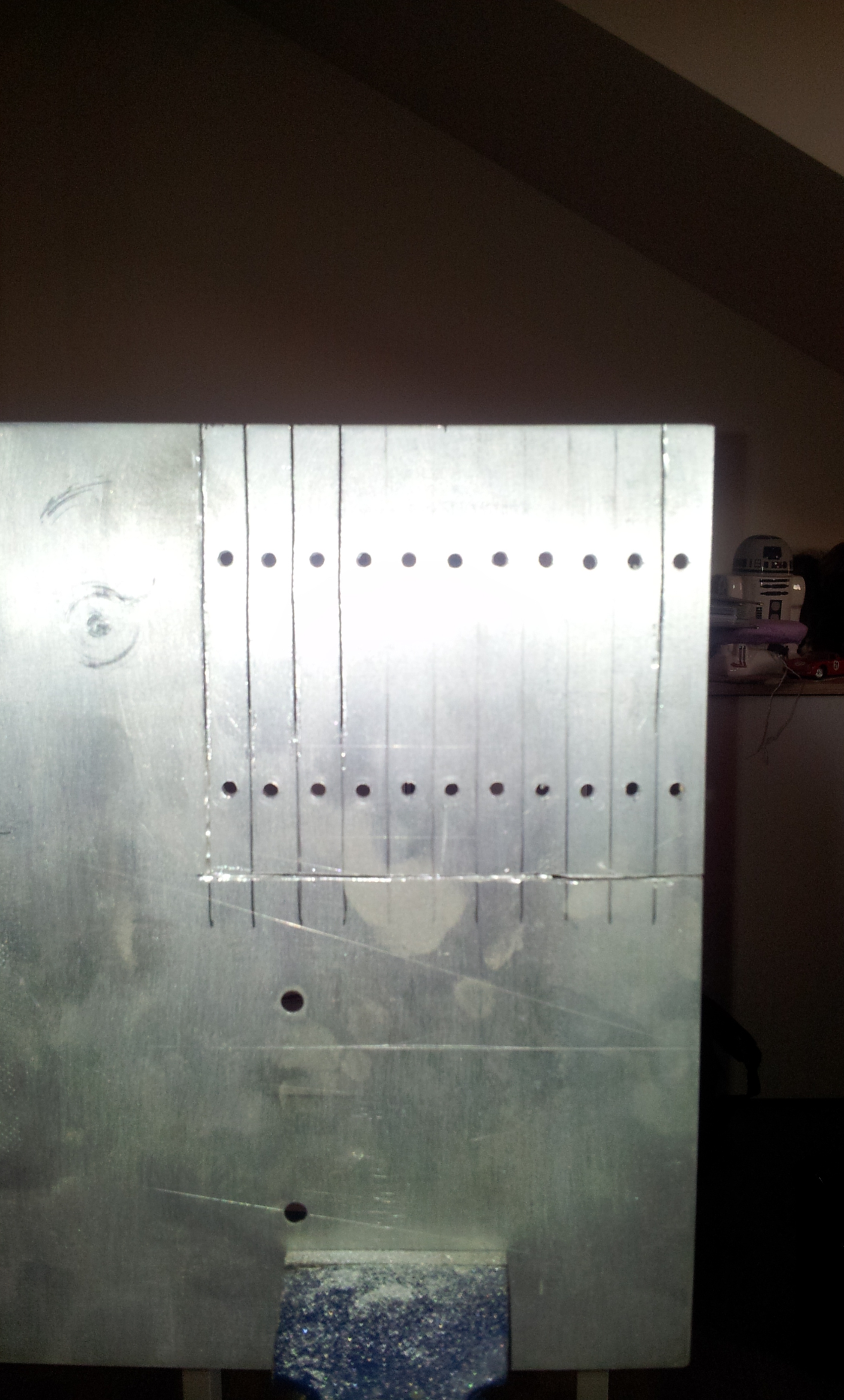

And first cut the rectangular metal stripes out of a metal plate I found.

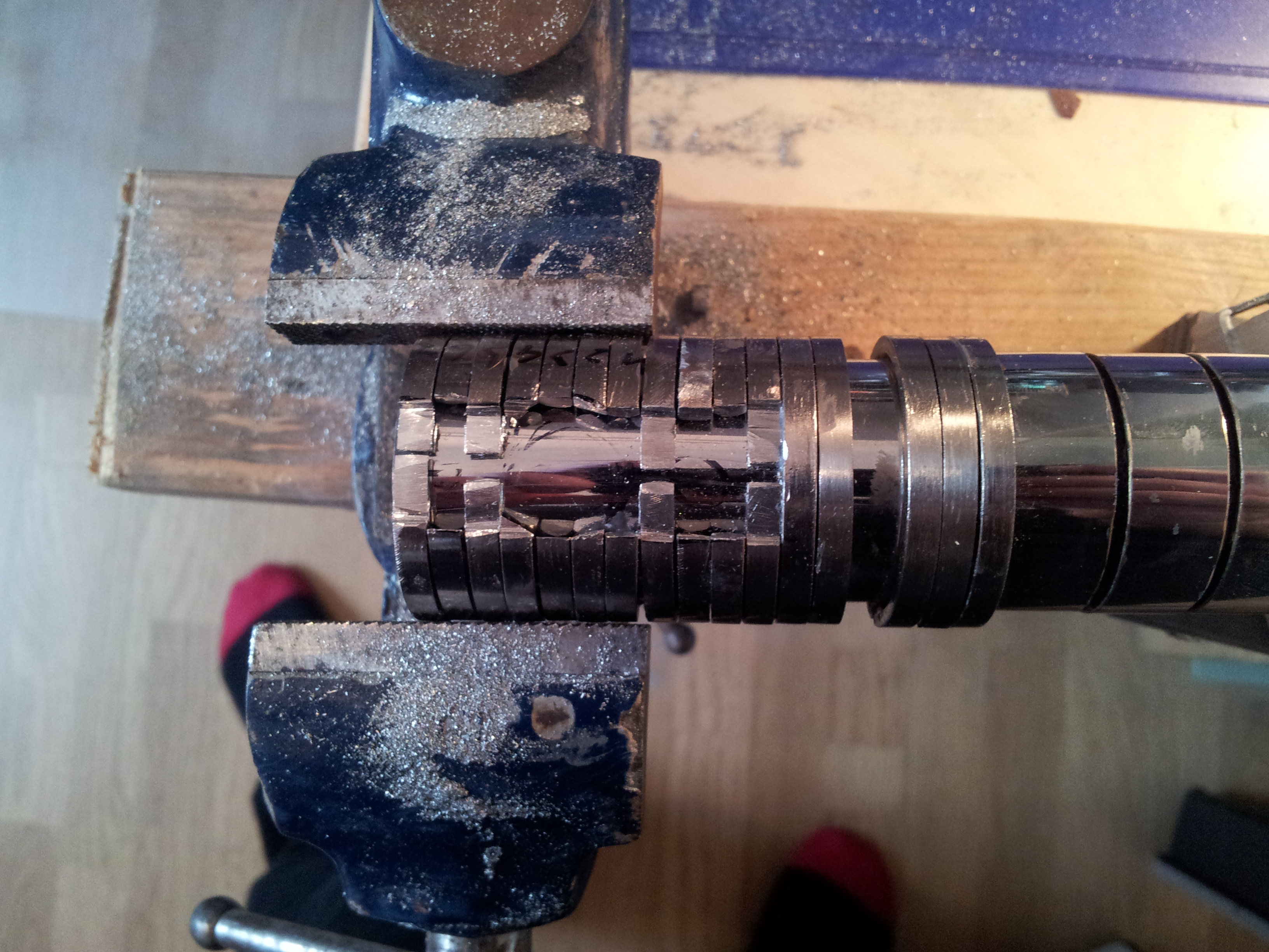

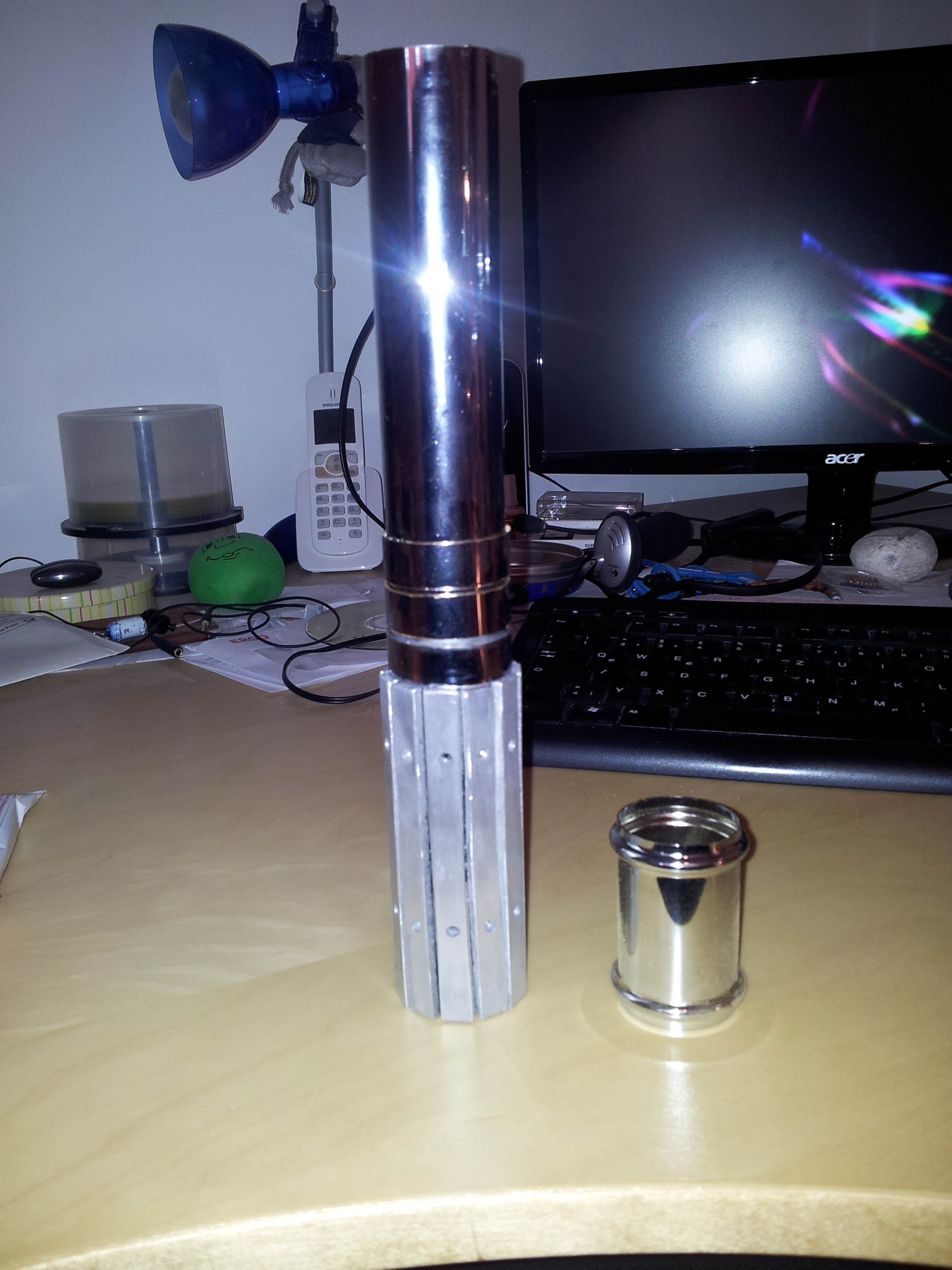

I glued the stripes on the tube and had to think about the metal bands going around the middle of the saber and the grooves between.
I used two plumbing tube coupler. They have a bigger diameter than the other tube.

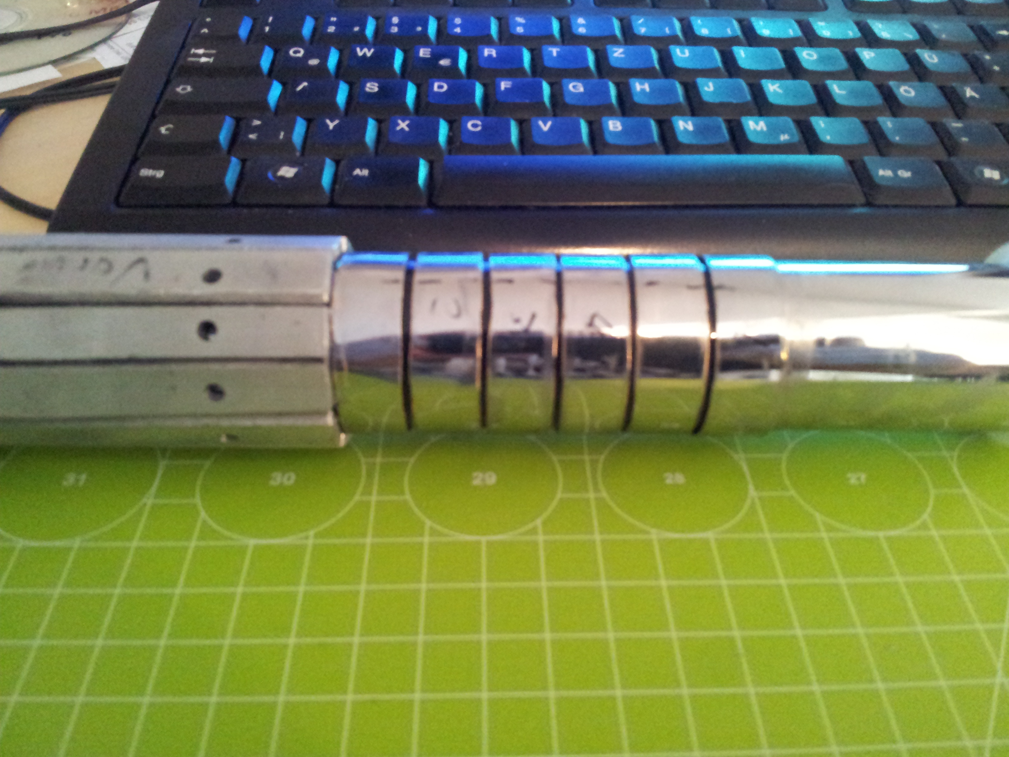

I cut them into six bands, painted the tube black and glued the bands in position.
So I got this nice middle section with black grooves between these six metal bands.

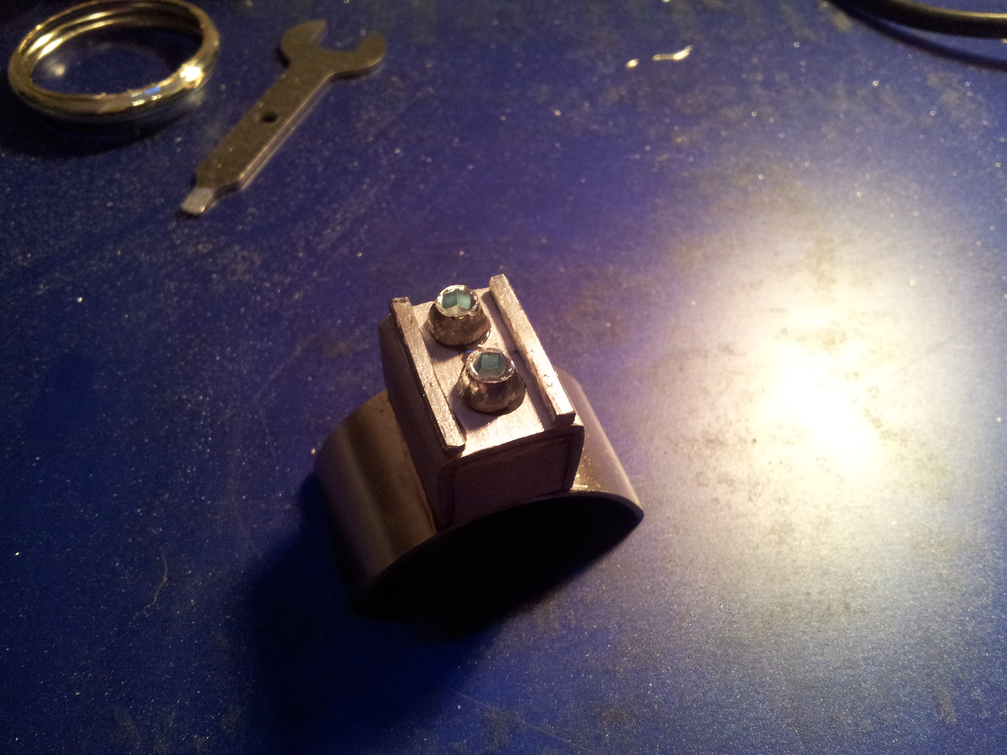

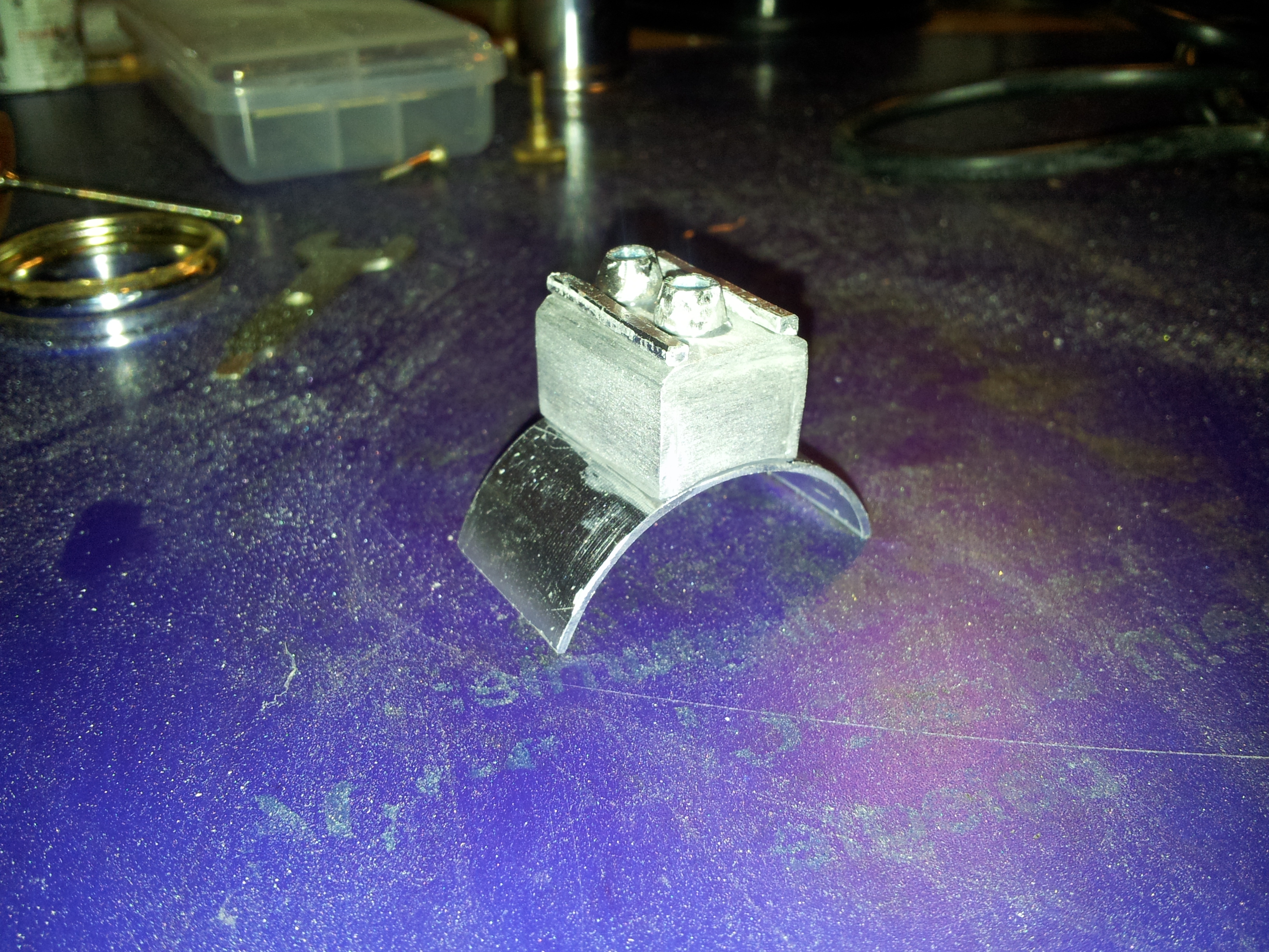

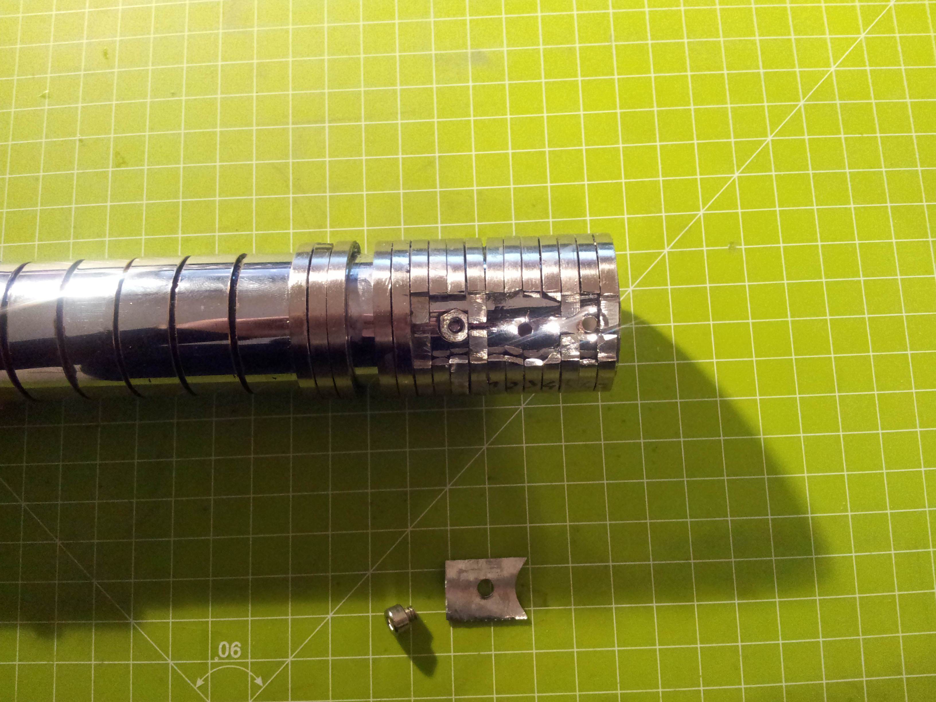

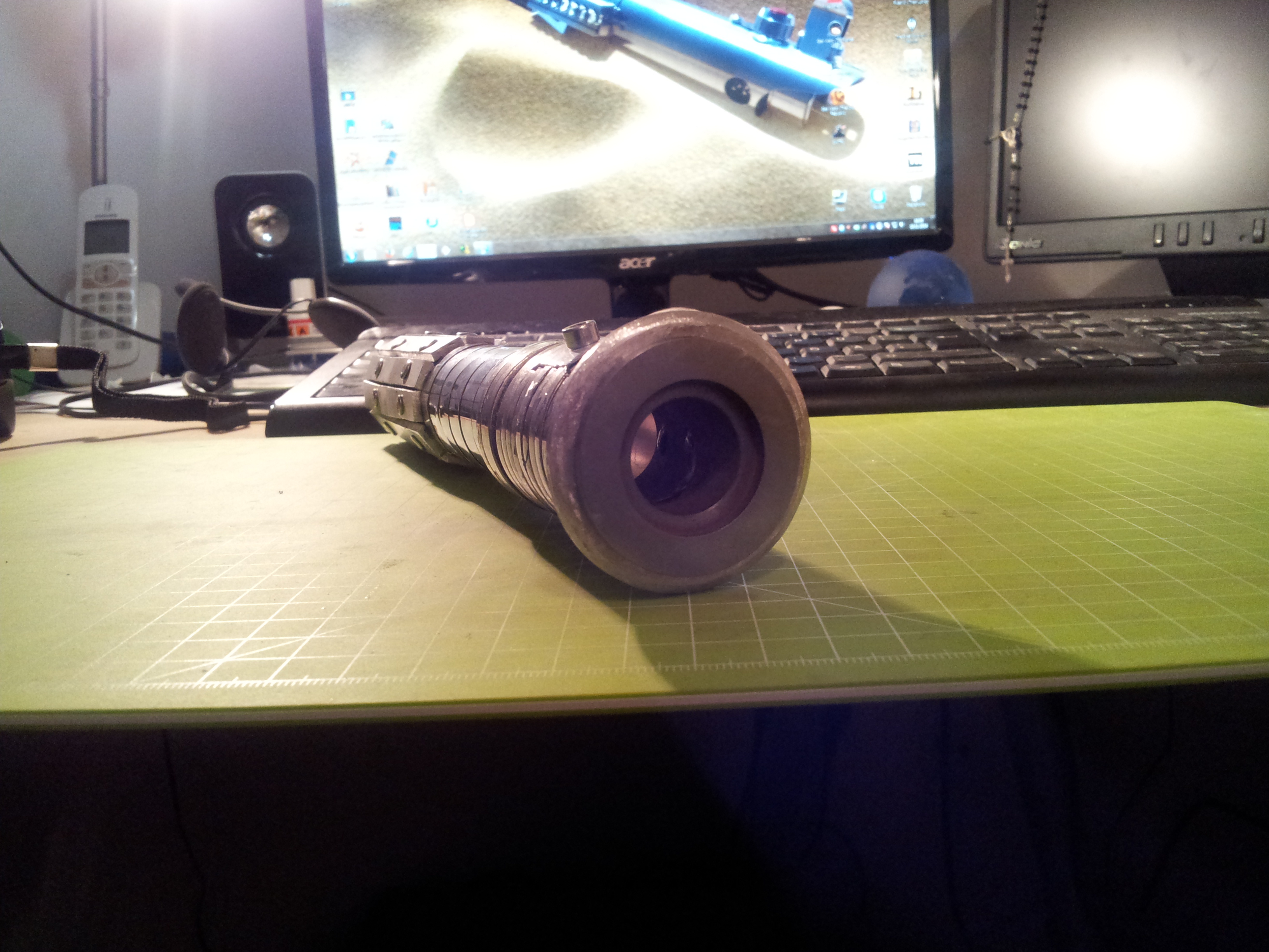

Next I build the little activator box from scrap metal.

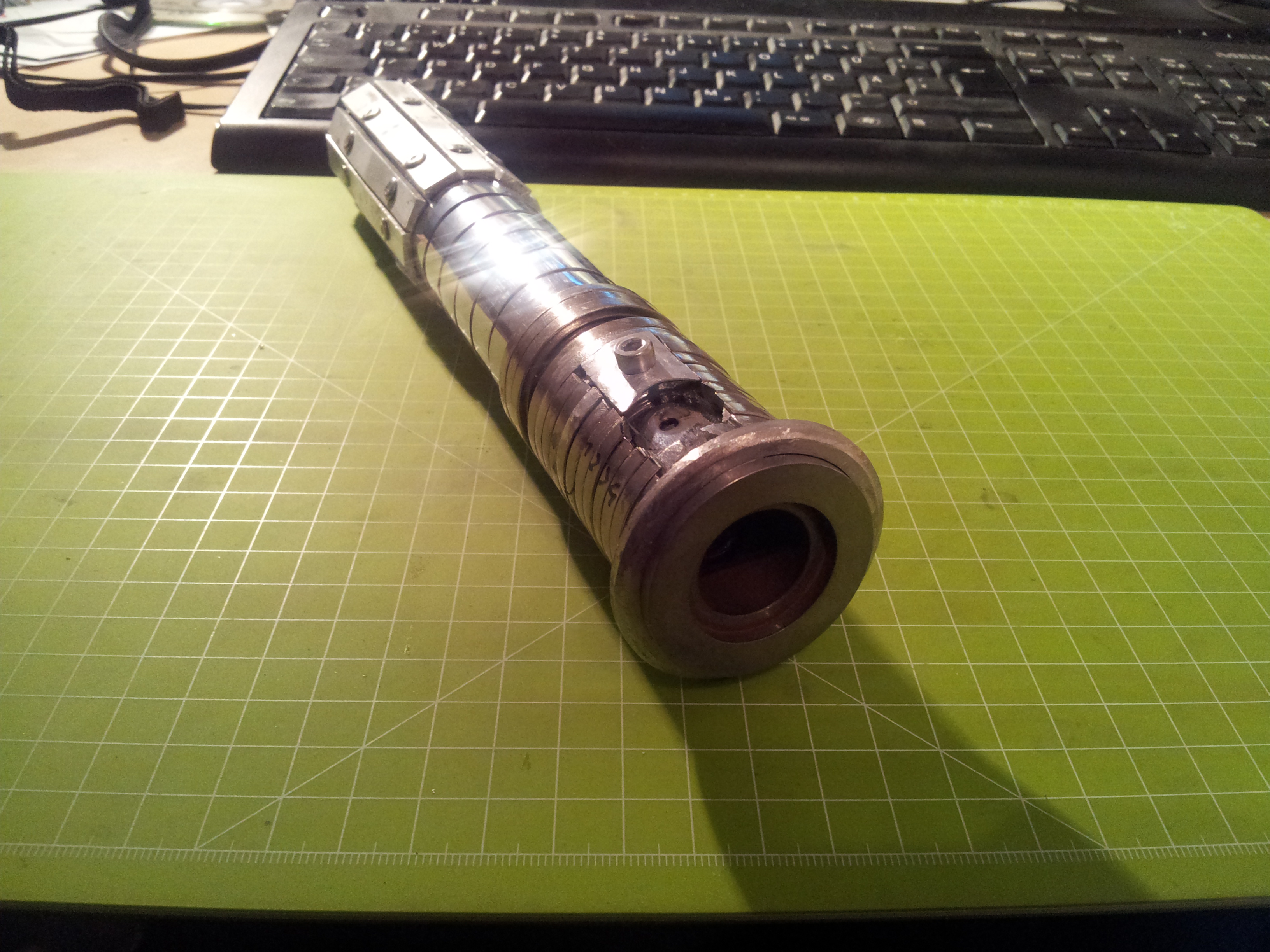

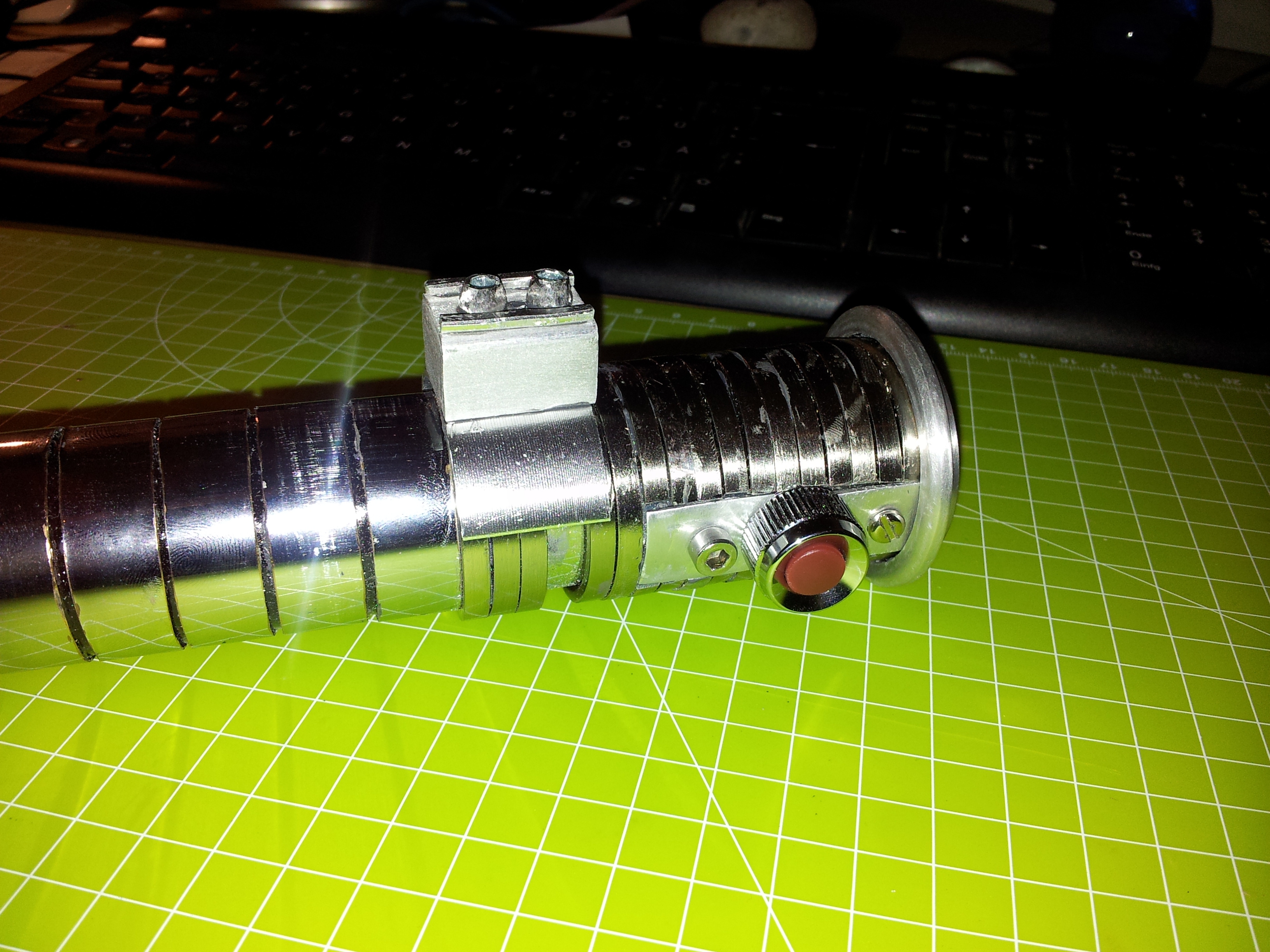

Now I used some metal rings, normally used to put up curtains, to make the tube thicker on the end where the T-tracks will be attached.
I could have glued the Graflex button in place, BUT I want to build a crystal chamber with electronics so it will be necessary to dismantle some parts from time to time.
The Graflex button will be hold by two metal plates which fit into the thread of the button and I can unscrew the plates and to put a switch underneath the button or maybe replace the switch.

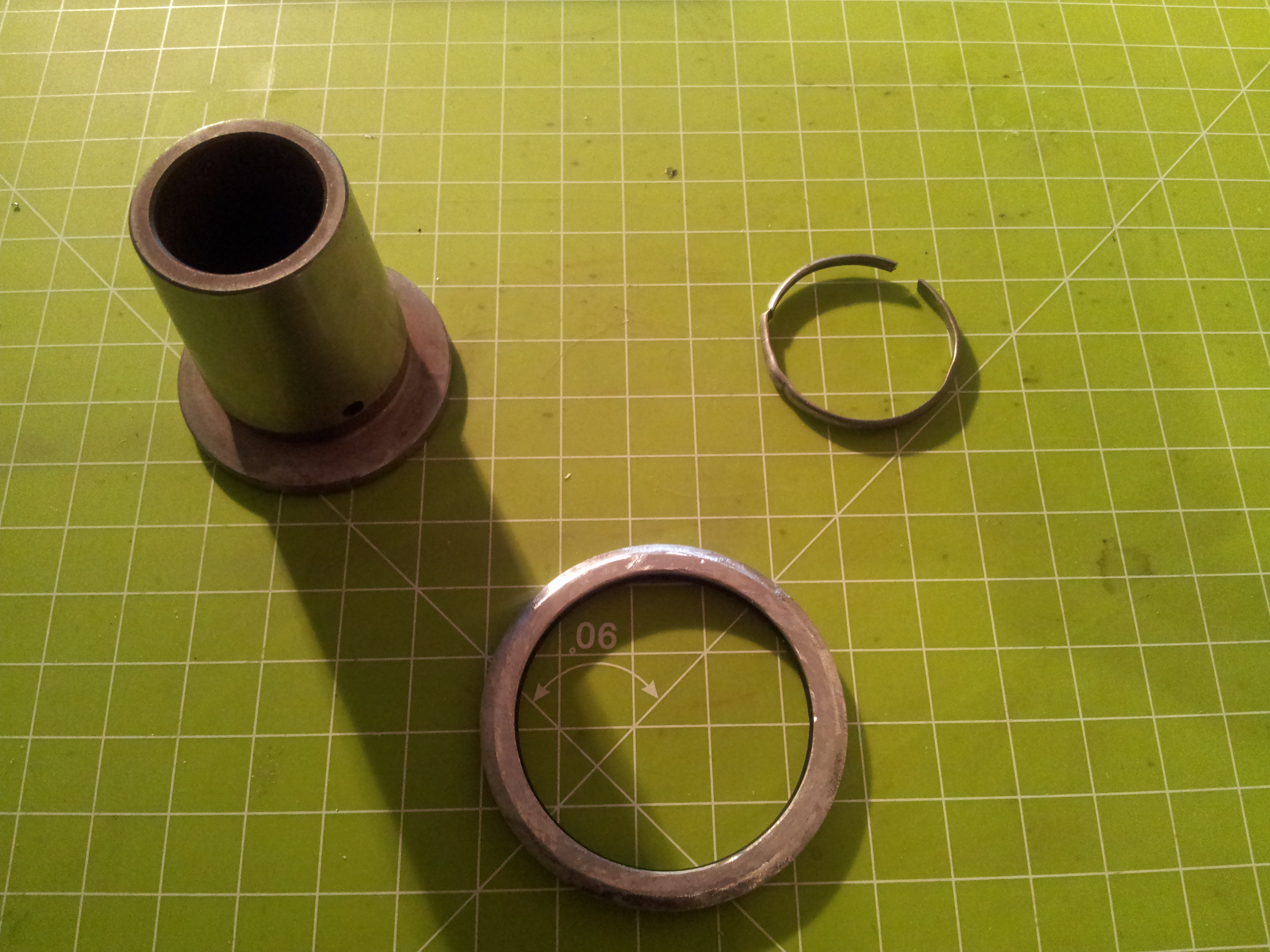

Same with the emitter I build from a vacuum flange and a scrap metal ring. One of the screws holding the Graflex button screws through the tube into the emitter part and holds it in place.

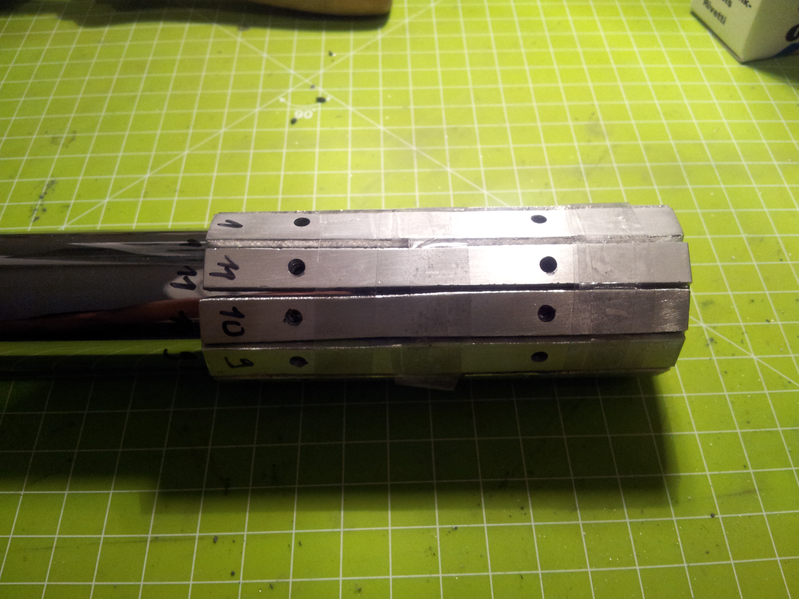

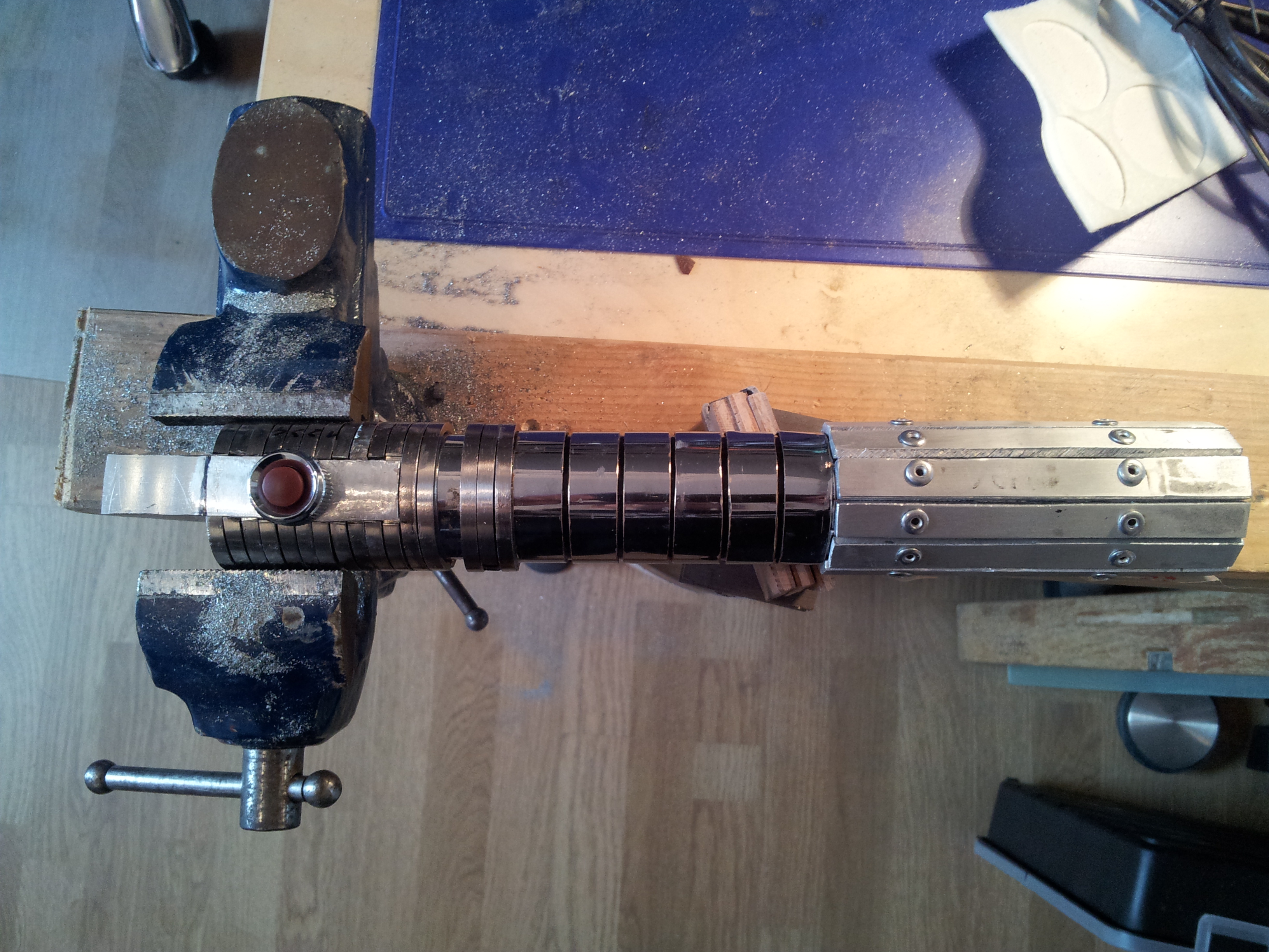

To see what I got so far I attached three T-tracks with some tape.
Will glue them the next days.

This is one of our costume references with purple blade.
Even if this saber looks like an Obi Wan Episode 1 type lightsaber ;)

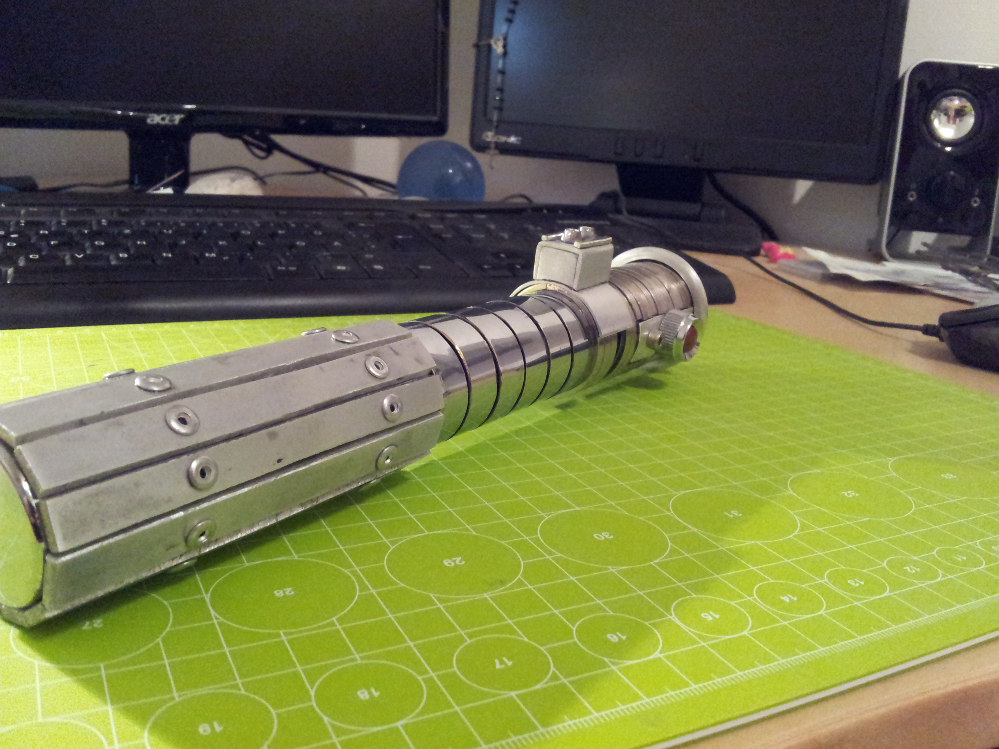

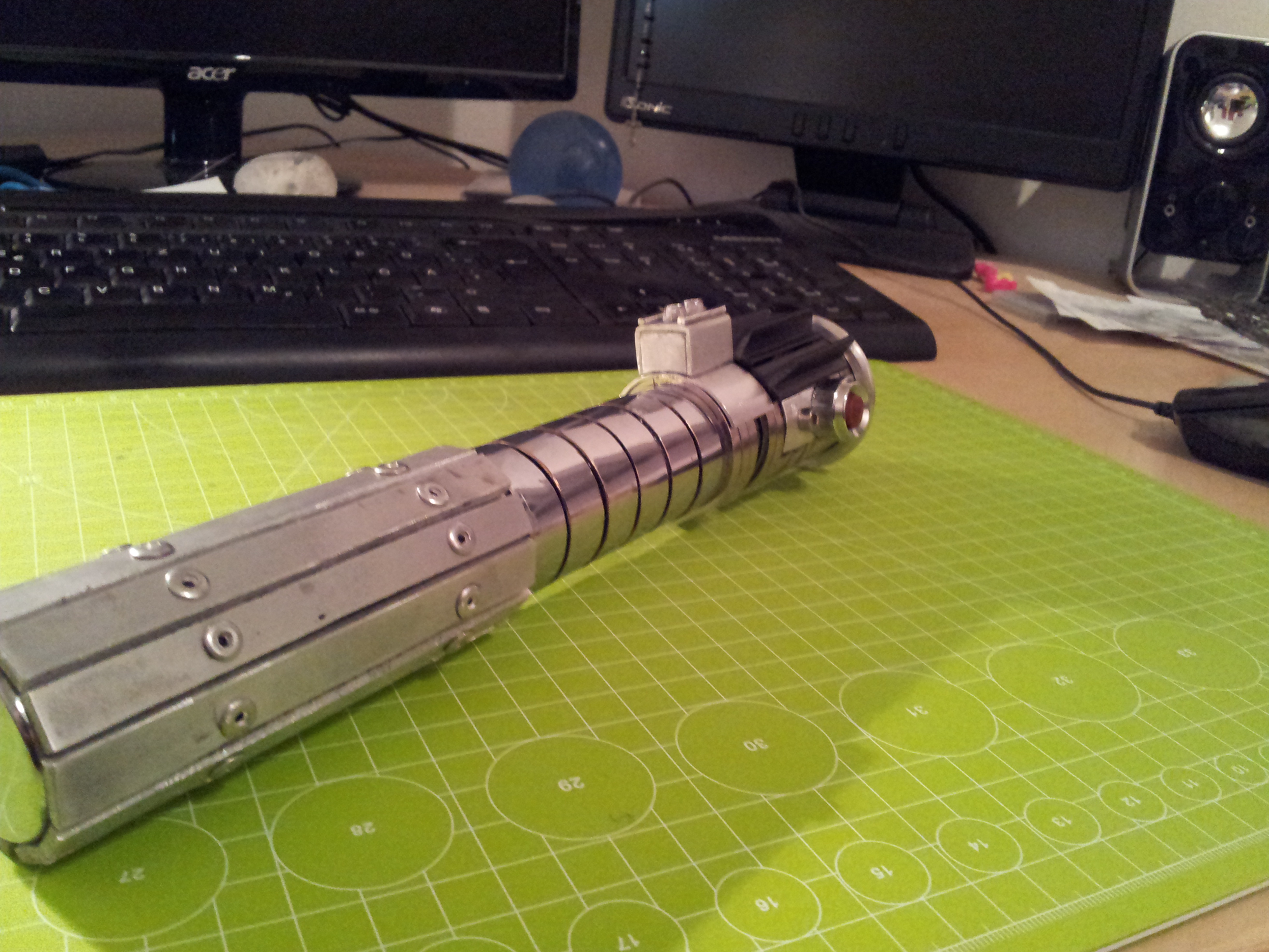

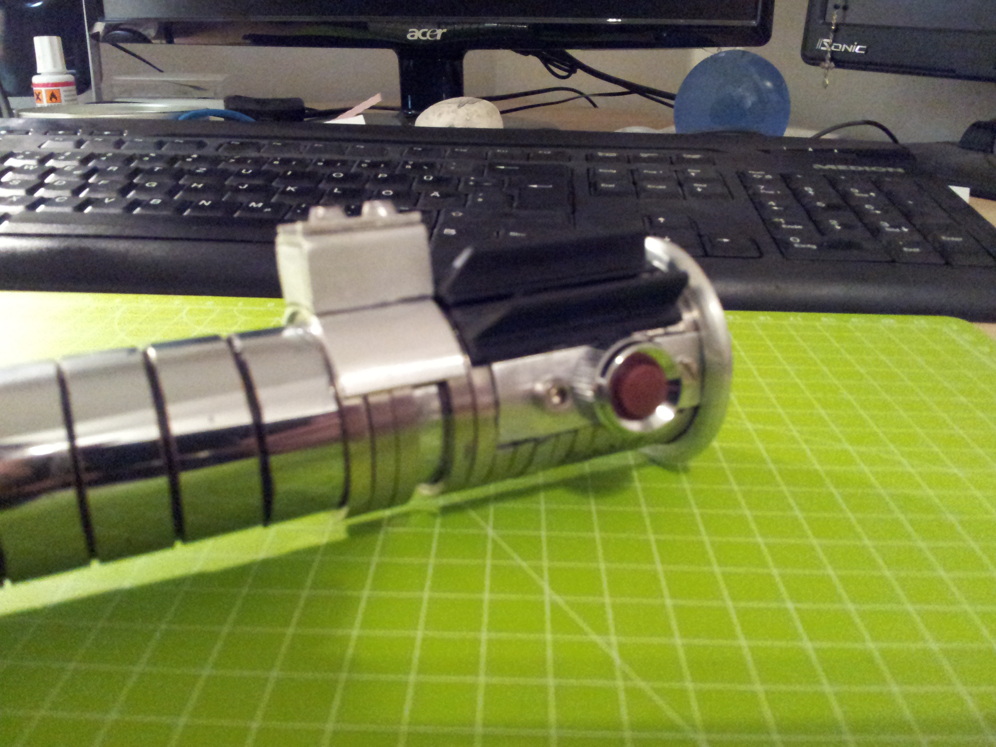

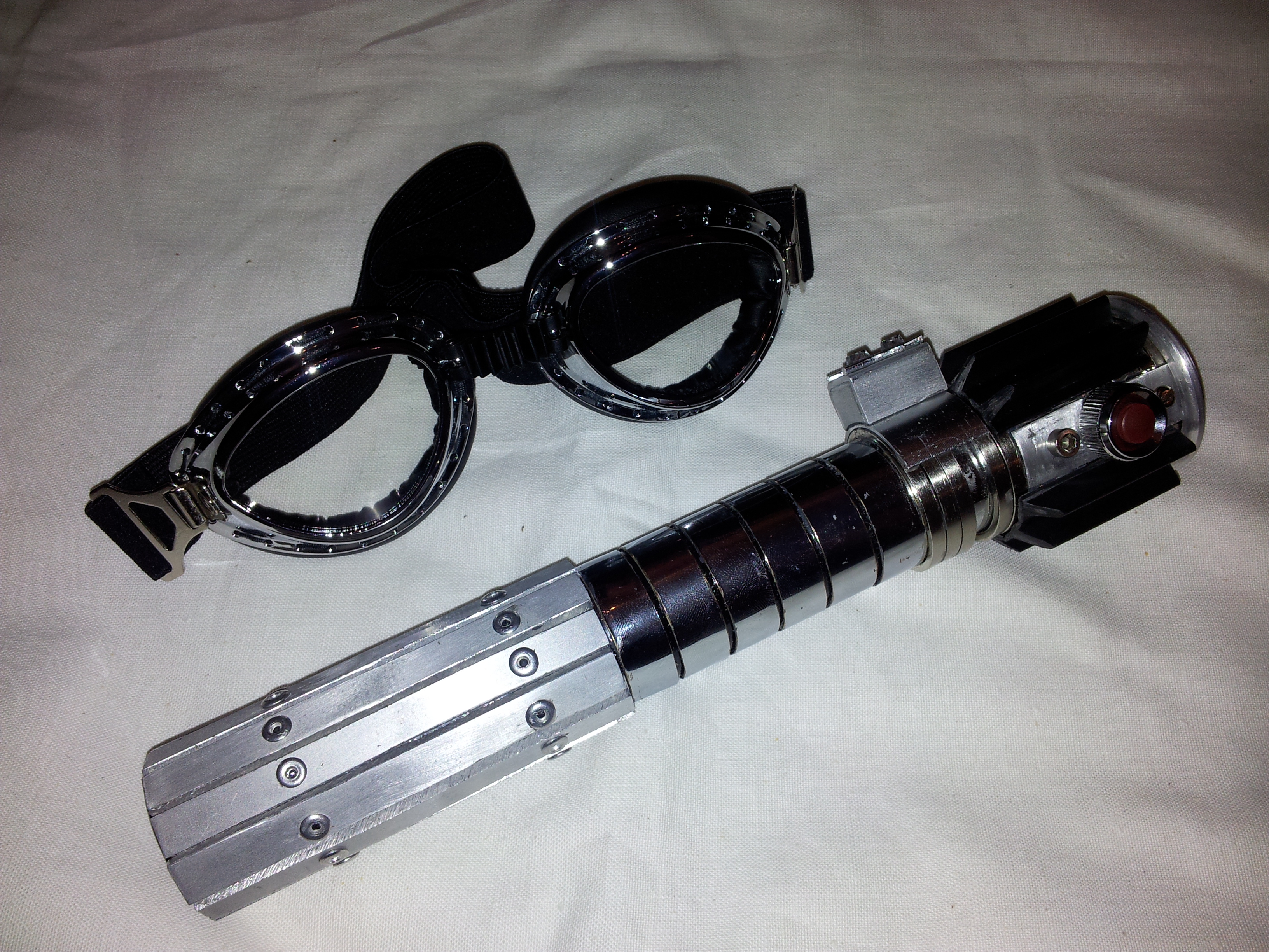

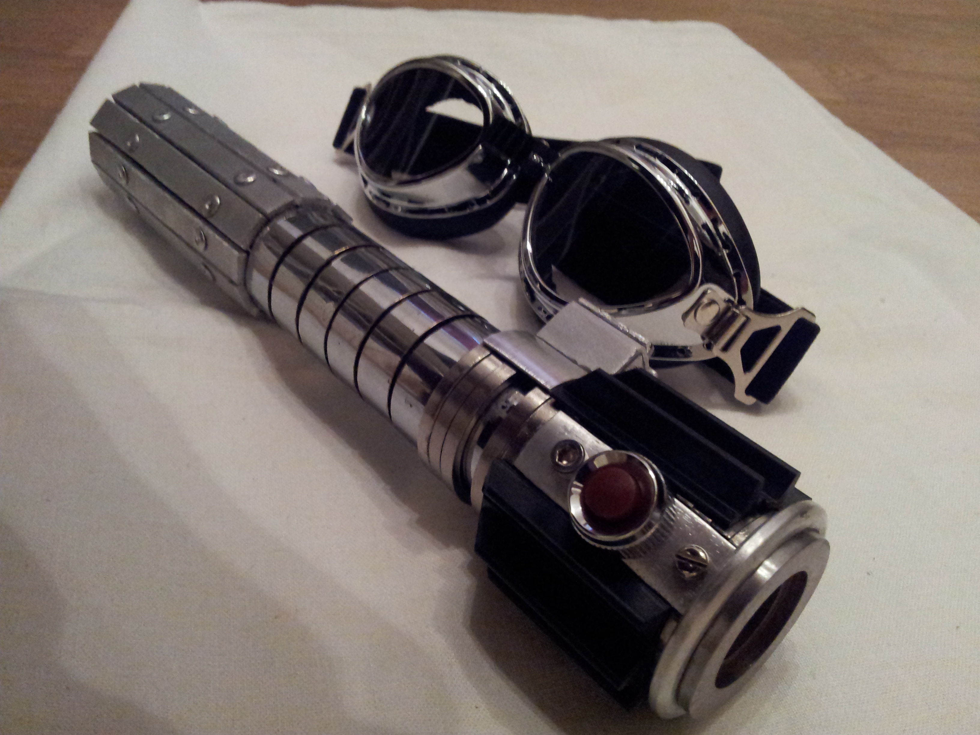

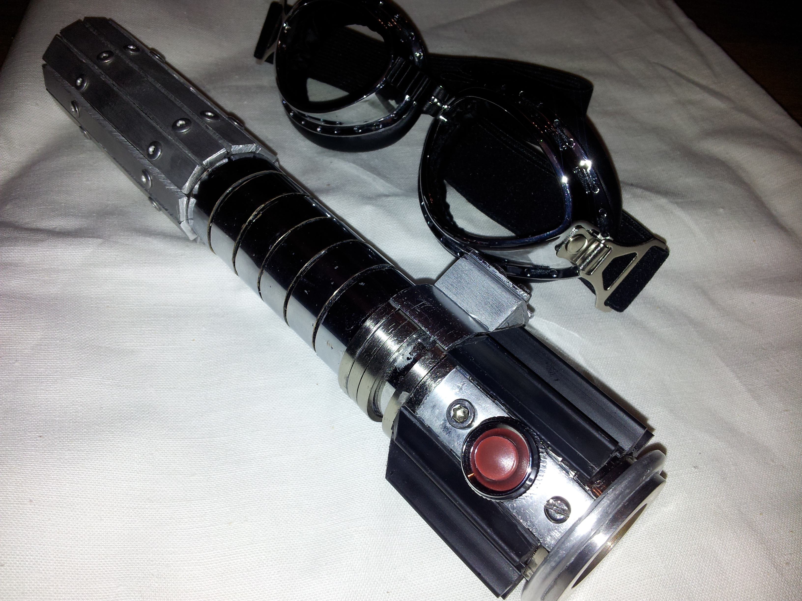

Finished it over the weekend.
Here it is next to the goggles we plan to use on the costume.
I'm very satisfied how the black T-tracks add to the look of the saber.
Next will be the creation of a crystal chamber with some light ;)

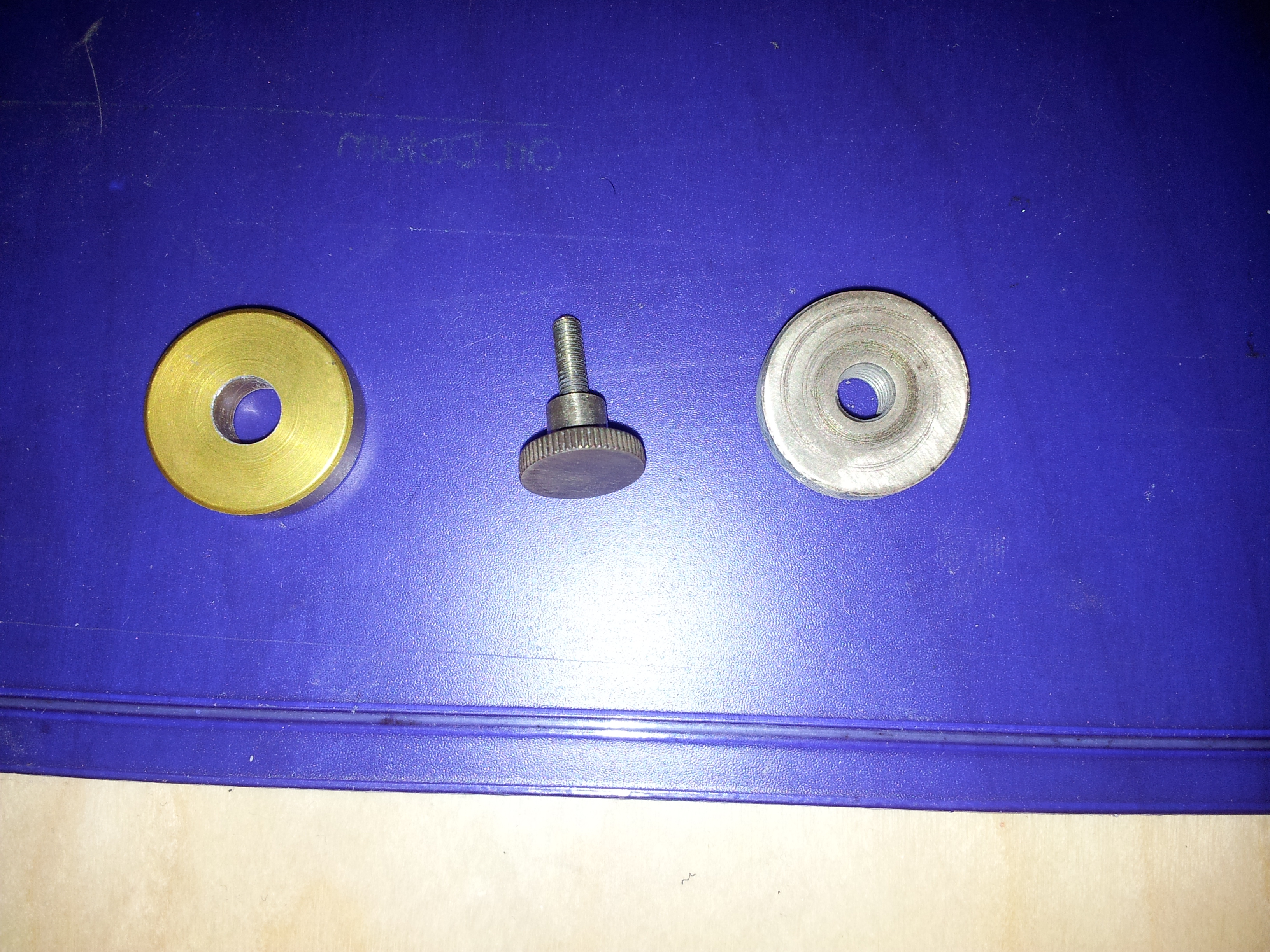

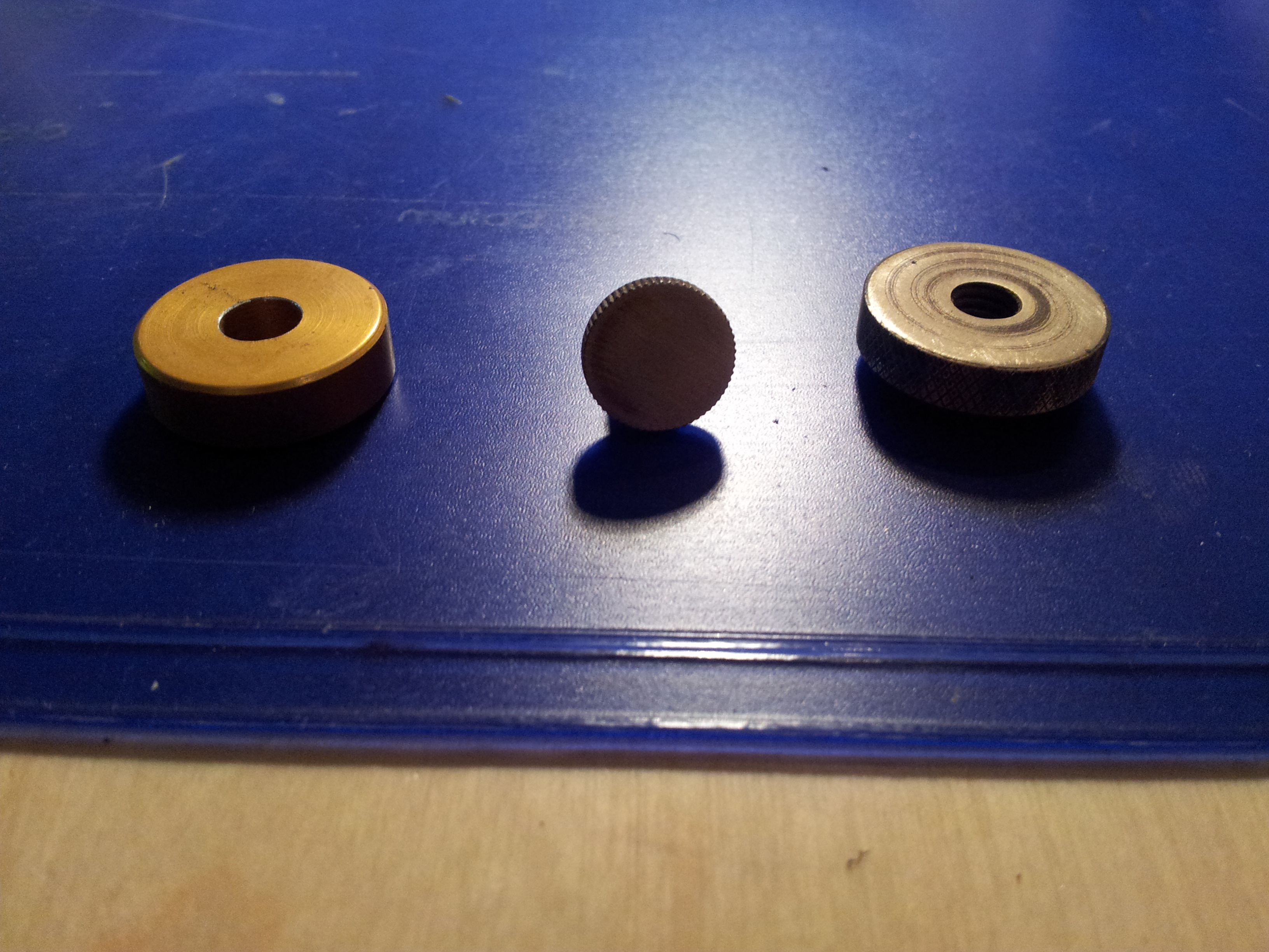

I have three pieces I could use. Which on would you guys prefer?
On the left a metal disc, only brass colored and very shiny, scratches on the surface would become silver.
In the middle my favourite. A real brass thumbscrew, smaller than the other two.
On the right a brass disc, threaded in the inner hole, so it is a kind of a thumbscrew.
Re: Custom Mara Jade Lightsaber from scratch WIP
I agree with Mara Jade's Father ... the middle one ... is quite subtle indeed :)
Chaim
Ok. Thanks.
I'll use the one in the middle.

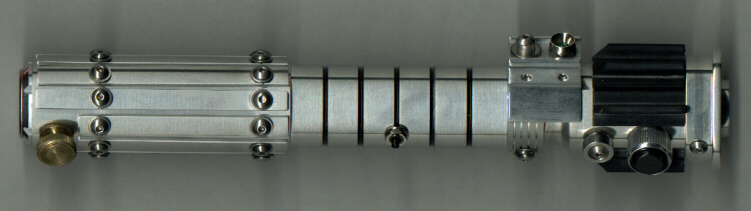

This is one I own. It is one of only five that Jeff Parks made identical to the one he made for the CCG in which this saber was first seen.
The functional purpose of the thumbscrew is to gain access to the battery compartment. You take the screw out and the pommel slides out.
