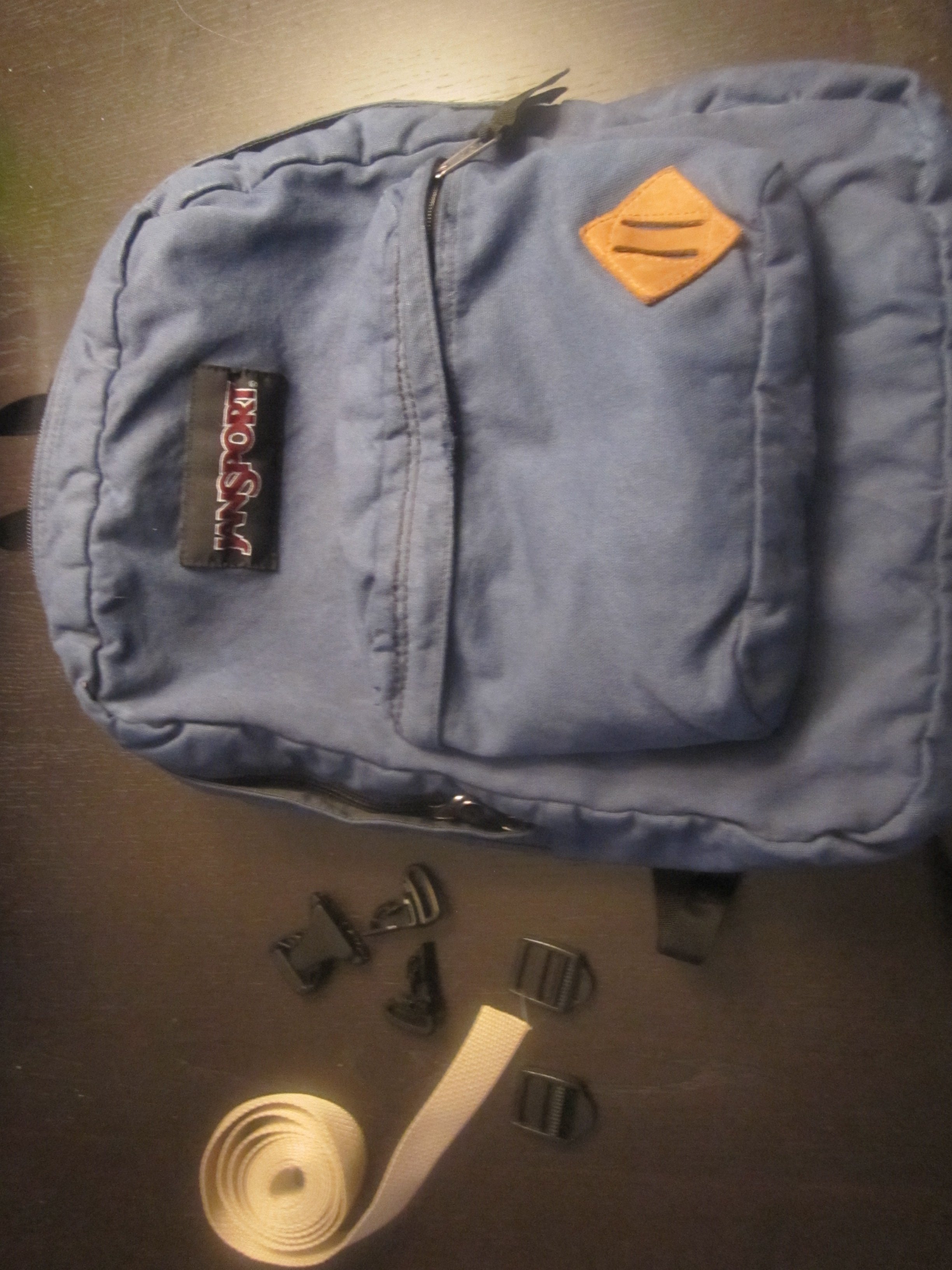

On a side note I made a Jansport bag.. bouht a black one on Altitudesport.com was like 19$ (60% off!!) and HeyJude7 told me how to bleach it and dye it in blue.
the result is just AWESOME!! im so glad!!
Wifey help me to sew the leather patch back.. and now she's installing straps +buckles

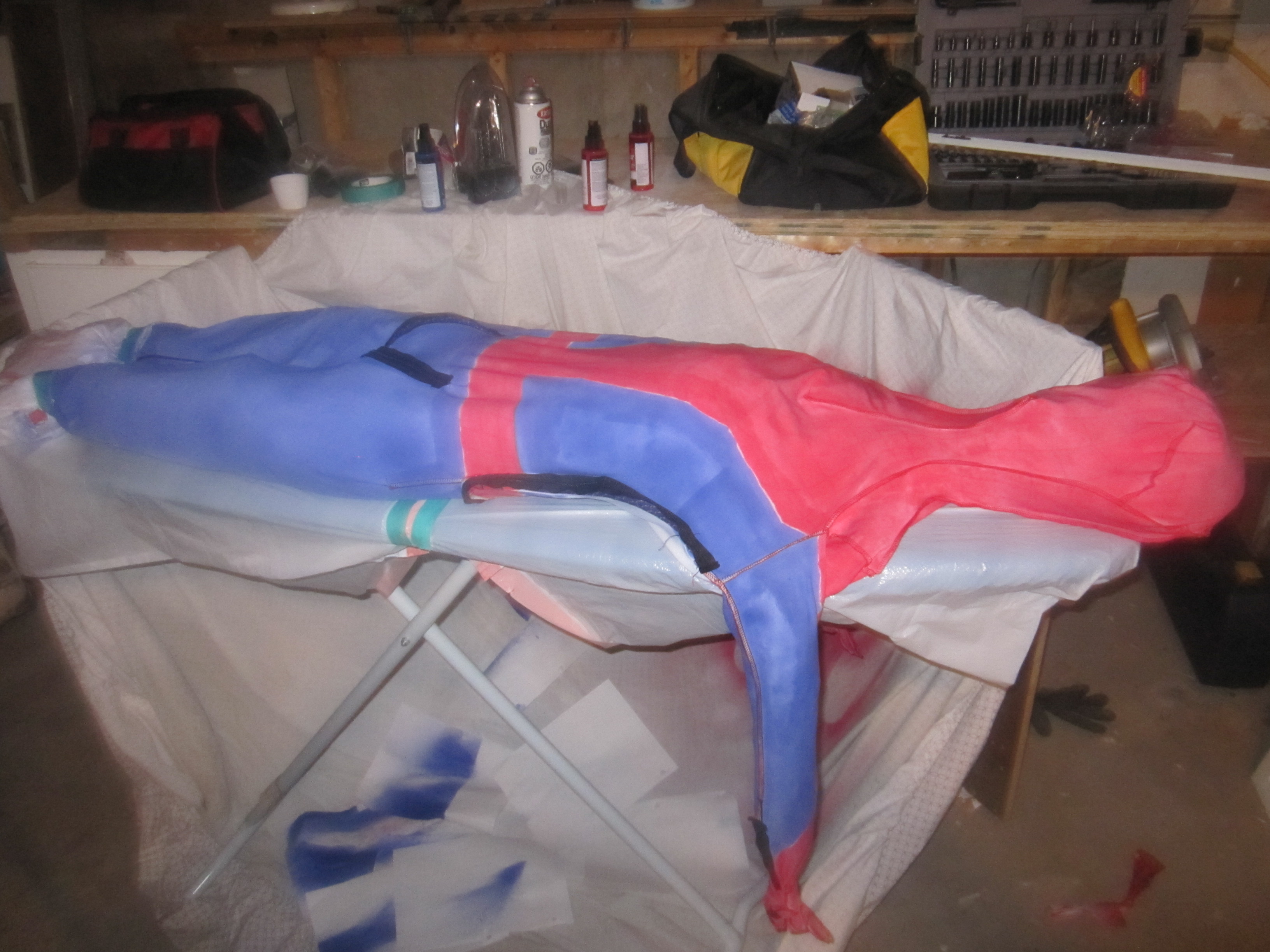

This is my progress so far.

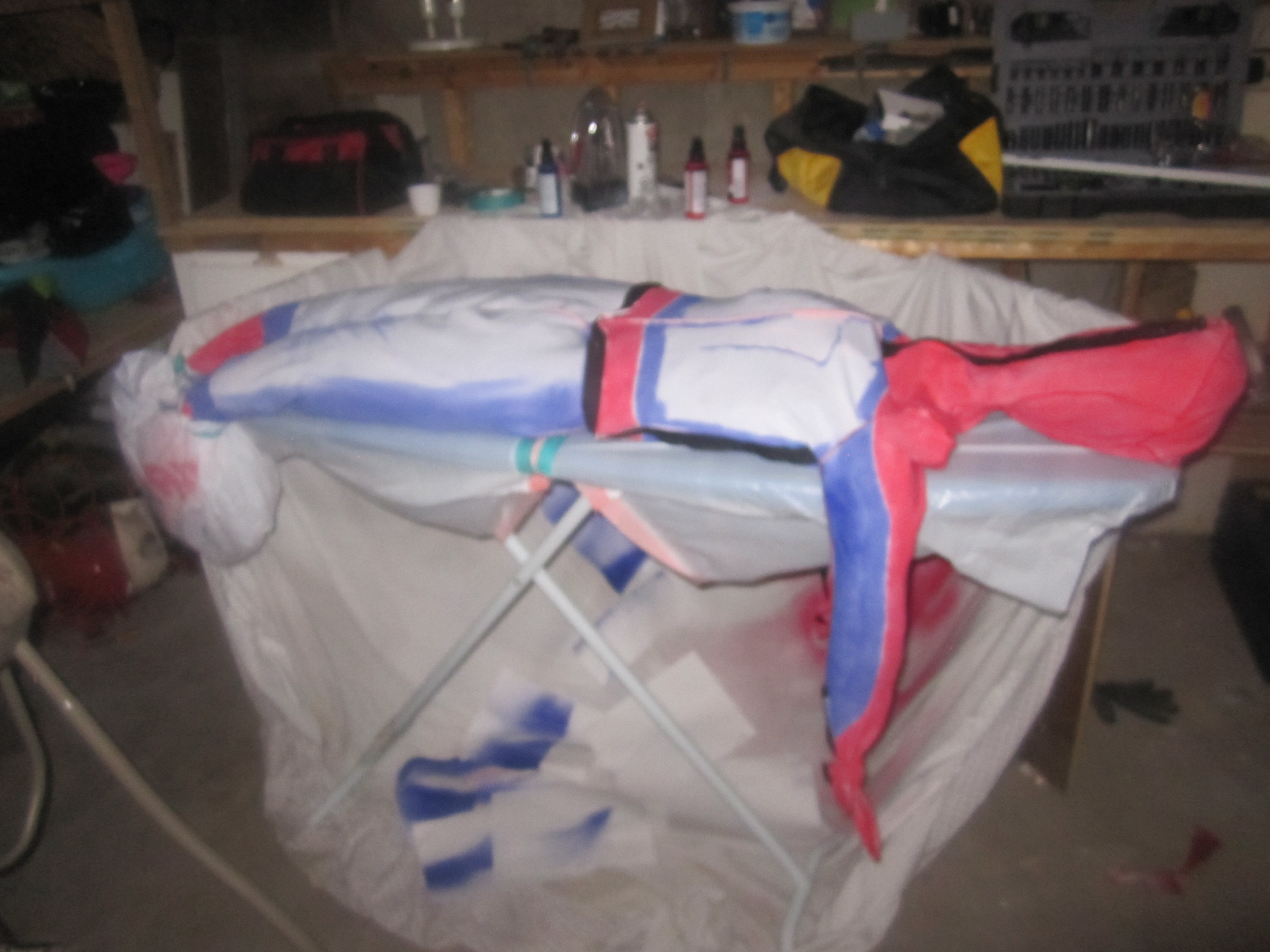

The dying process..
The Jansport bag

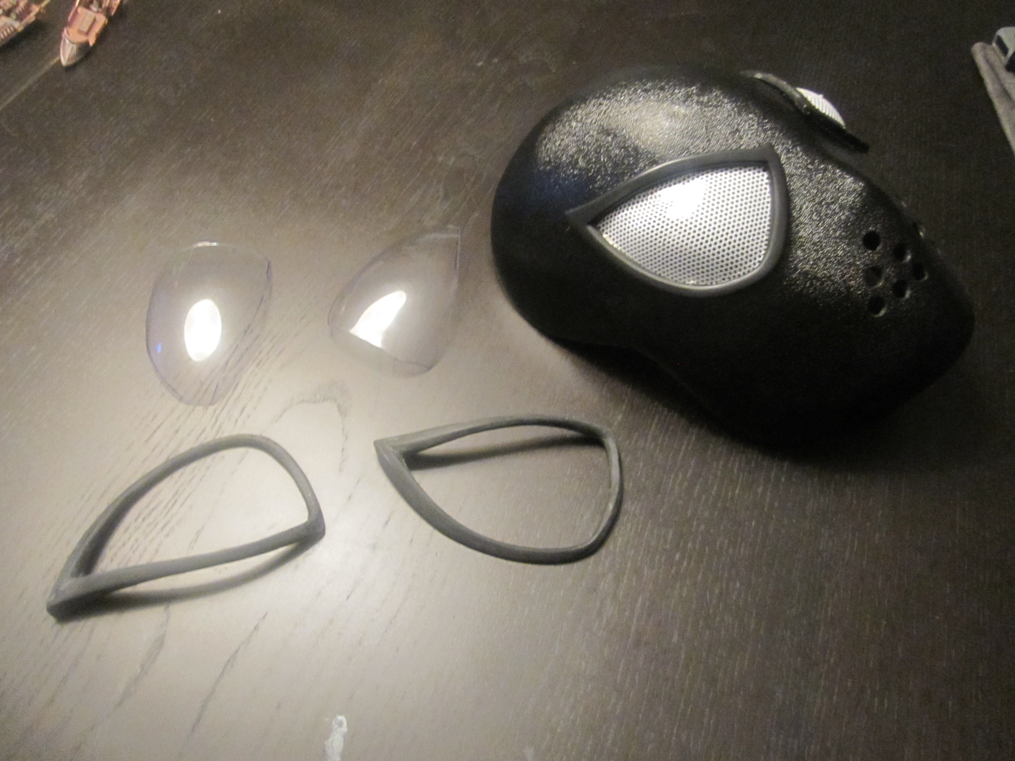

The faceshell i'm plannig to use is a budget TJack mod, with Ken eyeframe from his faceshell files.. and dome lenses with Jeck13500 tutorial
I also have a tutorial on domed lenses, incase jecks aren't domed enough, the dying look great and please paint your frames gloss black

Put the suit on inside out and spray you should be able to see the difference between the parts or hold it to the light
U only have to stretch the fabric to see if its work... as u are dying the whole fiber of the fabric.. u arent suppose to see any white if its saturate correctly....
and for the frames......... sure i will paint them........ they are only sand at this point on the picture.. because my 3dprinter dude did a terrible job on them

Alright, so i simply use a brush to apply as u can see on first picture.. so i could delimit pretty well blue and red section. Then i used the spray applicator to fill the parts out..
If u apply generously enough.. which i didn't u might need only one layer.. i left a few spots so i'll have to do more a little..

I did a test suit this morning as i was aware of being all blue and red after wearing it........ and Hourra!! everything holds pretty well!
AND the most important no more fading!!

it does tint a lil those white lines.. in light blue.. but u still see pretty well the brick pattern.
I'm reeeeally glad with the result! now when im stretching the suit it doesnt fading or blemish at all
