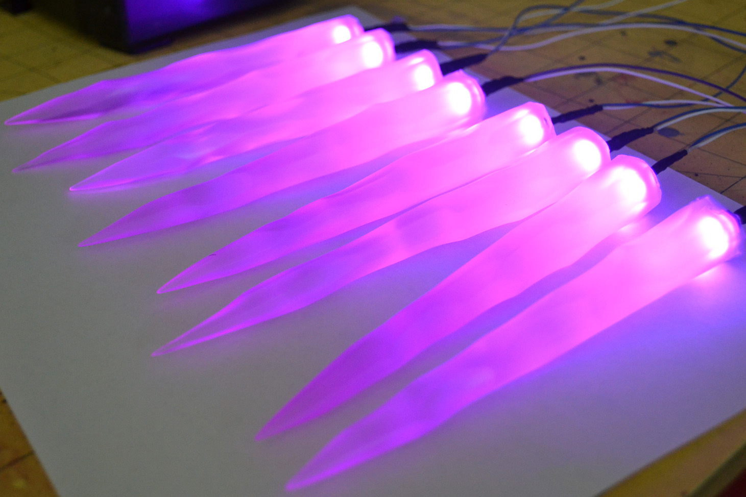

How do you intend on getting a glowing crystal effect on the needles? Casting each needle in clear resin with a pinkish white led in the bottom?
I will be using the same electronics as volpin has done in his needler but I will be using different products, and yes that is how I will do the needles but I have also bought some white leds to see the difference in colour shift it would give the needles rather than using pink. As I am going to do it up like the halo reach version and not the halo 4 version the needles are slightly brighter and less pink/purple. I'm going to try and do it up to volpin's standard and raise the bar a bit because he is missing a few details I would of added.
