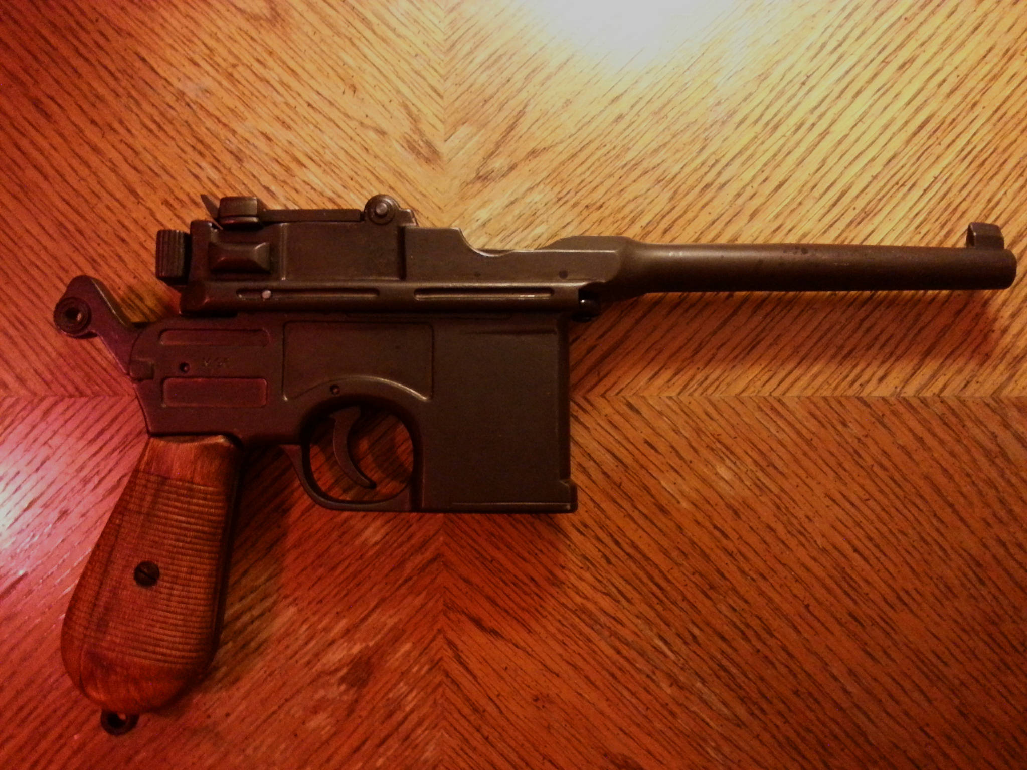

Denix Mauser To be refinished, with more accurate details milled in via BobaDebt's service.

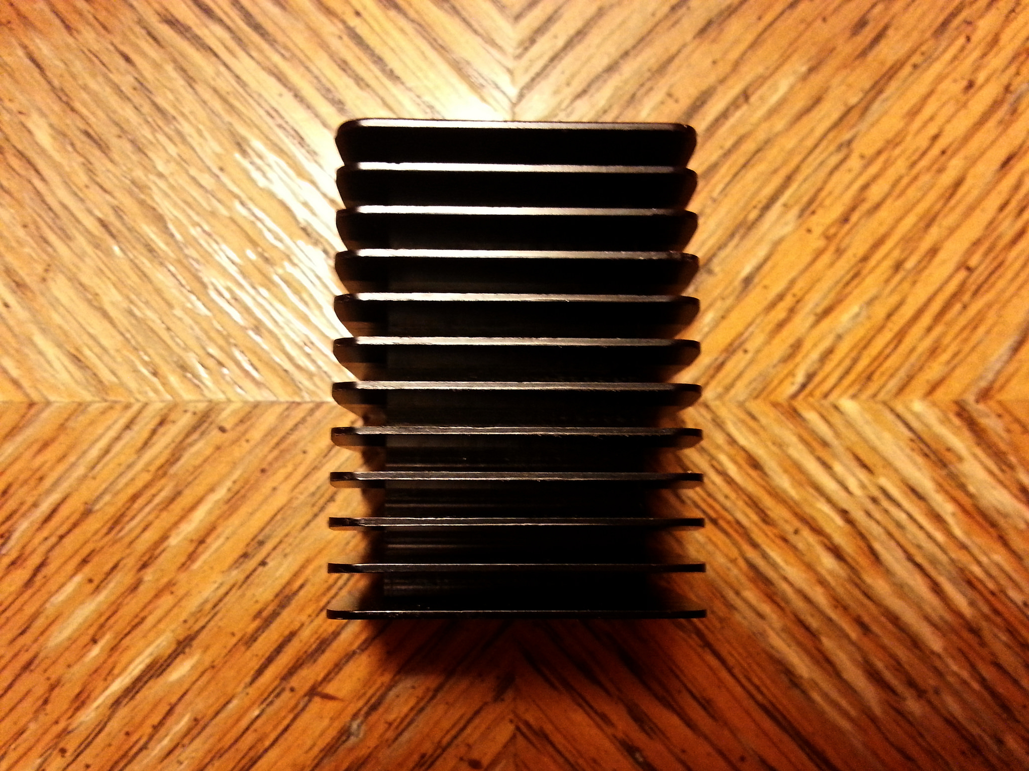

Corellian Exports Aluminum Grill ... This one has 12 fins rather than the correct 11, but it doesn't bother me enough to want to hunt down a new one just yet.

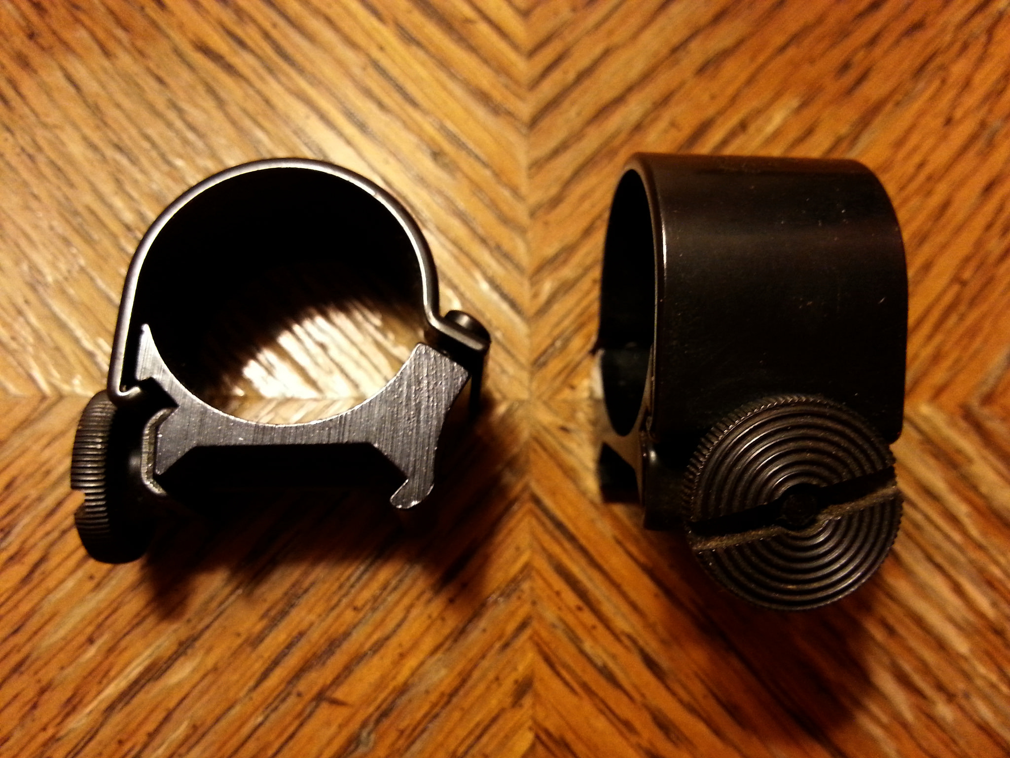

Vintage Weaver 1" Scope Rings ... I've seen other variants of these, one of which is slightly lighter and bluer, and doesn't have any lettering stamped on top. I think I might prefer that version to these, so I might look to replace them soon, but for now:

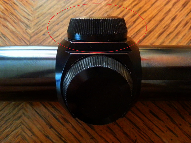

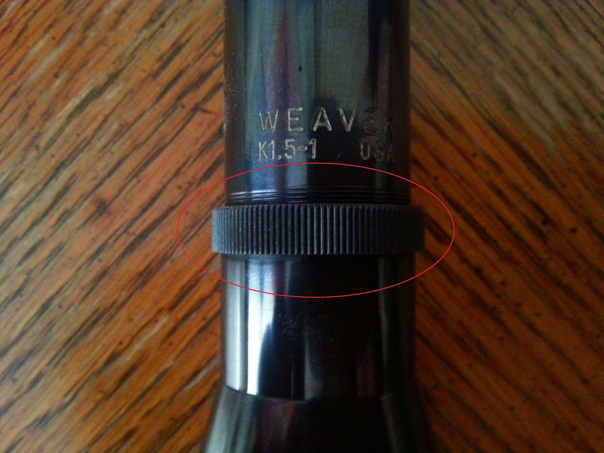

Aditionally, I've realized that this K1.5-1 has subtle differences to others I've seen used in GK builds or for sale on eBay that make it even closer in appearance to the Compac Super. For example:
The Knurled ring towards the front of the scope is closer in shape to that of the Compac.
Also, the knurling on the adjustment knob caps is closer to that found on the Compac Super:

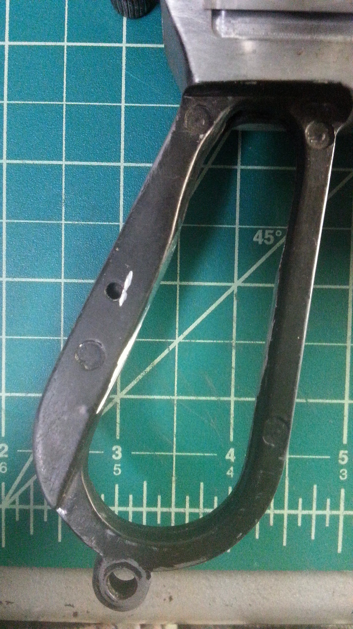

I've also begun widening the gap between the grip and the trigger guard, as I've seen Scottjua do this on several of his Denix builds and it seems to make a big difference. It still needs a bit of shaping and some buffing:

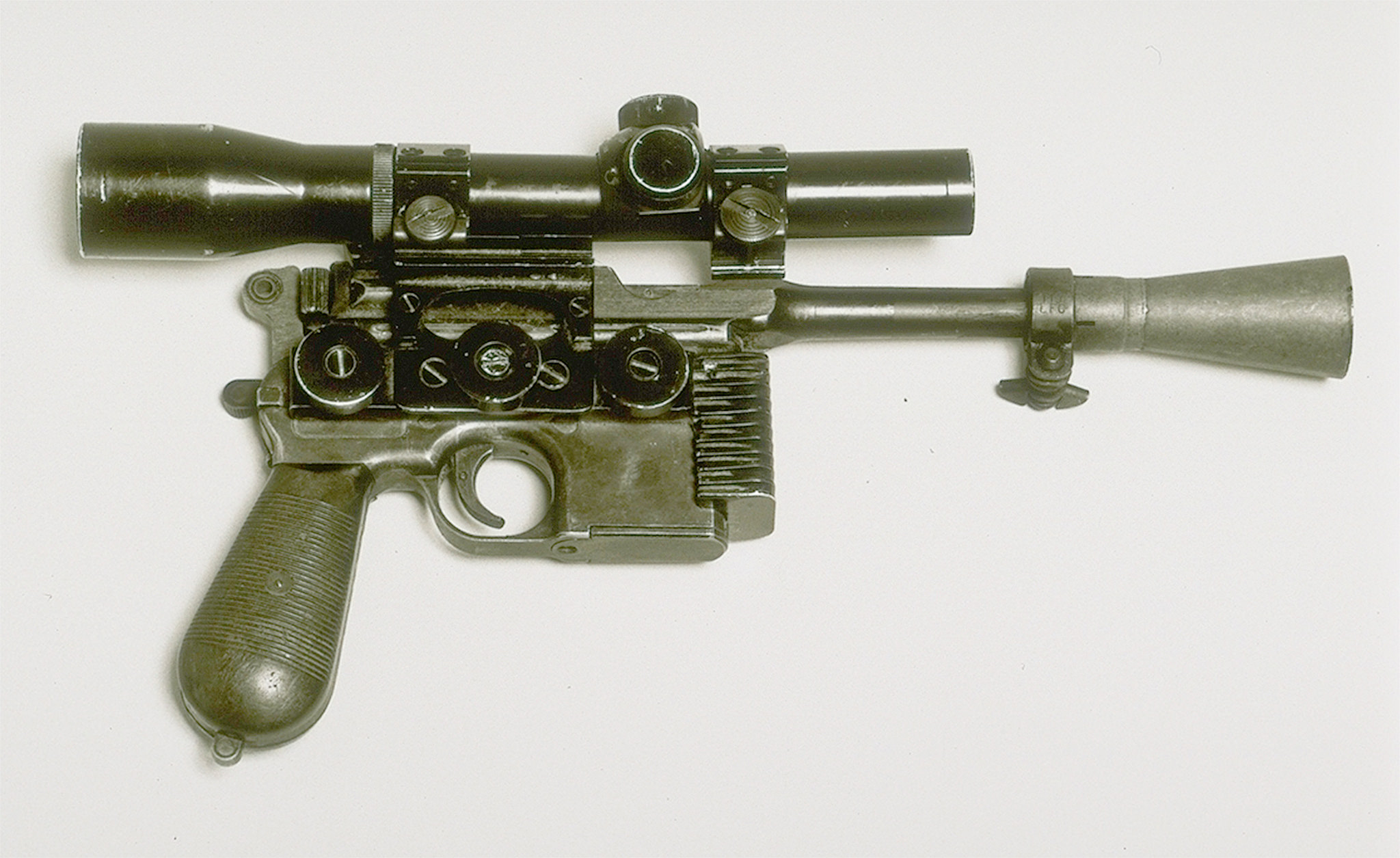

Thanks for the kind words as well! There's a pretty interesting story behind the Hero prop vs. the Greedo Killer ... they were actually two different guns all together that were used while filming A New Hope. The Hero prop was originally intended to be used as Han's blaster for the entire film (save for any resin stunt versions), which was shot over in the UK. The Greedo Killer however is the gun that is seen when Han draws his blaster under the table at the Mos Eisley Cantina to shoot Greedo. Most of the Cantina scene was shot in the UK as well, but the closeup shots of Greedo that feature his articulated head, and the aforementioned shot were filmed later in the US (with a different actor as well, who happened to be female!). Because of strict gun control laws, they were not able to fly the hero blaster over to the US for these remaining shots (since that verion was a real, live-firing Mauser), so the prop builders in the US had to build their own quick interpretation of the hero blaster for use in this very quick shot, and they based it on a Japanese Replica Mauser. The GK was also used for some promotional shots that were taken in the US. If you look closely, practically everything about the GK blaster is different to the hero blaster. I suppose the intent was just to create something close enough for a quick shot, but they never could have imagined the amount of scrutiny under which these blasters would later be placed by fans like us ... hah! I personally chose to create this version because it is the version that most clearly stuck out in my head as Han's iconic blaster when I imagined it as a kid ... I still don't know what material I was referencing at the time, but this is the blaster I always wanted to brandish.

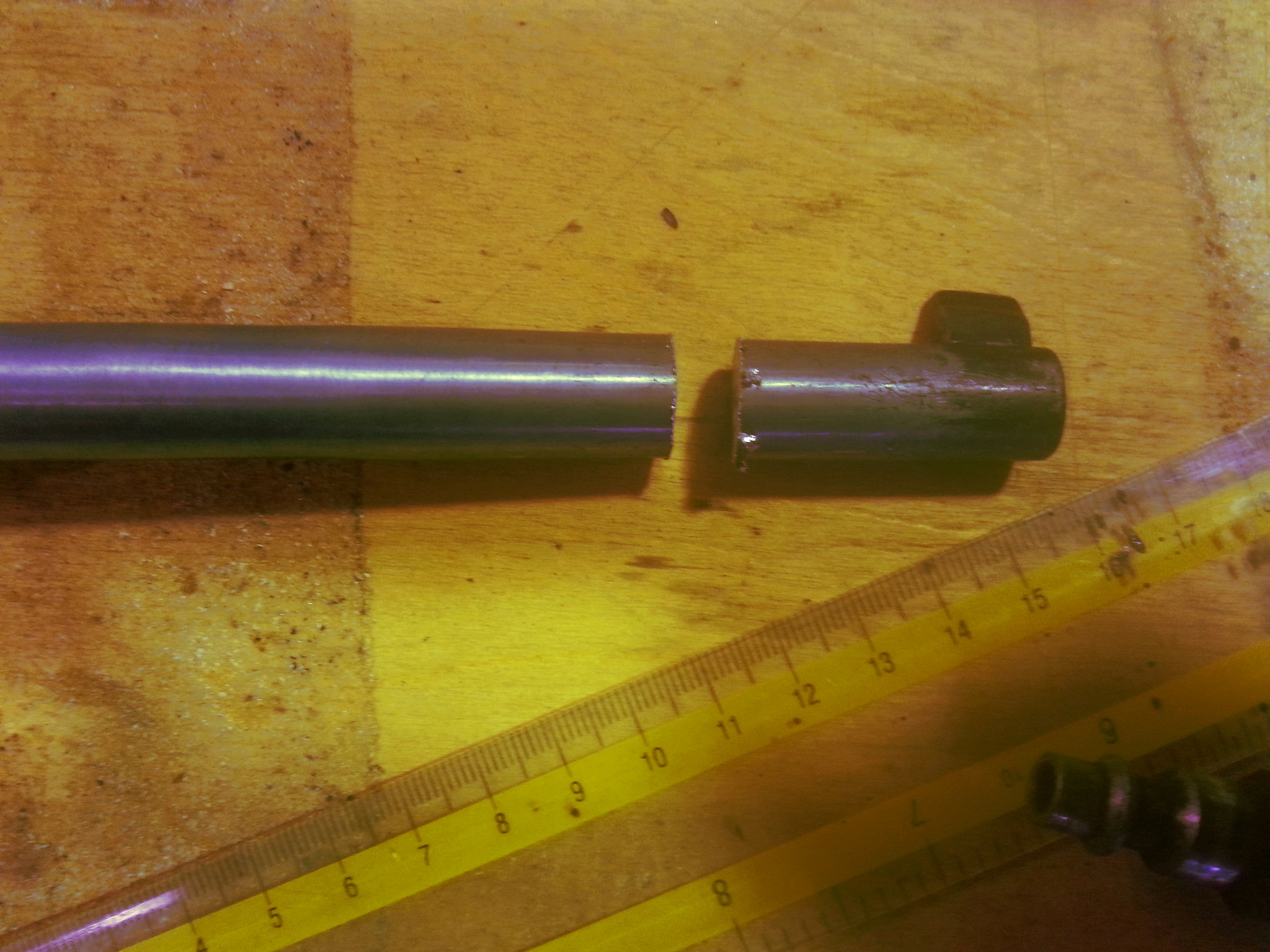

Took the plunge and chopped the barrel. We scaled it to the screen-used GK photos as best as we could with just my phone screen and a ruler ... I think it looks close enough. Plus, there is a little leeway with the flash adapter ... you can cheat it backwards almost half an inch (which is nice) so we tried to cut a bit long if anything. What do you guys think?

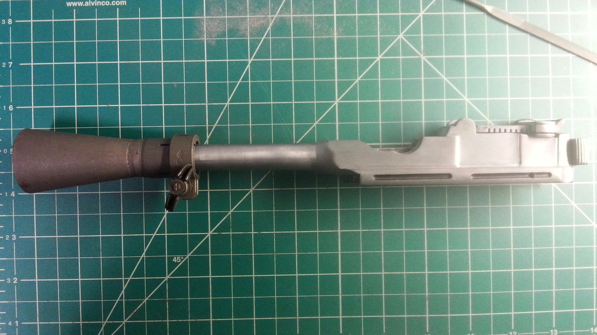

Mounted on the upper:

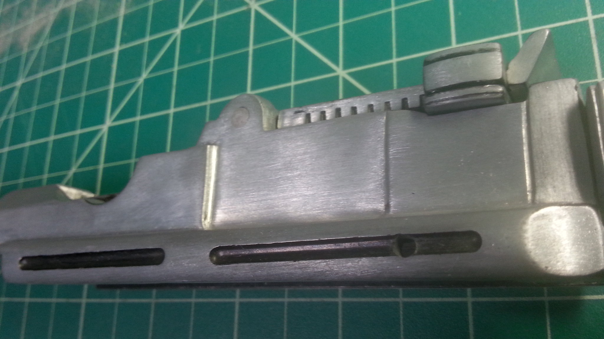

Here's a closer look at the state of the Denix ... Most of the pitting is gone. I've been lucky so far and have hit minimal air bubbles. I'll rough it up a bit before attempting to use the Aluminum Black:

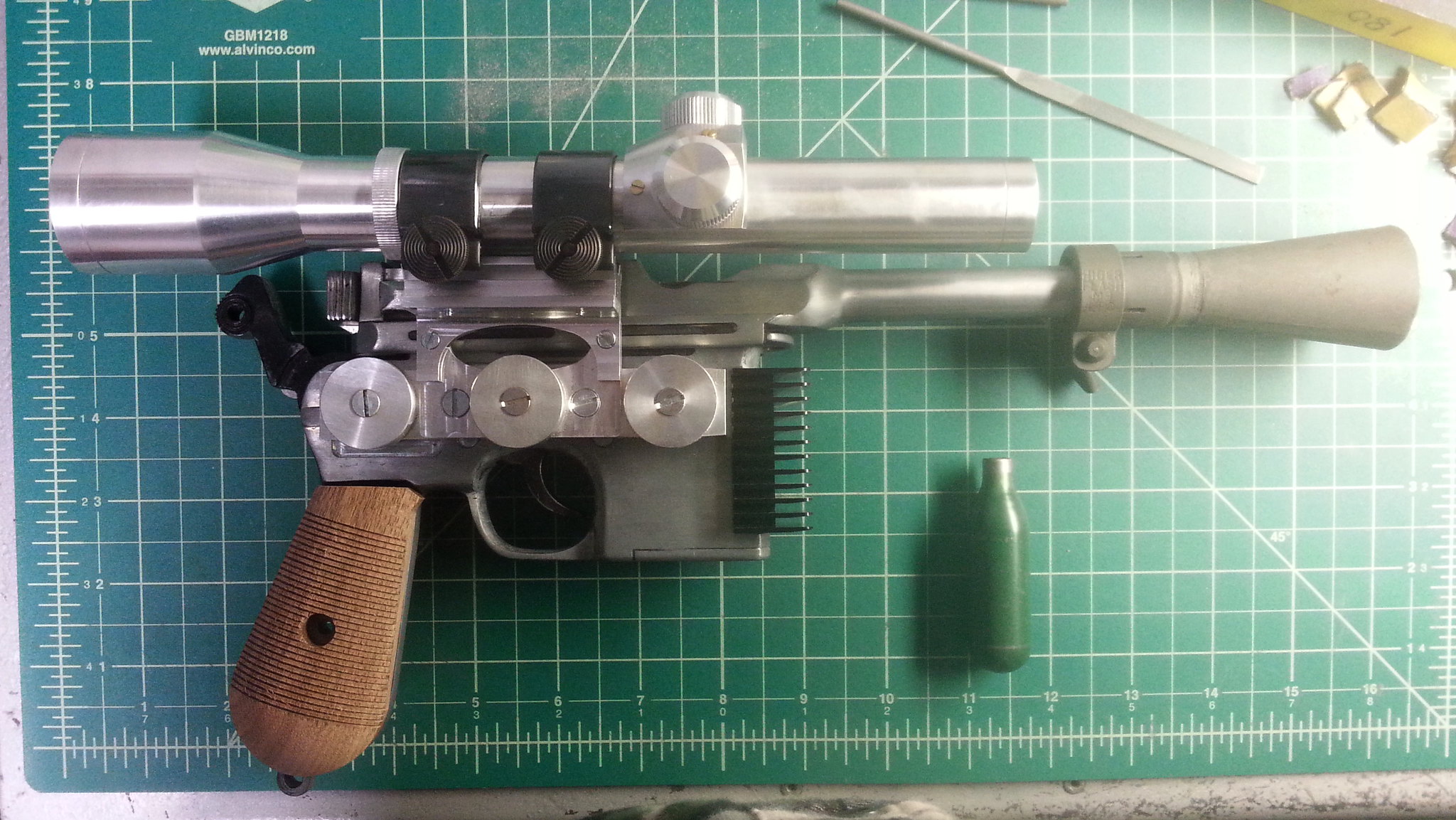

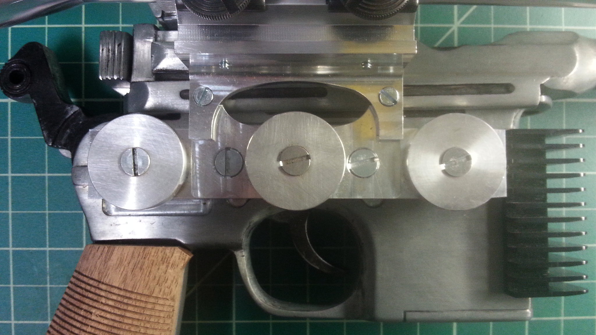

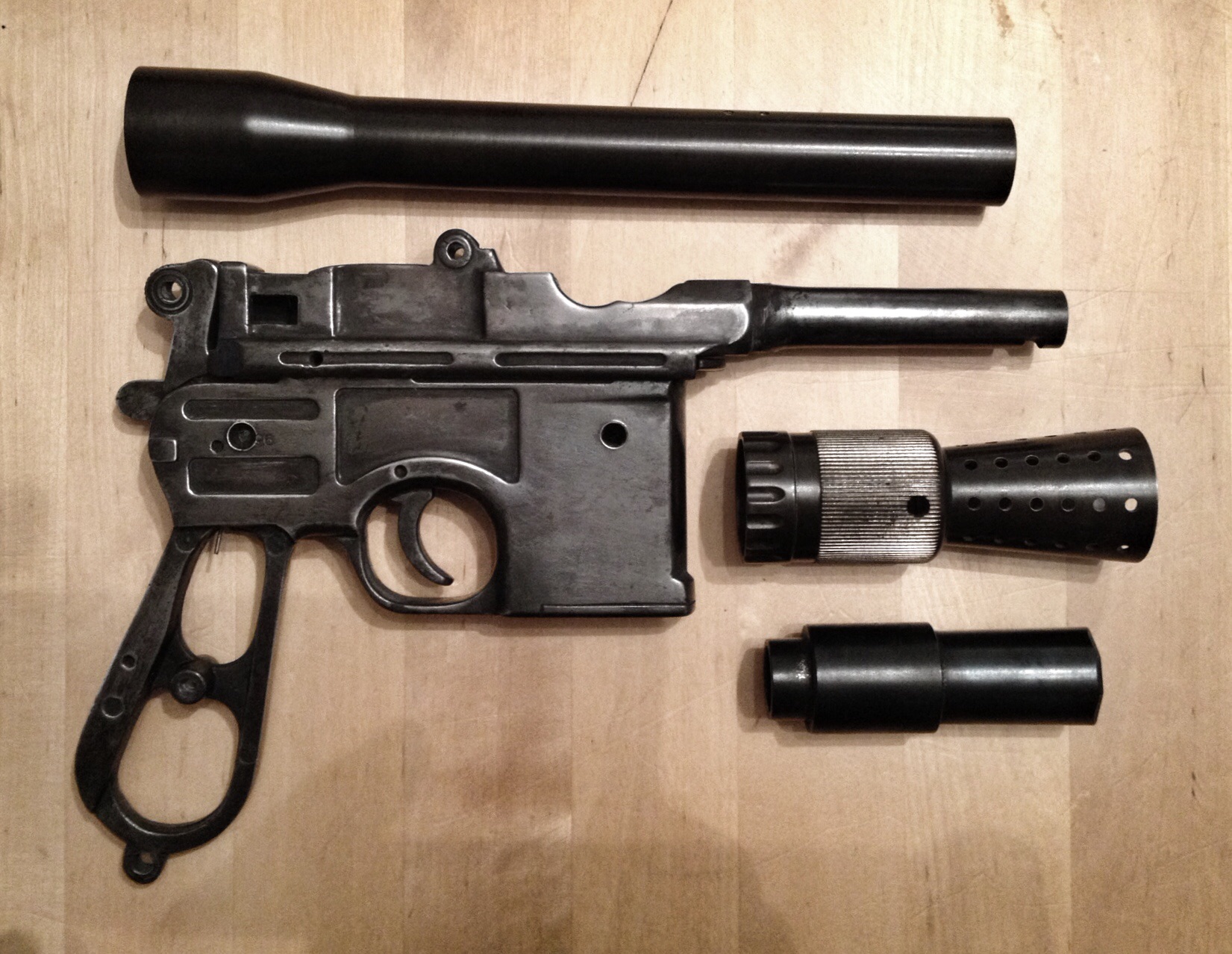

It's still in pieces, just figured I'd lay it all out and see how it's shaping up ... It's finally looking like a blaster! These machined parts are number one ... thanks Aaron & Scott!
Hoping to get everything finished in time for TFA ... we'll see though. Still need to do a bit of reshaping and sanding of the Denix, refinish it, paint the machined parts, get the grips fitted/stained, maybe reshape the trigger, etc. Stay tuned!
