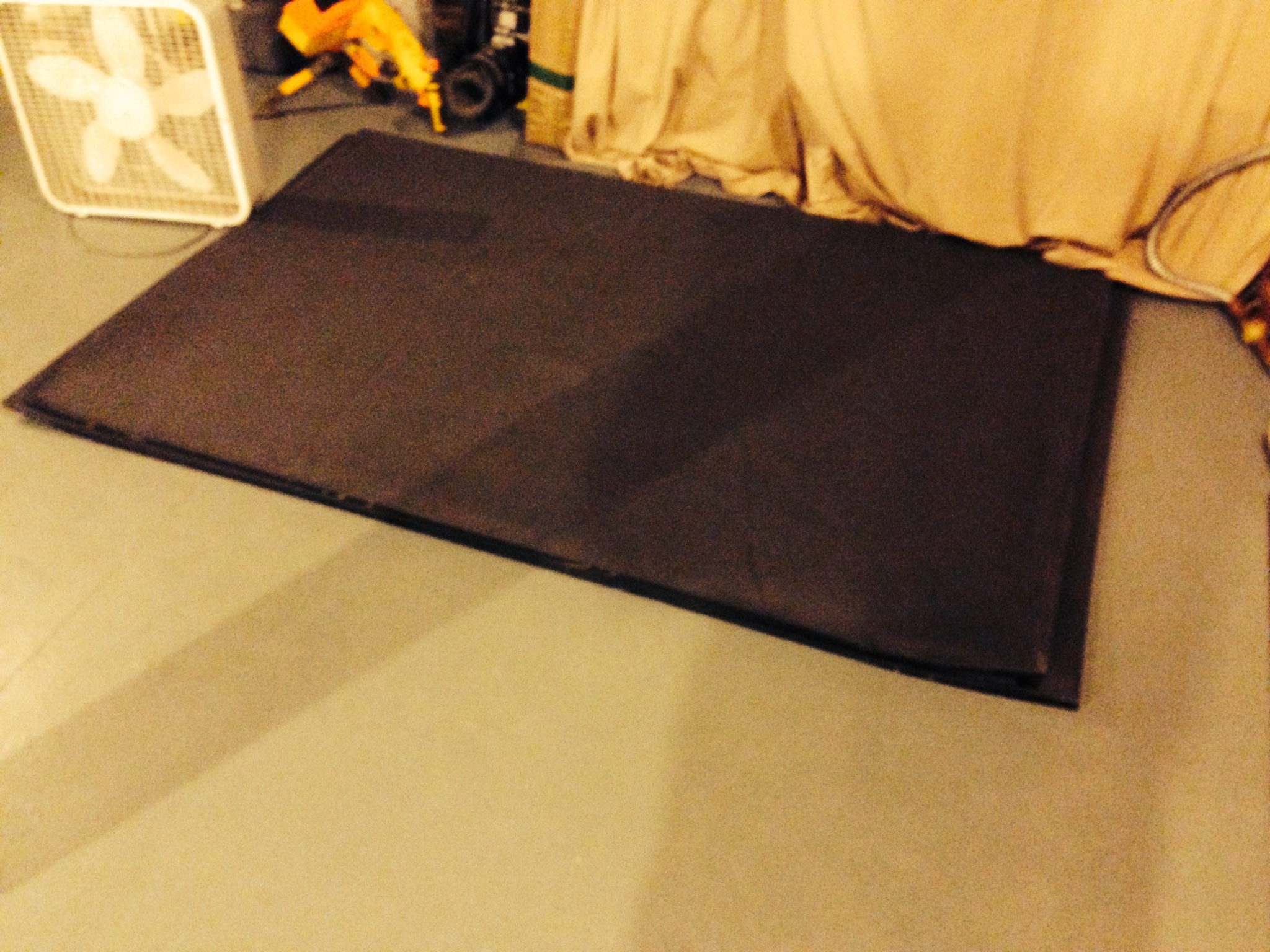

I've already ordered and received my first order of foam from here. I went with 1/2" thick and bought three 72" x 48" sheets to start with, which cost a little over $100.

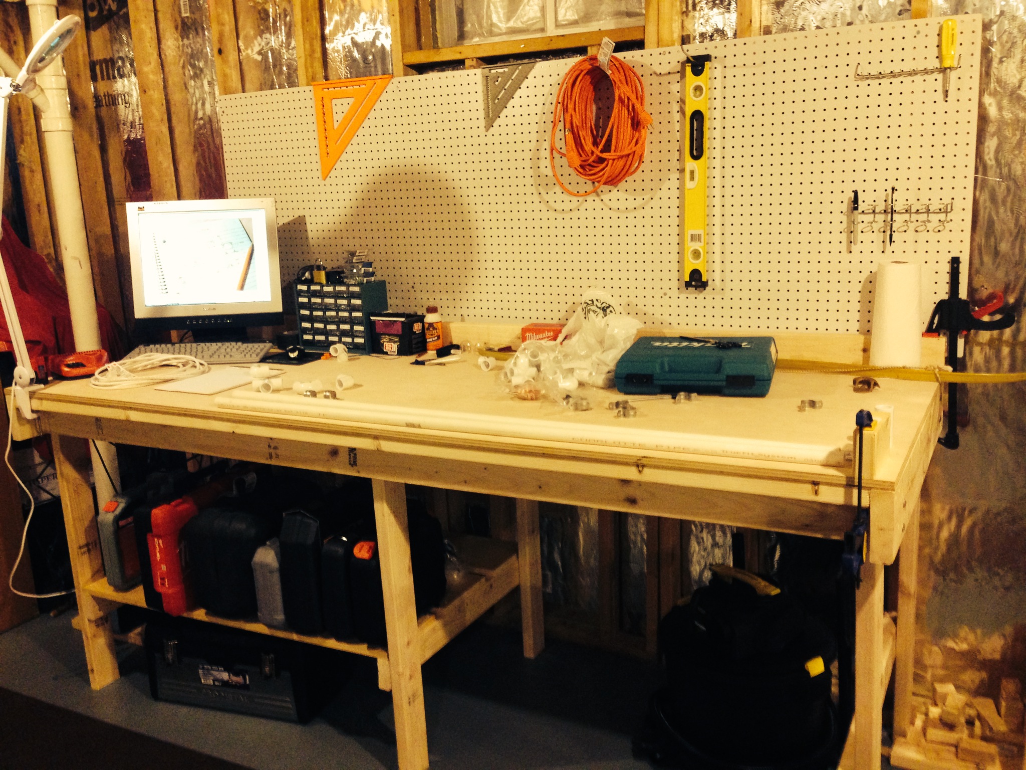

When I started planning the build, I realized that I lacked most of the tools I'd need as well as a decent work space. Which led to a scenario like this:
And ended with this:

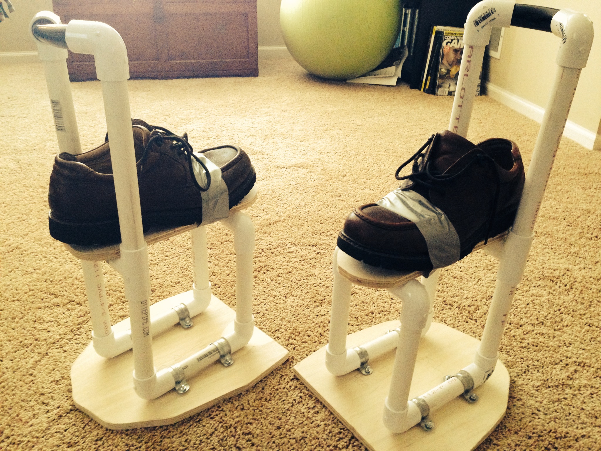

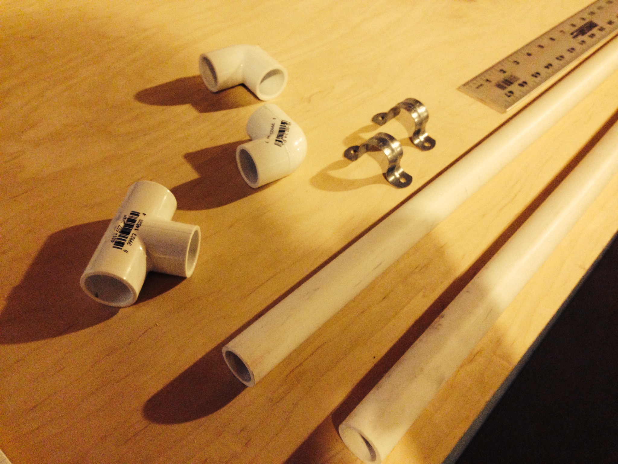

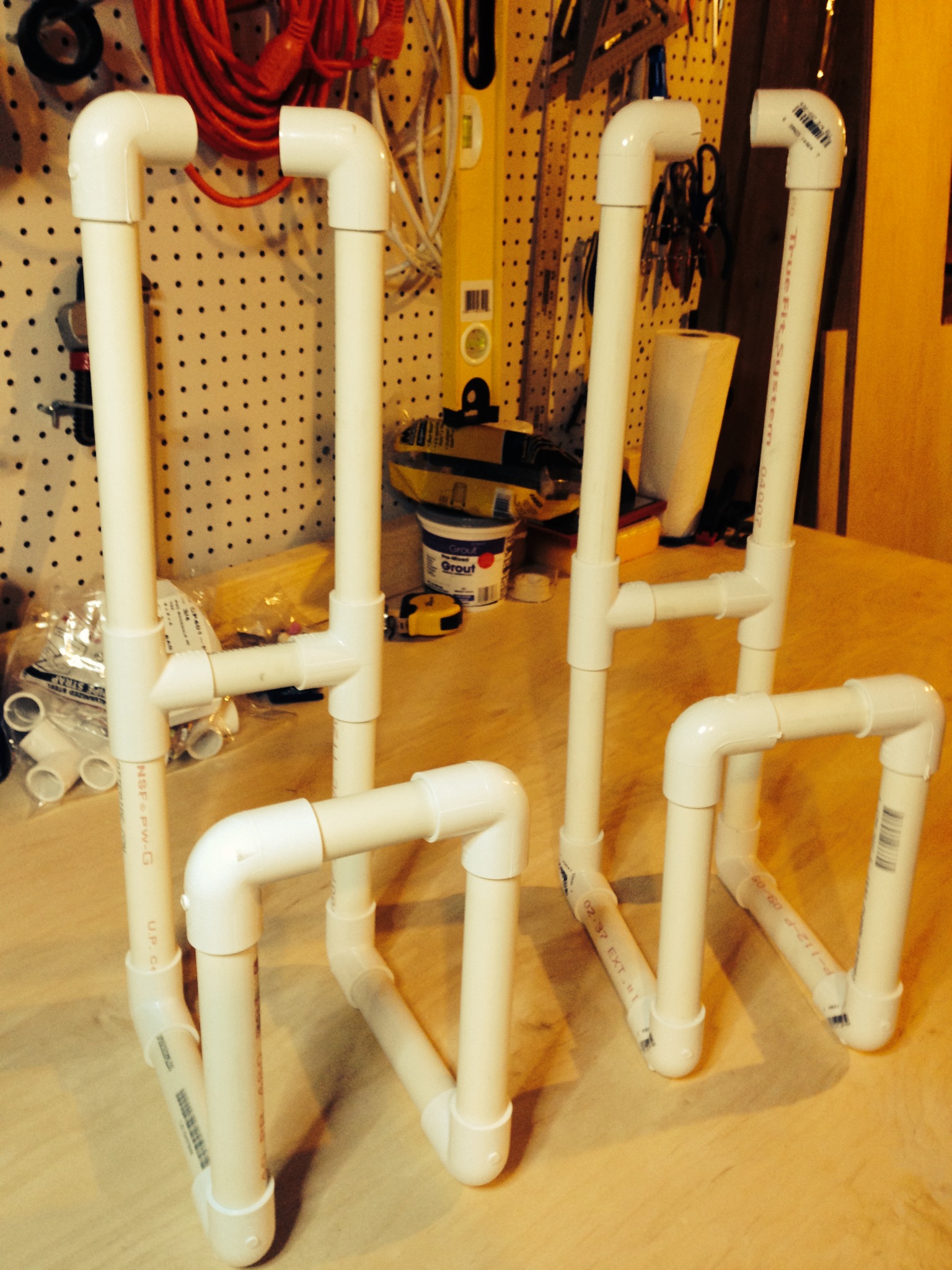

With the workbench completed I decided start with the stilts, because if I couldn't get those right then the base of the whole costume would be off. I went with the 3/4" PVC to build the frame, like Sylgian's build. But lacking the 3D printer to make the "feet/pole holder" I ran another piece along the bottom and used hose brackets to attach it to the wooden base:
I originally started cutting the lengths of PVC with a hack-saw. Which was slow, messy, and gave less the perfect 90 degree results. On a later trip to Home DepotI discovered that they make a tool specifically for cutting PVC. I highly recommend just having one of those on hand if you every work with PVC, way easier.

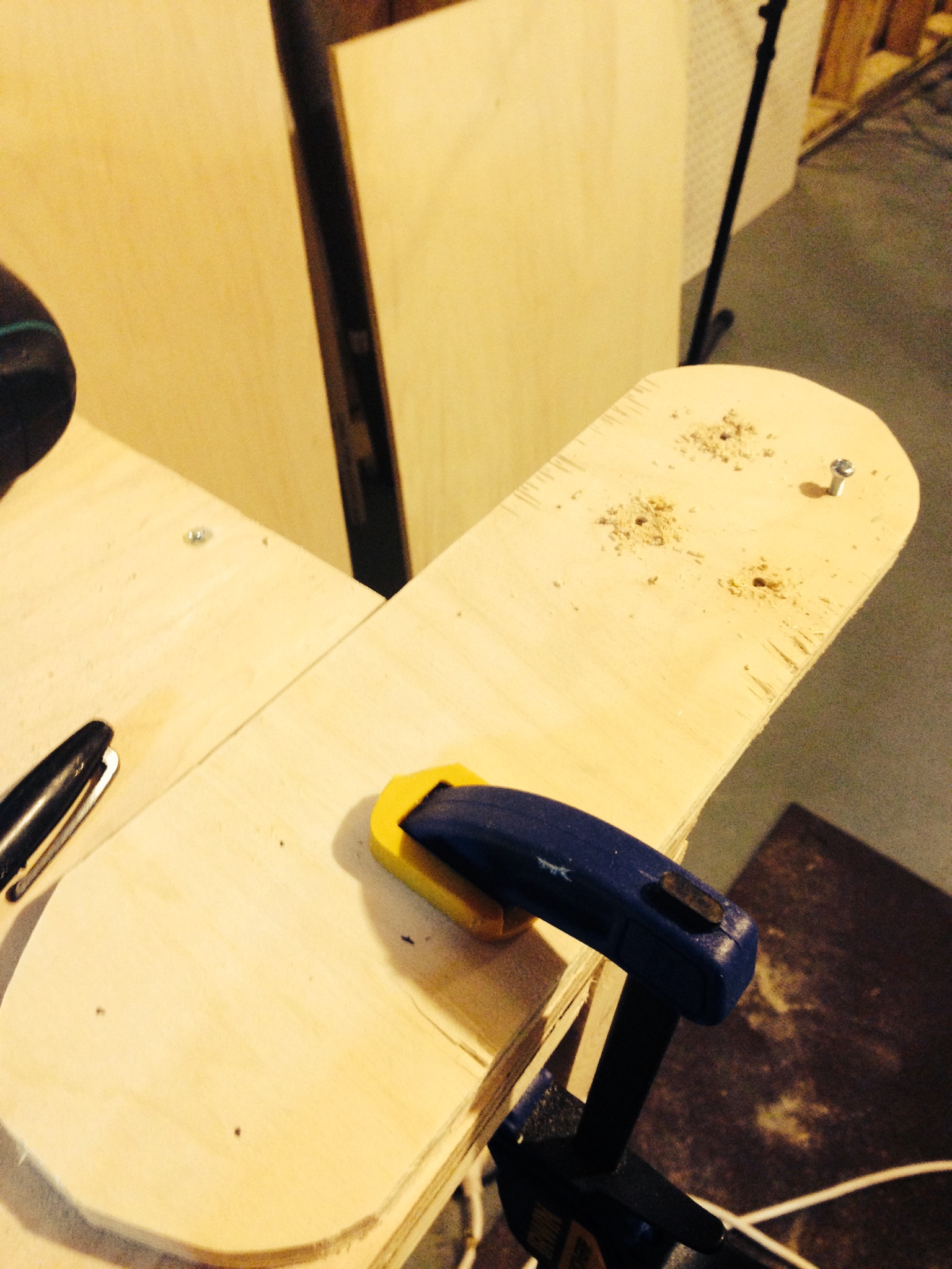

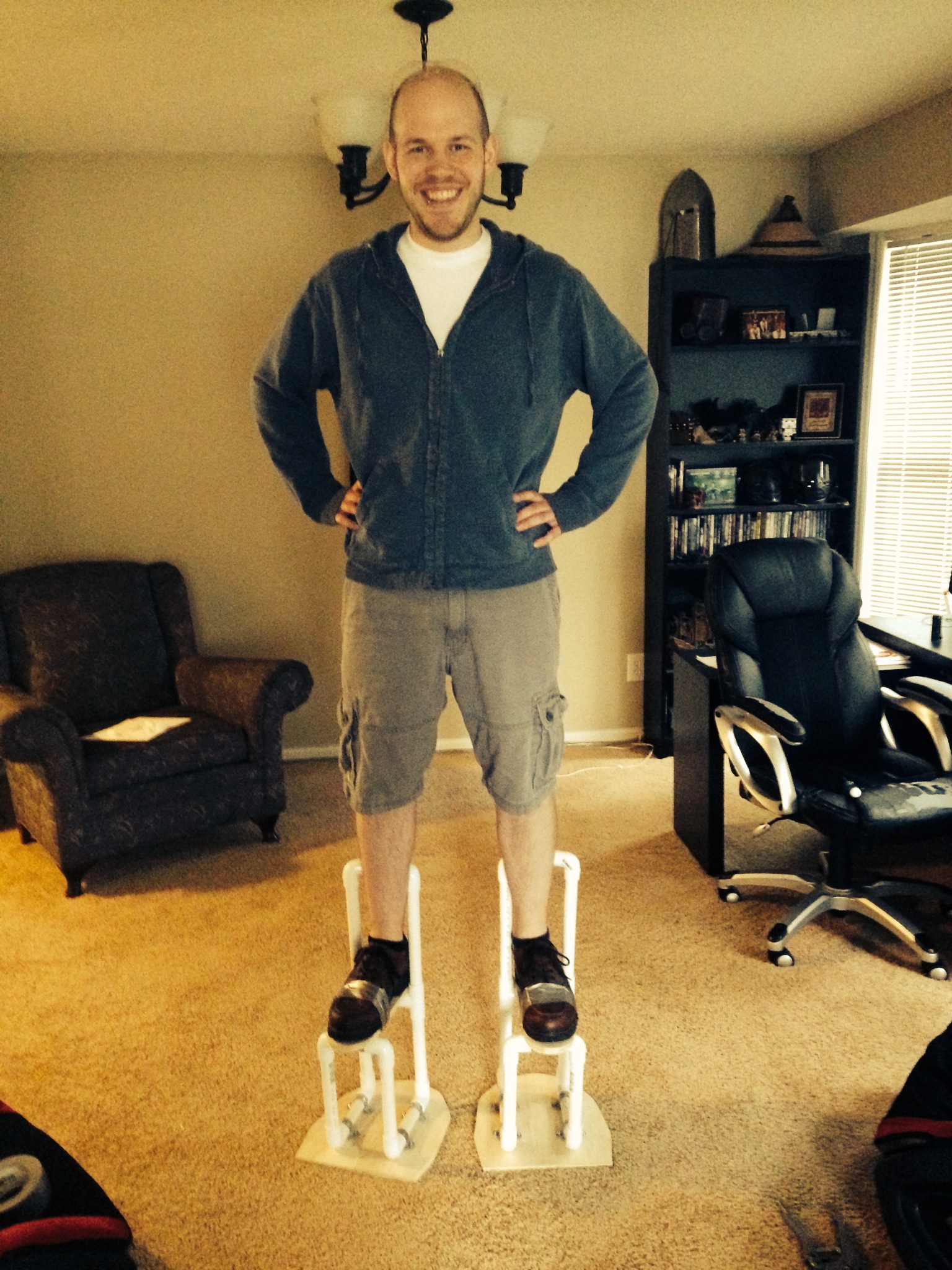

After the frame was done, I cut base and shoe platform out of 1/2" plywood, drilled the holes for the bolts, and bolted everything together for a test run:
That's all I've got for now. Now that the stilts are done I'll either start on the boots or helmet first. The boots if I'm feeling practical and the helmet because then I can just wear a Space Marine helmet around the house at all hours. :lol
