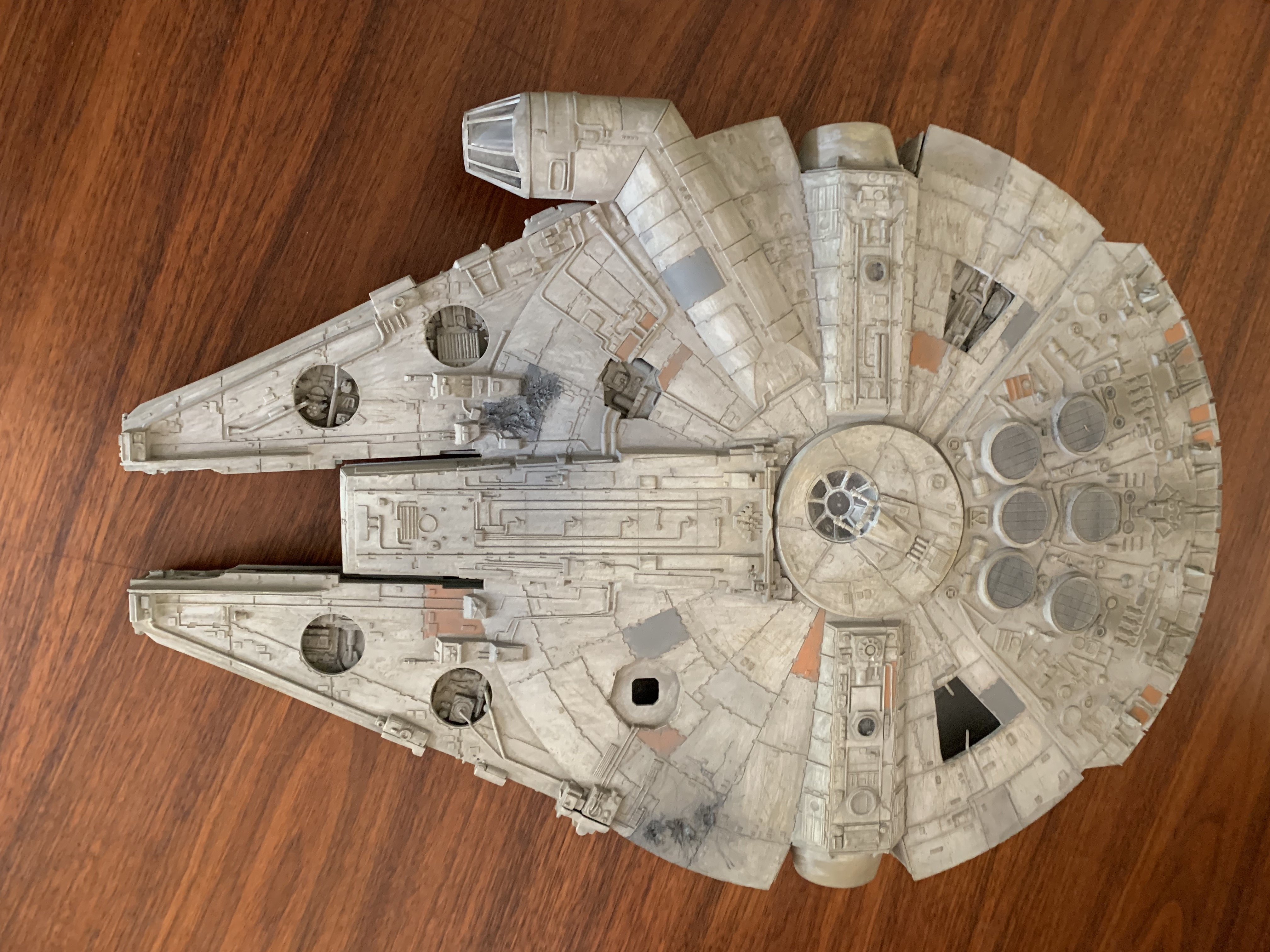

I actually OWN one other MPC Falcons that ILM bashed together for animatic work on Empire!
It was given to me, a good luck gift, (and for use as a possible foreground miniature) by my dear friend (and producer of 5-25-77) Gary Kurtz, while we were preparing to shoot the ILM sequence in "5-25-77". The dish is missing, and a couple of the recessed detail bits are currently bouncing around inside it, but other than that it's in pretty amazing shape.
