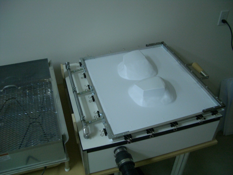

This is the inner part that angles in on each end right?
Looks great!!!!! I could see that being a pain to form with
some webbing coming off the sides if you heat the plastic
too much. Either way thats a lot of encapsulation wax it up
good to help get the buck out. Excellent part good to see you
get at it!!:thumbsup

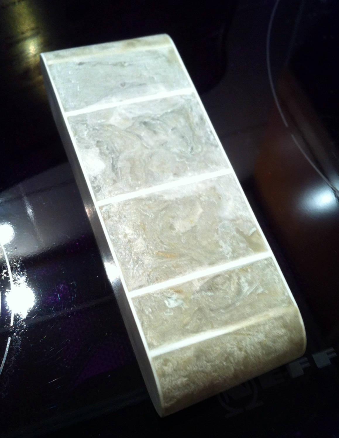

Well, you were very right Mike,
You're apoxie sculpt didn't softened you're mix ratio
was off with part A&B wax will have no effect on that stuff
when it's mixed properly and set up. If the buck never set up
then......hmmm thats unfortunate you will have to make another.
You don't have to be perfect with the mix ratio but a lopsided ratio will
cause problems!

Cheers Mike, re the Apoxie Sculpt it had def set hard already, I'd sanded it a few times and got a great solid hard Finnish on it, so something had def effected it afterwards also, it may have been a bit off but def changed viscosity after the fourth pull i did, I noticed each pull get more scruffy from the surface detail each time but it had def took a good sanding prior to being used, I've made quite a few bucks with it and its a first for me
I'm gunna have a crack at re making a half buck tonight....lessons learned are a god thing though as I'm less likely to waste time and energy like that again now I know its a none starter
Wow thats crazy never had the wax effect the apoxie clay,
especially if you consider your buffing most of it off, and just
leaving a smooth surface. I have had it where I mixed it wrong,
and when sanding it down ran into areas below the hardened
surface, that were soft because it was not mixed properly in
those areas below. The regular apoxie sculpt is good
up to 350deg my entire front skirt is made of that I formed that
more than a few times with no problem......hmmmm crazy let's
see what happens when you make the next one? I put like 4 coats
of wax on that front skirt....just for fun it was so shiny!! LMAO
Yeh it was odd, and it only effected one section really bad and another just lightly. If I wasn't totally battered from having no sleep for a few days I'd jump on it, I just had my car trashed at a Safari Park by Baboons so need to go and see how much more damage I have on that as well!!!!
Oh snap sounds like you're gonna need more Apoxie Sculpt.....that sucks!!!!!!

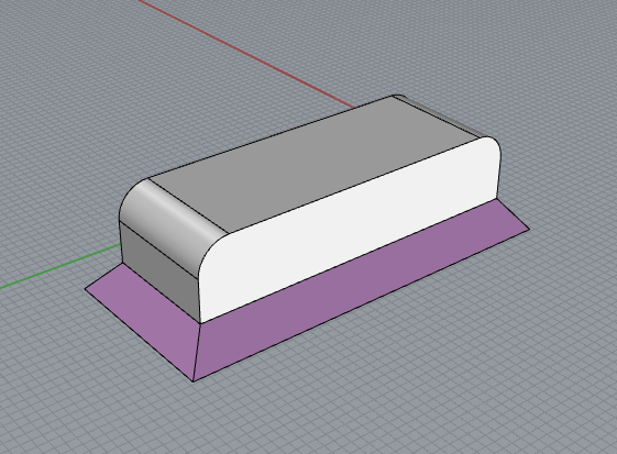

Guy, don't make a new buck. All you need is some Klean Clay, or similar. Make a riser of clay, then place your buck on the clay laying on its side. Then build a narrow perimeter of clay around the riser and buck, even and level with the depth you want from your pulls. With a little patience you can form the clay to slope slightly outward - this way you can add a little more height to your buck to aid with trimming the pulls. Should save you some trouble and time. This is how I pulled my AT-ST head halves. The buck itself is the same size/shape as a finished head. This pic may help illustrate what I'm probably explaining pretty poorly...
Good practice to have a base on all pulls to aid in removal and hopefully move any webbing to the base.
Cheers fellas, I did have quite a thick riser on it but will have a crack at again asap, thanks for the advice and tips :)
