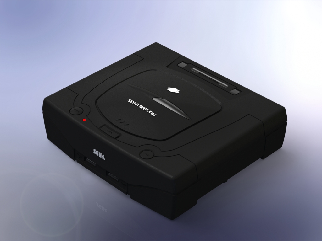

Just finished the Sega Saturn. Almost done the Sega line of primary consoles!
Just got all the 3d prints for the rest of the Nintendo systems! I'll post pictures as soon as I've had a chance to paint and assemble them.

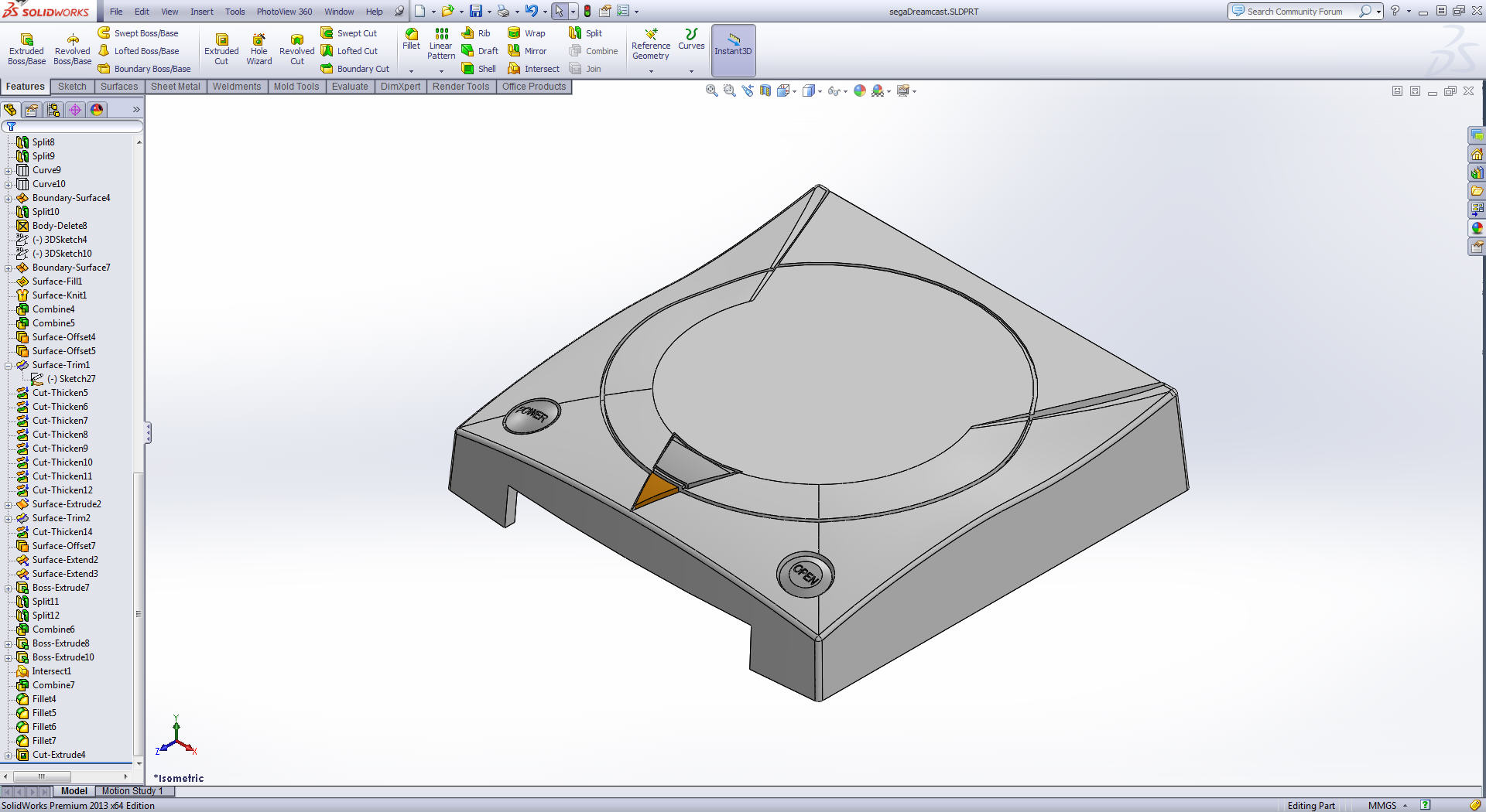

I also thought I'd share a few WIP shots from Solidworks so you can see these during the modeling process. The first one is the Sega Saturn I just posted and the second is the current console I'm modeling.
This will complete the Sega line (sans 32X if I decide to do it at a later date) and then I'll probably start on the NEC line (TurboGrafx, PC Engine, etc), unless I decide to do some more classic consoles.

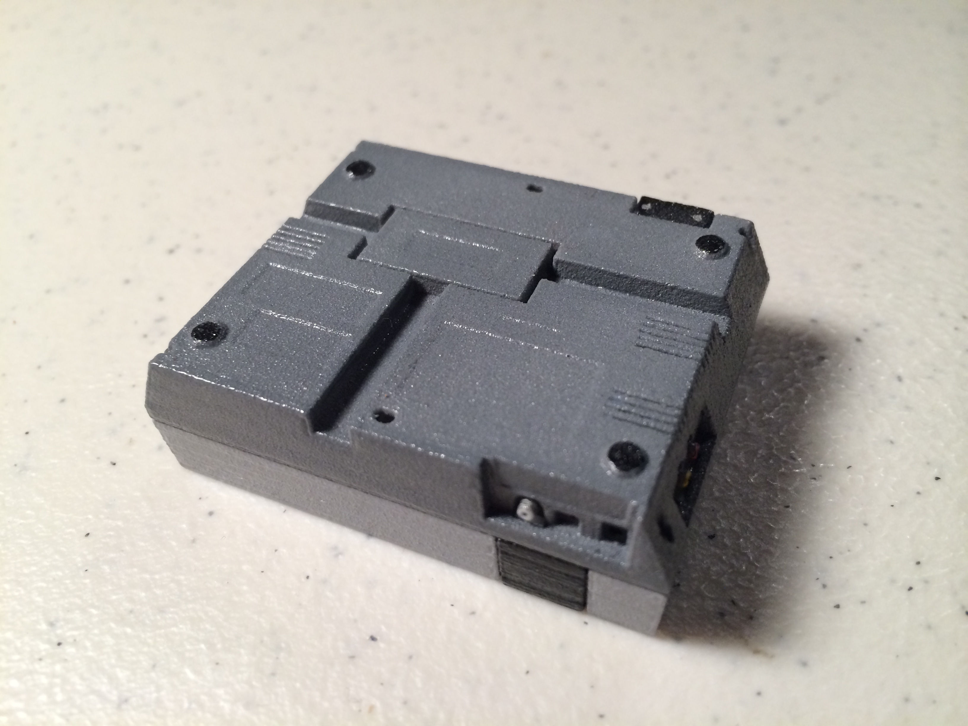

Exciting news! I received the 3d print for the NES yesterday, painted, assembled and varnished it. I think it turned out fantastic! I'm going to order the rest of the Nintendo consoles I modeled and finish them the same way I did with this one. I'm also almost done modeling the Atari 2600.
View attachment 407927 View attachment 407929
View attachment 407930 View attachment 407928
What are your thoughts?

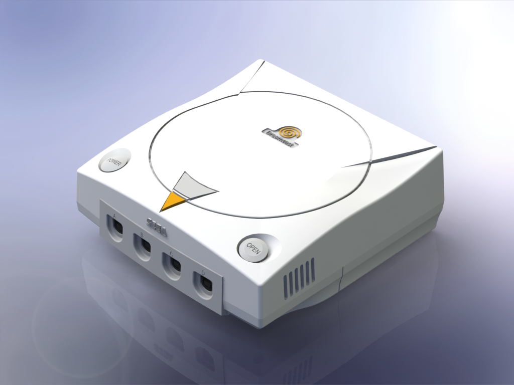

Dreamcast is done and so is the Sega line of consoles! Again, I'd like to do the 32x but there isn't a good way to do it without modifying either of the Genesis models that it goes with or the 32X itself. Still, it would be a relatively inexpensive add on in the grand scheme of things so it's definitely on the table.
So the question is, what should I do next? NEC, SNK, handhelds, or some more retro systems? Or maybe a series of less popular consoles like the 3DO, Jaguar, etc?

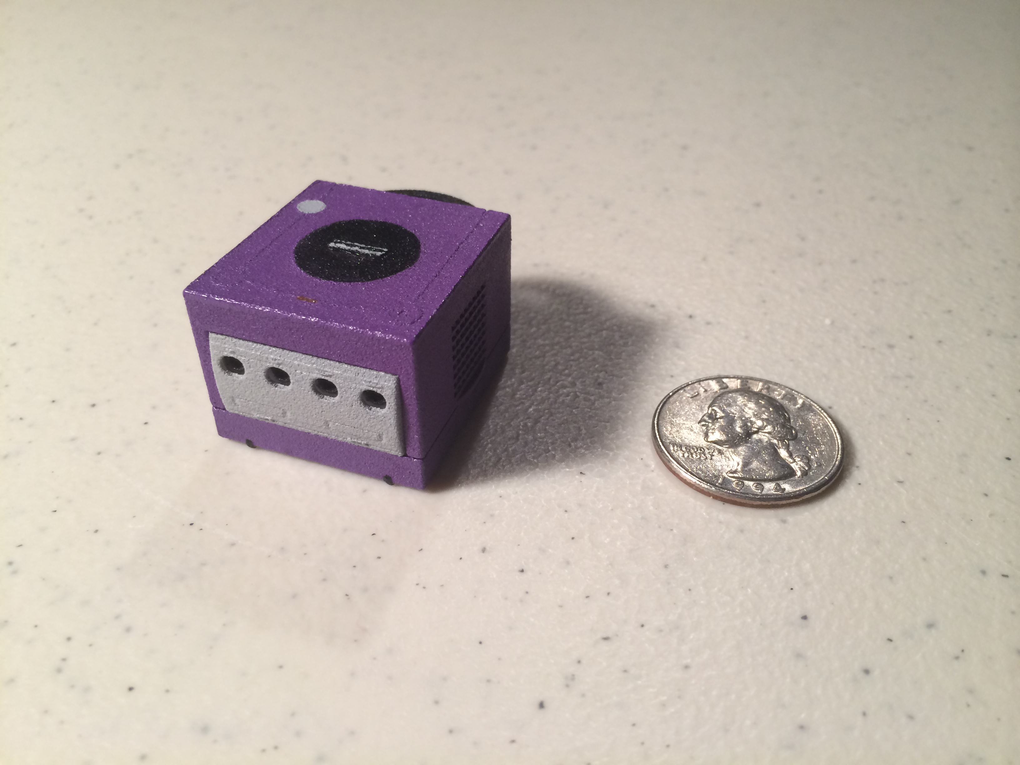

Two more 3d prints assembled and painted - Super Nintendo and Game Cube!
The color on the GC is a bit off from what it should be but it doesn't bother me. I hate having to mix enamels but a lot of the colors on these consoles are not available directly from the bottle. I'll probably paint the N64 next since it's a similar matte texture of plastic to the ones I've done so far. For the Wii and WiiU, Im planning to do some sanding to eliminate the stepping around the curved and angled faces, as well as attempt a finishing technique for a smooth and shiny surface.

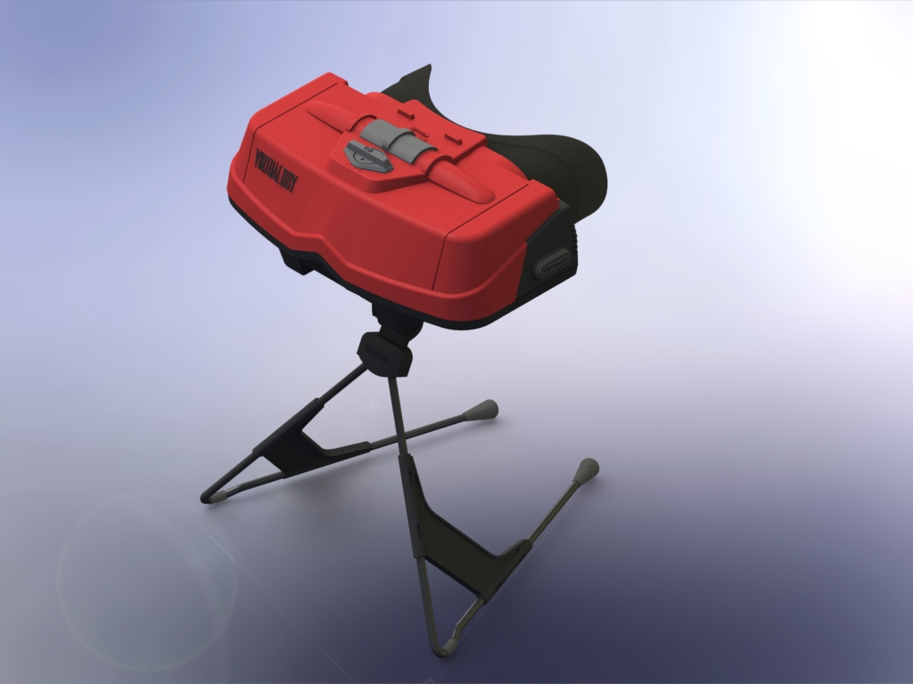

New model is finished - Nintendo Virtual Boy. I'm curious how the stand will come out but I'm confident. the minimum wall thickness is 1mm and the thinnest portion on the stand is 1.2mm , so we'll see. I set the legs up to print as as separate parts, lying flat on the print bed so they don't warp during the process.

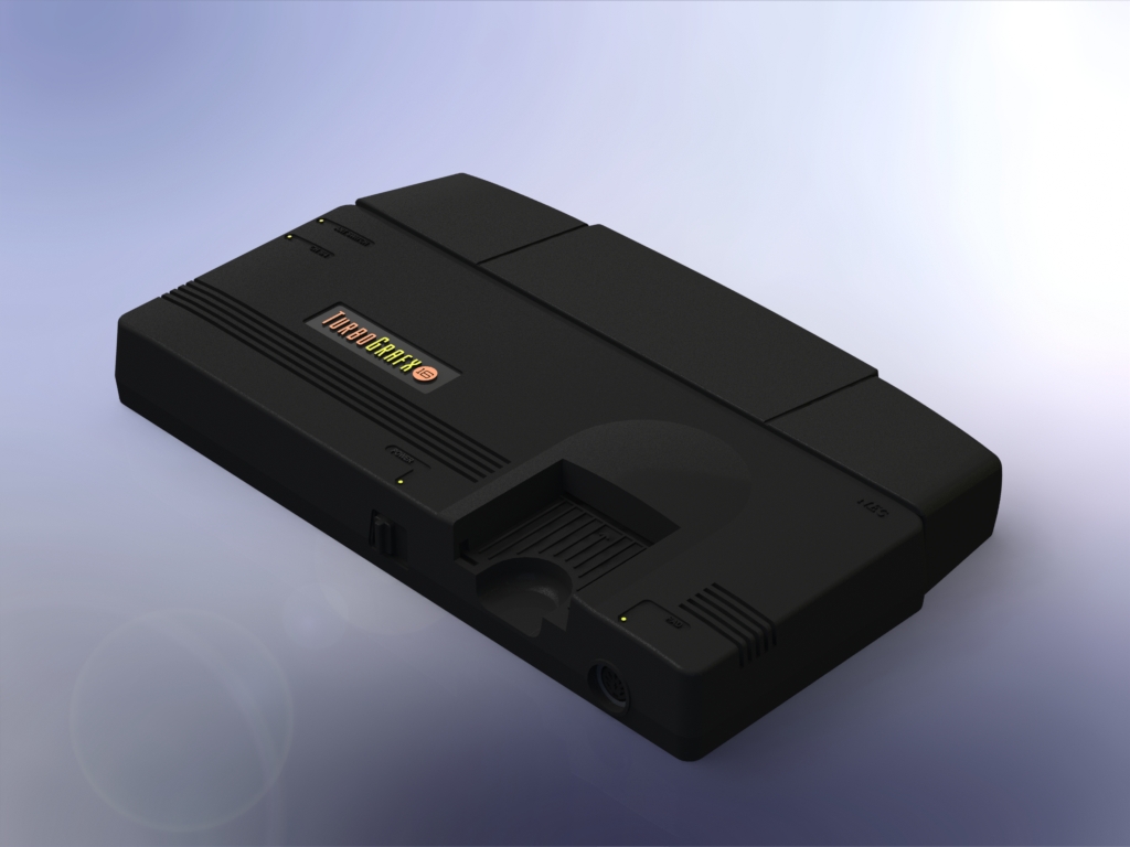

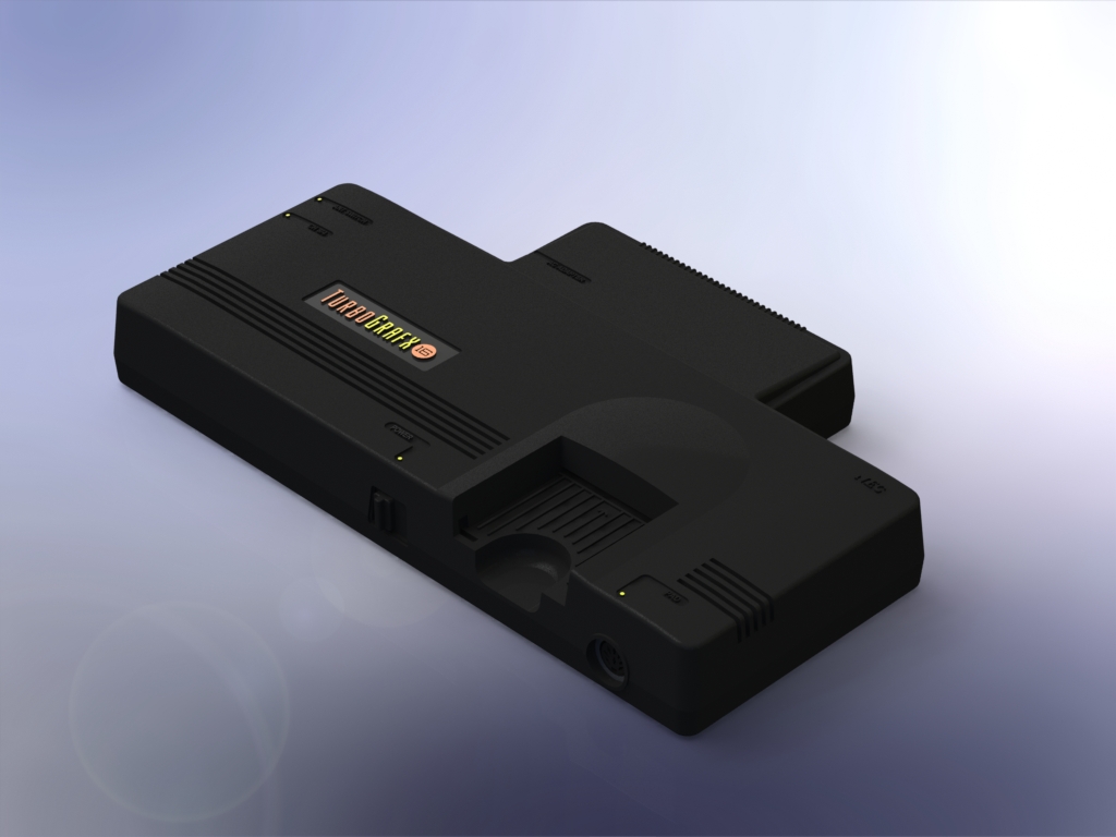

NEC TurboGrafx 16. This one has an "optional" cover that goes on the back. On the real deal, it covers the expansion port so I figured I'd make it a separate piece from the main assembly with extra tolerance so it will fit nicely after painting.
Here is it with that back piece.

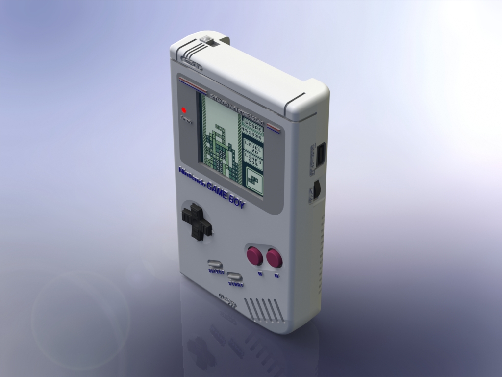

I've moved on to handhelds. First up, naturally, the original brick - Nintendo Game Boy. I have yet to print something so small in the WSF material so we'll see how it comes out. Special consideration was made for the screen section, which was modeled as a separate part so a printed screenshot can be applied before assembly.

*Also, I'm been going back through the models and creating high res renders - they've now been replaced throughout the thread.*
I definitely have considered it! I have one of the Odyseey 2 consoles as well (I'm a bit of a collector, hence my obsession with them and making tiny versions of them all). There are so many I'm just going to keep going until I get sick of them so I'm bound to get to the Odyssey 2 at some point. Initially I was staying away from consoles with a lot of print on them (easier to model stray bits of text into the surface to paint later than to model lots of small details) but after doing the Coleco Vision and Intellivision, I've come to realize that it's just a matter of printing out tiny labels to be applied to the surface - as long it's a solid shape (much like the metal plates glued into recesses on the surface of old systems) and not a decal needing transparency, it works.
Also, I'm been going back through the models and creating high res renders. I'm not going to post them all but here's the Virtual Boy again, with the better resolution:
