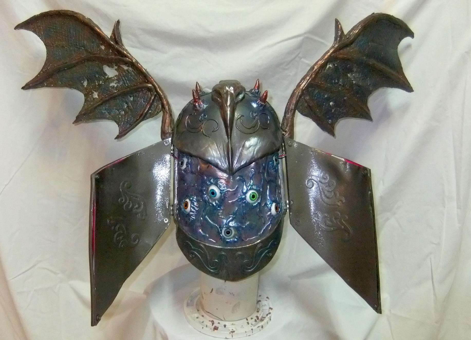

my belated wip. :)
I used styrene to layout the face plate door.
It is built up with 3-4 layers of styrene.
Some heat to curve the doors and a quick test fit for looks.
The vision is thru gaps between the brow and the top of the doors.
It is set back and hard to see, hopefully the illusion is that there is no eyes. ;)

The raised crest area of the magneto helmet was grind away.
I then used 2 part epoxy clay to sculpt the raised brows and furrow lines between them.
View attachment 155328 View attachment 155329
I glued foam to the top to have a base to sculpt the bird skull? crest with
the same clay.
The clay dried hard over nite.
The next day, all the sculpts are nice and hard.
View attachment 155331 View attachment 155332
Some more grinding and sanding to shape.
One horn was sculpted for casting.
I wanted to have the horn looks like it was growing out through the helmet.
clay wall and quick brush mold.
some fresh casting. Need about 14 of them.

Cut and form a piece of styrene for the base pf the eye ball mask.
View attachment 155393 View attachment 155394
Holes was cut and soften with heat to push out a slight bulge..

More e-clay was sculpted around the hole.
View attachment 155399View attachment 155400View attachment 155401
veins was sculpted with e-clay
View attachment 155402 View attachment 155403View attachment 155404
the wings was sculpted with clay.
same with the wing attachment.
Similar look as the horns, with it growing out of the helmet.
View attachment 155406 View attachment 155407
several coats of brush on silicon.
and plasti-paste as a mother mold.
View attachment 155409 View attachment 155410
after the wing mold has cured, it was flipped over and the
back half of the wing was sculpted with clay.
and 2nd half of the mold was made.
blue tape was used to line out the location for gluing the horns.
horns glued and some raised sticker was applied
to give it a more ornate look.
View attachment 155413 View attachment 155414View attachment 155415
A base coat of dark bronze was applied.
a quick test of the finished cast wings with base paint applied.
The wings was cast thin in spots to give it a tattered look.
Started to applied weathering wash of metallic blue,green,purple to
the helmet. The horns and wings was given an additional color of metallic copper.
View attachment 155483 View attachment 155484
attached the eyeballs in with hot glue
View attachment 155485 View attachment 155486
The face door was assembled, the el circle attached.
Then the face door and wings was attached to the helmet.
