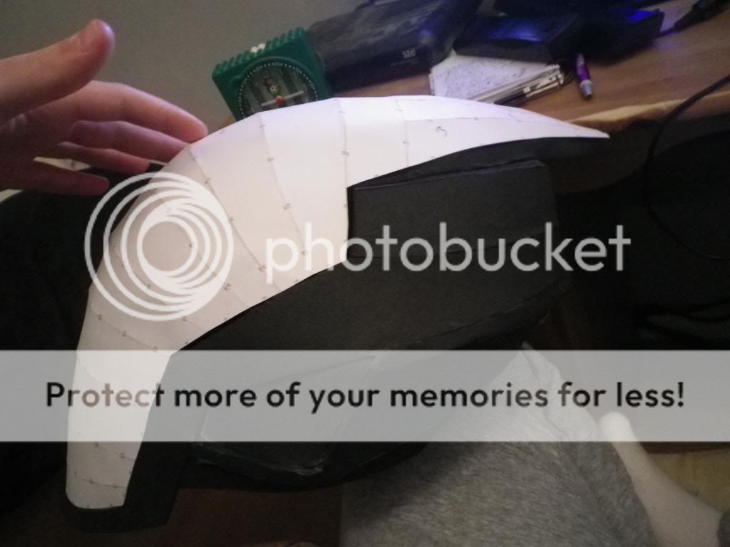

Hello, fellow borderlands fans! For my first build, I am making Zer0's default helmet from borderlands 2. I have decided to go with an EVA foam helmet shell and a PETG vac-formed visor, because it'll be lightweight, flexible and I can actually fit my head in without sacrificing its size. I used JTM1997's Zer0 Pepakura file and modified it for foam use, I also resized it to fit me better. On to the build!
Unfortunately, I don't have progress shots up to this point, this only took around 2 hours of my time.
I made it by tracing the templates on the foam, cutting them out, hotgluing the peices together and used a hot air gun to shape it.
I made the visor out of cardstock from the same file, the plan with the visor is to harden it and bondo it to make a "buck" for vac-forming.
That's all I have for the time being, updates will come shortly.

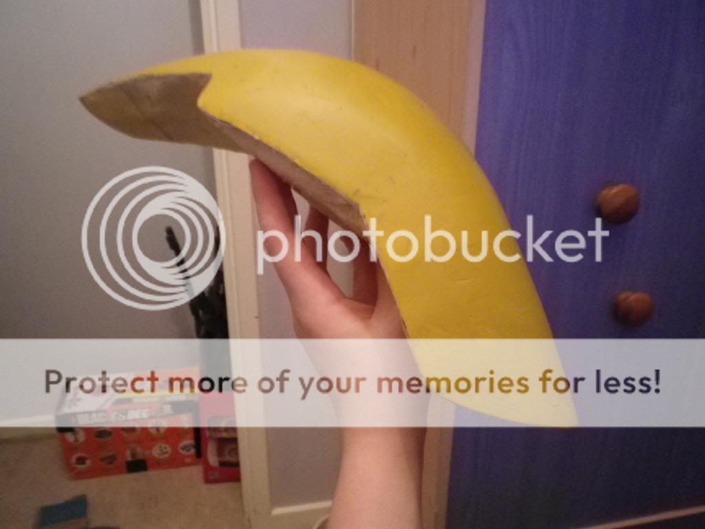

Update: I resined the visor. I taped it from the inside to help keep its shape, its quite patchy though, I did it in the dark,:facepalm not a smart move when foam is around, thankfully, no resin touched the foam.
ANOTHER update:
I have hardened my visor starting with a layer of rondo (50/50 mix of bondo and fiberglass resin) and then used quad stitched fiberglass matt and fiberglass resin. The reason I used quad stitched fiberglass was that the resin soaks in much better and later on, I will be using expanding foam on the back which will grip to the open weave much better than normal fiberglass matt.
P.S. The expanding foam is to spread the pressure for when I vacuum form it and stop it from cracking under the pressure.

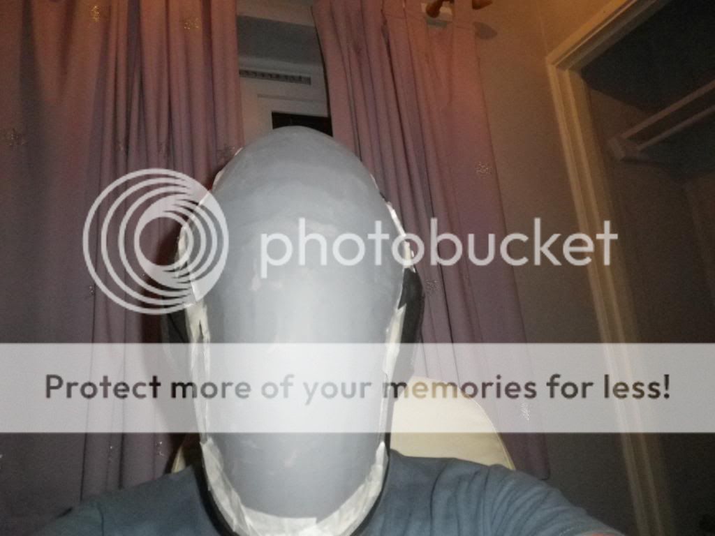

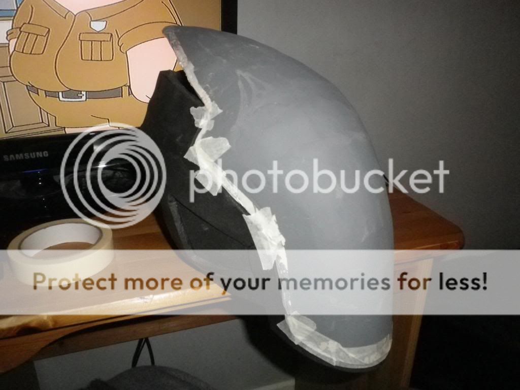

Test fit of the helmet with the visor attached. This was mainly just to see if my head fits, (which it clearly does.)
Theres a few pros and cons with the visor. 1 con is while hardening the visor, the shape of the visor has become thin, making the visor "raise" at the top portion, so I had to remove a couple peices of foam and draw up a new peice, however the pro is the visor looks much more like the in game visor. This image shows the gap, and yes thats peter griffin from family guy.

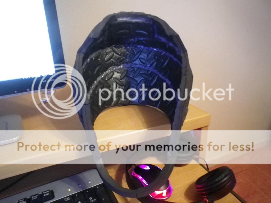

my expanding foam arrived today, as previously stated, I'm using this to spread the pressure for when I vacuum form, otherwise the buck will crack under the pressure. First I boarded up the sides with cardboard and tape.
After that, I covered the base with the expanding foam, then carved the excess mess using a hacksaw.
Just another angle.
