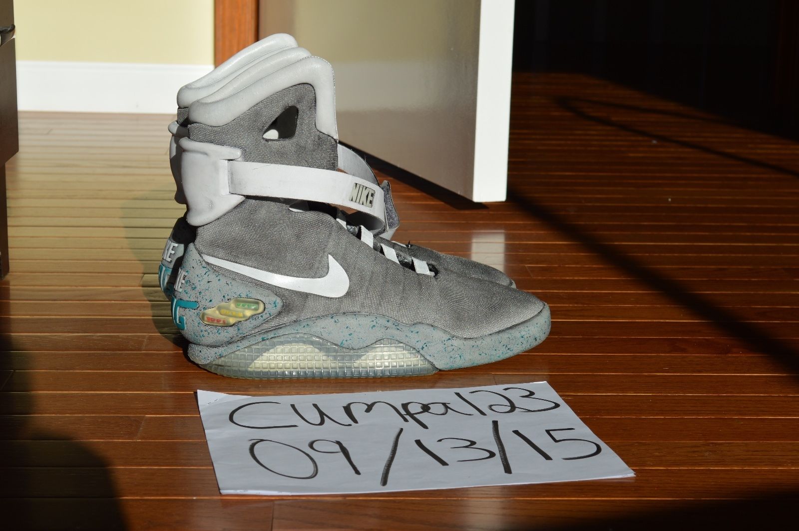

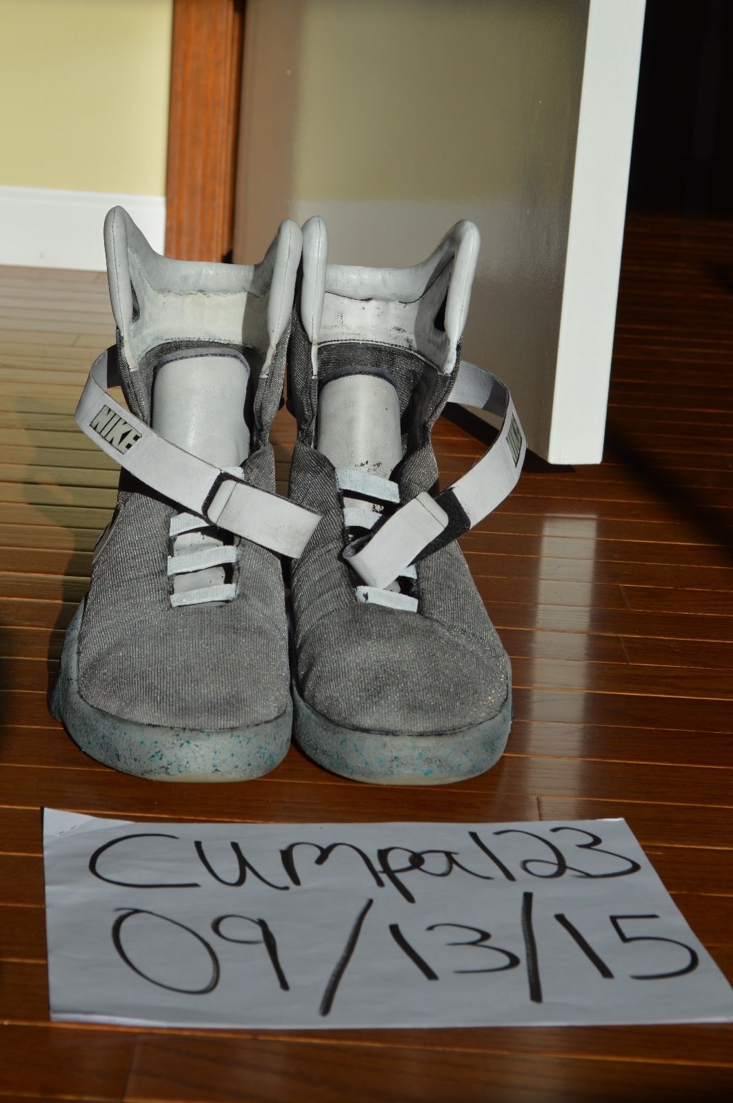

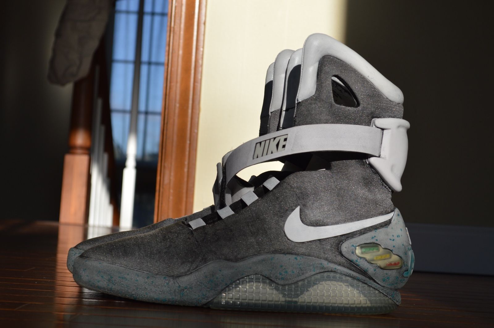

You can do that from the playing with the patterns. I have already figured out many parts to the shoes just by making up some different versions. The idea of buying the shoes is to have the most accurate parts. Again, in a once size only option regardless if they are the real soles or my V2s. And do we even know what size these are?
So far, the has been a cloth similar to the V2 uppers, but nothing quite like the 2011 MAGs.
They're 12s as far as I know.

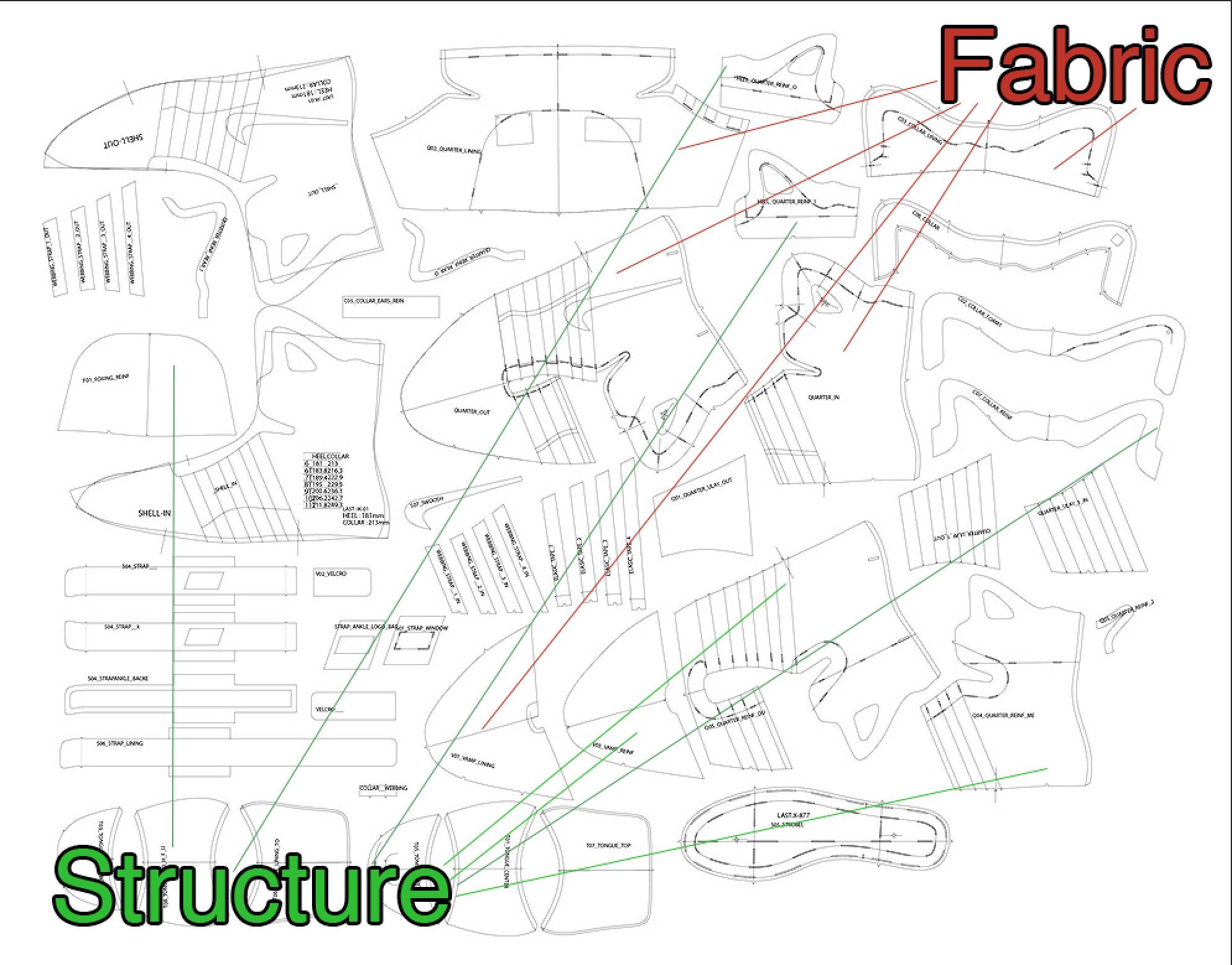

By the way, the flat patterns DON'T form perfect Mags. I've been doing some test while away from the board and they need to be formed over a last to get the curve of the toe. Since I didn't have lots of free time, I had to choose tiny projects like that to focus on.
...also, my original K-Mag Re-upper pattern actually used the proper seam points for the structure of the uppers. Here's the results of one of my tiny projects:
And once my work-work is done (In about 2 weeks) I'm going to be working on uppers again using a new technique that should eliminate the need for these patterns, and make a more durable shoe, even though it will add a little more effort up front.
-Nick
I think they do, but your right, you need formers to get them to hold their shape and you need materials that can bend in two directions at one time. Paper does not do this very well. Because this shoes is basically non self supporting cloth, you need an substructure under the shoe first. Multi-layers of some materials can work to make them self support and do away with some of the substructure.
-Nick
I look forward to seeing what you come up with.

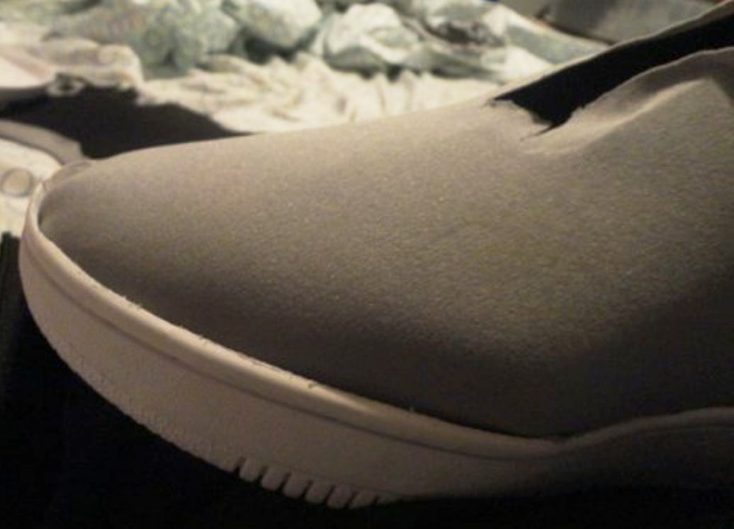

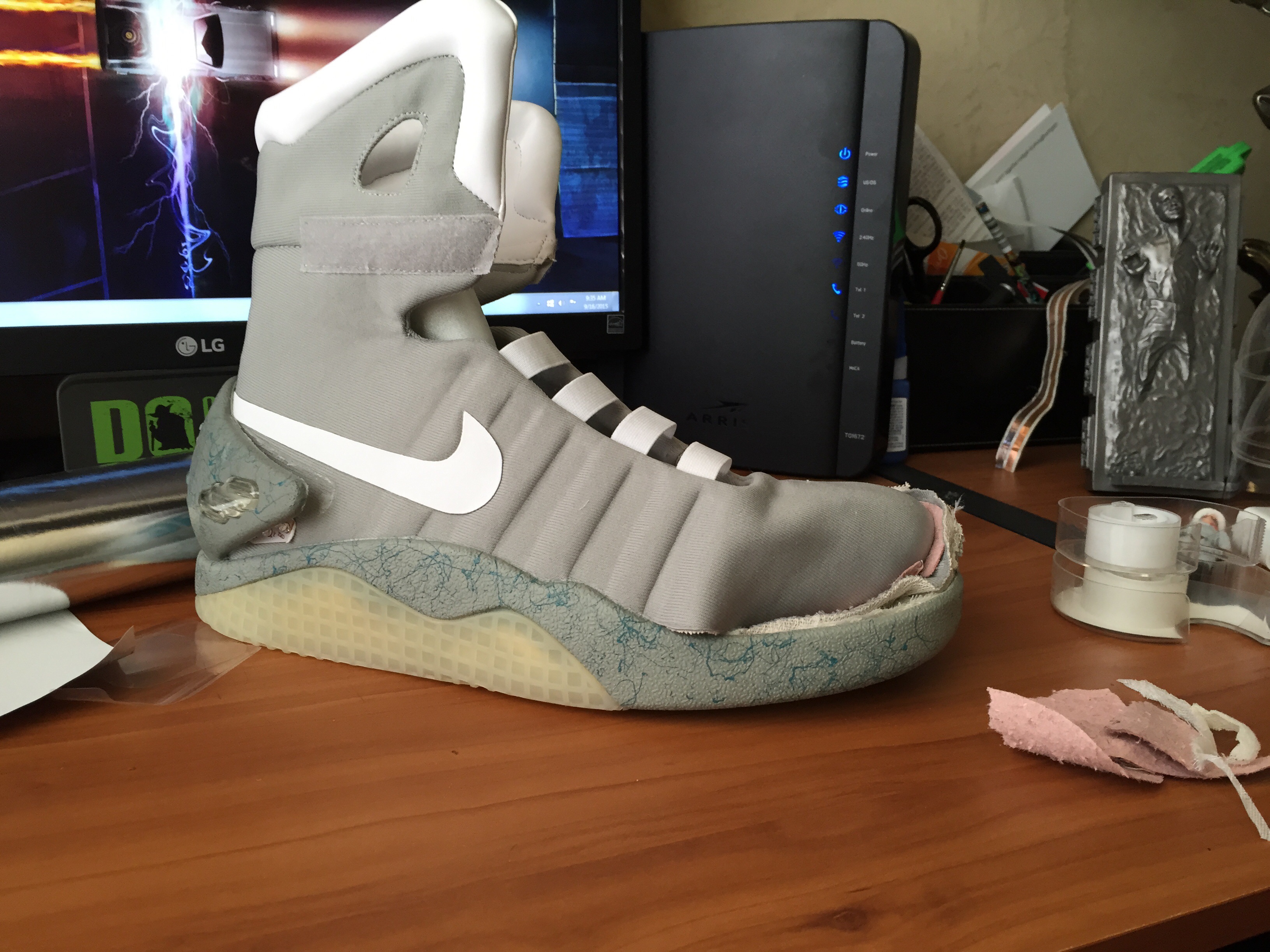

My tester upper (simple craft EVA Super77'd to a layer of fabric and a generic Air Force I look alike midsole.) I heated the toe with the slightest amount of heat. I used an iron and hovered above the upper (inside out, the fabric not in harm's way) heated just enough to soften and shape the foam. I don't recall the exact temperature, though.
Once heated, I wrapped the front of the upper around the front of the midsole, taking the shape of its surroundings, that way it's basically tailored to that midsole once it cools and keeps that shape. Then, since its slightly bigger than the inside of the sole, it'll be nice and snug against it, making gluing easier and not dealing with a stiff material as would a paper template. This midsole doesn't rise like the MAG does, so it may be easier with a MAG midsole for gluing the upper to it, because a deeper midsole has more clearance than the one i tried it on. Now, EVA gets pretty hot, and this shoe would be killer to wear around for even 10 minutes. I know this because I actually made a few other custom shoes with an EVA inner frame and boy those got warm quick! No breathing whatsoever! So a Nike MAG made of EVA wouldn't be the best, that is if it were to be worn. As strictly display, yeah it can work. I have an idea for using the 1989 method with the automotive foam, and keeping parts rigid to keep form and not so flimsy, and I also found some "head rest foam" that may fit the bill. What's really stopping me from continuing with experimenting is that I don't have any other midsoles to try it out on, and my grey fabric is in one of my bins, somewhere in the storage unit lol.
That is a good shape on the toe. One the best of my projects, I found that making foam inserts helped the toe take a proper shape. The other technique is to fold the edges under the toe as well.

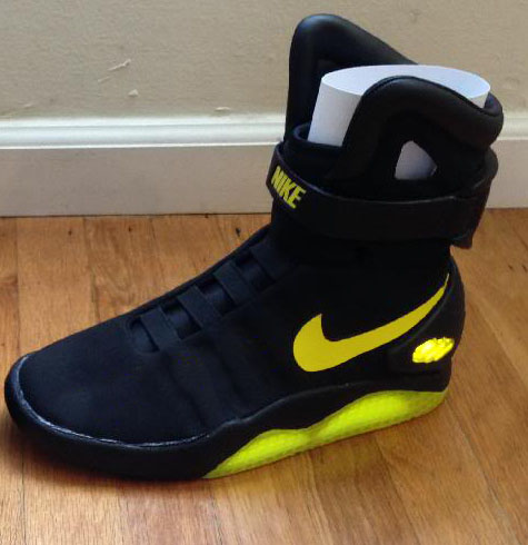

I just saw a photoshoped pair of mag that makes me wonder if i really should bother myself doing a "remake" of jedifyfe version without the footwear logo and EL panel for the heelcups or if i should go for an even more simple version like this one
blackfridaymag.jpgor this one Sans titre-1.jpgJedifyfe's customs photoshoped
* White Swoosh white EL panels
* Clear soles from cavx
* White EL panels on the heelcup bubble or white LEDs (if i feel like doing it due that i'm a noob at soldering)
* White EL panels in the soles
* White light splatter

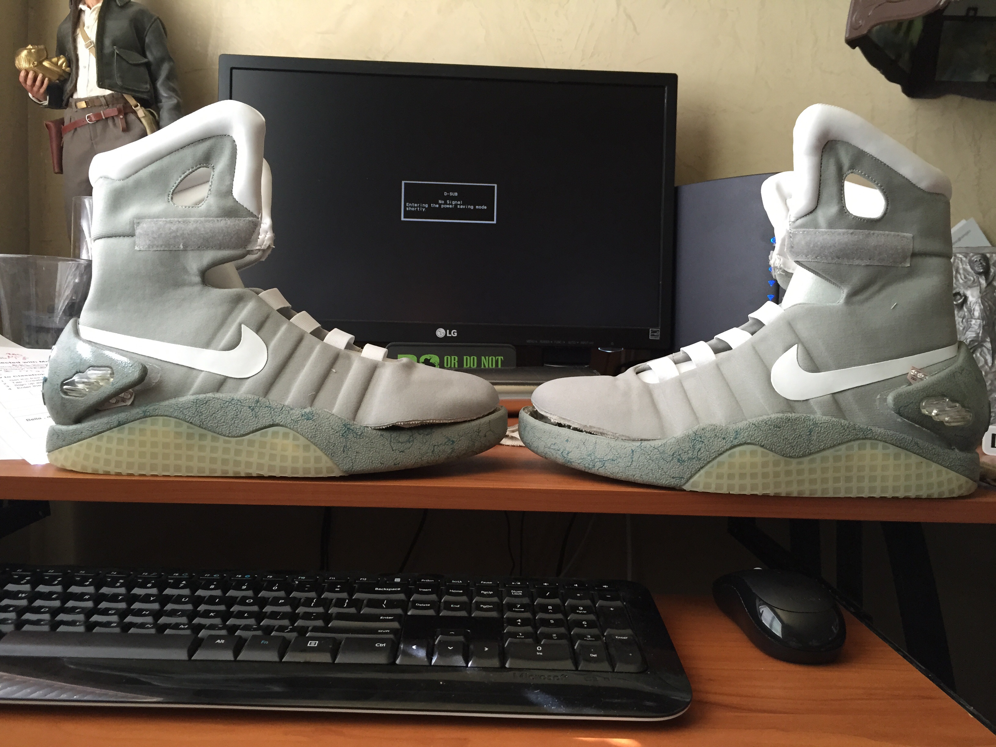

Thanks bud. These are probably the best toe slims I've ever done, so clean. I might have to keep them...LOL ;)
They do look awesome. Have you done a sock toe yet or do you still leave the toe box in place?
What size are they?
Maybe colored rubber mock LEDs can be made just for the look. Would that be possible?
Yes it is. I am all out of Urethane right now, but with last drips I could get out of the bottles, I ran a test with clear pigments and whilst I made mine too dark, the idea works.
What size are they?

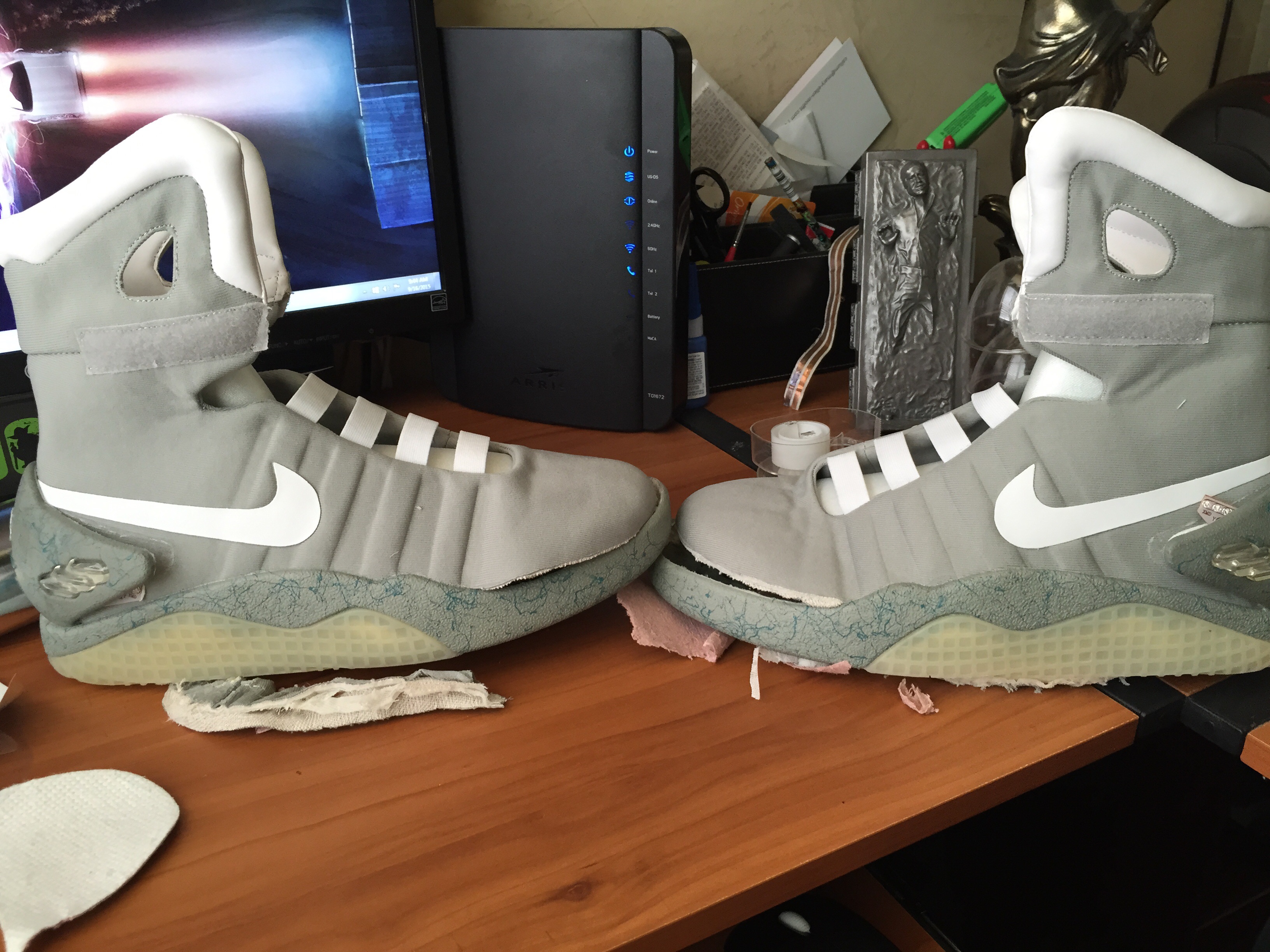

No sock toe. Though I liked the sock toe on the real props, the fabric on these are not as stretchy as it should be. I keep the rigid RD look.
These are size 11.
These are size 11.
I found the sock toe (only the box removed, both upper and lower fabric left intact) way more comfortable than when the toe box is in the shoe. It doesn't slump like the movie prop because of the dual layers.
I just got US11s in, so it will be sole stripping some time today.
