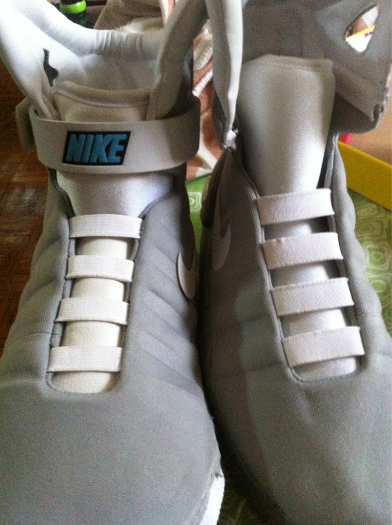

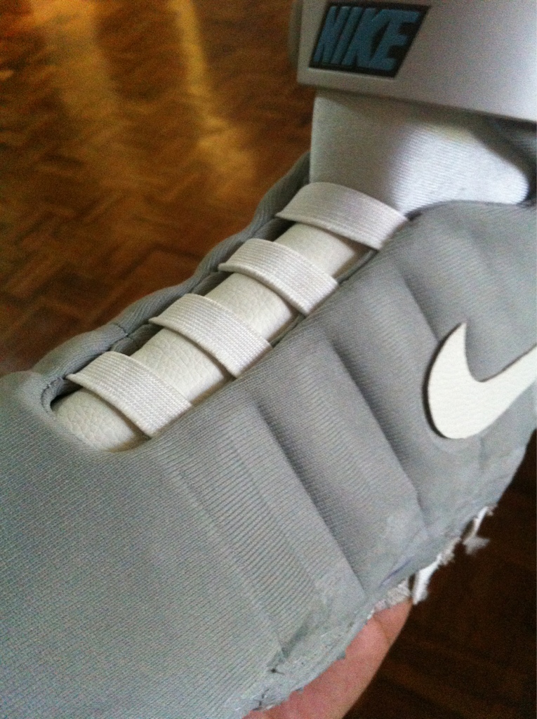

Update, replaced the 3/4 inch elastic with 1/2 inch, adding leather/ette on tongue as well.
ImageUploadedByTapatalk1396677424.199693.jpgImageUploadedByTapatalk1396677439.911723.jpg
View attachment 307431View attachment 307432
great job, did you unstitch all the elastic out?
