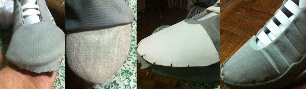

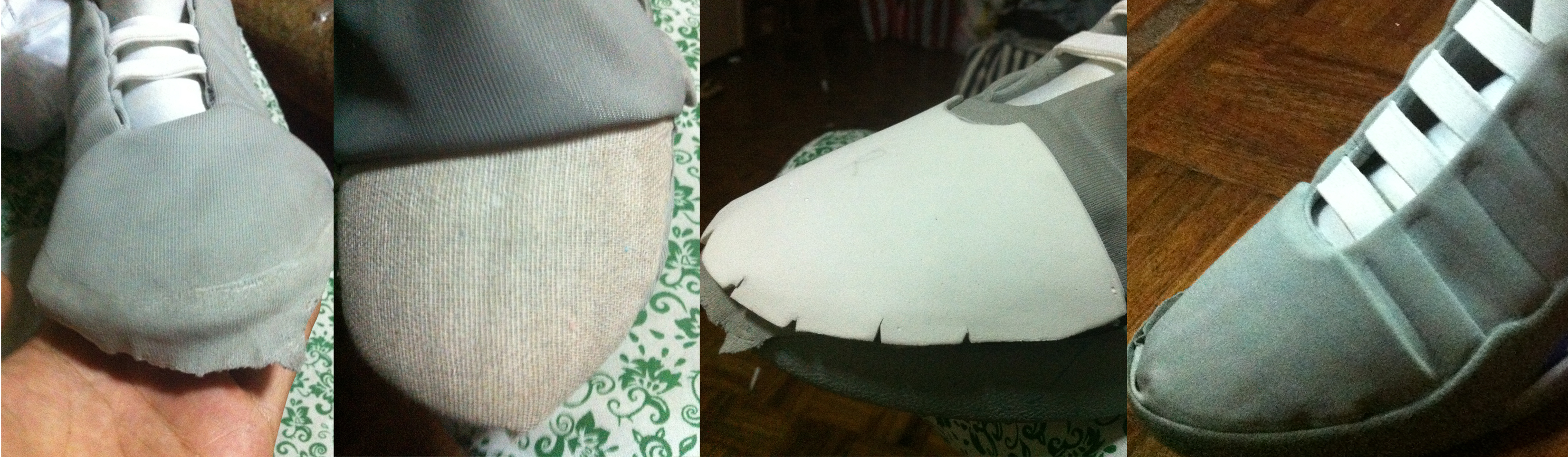

So are you saying you used a thin piece of EVA foam to replace the standard toe?
If so, details! Haha did you heat your foam to shape it, did you just use a flat piece of foam? Any other pictures of your process?
Regardless of what you did, great looking toe!
-Nick
Thanks for noticing nick, my purpose for the toecap is also to prevent toe creasing in future use.
I actually tried the steam mod first, didn't like the results so I separated the sole from the toe, cut the little stitches that bind the fabrics together and then inserted the toecap(i didnt remove/cut away anything inside.) I haven't glued them together yet as I said i deconstructed the whole shoe.. . Here are some pics and an alternate angle showing how the toecap will sit inside the shoe. I might also try to look for a slightly thinner EVA, but it depends because I'm happy with how it looks at the moment.

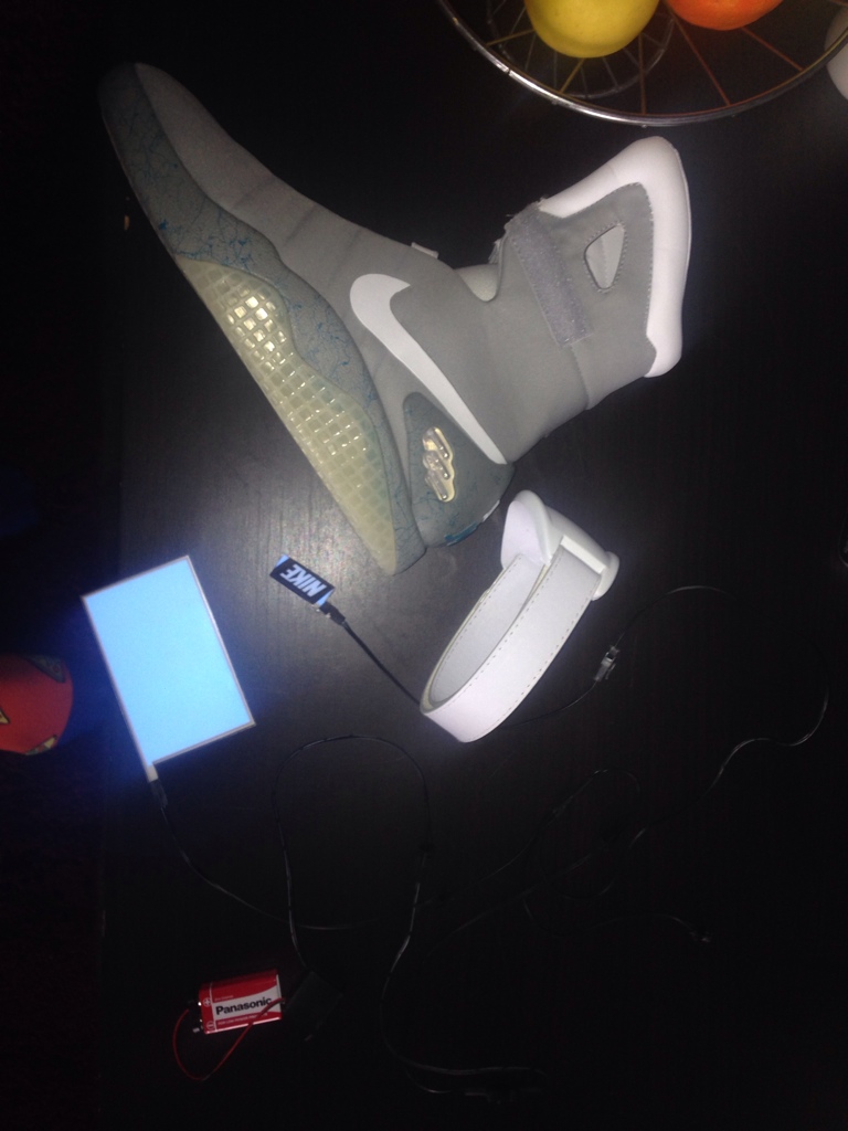

Here is my new strap and layout for el sheets and inverter with on/off switch just got to put in all in lol when I get chance , toe mod looks good toImageUploadedByTapatalk1394460022.286776.jpg

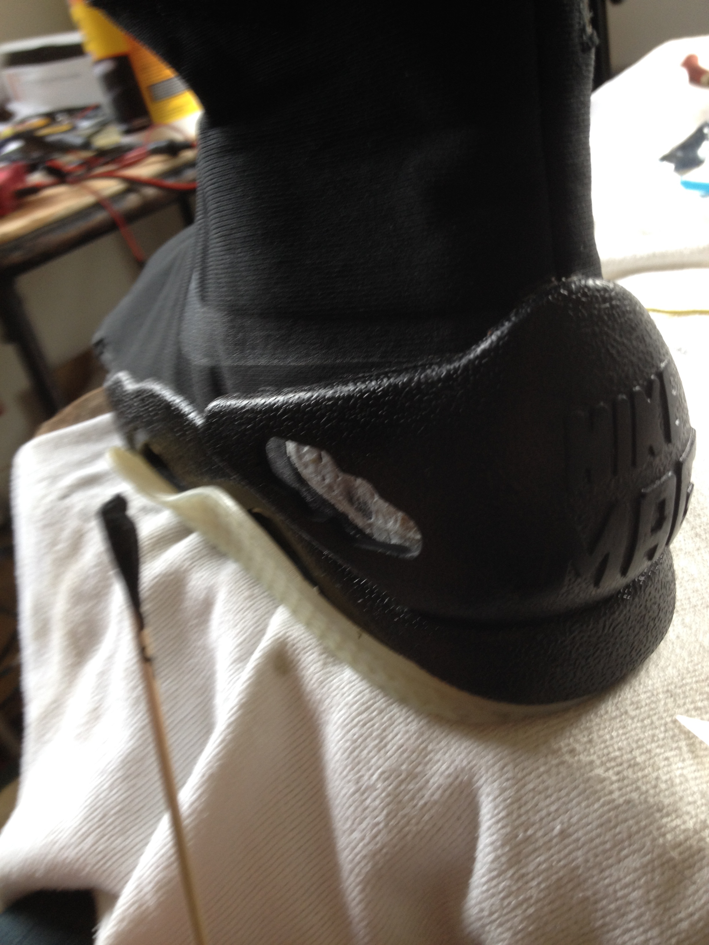

IMG_0671.jpgIMG_0672.jpgjust finished painting first sole i got this pro paint from (turtle feathers) a site just for shoe moders :D
i applied it with just a medical Qtip come out perfect was going to air brush but it applied so even wit just a Qtip ??? go figure lmao
