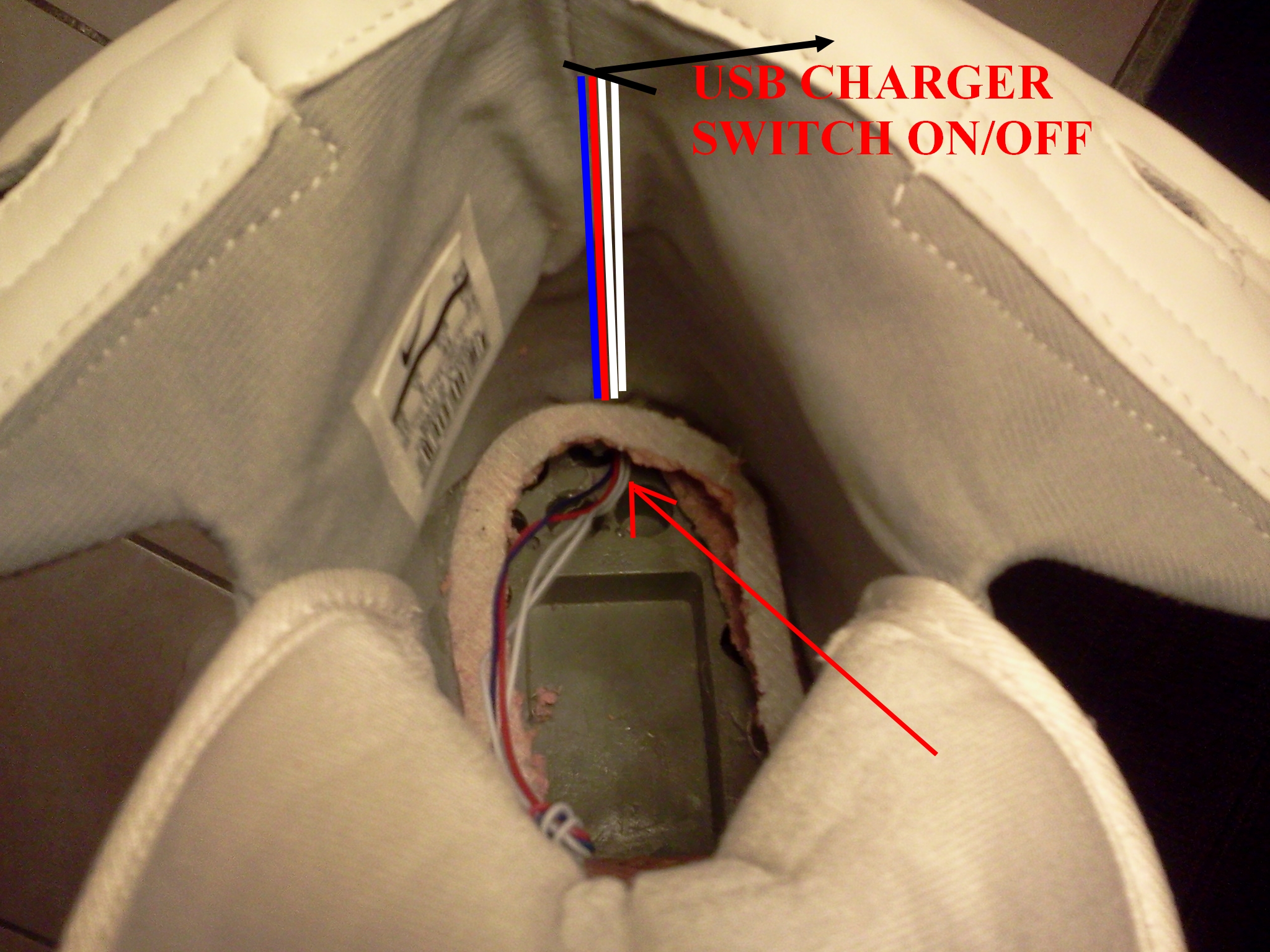

View attachment 249745View attachment 249746
What are the benefits and the disadvantages of 3Volts battery and 9Volts Battery ? Which method is better ?
When i opened the sole, i saw a long plastic strip ! I should remove it ?
And last question : How can i remove the wire of the USB CHARGER & Switch ? :eek
Best regards.
Anybody can't help me ? :cry
yes, remove those clear rectangular rubbery pieces and circular clear rubber pieces.
just cut off the USB charger and switch wire. You can pull it out and stretch it a bit and then just snip it off.
It doesn't matter if the cable stays in the grey fabric, its super glued between the grey fabrics so almost impossible to remove.
cut the wires or if you can pull them, just pull them out.
