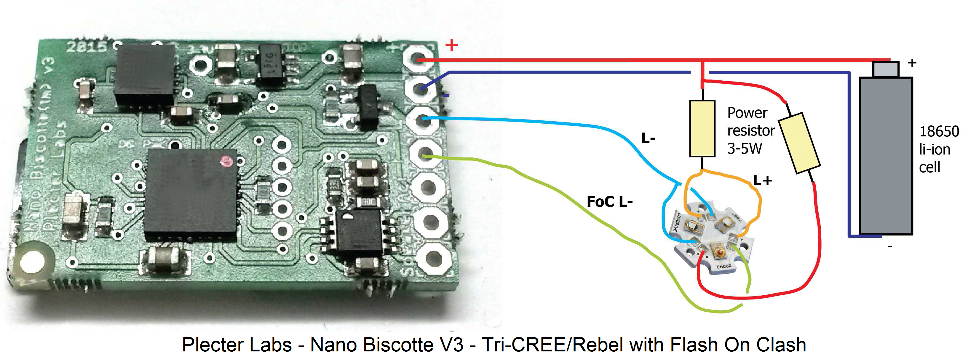

Which Nano Board do you have? It might not be driving the led to full capacity, I know the NB V3 only puts out 2 amps to the LED which isn't enough to fully drive 3 cree Dies.
If it is the V3, I think he's O.K. depending on how he wires it...
SOUNDCARD - PLECTER LABS - NANO BISCOTTE V3 - WIRING DIAGRAM FOR TRI-CREE WITH FLASH ON CLASH - .png
Diagram from the Plecter Labs Nano Biscotte V3 Manual.
Two in PARALLEL and the third for Flash On Clash should work just fine. :)
soul products You might ask erv if you could wire a satellite Power Extender somehow to drive the third LED if you want all 3 LEDs on at the same time.

a NB uses direct drive and does not "put out" anything. The 2A ratings (per *channel*, as quoted by Ridire Firean) from the manual is common sense consideration, the driver part itself is rated for 6.5A and can easily drive 4A if your battery / led accept it. A single output should be able to drive 3 dice (again, if the battery accept the draw and if the resistor or drive are properly adjusted).
To address the OP's question : The TCSS diffuser performs extremely poorly compared to a transwhite blade + PP wrap. Then if you want a daylight blade with colored polycarbonate it's fine but I'd suggest to rather use a amber-amber-white tri-cree instead of filtered white.
As for the juice you are actually putting into the LED, I'm stressing (again) that you need to measure your LED Vf before you can decide on the resistor (or drive adjustment) to use. Once you have set your resistor accurately you'll be sure your LED is getting the expected current.

If the OP is using a pre-V3 Nano Biscotti it needs a separate power extender. Without it the blade will be dim.
Short answer to this statement is "no". Older NB use the exact same 6.5 A rated driver part. Suggestions have been made to either double the driver or to use an external PEx to split the load and allow better thermal management just in case. Same applies to the current NB (v3). Those safety measures have been proposed on forums as I can hardly control the lack of common sense when it comes to high current, fried driver or fried led and I prefer beginners to walk on eggshells.
Also, the NB isn't the thing that limits the current in the LED (unless when adjusting the drive), the external resistor is (and the battery of course).
