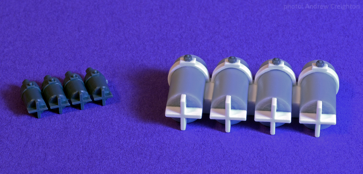

For the most part will be using large kit parts that are similar and have been going through my greeblies stash selecting what looks about right. Here are some pictures of the double studio scale parts I have been scratchbuilding/kitbashing:

Thank you, Taz! The King Tiger vents are 1/16th scale. To be perfect they would need to be 1/17.5th scale, but that's close enough for me. (Didn't want to buy an entire 1/16th scale King Tiger kit, those are too expensive.) Buying just the vents cost me only a few dollars,and yes, they are indeed white metal.

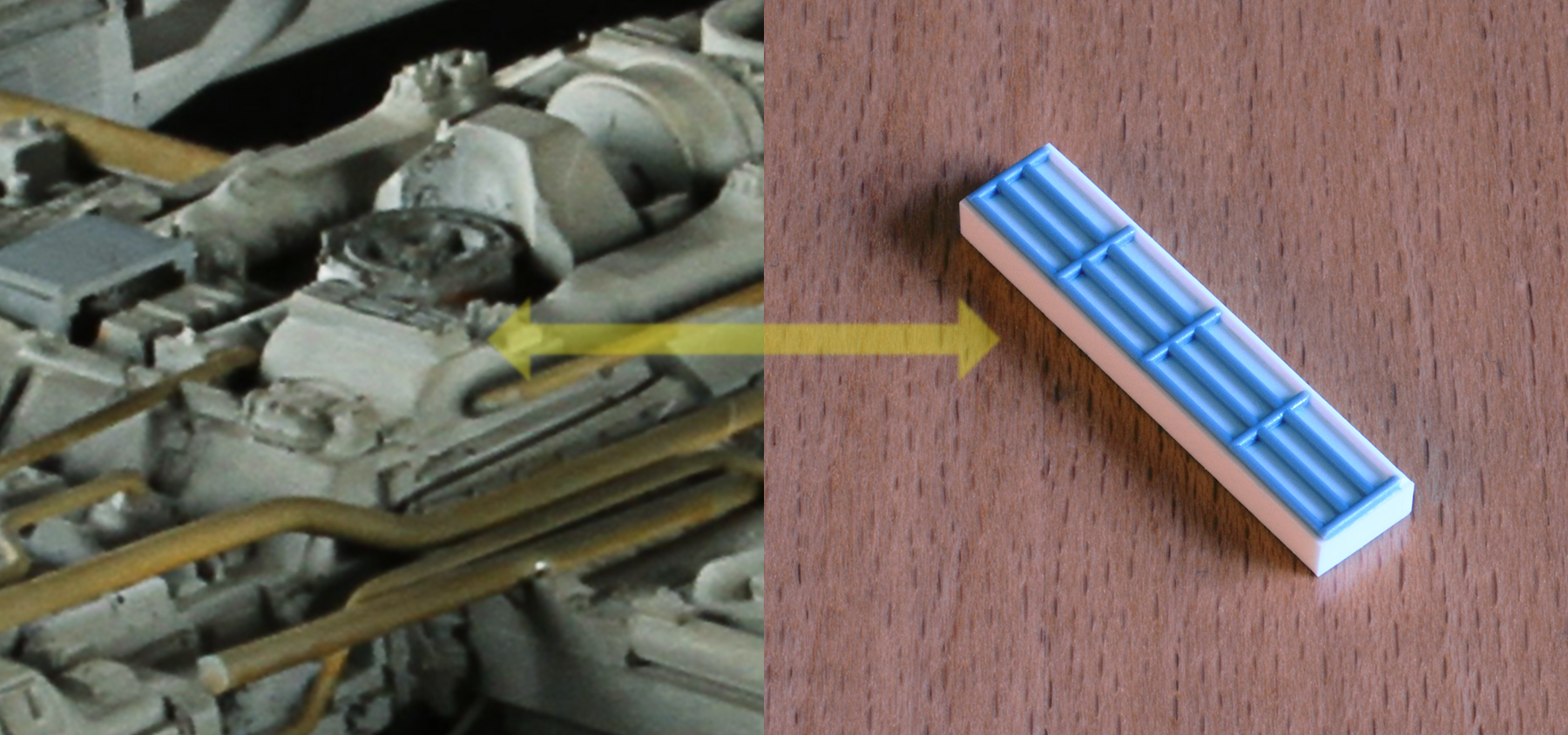

These two scratchbuilt parts are on the Y-wing twice, so when the time comes will be making molds and casting all the multiple ones in resin.

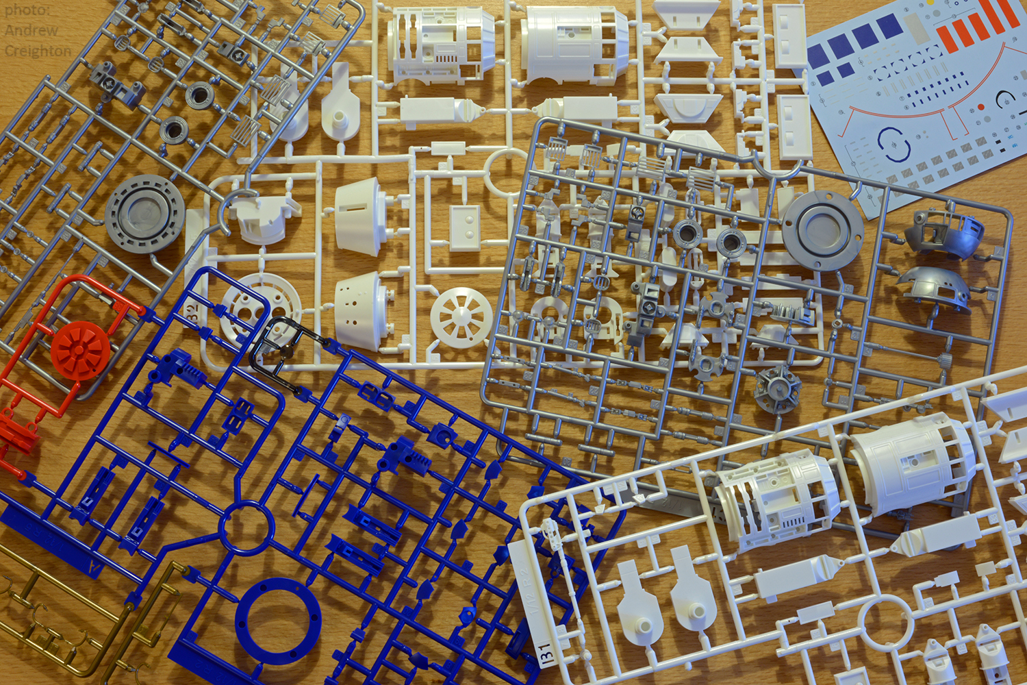

Bandai's 1/12th scale R2-D2 & R5-D4 kit is perfect for this project. Am thinking of taking R2 and giving it red instead of blue panels.
