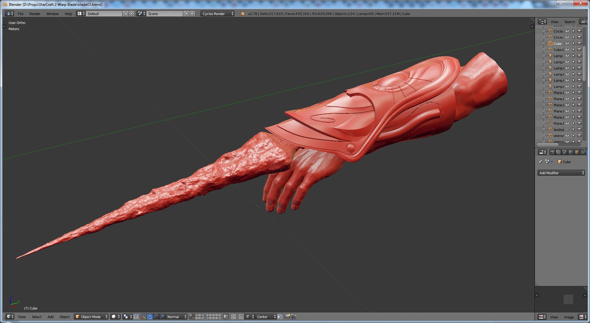

Hey guys, just wanna show you something I've been working on for some time now :). It's basicly like a lightsaber attached to your forearm :).
Viewport from Blender - modeled by me
Looks awesome. When I first played the protoss campaign in SCII I wanted to make on the warp blades, but I didn't want to deal with the issues surrounding retractable blades. Design looks cool so far.
That can be somewhat of an issue but for me making the blade bright enough and evenly bright is going to be the problem since it's not a regular cylinder like a lightsaber

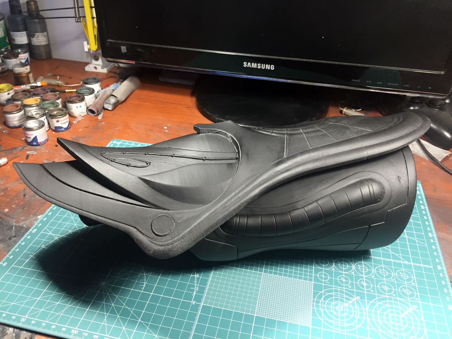

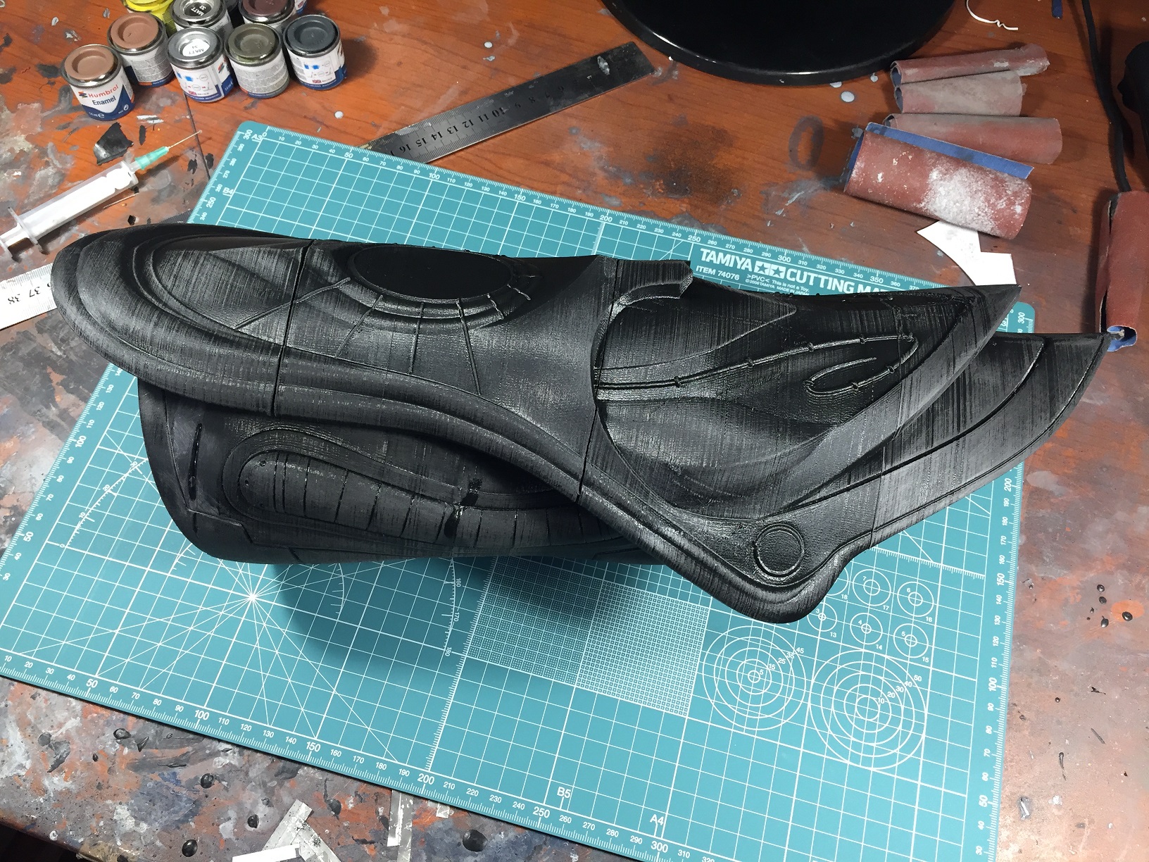

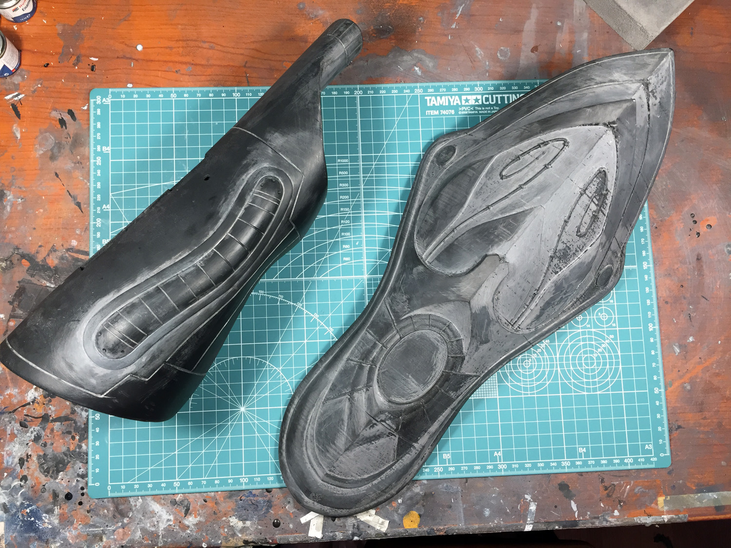

Here's the 3D print, I'm currently dealing with multiple problems surrounding my printers so the quality is really poor but it's still enough to keep it so here it is (electronics are already inside and working)
Print turned out quite nice. Abs or PLA? What are your plans for the blade as far as material? I thought of acrylic but as you mentioned light diffusion will not be easy to sort out.
I used PET-G and PET-G is what I intend to use for the blade since it has really nice transparent colors. Might not work at all but I definitely gonna try it since it allows me to create the shape I want without molds and such.

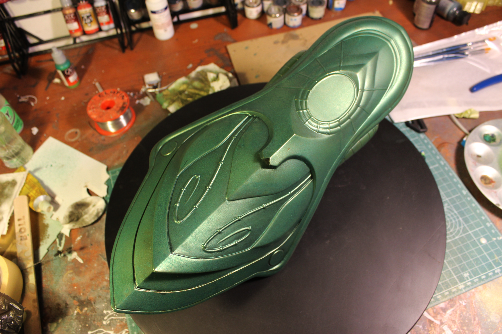

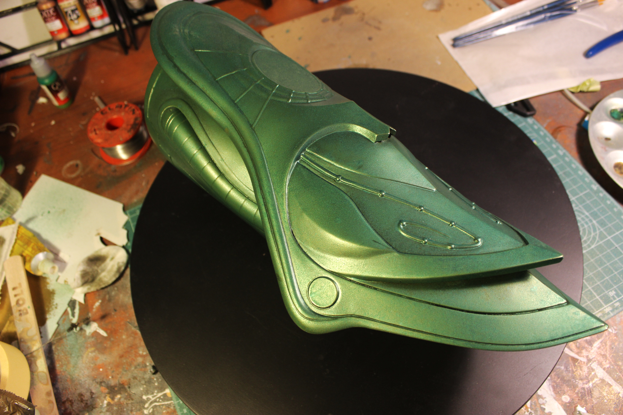

UPDATE! Finished painting, now working on resin stones
Might not be as visible in the pictures but it is heavily weathered. Zeratul is old and has seen many things in many distant places across the universe so this must look old as well :).
