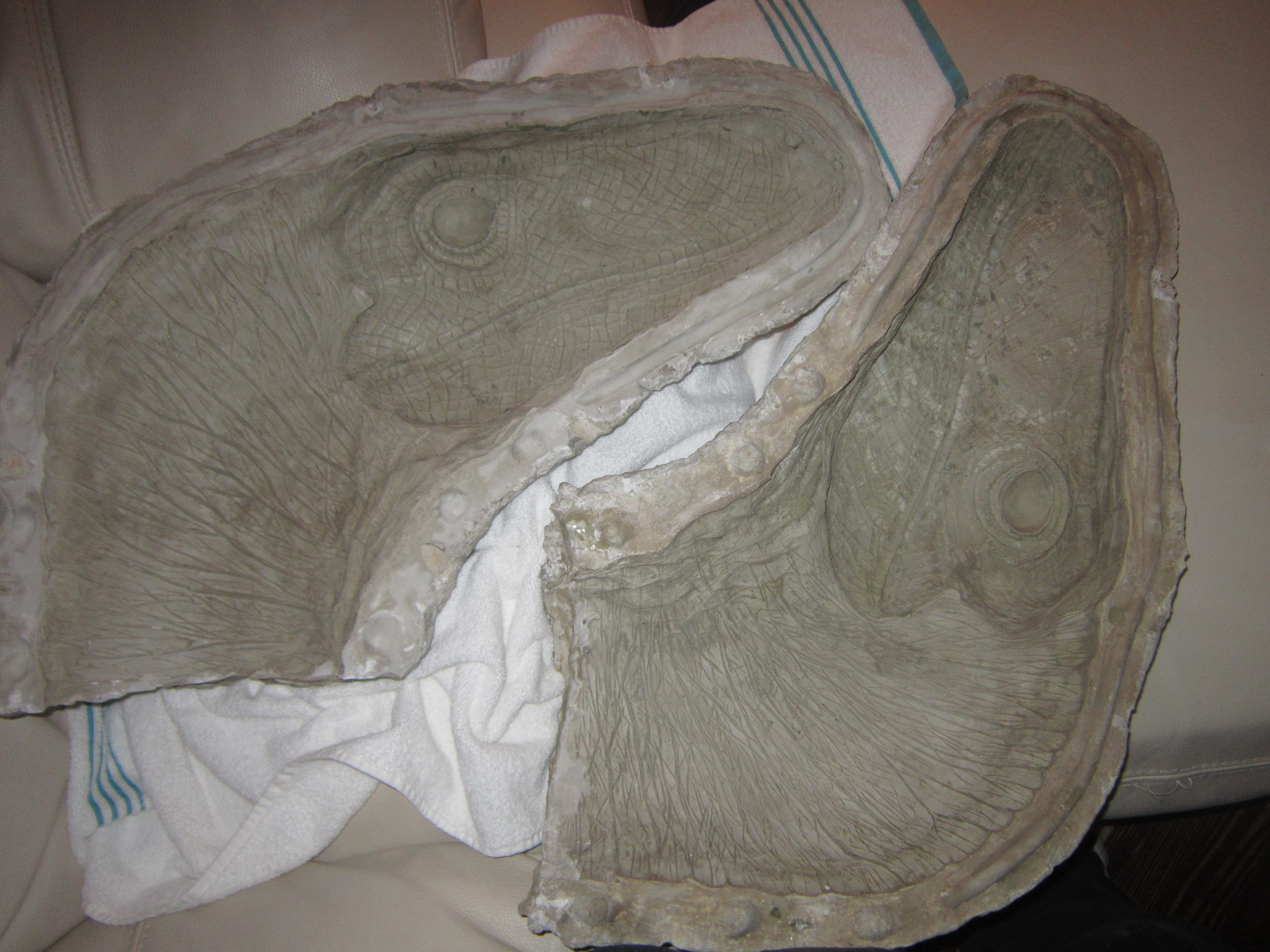

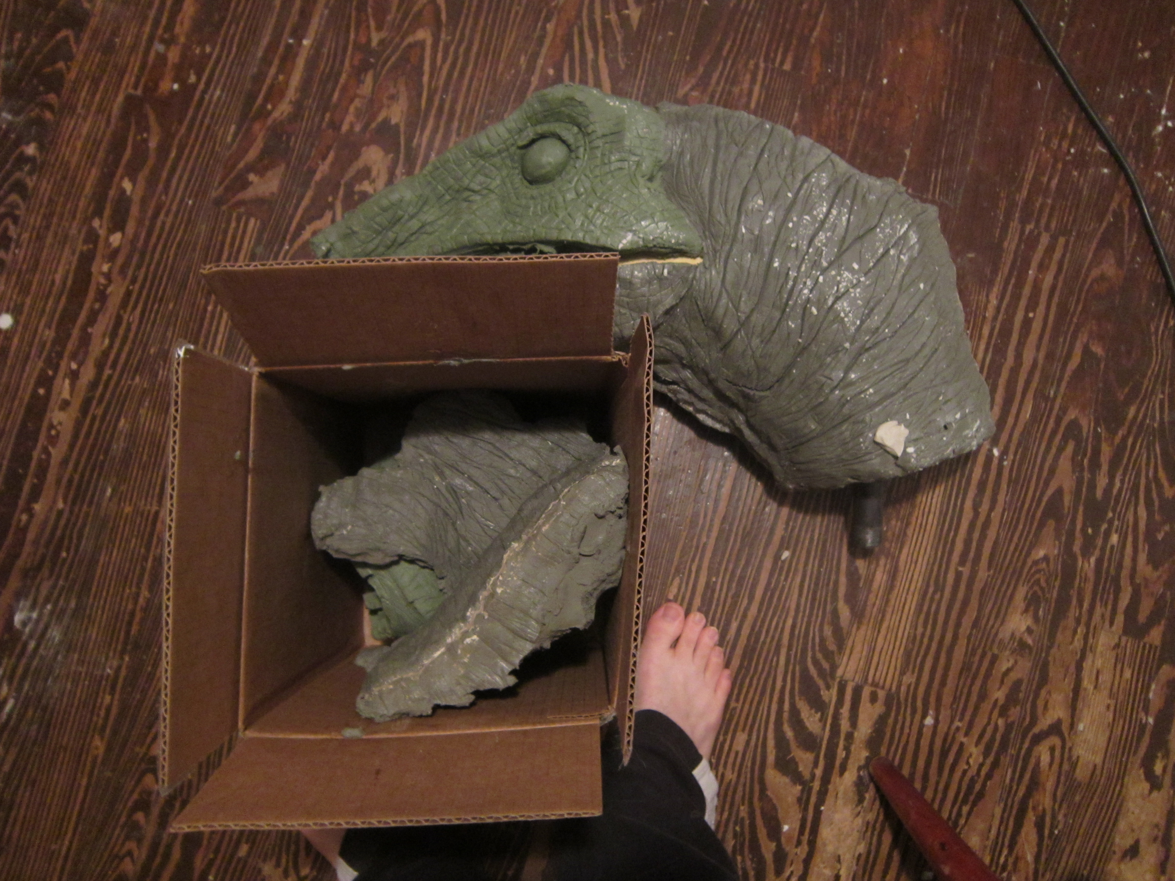

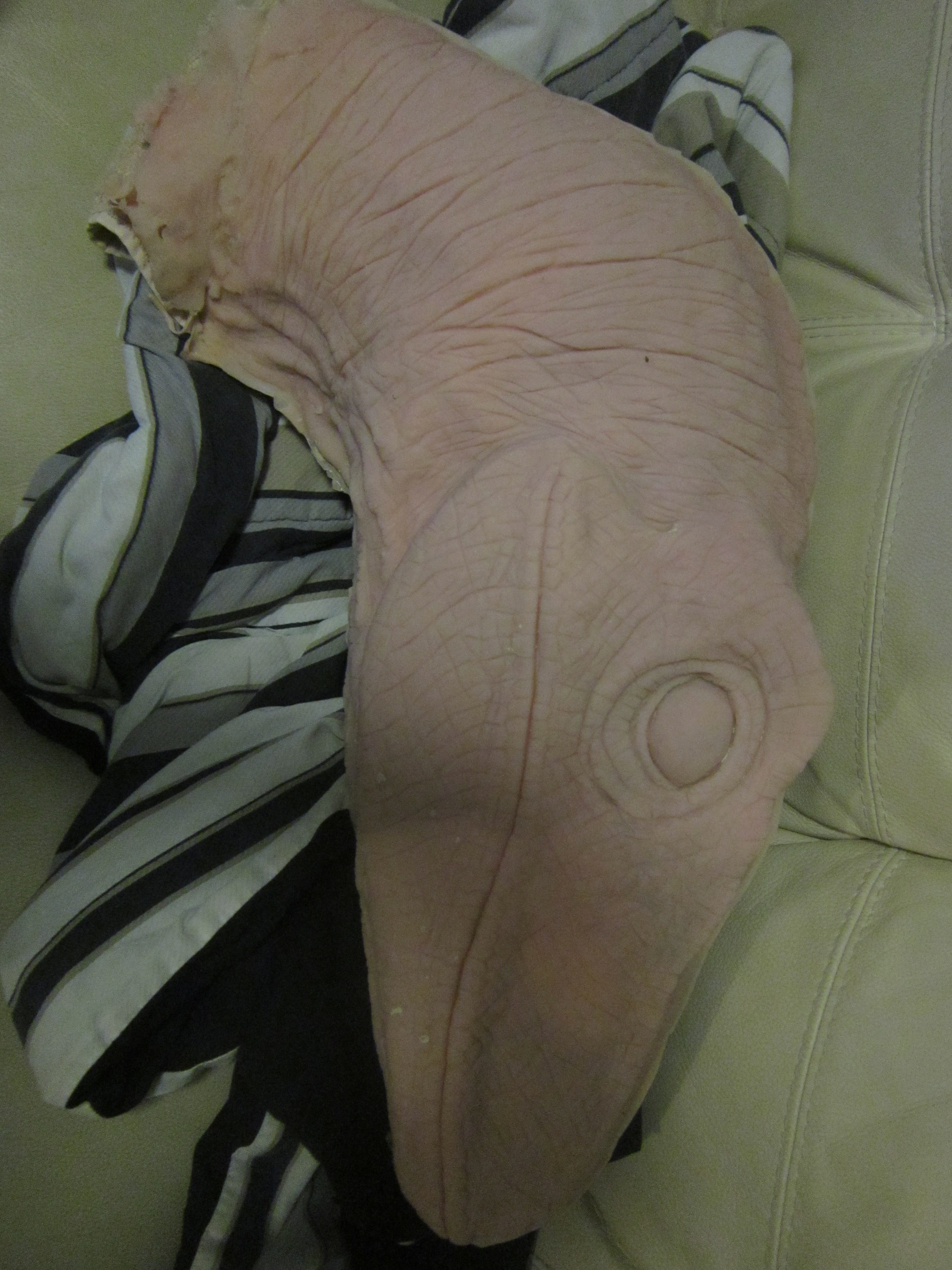

When you cast the GEL-10 into your mould, Get the Right thickness of layers you want & Let it cure Completely.

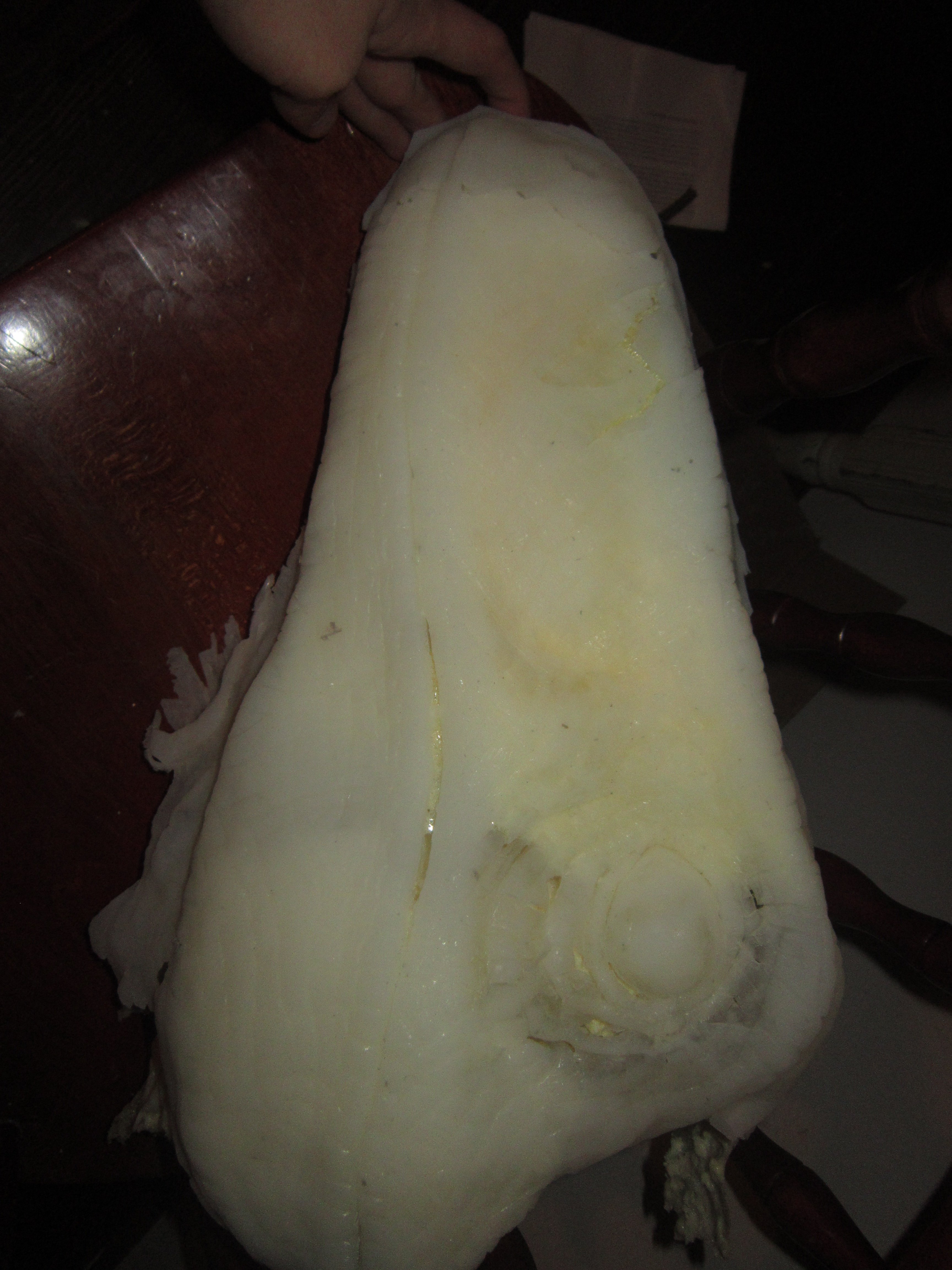

Then you can use Easy-Flo 120 Directly into the mould Behind the GEL-10 Skin, make sure it does not get on the Ultracal mould.
you need to Slosh it around the back of the Silicone you want to
Make an under-skull For, until it Go's Solid White..(5-10mins)
I would apply 1-3 coats until you have a strong thickness..
When it's Fully Cured (30-60mins) you will have A Solid under-skull.
when you remove the Two half's of your stone mould,
you can pull the whole Cast out together and Pull the GEL-10 off the under-skull Like A glove mould.
This will also keep the GEL-10 in its Original Sculpted Form when fitted to the Under-Skull..
