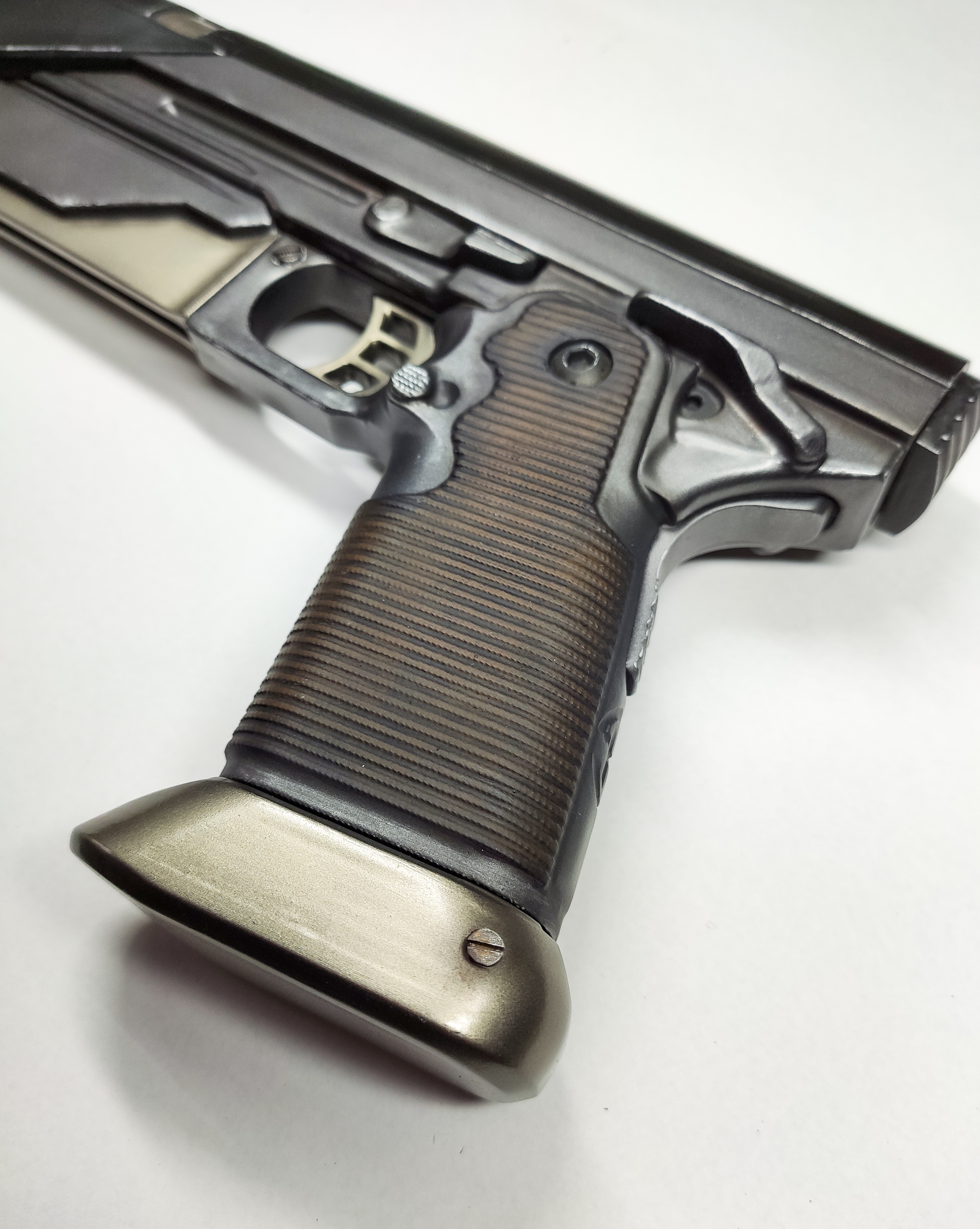

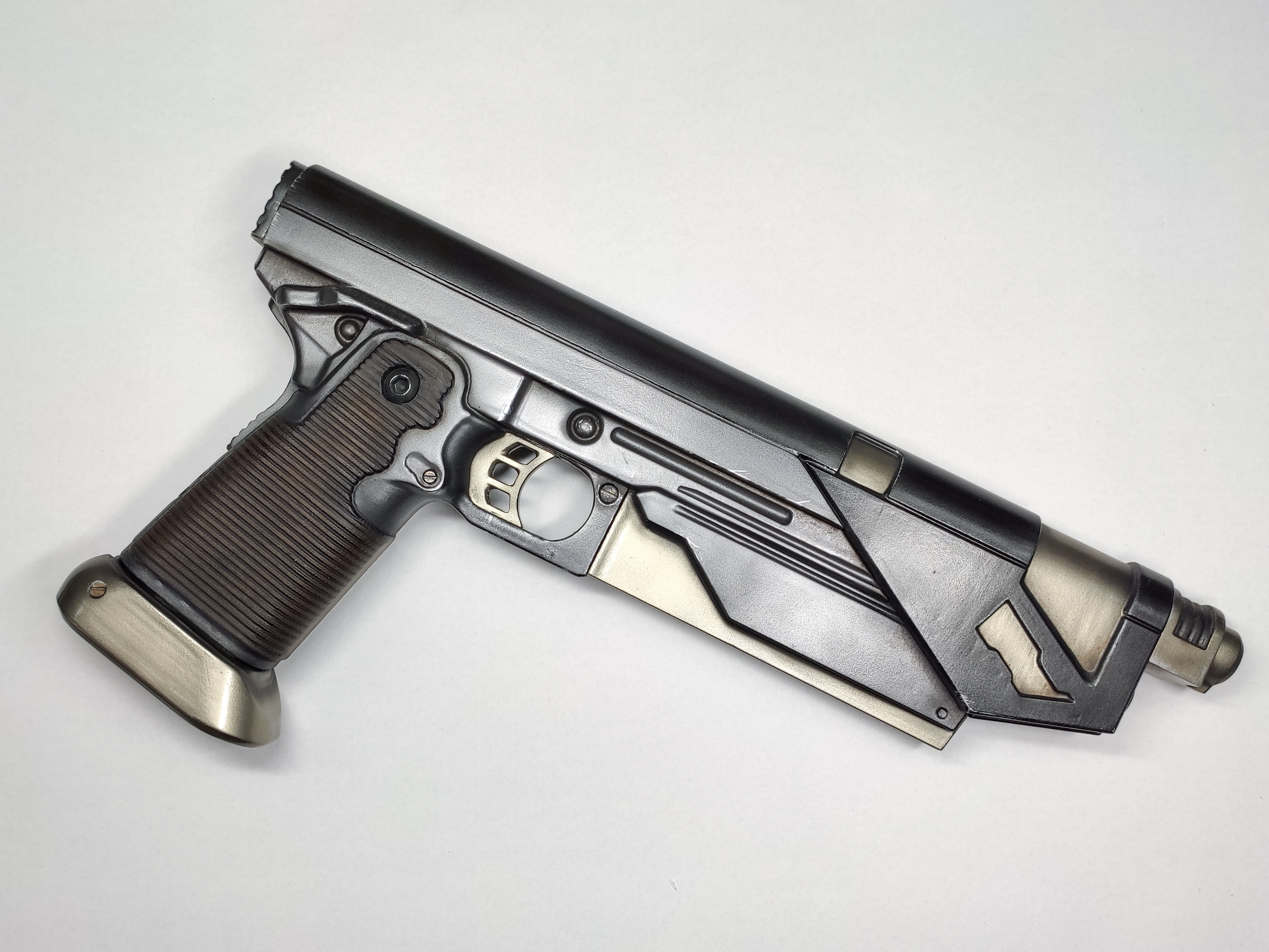

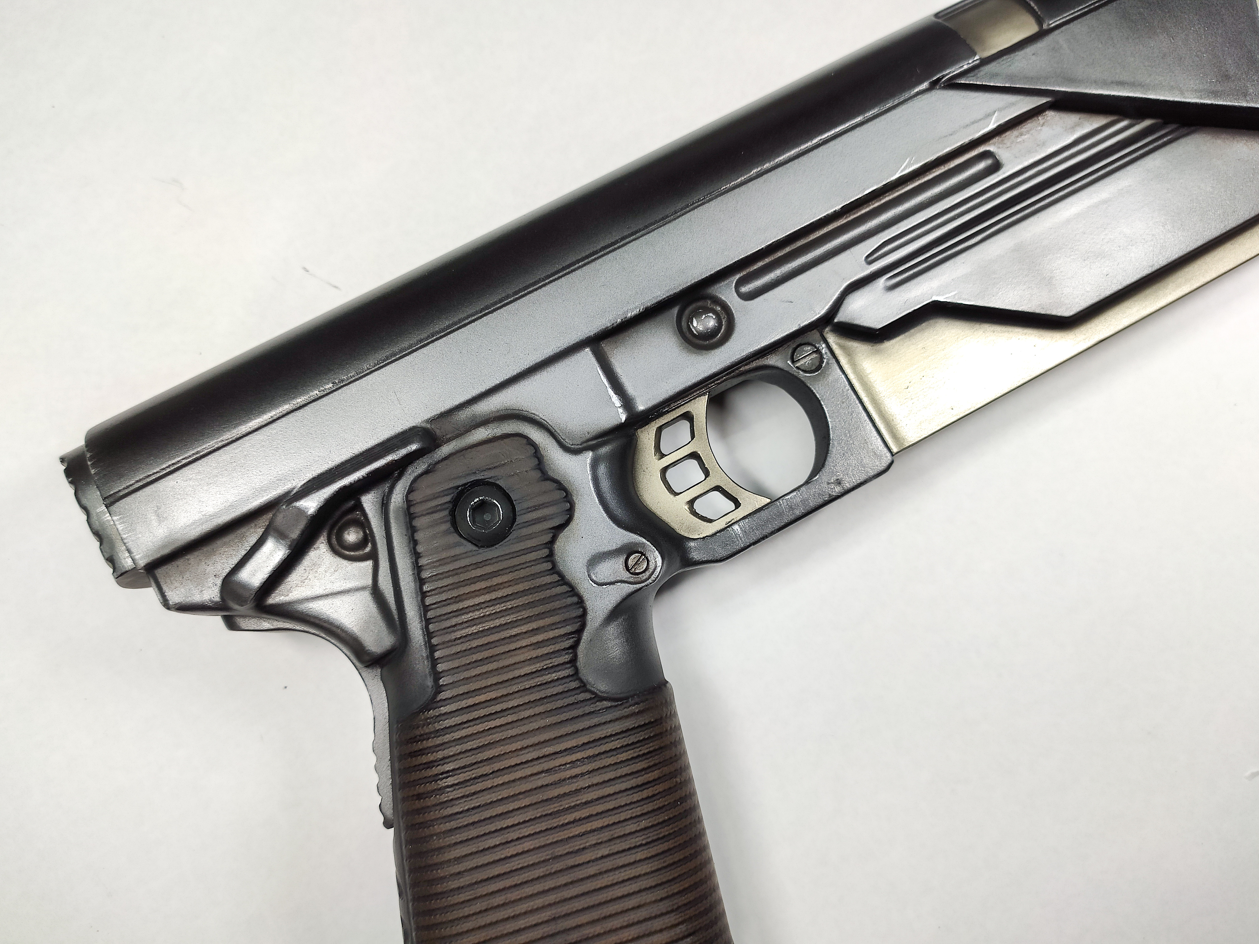

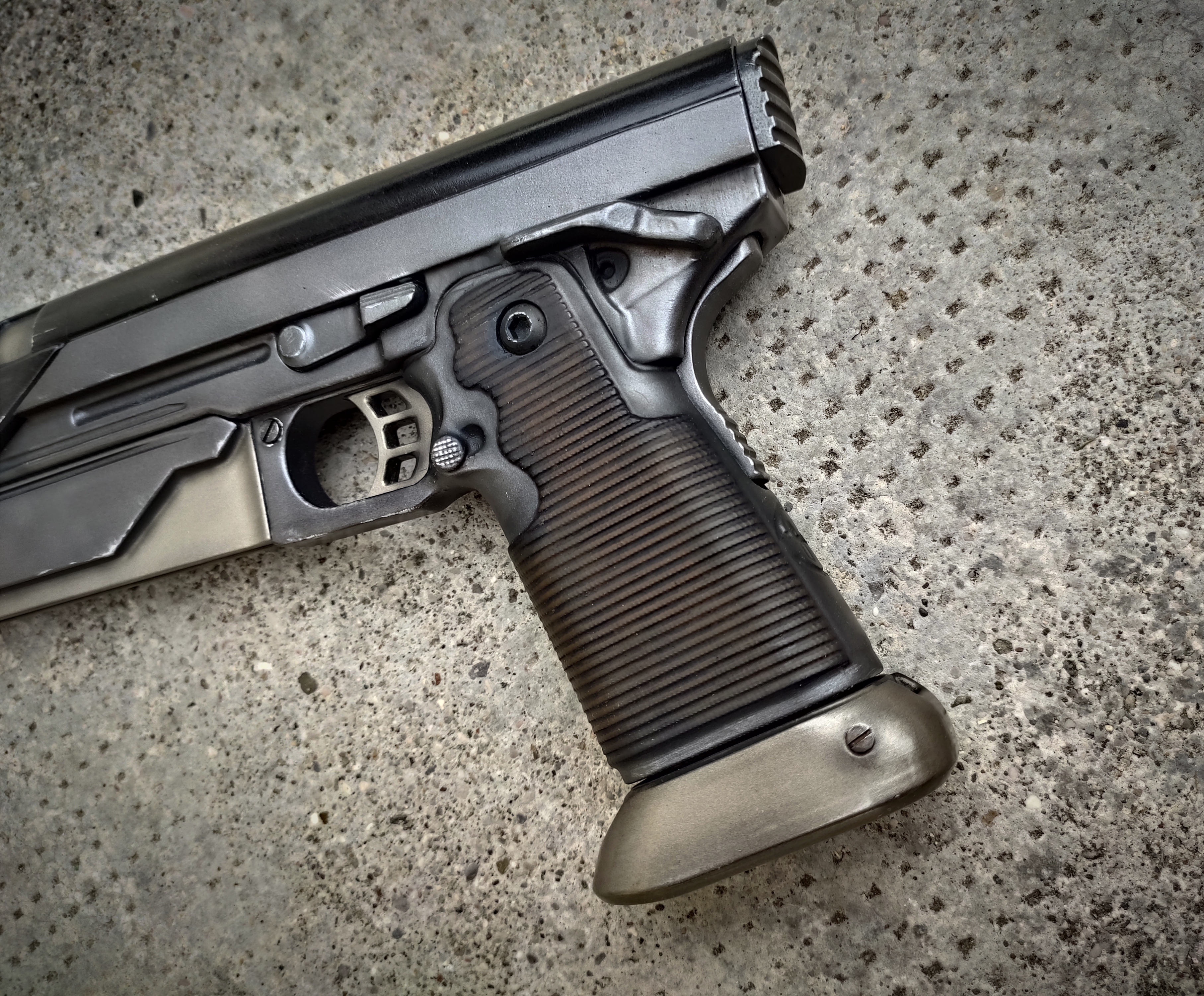

Hello everyone, here are some pictures of my recently finished project. It's a Westar-35 blaster in the live action version, as seen on the show The Mandalorian, most notably used by Bo-Katan and the Nite Owls. This is a purchased 3D printed kit from etsy that i assembled and painted using mostly Alclad metal colors.

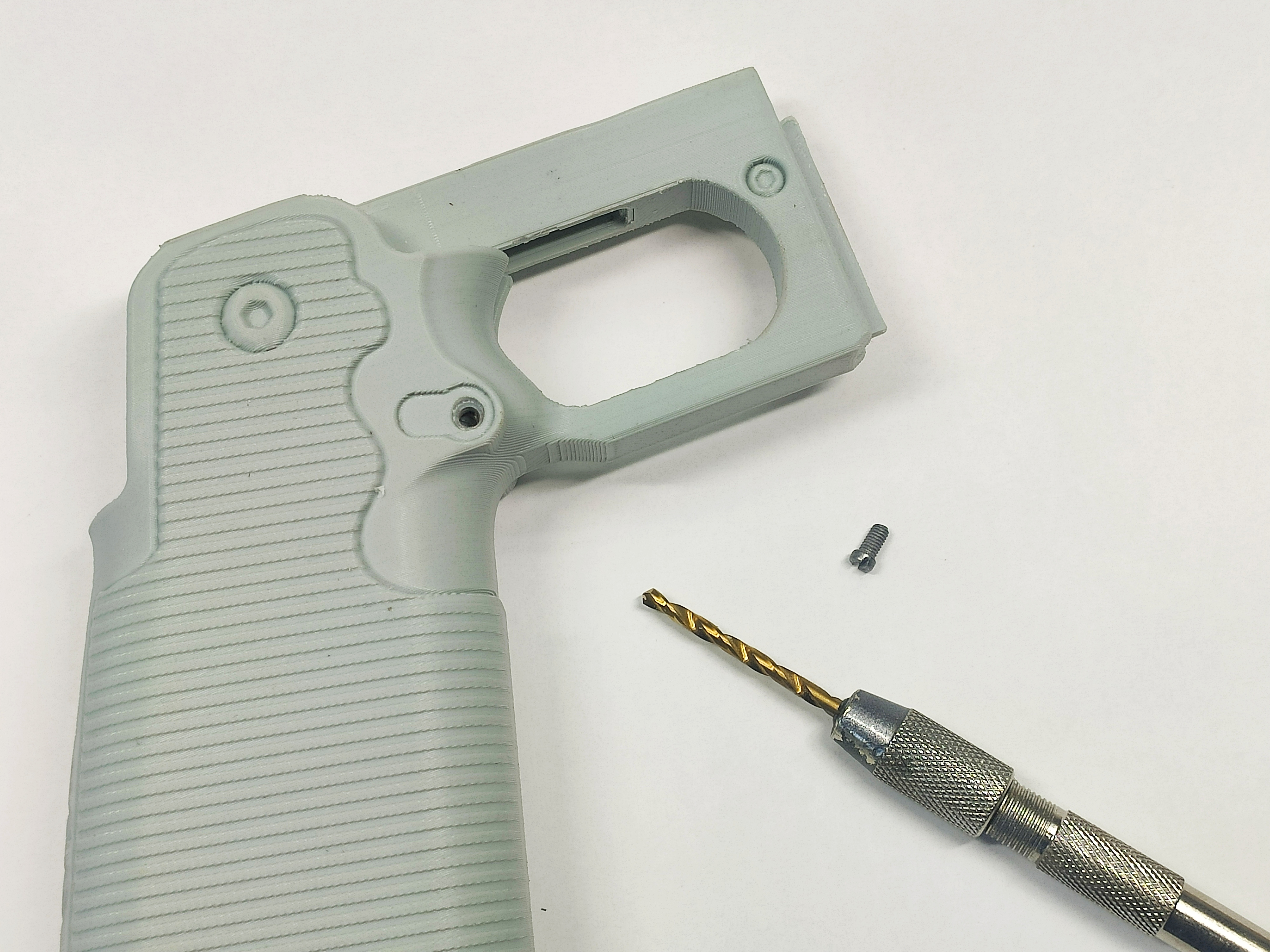

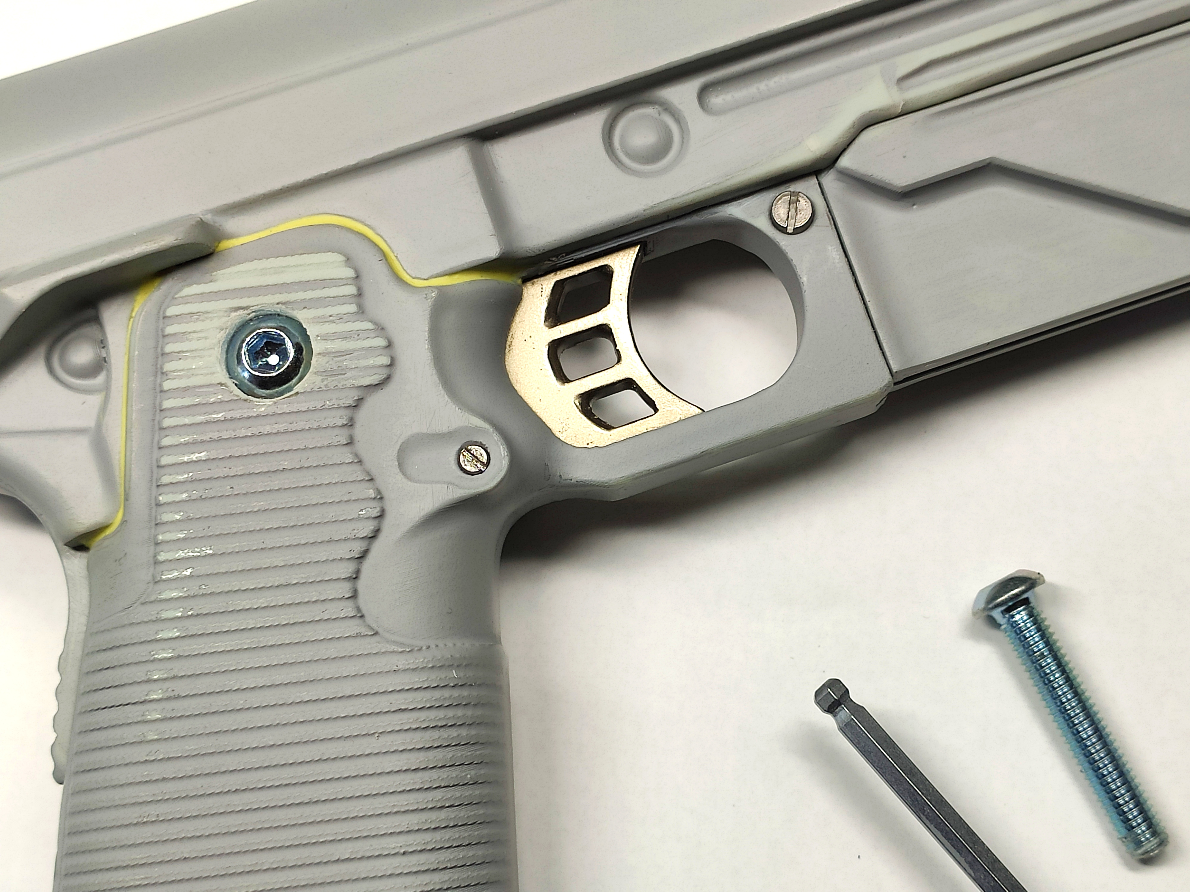

Here is how the kit arrived, it was in several pieces, and the quality of the print was already pretty amazing, but i still went on and applied a coat of smooth-on XTC 3D to help me in the sanding process and remove most of the print lines.
I then proceeded to drill and add real metal hardware in place of most of the screws and bolts printed on the model, to give it a more realistic look and feel. I glued together the whole thing and sealed the only major gap in the body with milliput putty. Then on to painting.

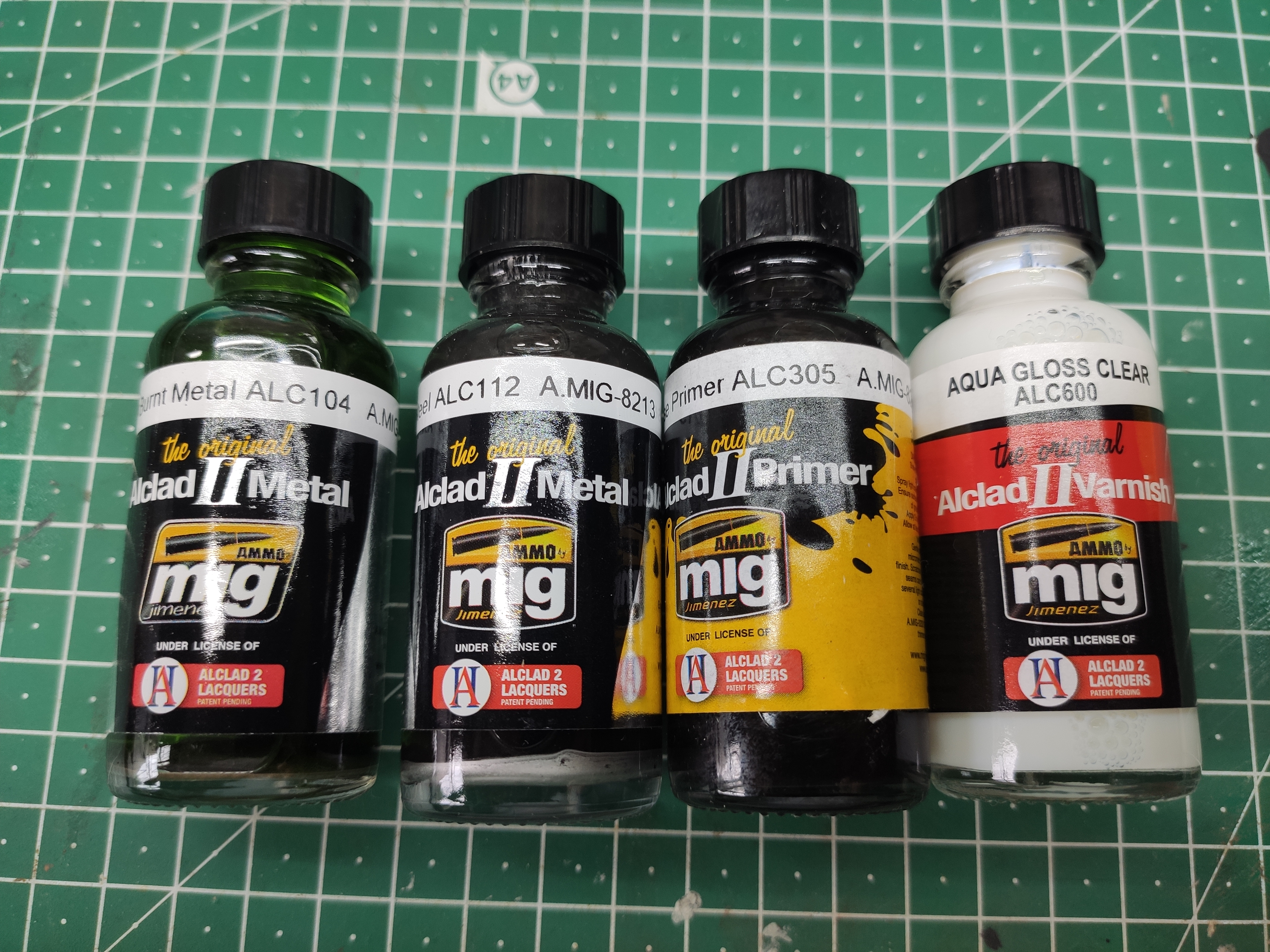

These are the color i've choosen, looking at the very few clear reference pictures that i've found from the show: Steel, pale burnt metal, black and gunmetal. All colors are from Alclad line of metal colors, except for the gunmetal that i already had at home, which is from Vallejo. It is important to note that this model is not 100% accurate to the show used prop, it was a personal interpretation from the artist that 3d modeled the thing, so i also decided to go with the most accurate colors i could find, but give my own interpretation to the color pattern (while still being fairly close to the show). I cannot reccomend enough the aqua gloss finish if you are working with metallic paints and props, that stuff really sells the effect of metal and turns your plastic into an amazingly realistic metal piece.

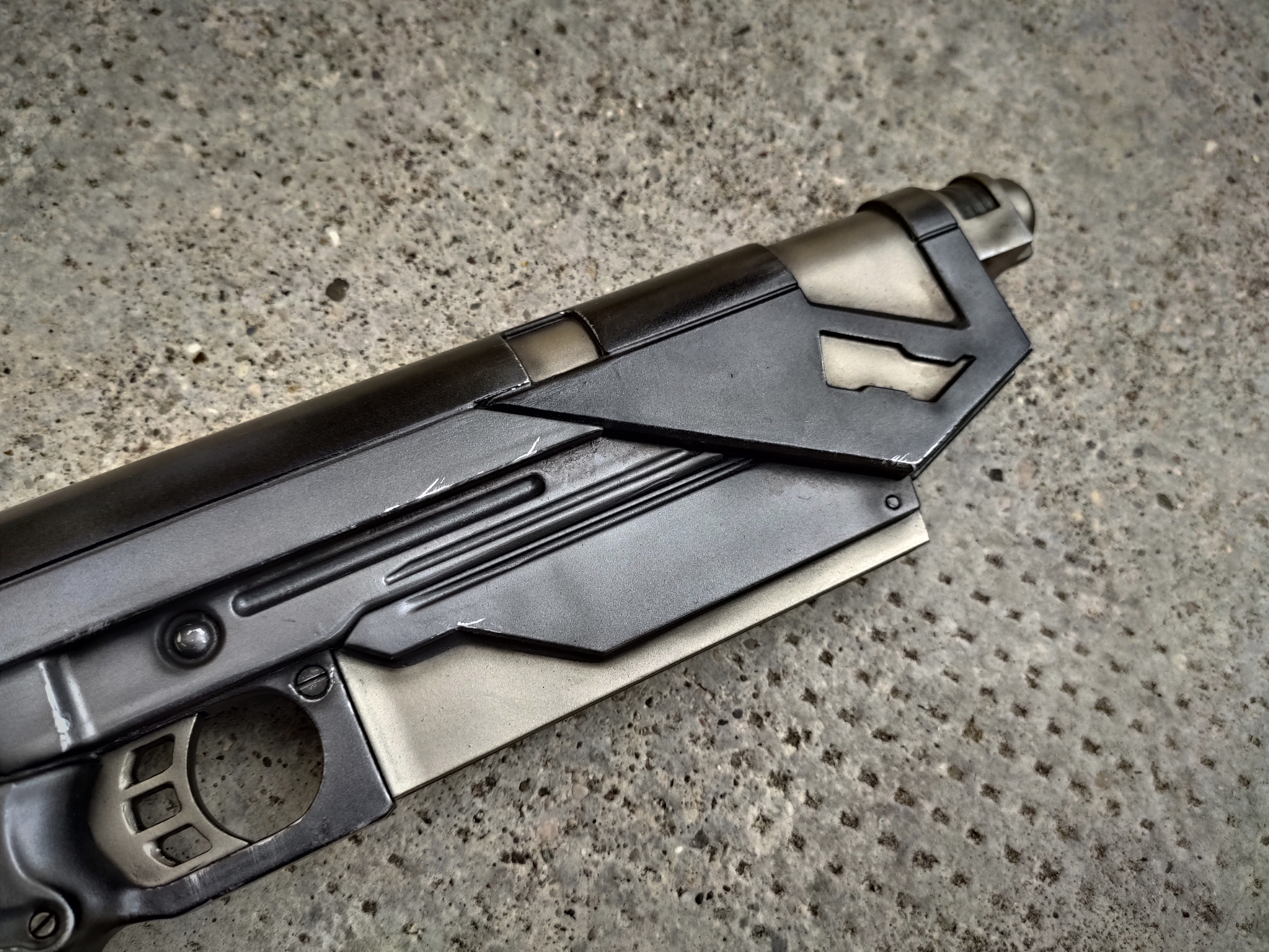

Here are the first two colors down, steel for the main body and black with a thin layer of gunmetal for the upper part, to give it a bit of a sheen.

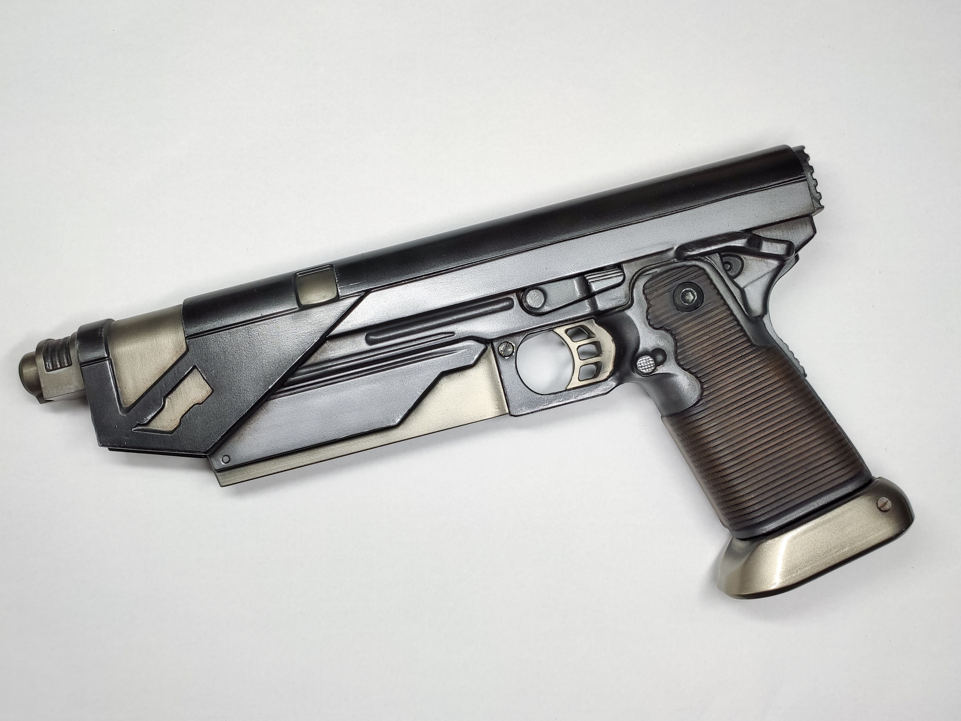

And the final result, with the pale burnt metal added and the final acrylic weathering. The grip was handpainted using acrylics, dark brown for the main base coat with drybrushed wood color on top and a black wash to make it pop.

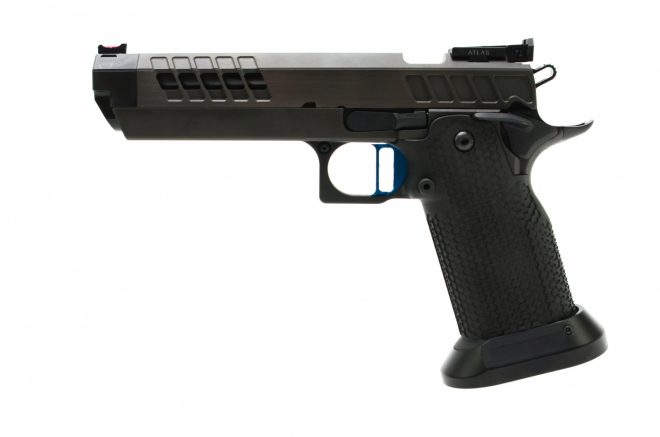

Never noticed that the base of the prop is some sort of 2011 styled pistol. It has some competition upgrades like the magwell. Glad to see Star Wars is still building props on real objects!

Hedonist Farmer , that's an awesome paint job! I'm a decent painter, but that's miles above what I can do. Well done!
I'm curious, does the grip safety actually compress or is it fixed in place? I remember having a toy mini-uzi (back in the old days when one could get such things) that was a massive pain to actually hold, because the grip safety was just molded on and jabbed you in the hand.

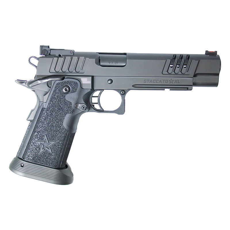

Again, pretty sure its a 2011 (a spiritual successor to the 1911, which is where the grip safety is from). Particularly this looks like an Atlas or Staccato with a custom grip.

Thanks! No the grip safety, while being molded as a separate piece, it does not move once in place, but it's still pretty comfy to hold unless you have super tiny hands. All the moving parts except the magazine are fixed in place.

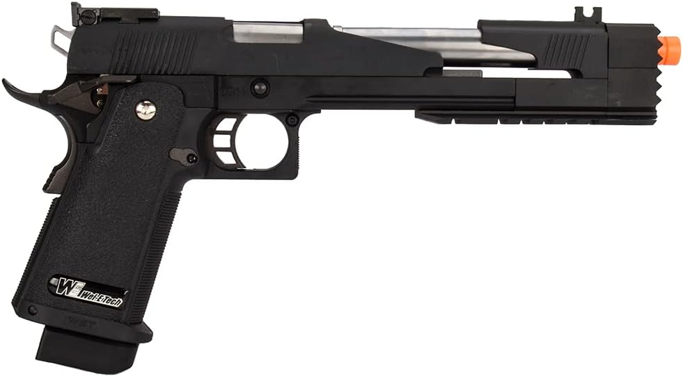

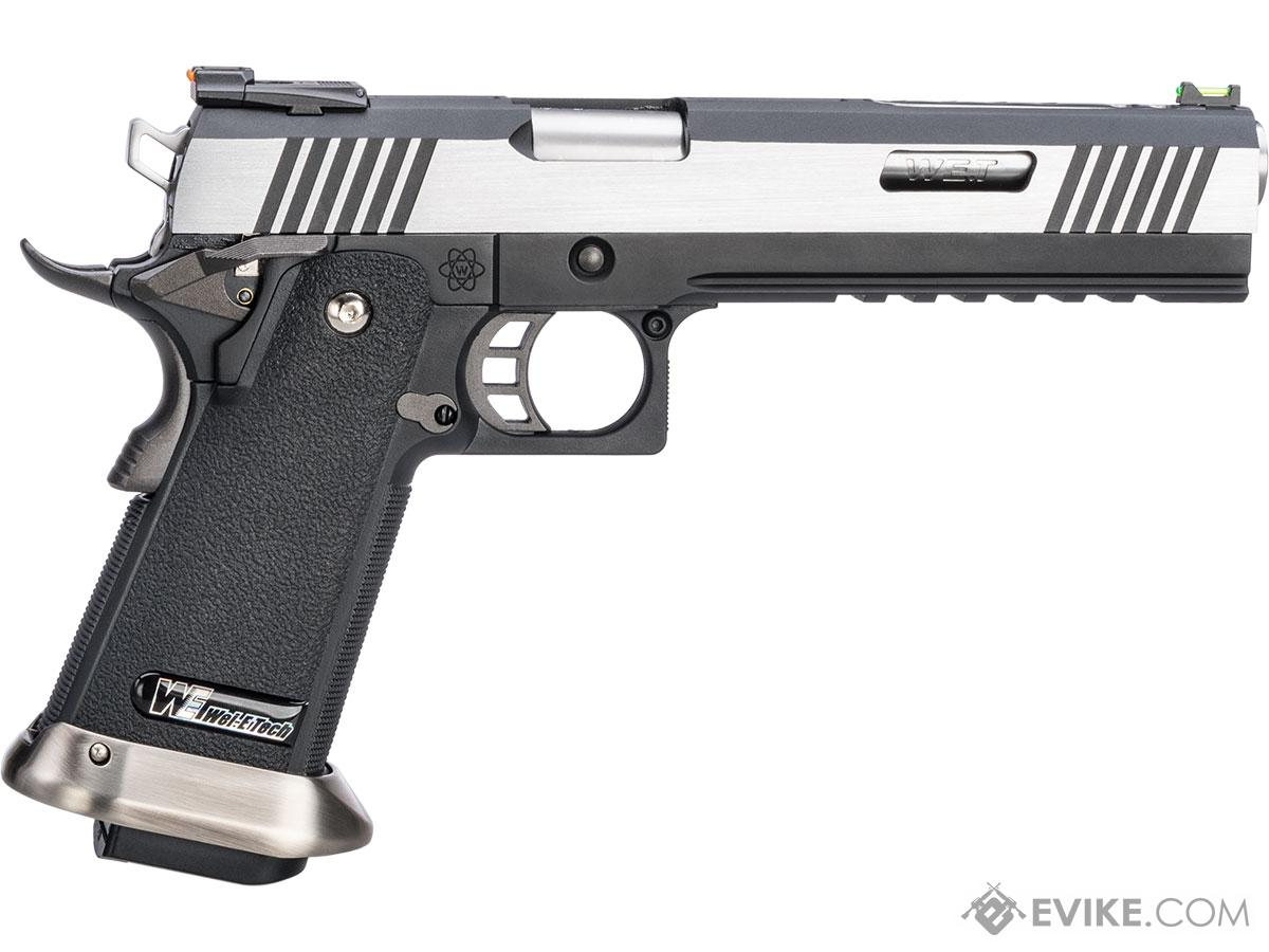

Actually strikes me as an airsoft pistol (Tokyo Marui Hi-CAPA 5.1 Competition)
I agree on swapped or custom grips
oooh, now we're getting somewhere... "Long slide"

Gilmortar and Parts of Star Wars identified the base airsoft as the AW Custom Hi-Capa Competition Grade:
I found the HX1102 and tried to point it out to Parts of SW having *clearly* missed it was already fully identified previously.

I will say that it is worth noting that although many of the details are the same with Sabines’ blaster the Mandalorian show pieces are *much* crisper (thus easier to ID the AW Custom). Considering some crucial geometry has moved around and softened on Sabines blasters it makes sense they are probably the results of a modified 3D scan of those blasters.
