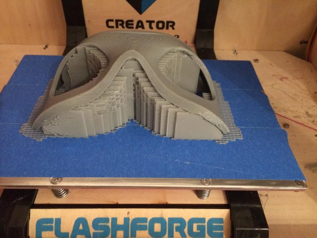

Both masks were sculpted in Zbrush (the arsenal was my first attempt at Zbrush) then we printed/finished them. The Arrow took some experimenting as we needed to keep the texture intact so it was printed upright with supports at 80 microns. Came out beautifully, very proud of our little printer considering we've only printed as high as 100 microns before now.
