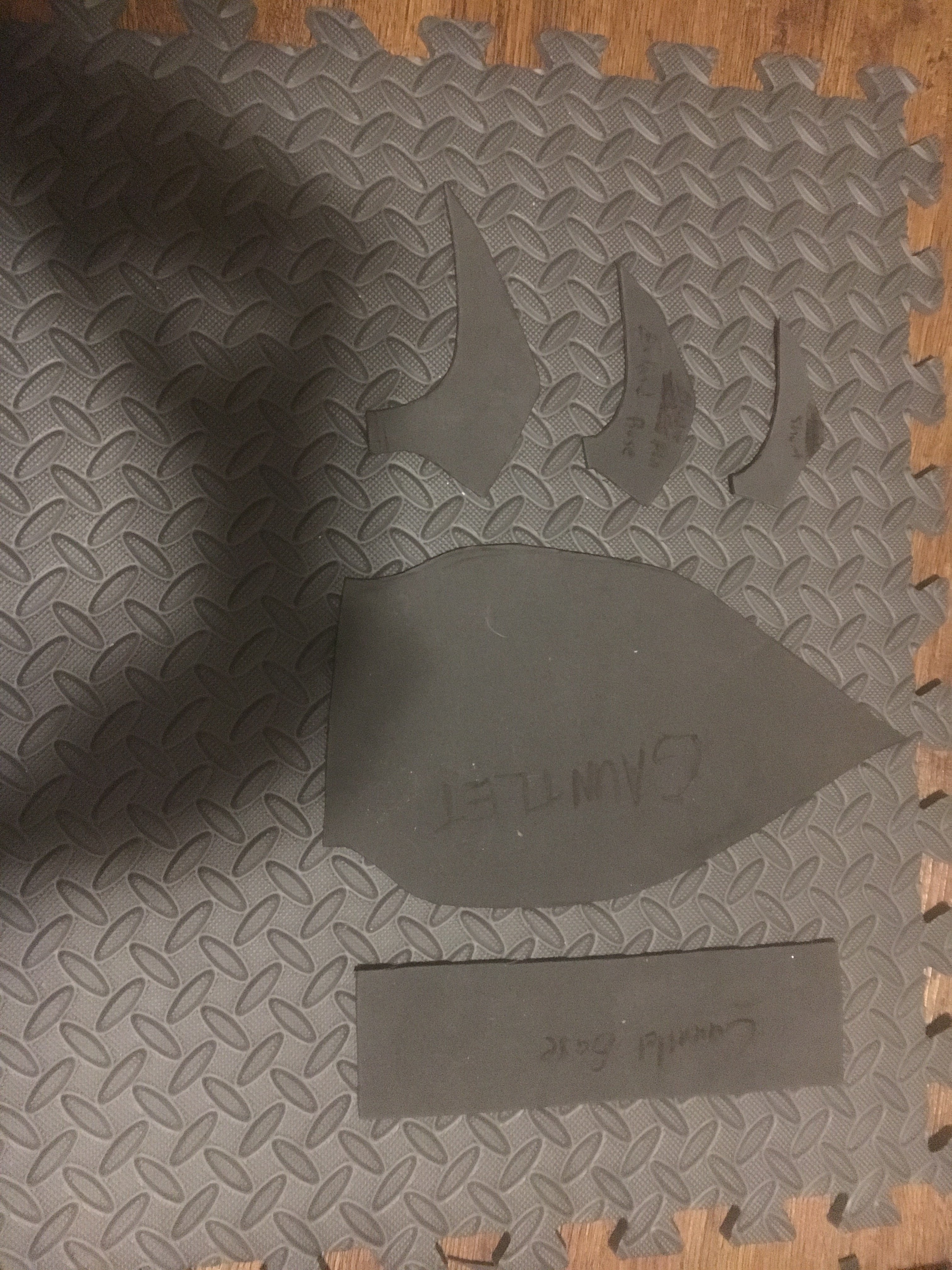

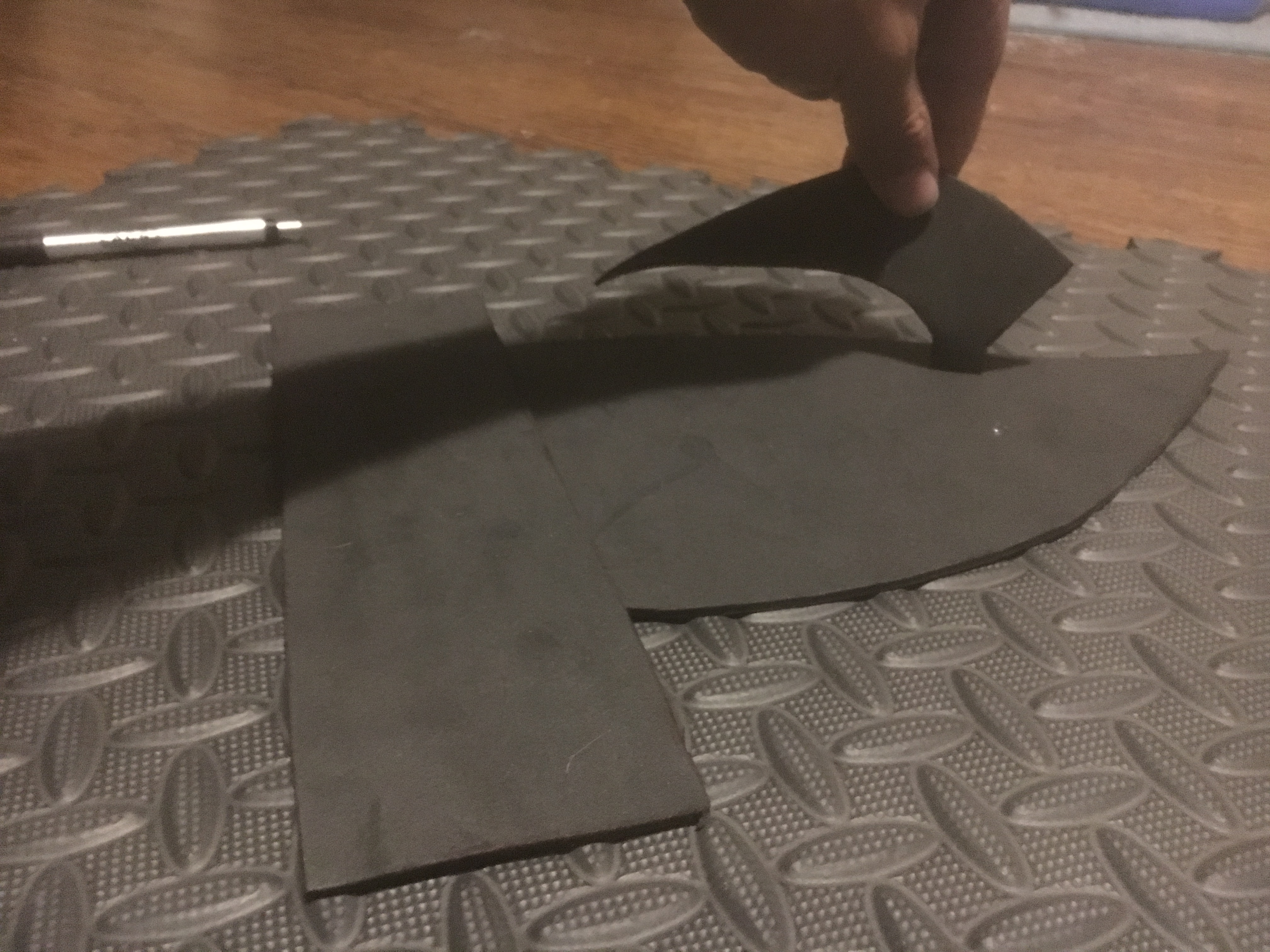

Now what you will see attached in this post so far is, the first gauntlet. I took a set of craft foam sheets and made templates of the fins, the base, and the bracket.

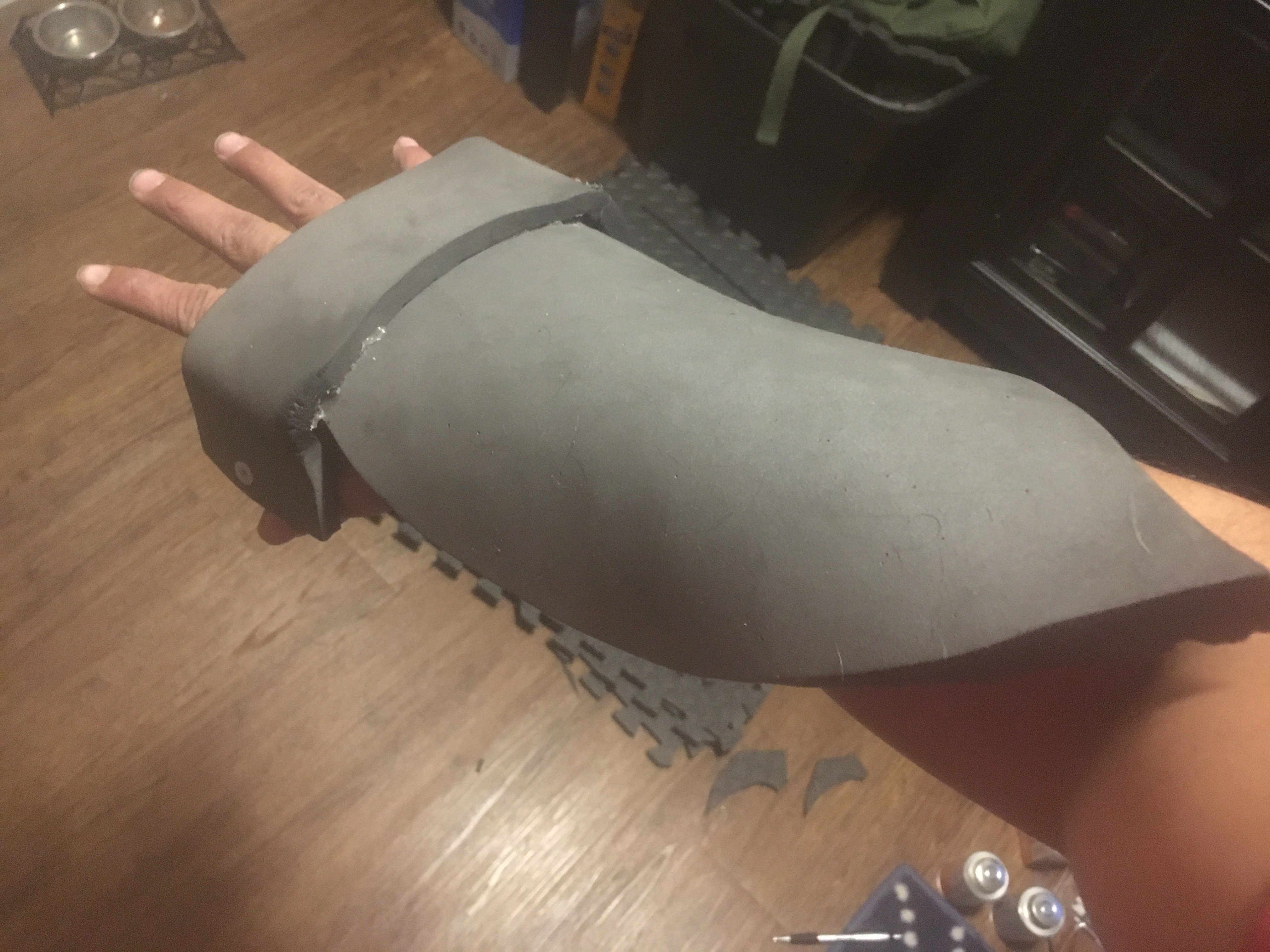

Then I simply traced them along the eva foam. I got a PVC pipe cut into 4 pieces.
2 for the gauntlets and two extras, just in case I messed up so that I had spares.

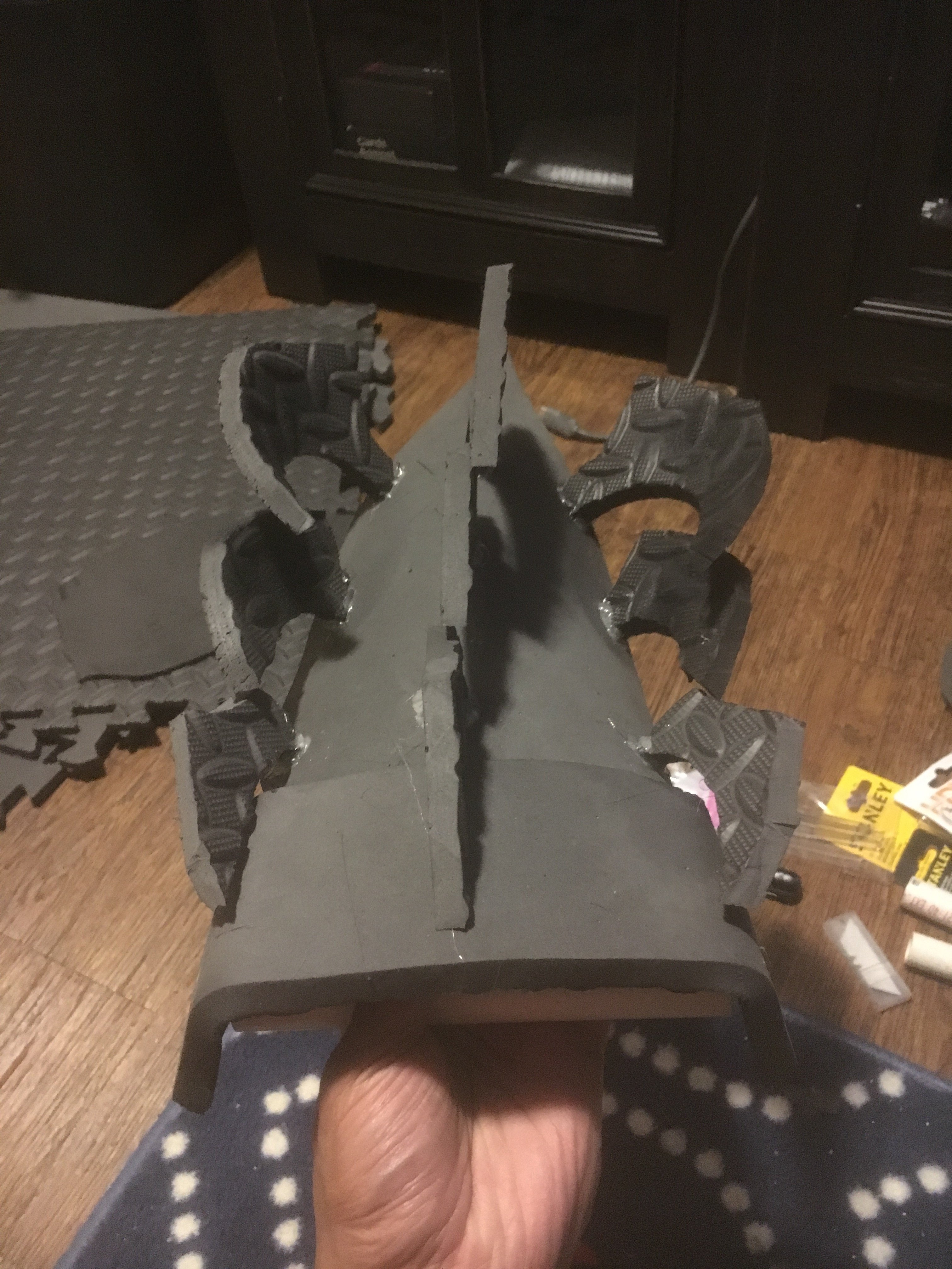

In order for me to get the placement I wanted for the PVC PIPE to act as a handle in the gauntlet, I took plaster wall screws and inserted them in the sides of the bracket. This way, I can user PVC ADHESIVE to bond the PVC with the foam. After I did that, I used my heat gun to warp the foam I had already assembled to give it shape.

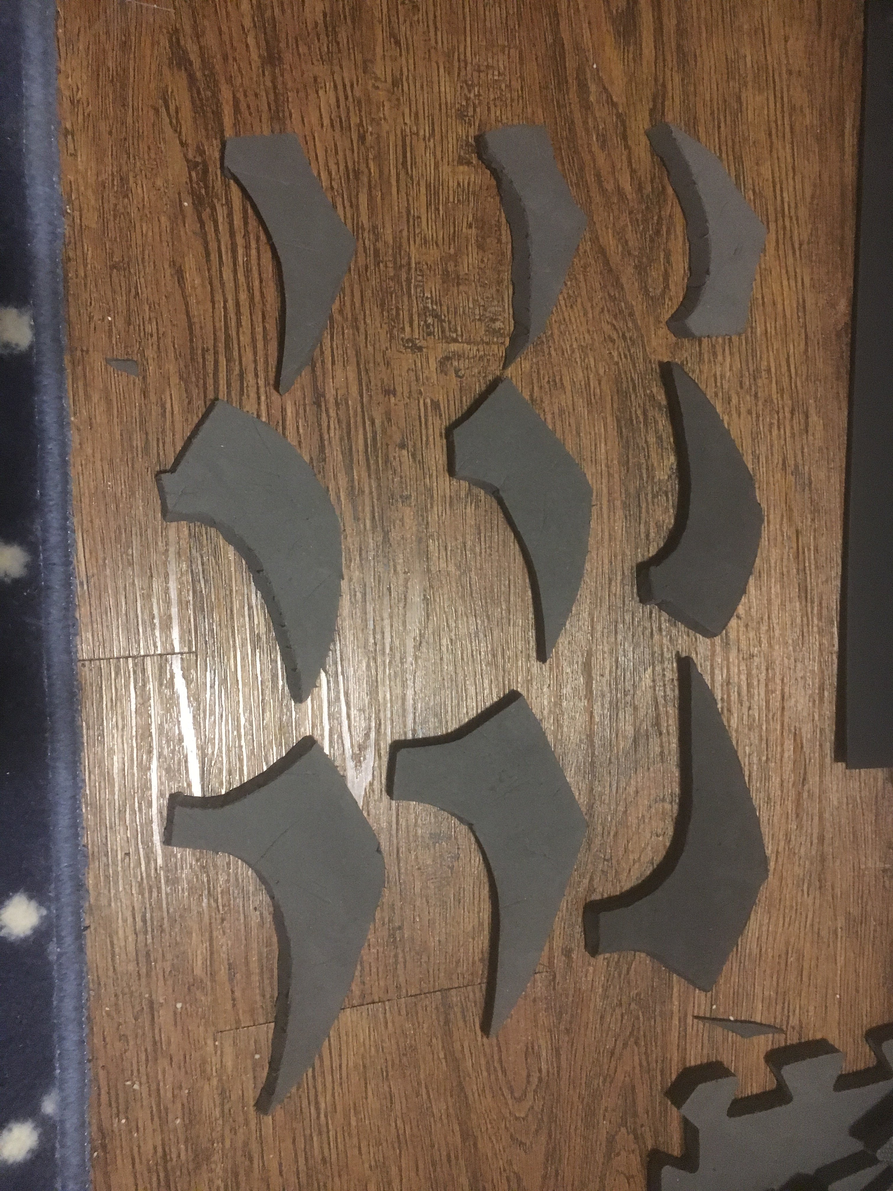

I then took my fin templates and cut them out from the EVA. Using Hot Glue I bonded the pieces to the base of the gauntlet. I had some problems in this process, noticing that the fins were on top of each other, so I adjusted and shorted the ends in order to compensate. Once the fins were secured, I took the heat gun to the fins and shaped them in with a curve. The fins took their shape and I went on to complete the last two pieces, the two elongated blades.

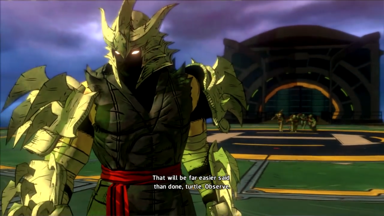

Now this was a little complex for me, even though it seemed like such a simple piece. Going off the source material, I am not entirely satisfied with how it looks since it doesn't have that detail I am looking for. Definitely need advice on this.

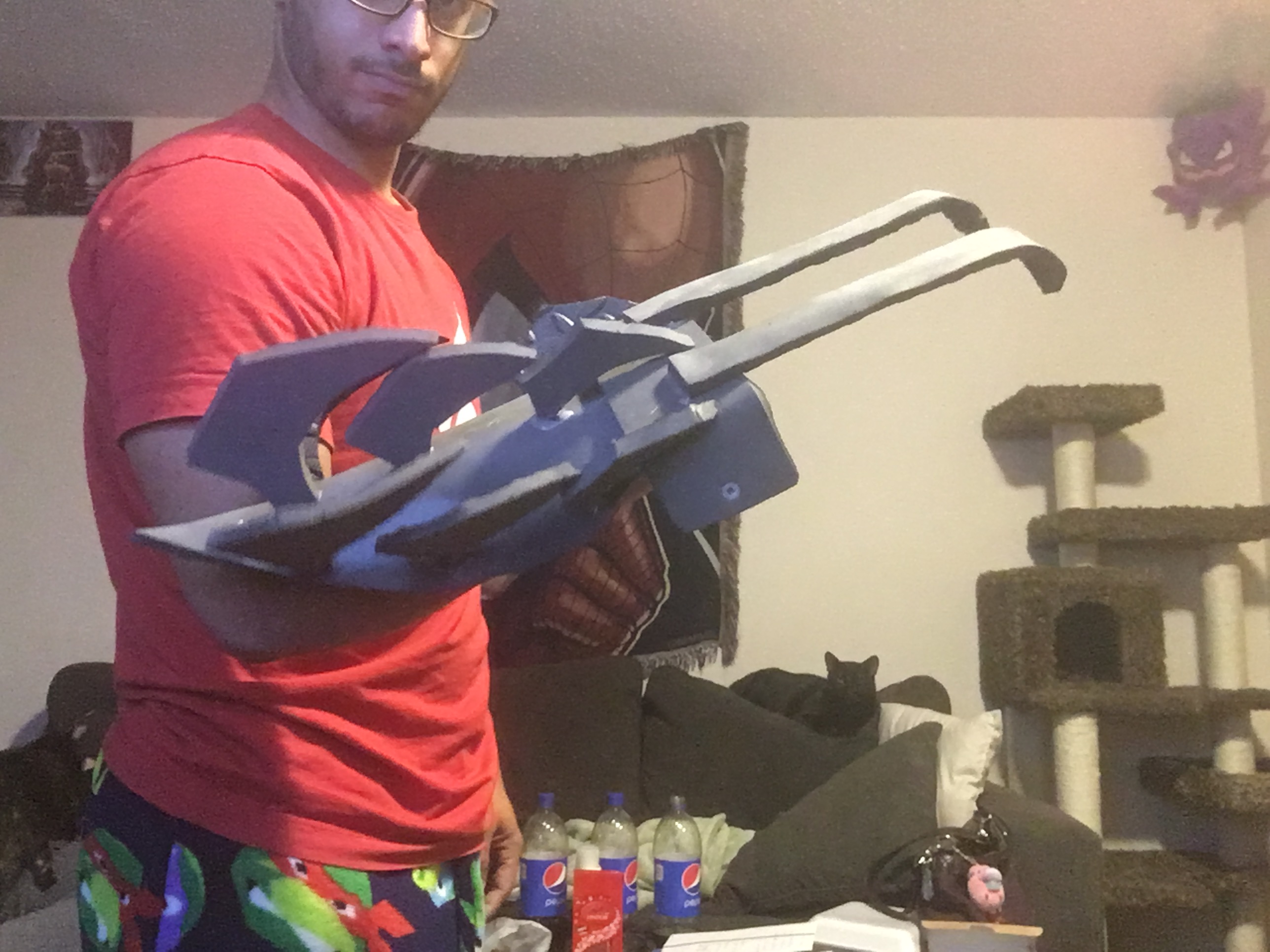

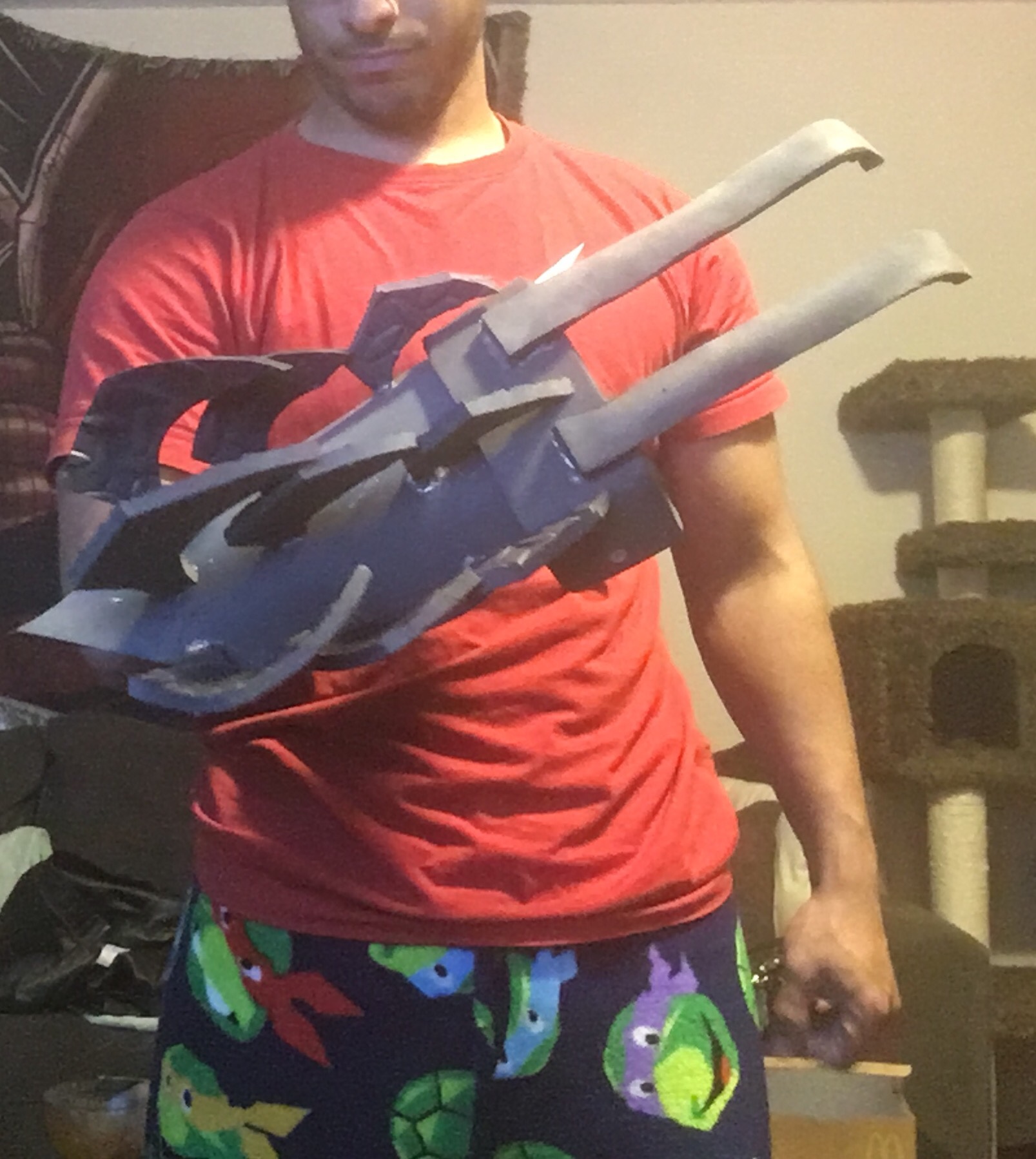

And what ya see is what ya get. The first gauntlet was done last night, and once I finish the rest of the armor, I plan on solidfying the foam and giving it crosshatch battle damage marks. I also wanted to do a mouth guard even though its not part of it, but it would be removable. Also thinking about adding chains but not for the physical look, but I wanted it so that when I take a step, you hear chains rattling, similar to the 1990 Movie Shredder. Maybe somewhere on the shin guards?
OVERALL: I can see I messed up on placement and it isn't aligned perfectly but that is something I plan on paying more attention to for the next gauntlet and the rest of the pieces.
