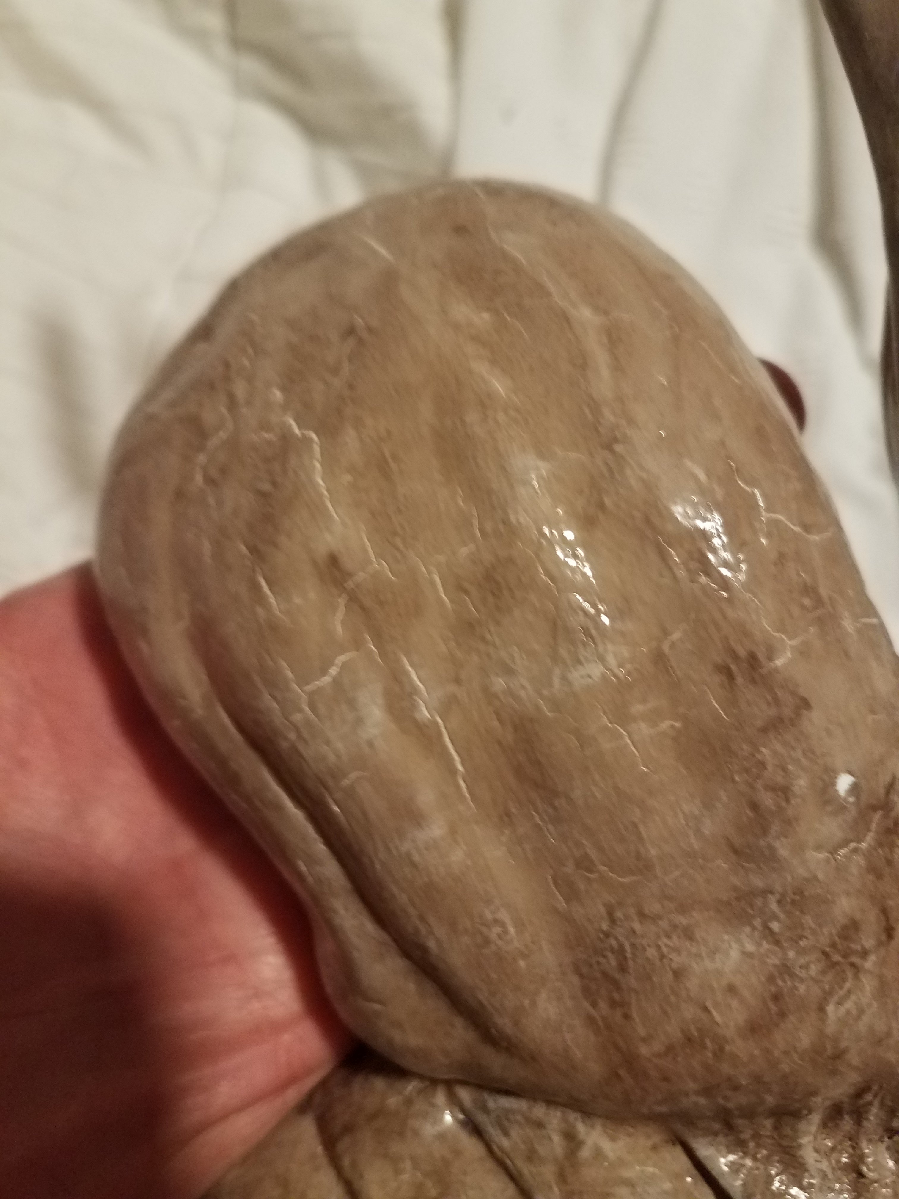

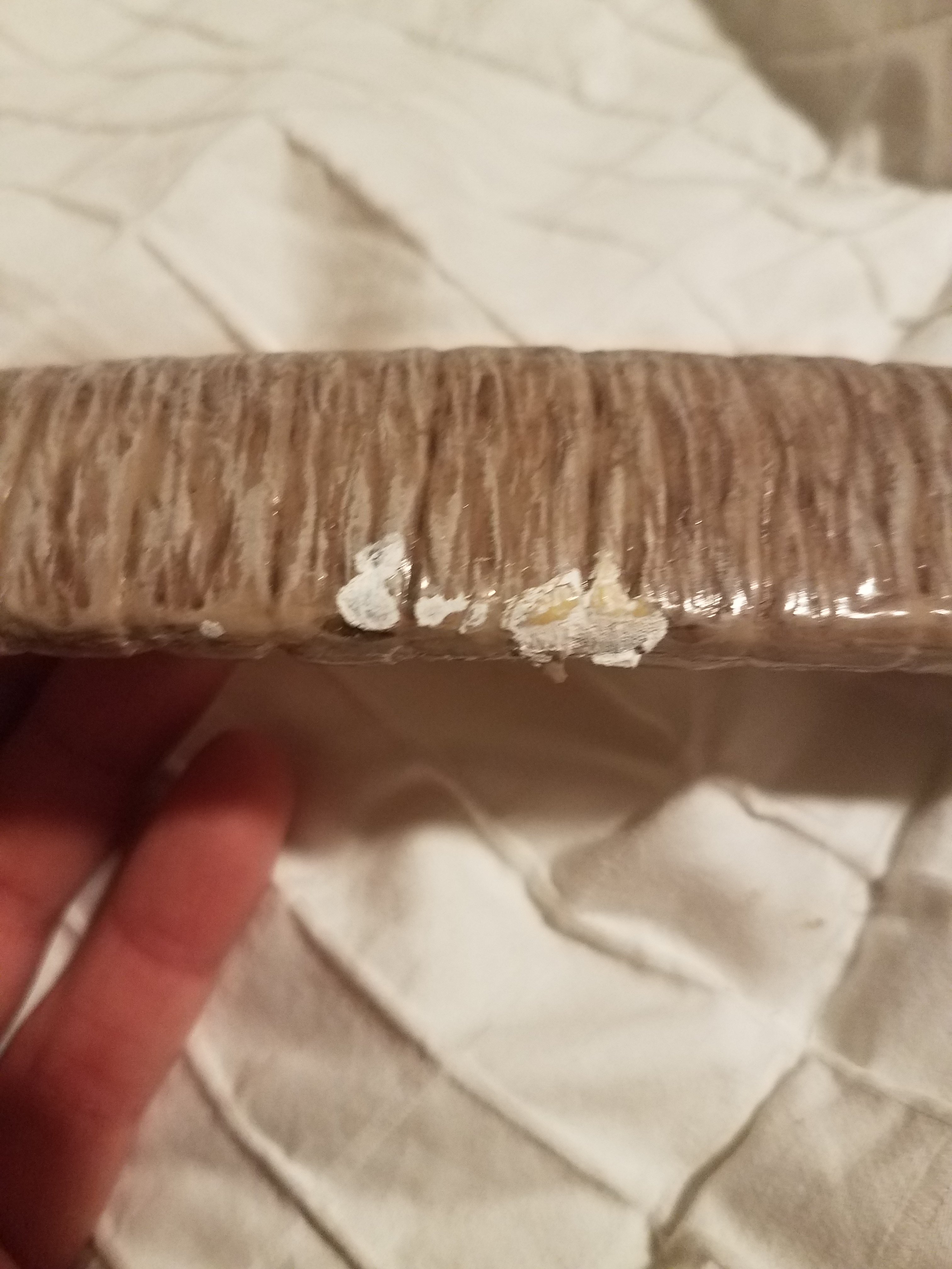

Thanks to everyone for the advice! To "basementdweller" it's the 1/4 scale version. I've got it assembled, waiting on my putty and primer to arrive, and then I'll get started on the painting. On another note, I'm posting some pics of my Aliens facehugger I did a few years back to see if anyone can explain the cracking in the paint. I also did the Queen Chestburster which did the same thing. It's been a while so I'm trying to recall any details that might provide some insight. I primed, and waited a few days before painting. I used acrylics, I can't remember the brands. I feel like I diluted with water and Future. I waited a while before applying the gloss coat. Maybe too much paint or the humid Mississippi air? Any thoughts?
