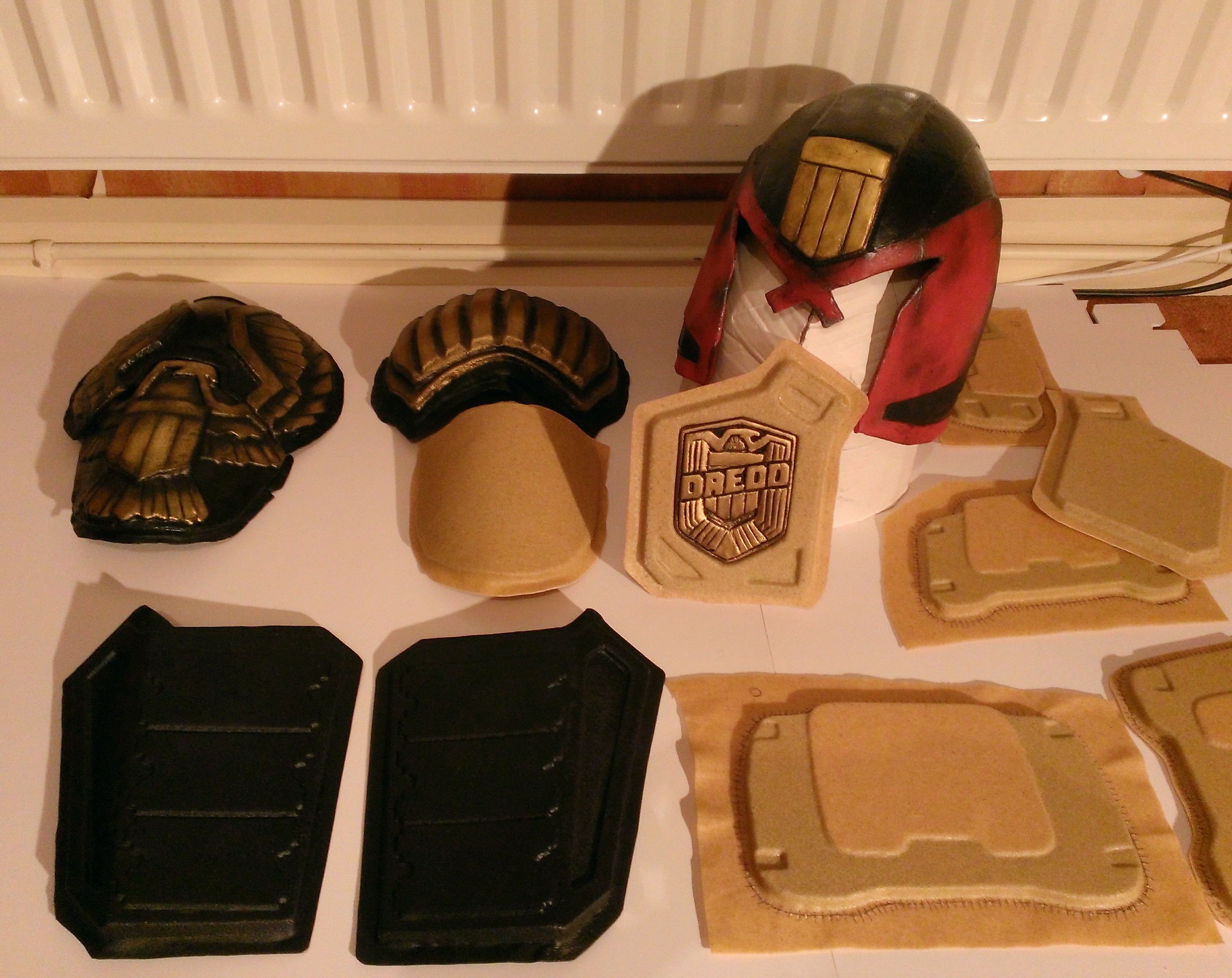

HERE'S A FEW PROGRESS PHOTOS OF FINISHED , OR ALMOST COMPLETE PARTS OF THIS BUILD....IF YOU WANT TO KNOW HOW I MADE THEM ALL, THEN PLEASE, READ ON.........
THE BADGE: JUST AS ICONIC AS THE HELMET.

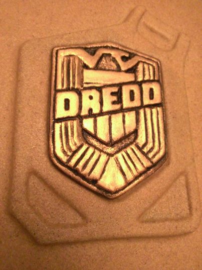

We shall start with the Badge...can't be that hard, I thought.....ah, the first attempt was not to scale (at the time I didn't know this) and was made using an image from the internet, cardboard and then covered with Worbla...
...anyway, like I said, the Worbla biscuit badge as it is now named was not to scale. So I got myself a better image, scaled that to the movie proportions, then came up with the crazy idea of using self adhesive vinyl floor tiles to make up all the layers of the badge. It turned out pretty well, if a little time consuming...the vinyl tile sections really help to give the prop some added authentic weight.
..then time to whip out the heat gun and some Worbla...
...then it was time for a Cuppa...
...then back to work... so using wood filler to fill in the Worbla imperfections, several coats of build up primer, sanding, primer, sanding....you get the idea...
...a few coats of two types of gold and some more sanding, more gold and then some black for weathering and detailing and I ended up with this little beauty.

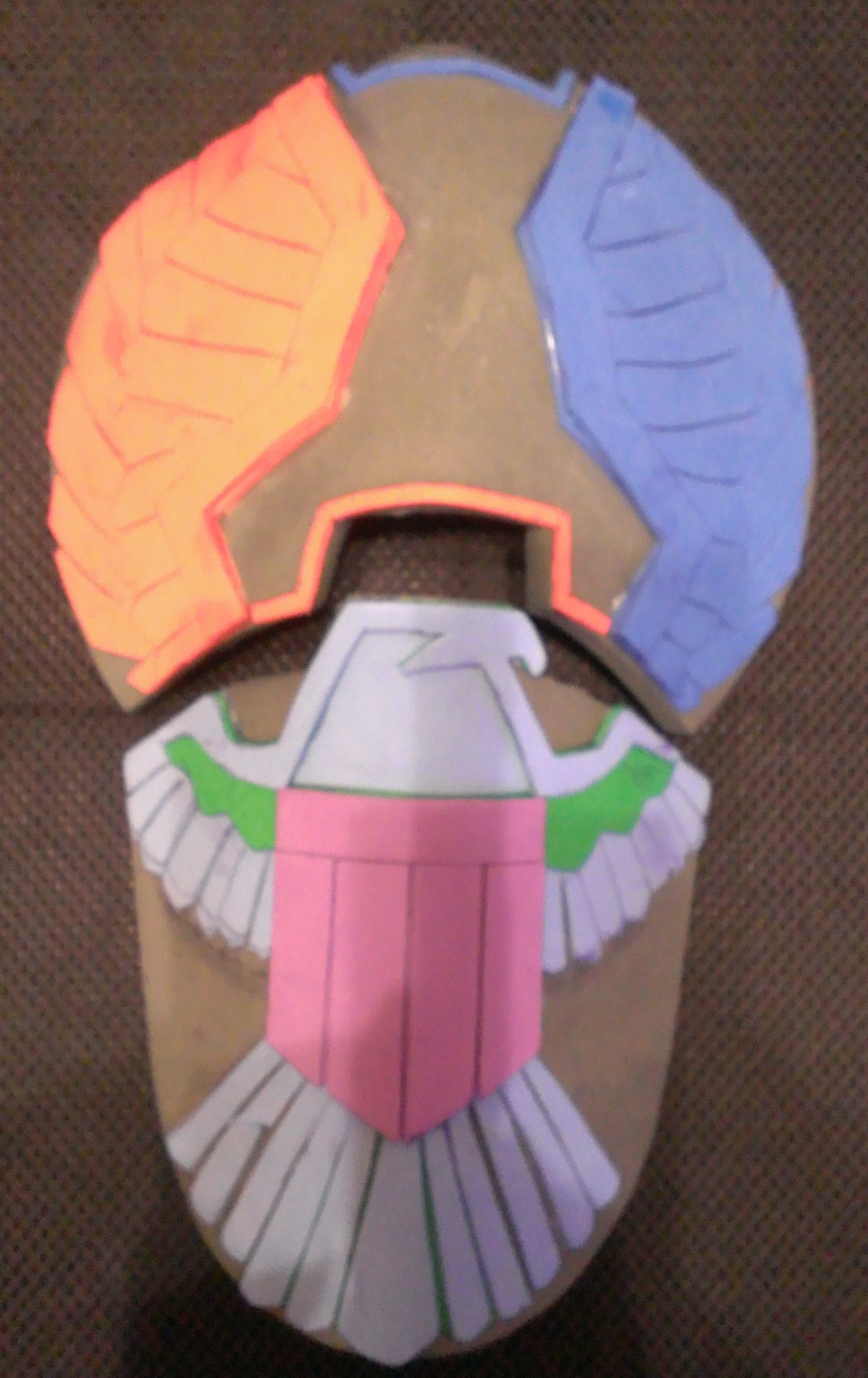

To see if it was all going to fit and look the right size, I built a cardboard mock-up...

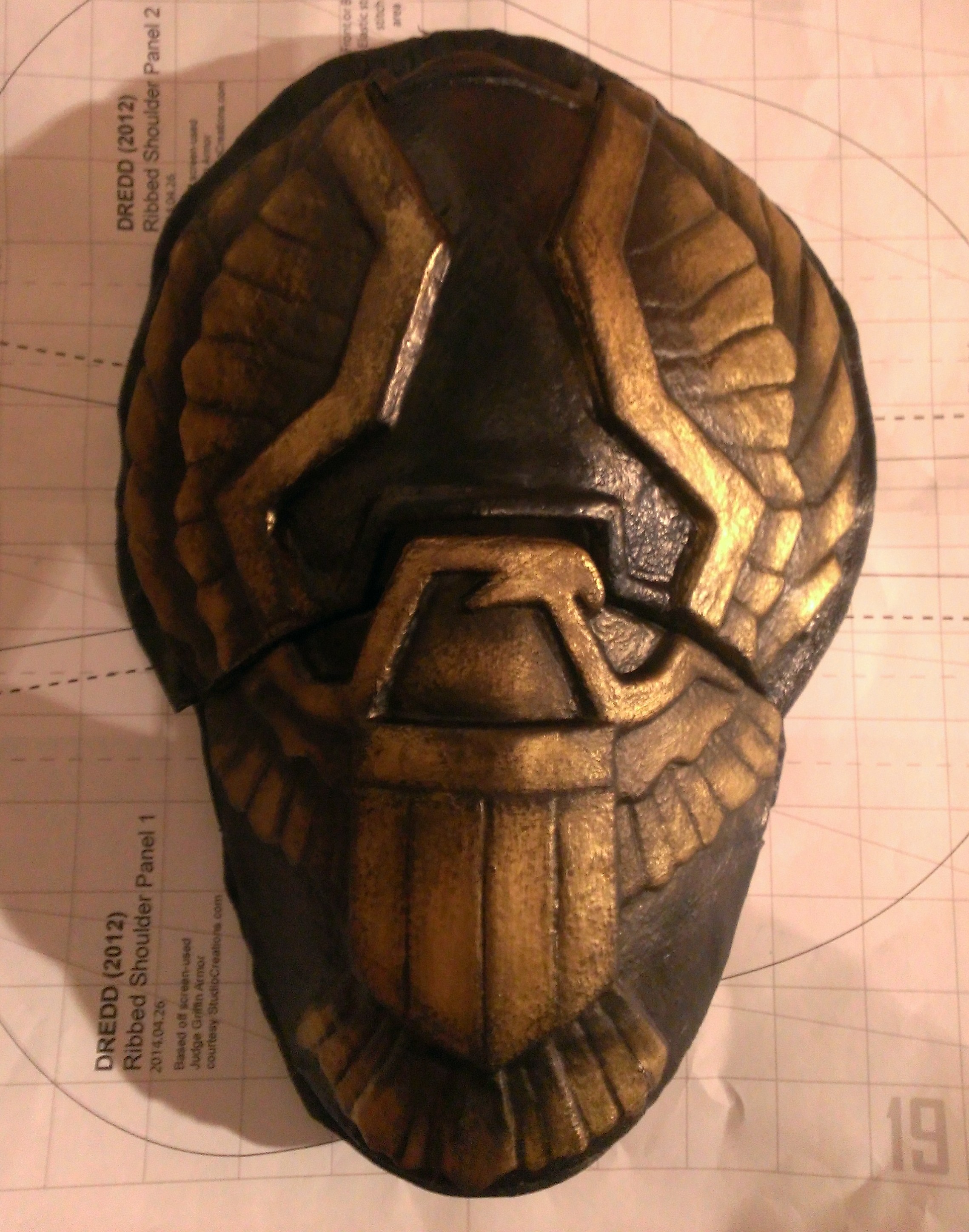

I was smiling on the inside, not to mention a little warm also. It looked like it all fitted, so, on with the actual prop parts. For the material parts of the vest I will be using an old coat that I will be cutting up and some kitchen material cleaning cloths which match the mesh fabric under the plates. The plates and shoulder pads will be produced from a mixture of EVA foam, craft foam and Worbla.
The breast plates I manually drew and sized, for the lower AB plates I used a Pep file, but again altered it as the shape was too square...
...and then these where transferred onto EVA foam, cut out, then covered with Worbla.

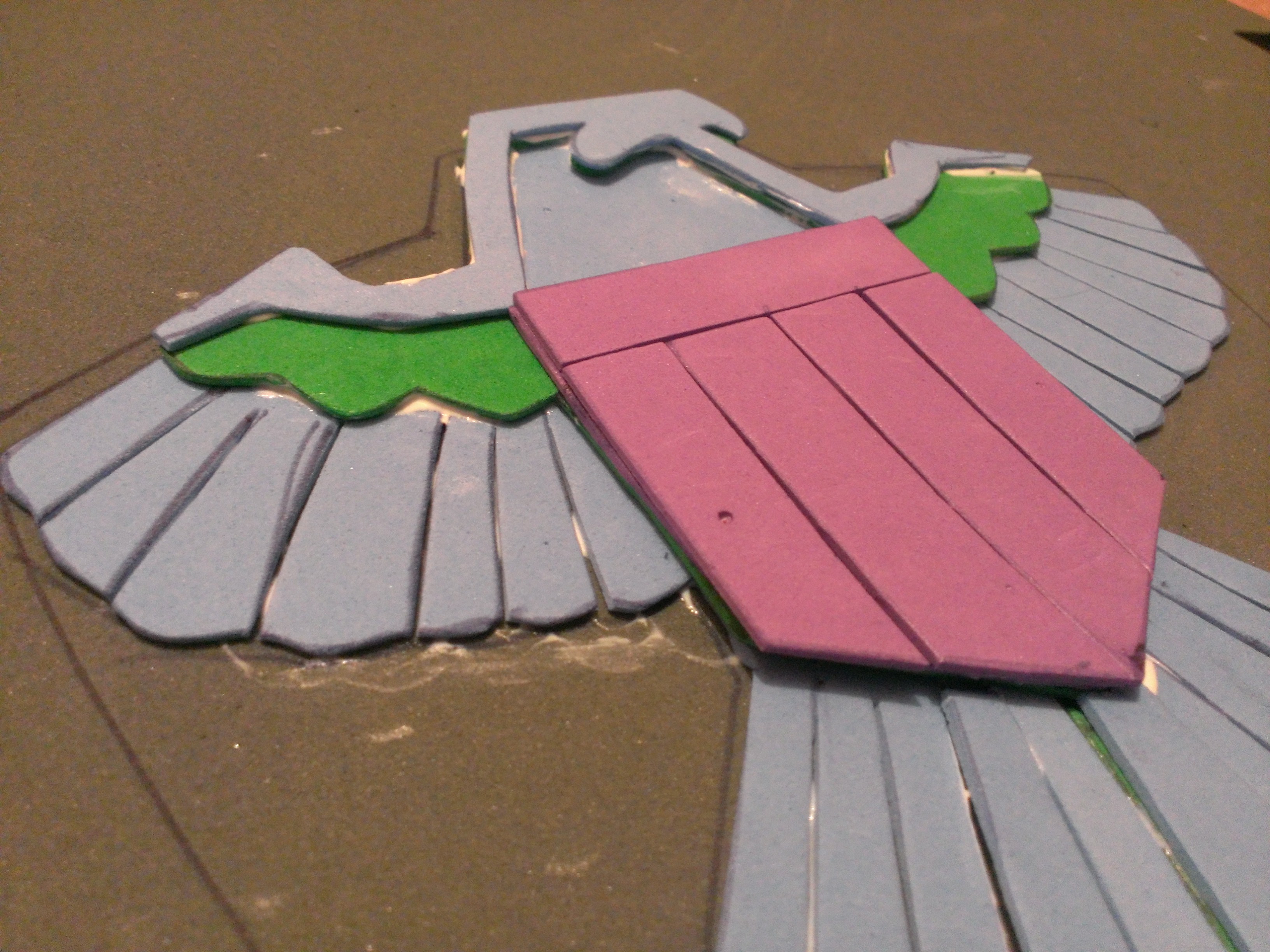

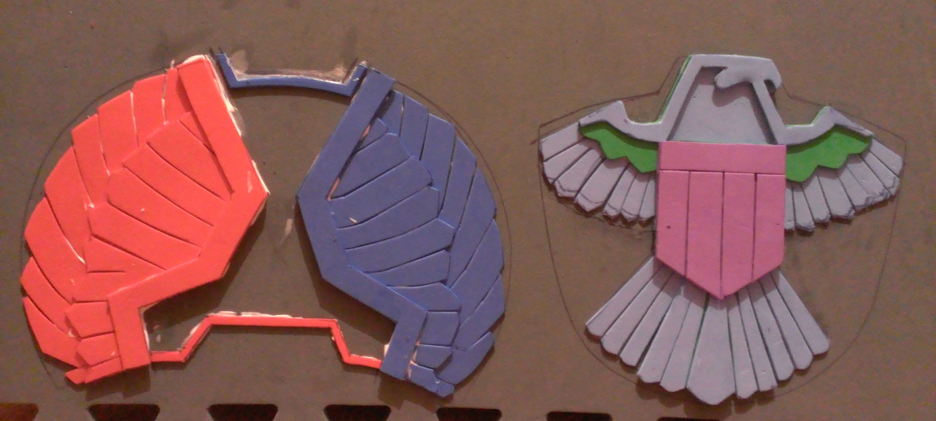

By layering up the thinner craft foam I built up the eagle pad...It wasn't until I covered it with Worbala that I realised I had made the lower pad too long...

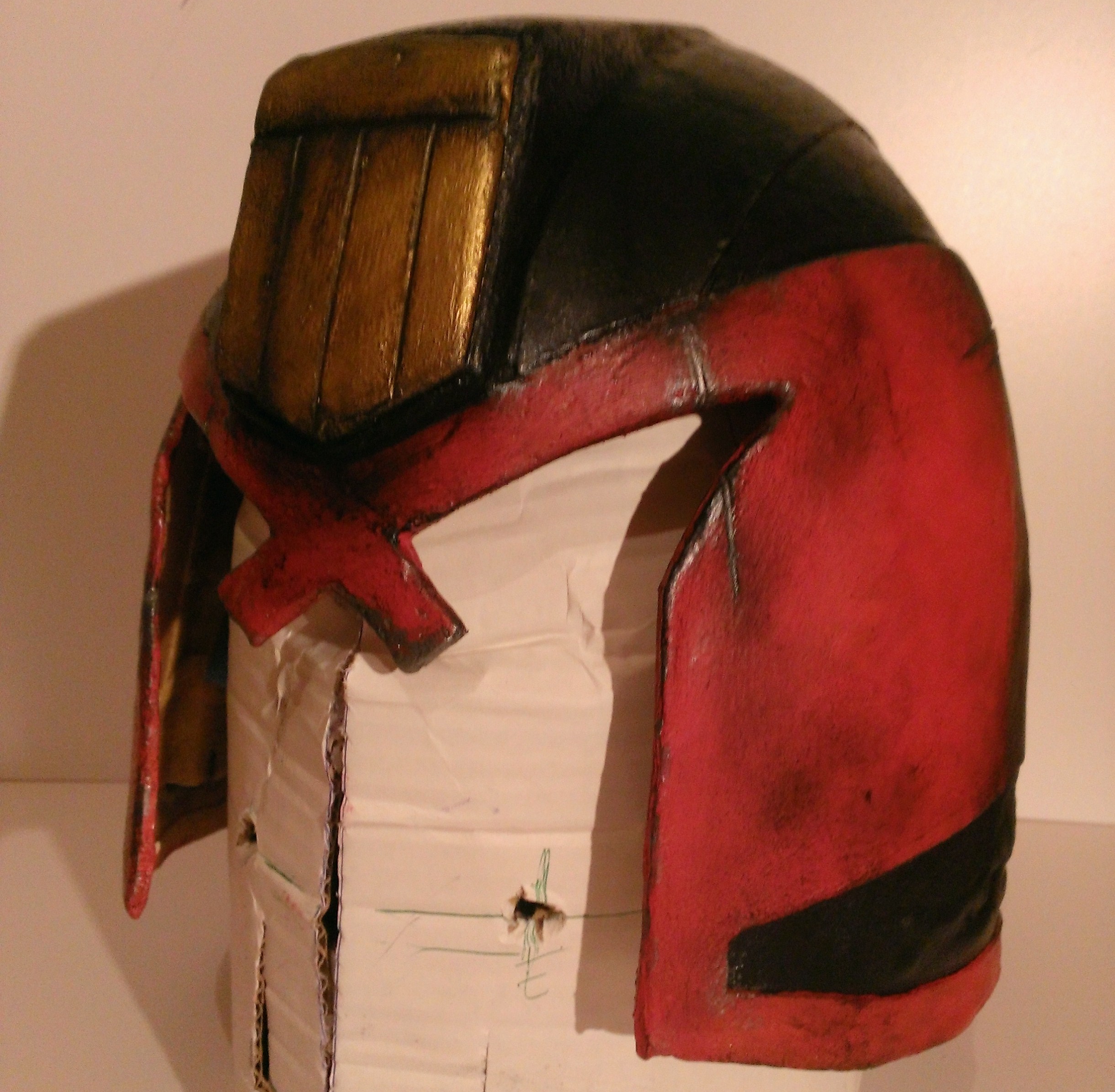

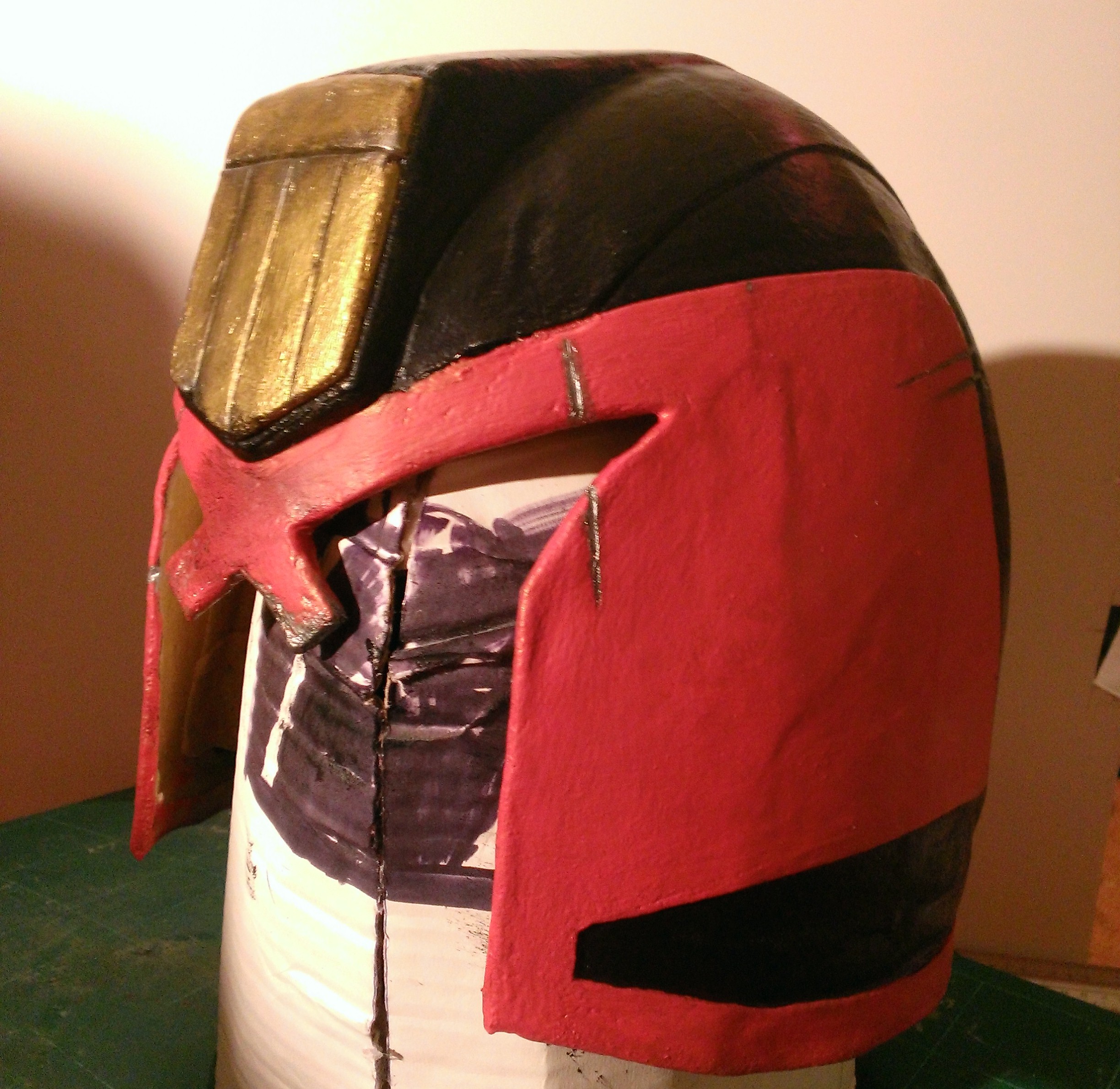

Finally got to a place where I am happy with the helmet...but it wasn't always so rosey.
