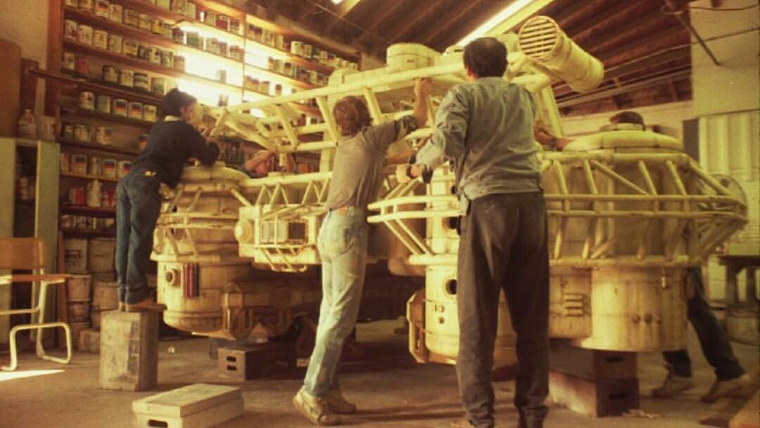

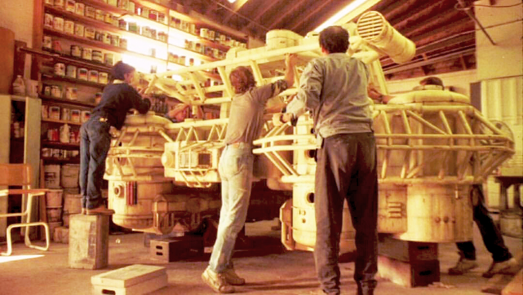

Deepcore having the final touches put on it at Design Setters in Burbank California back in the day. I am the one in the middle adding some weathering to it. Deepcore.jpg

"Bigature" it was indeed! 16 feet wide, 22 feet long and almost 8 feet tall. It was a gorgeous model shot "dry for wet" on a smoke filled motion control stage at Dream Quest Images in Simi Valley, California. One of the biggest challenges with this model came towards the end of the shoot. Jim Cameron wanted a shot during the chase scene of Flatbed sideswiping the lower cylindrical section of Deepcore as it pursued Cab. The Flatbed model was hung on wires like a marionette and because of the main overhanging framework of Deepcore it was not possible to get Flatbed in close enough to look like it made contact. The only solution was to film the entire shot upside down.
Now Deepcore was never built to be flipped over on it's back. It was really more of a miniature "set" than a single structurally stable model. There was no central framework or chassis, just a bunch of plywood boxes, cardboard tubes and PVC pipe held together with drywall screws. It also probably weighed 1500 pounds or more! Much to big and heavy to flip over by hand. The only option was to use a bunch of electric hoists and straps to lift the model up, roll it on it's side and then flip it and lay back down on it's top. Unsure if the model would survive or break into a thousand pieces I insisted that Jim sign a letter acknowledging that the model was not built for such a maneuver and that in might not survive.
Flipping the model over was one of the most terrifying things I've ever had to oversee on a stage. Deepcore creaked and groaned and there was the sound of screws ripping out of wood but somehow we were able to get it flipped upside down with a minimum of damage. The shot was a success and is one of my favorites of the film. I don't think anyone would suspect it was filmed upside down!
So did we flip it back over when we were done? Nope, we chopped it up with a chainsaw and threw it all in a dumpster!
