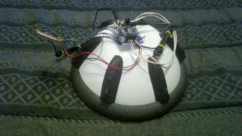

I finally have all of Tom's parts where they should be. I've got to do some touchups and I might look into making a black felt ring to hide the lazy susan better. I'm putting him on a shelf until I find the rest of the parts I want. I need a small set of speakers that run on 6-9v that I can hide on him. I'm thinking personal music player speakers might be what I want.
I'm going to have to look into that. I just installed a Sure 2x25w in K9 and I was extremely impressed with the sound quality and volume. Thanks Daniel.
I was just doing a test run of the amp and those speakers tonight and you are right Daniel. It's insanely loud for such a small footprint. It's painful on the highest setting. Thank you for your recommendations. I'm very happy with them. Now to figure out how to stuff it all into Tom.

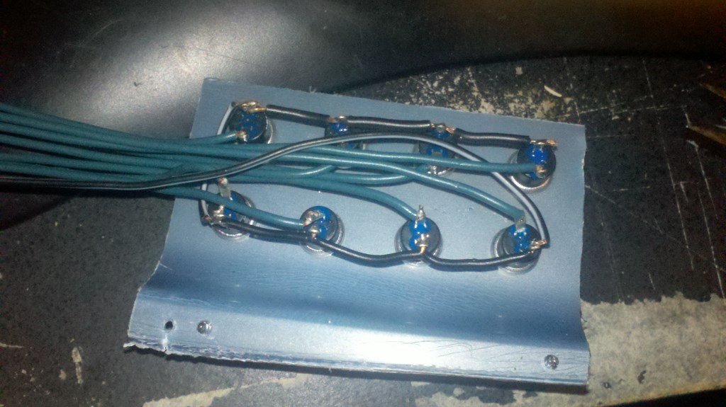

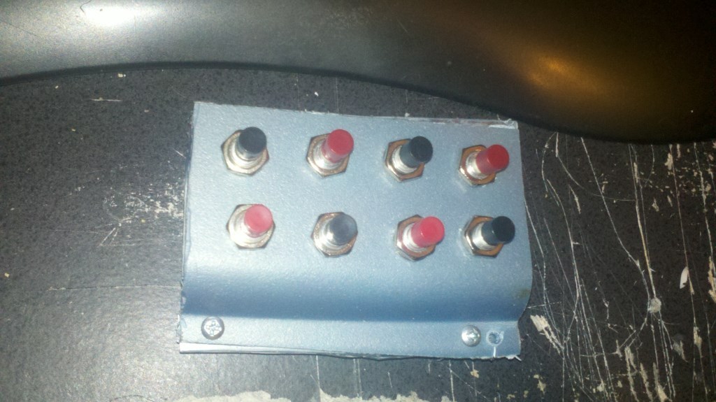

I finished the button pad for Tom. It's made from an old discarded rubbermaid lid my neighbor threw out. I went way overboard with these buttons. I figured they'd be easier for my sister to find and press but they are a lot larger than you think when you're trying to hide them under a hoverskirt.

I forgot to take a photo of the inside of the barrel but the two circuit boards you see, the MP3 Trigger and the Sure Amp, are secured to the inside with hook and loop strips. Everything runs on 4 AA batteries. I changed up the lever for the mouth. I went with a thick piece of styrene and a small metal hinge. I think it works better and is a lot lighter so I didn't have to upgrade the spring that came with the kit to keep Tom from going slack-jawed.

She asked for a couple of tweaks to make controlling him a little easier. I should have realized that my hands are bigger than hers.
