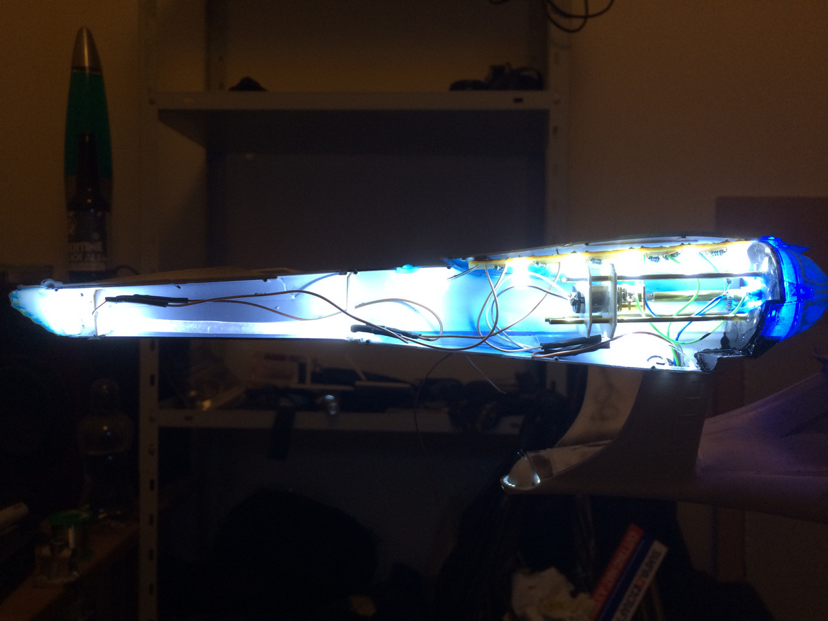

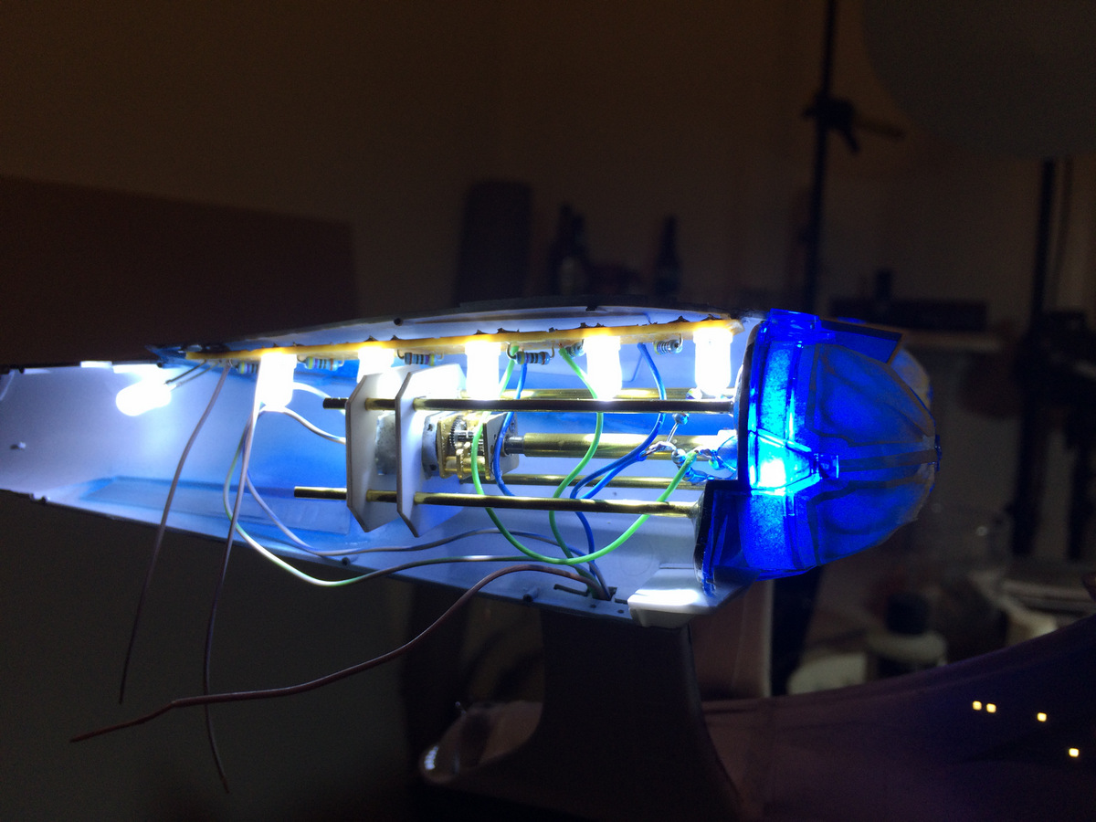

I didn't get any where near as much done over the holiday as I'd have liked, but there has been more work on the nacelles. Nacelles are lightblocked, and the clear parts fitted. The four clear windows at the bottom of the nacelles are a very tight fit, and have a groove moulded into them to grip the main styrene parts. I didn't notice this until I'd precariously glued in two of them, so had to unglue them, clean them up (I was using micro krystal klear, which dries quite slowly), and refit them. No harm done, and they're much more secure now.

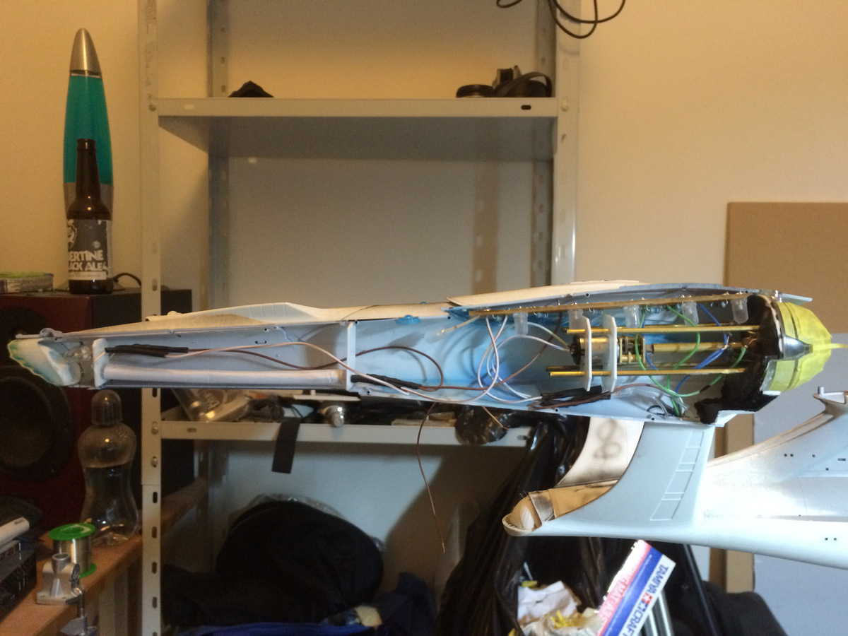

The bussard domes (with their rotor, LED and motor assembleys) are epoxied in place into the nacelle shells - I don't want any movement here.
In order to wire them up, the mounted half of each nacelle was attached to the pylons (which already had the wires running through them). Once all the internal lighting was in place, the other half was attached with a mixture of micro krystal klear for the clear parts, epoxy for the bussard dome assembley, and good old Extra Thin styrene cement for everything else. Milliput 2-part epoxy putty was used to make a small fillet blending the pylon into the nacelle (as seen on the CG model), which adds some support. 1mm fiber optics provide the flood lights down the pylons.
Pictures!

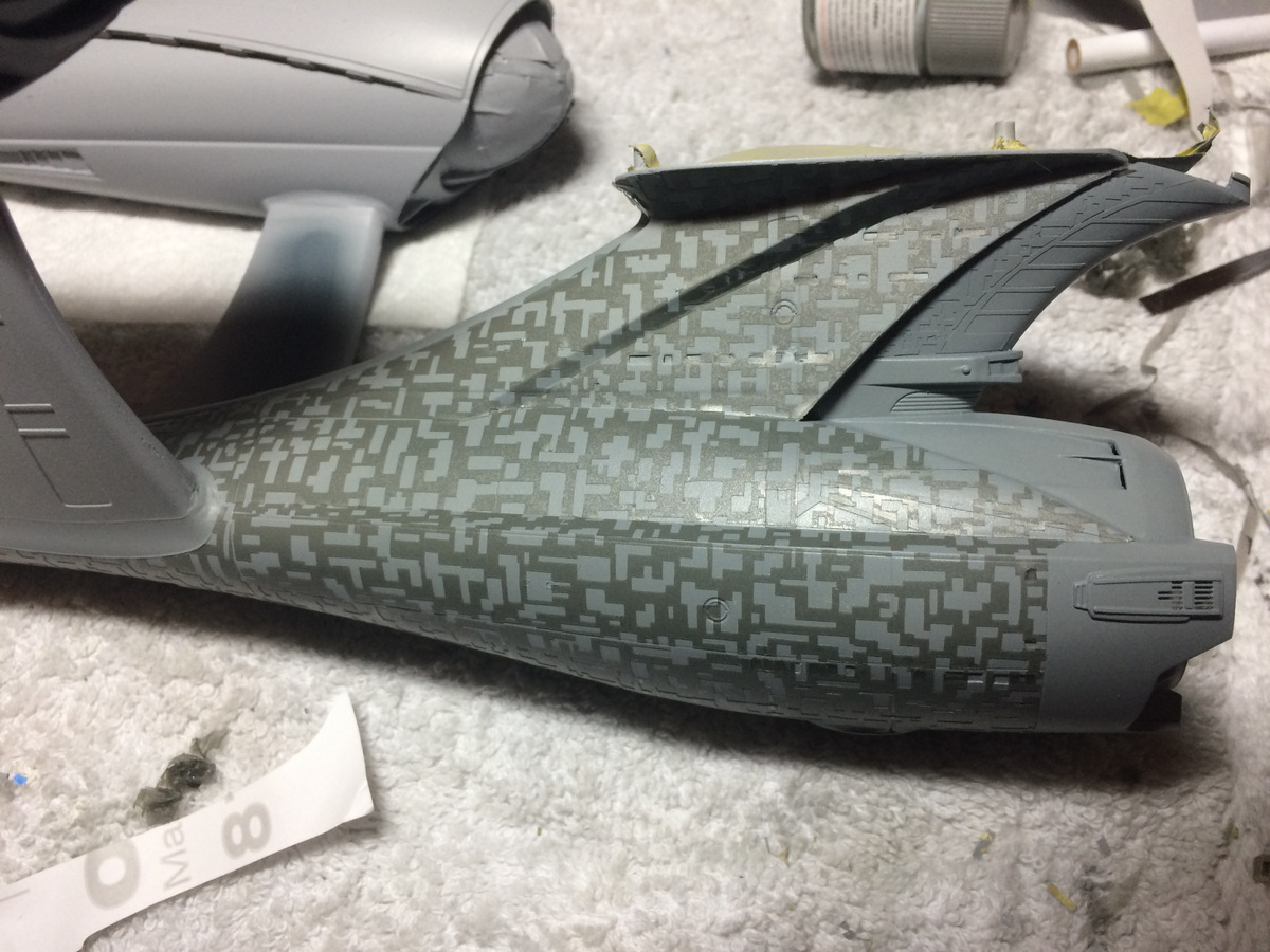

Well, it's been a while, but progress continues. I've been priming, sanding, and priming again on the engineering hull and nacelles, and have spent the past few evenings getting some paint down on the engineering hull section (I prefer to tackle things in sections)
First, a coat of medium grey, and then masking with Orbital Drydock's excellent masking set. I have to say, the way these have been designed to conform to the contours of the hull is great, they're really easy to use:
After this went on, a coat of 75% grey, 25% white went down, followed by the same mix with a little silver blended in for some metallic textures. This was done using some of the additional hull detail panels provided in the masking set.

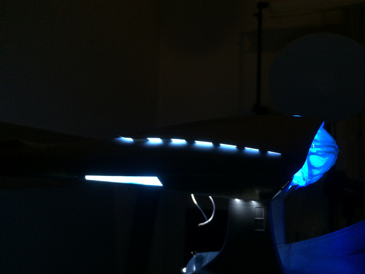

After removing the masks (but leaving the sunburst-type thing masks on the strongback on - these are covering up some ocean grey), another texture coat of 50:50 white/grey went down using some more of the hull detail panels, and then a final 25:75 texture coat on top of that. All the masks were then removed and a blending coat of the 25:75 was added to tie it all together and reduce the contrast, giving me this:

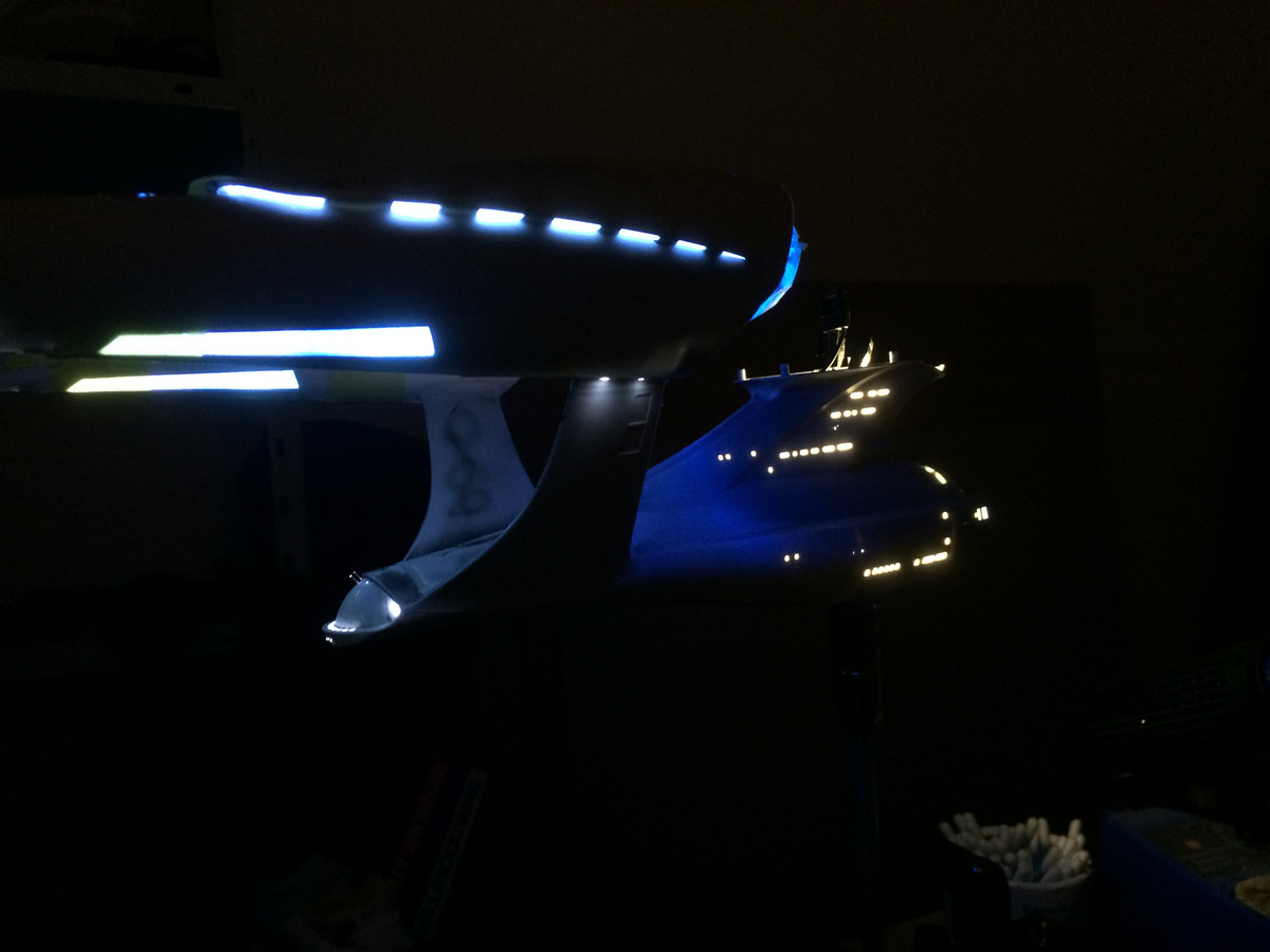

...and because I'm a sap, here she is with the lights off again:

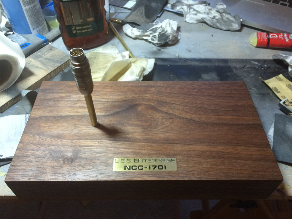

Quick question, what are you using for the mounting plug/jack?
Thanks! The connector I'm using is a 14-pin screwed DIN connector by Lumberg. I got mine from RS components here - you can probably find the same thing from Mouser or Digikey in the States. It feels really good and sturdy.

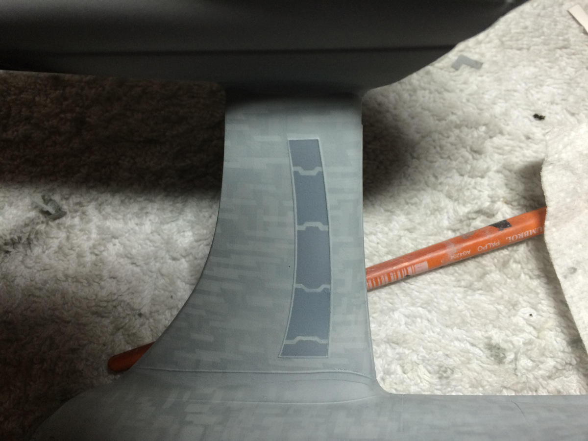

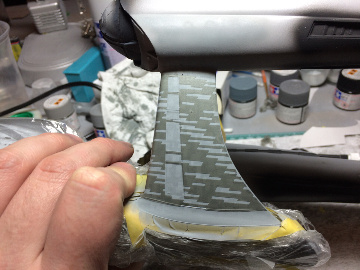

Painting on the hull continues, moving my focus onto the pylons. The process was slightly different here, because I wanted to use the pylon templates for the final, lightest layer to make the lightning bolts more prominent. To do this, I did my usual layers with some spare random hull panel templates, and then added the final layer using the proper, fitted templates:

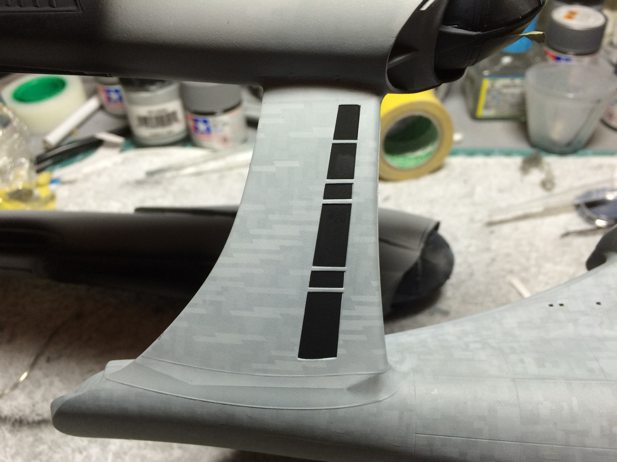

I'd already painted and masked the panels on the inner and outer edges of the pylons, but these had suffered from a bit of paint bleed so were touched up with a brush. Not the neatest job in the world, but I can live with it. After unmasking and misting over the final blending coat, the pylons are looking like this:

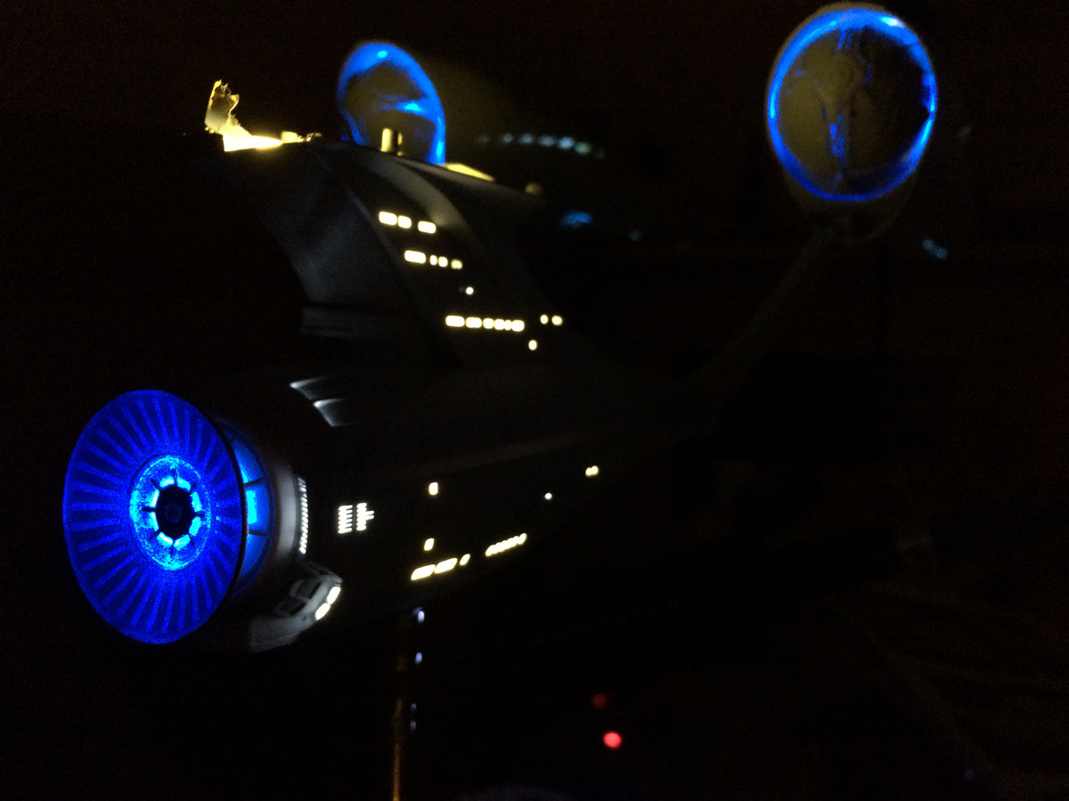

So, I put on a coat of gloss on Wednesday, and completed the decals yesterday. Once I'd done that I couldn't resist fitting the saucer and seeing how she looks all together - this is the first time I'd fitted these parts, so it took a little bit of sanding in order to get the two bits to make friends. That means there's some touch up to do on the paint, and some light leaks to fix. Here's how she looks now:
...and a kinda shaky one with the ambient lights off (there are bits in this video where the camera negotiates my soldering iron and I move a bottle of acetone out of the way, so sorry!):

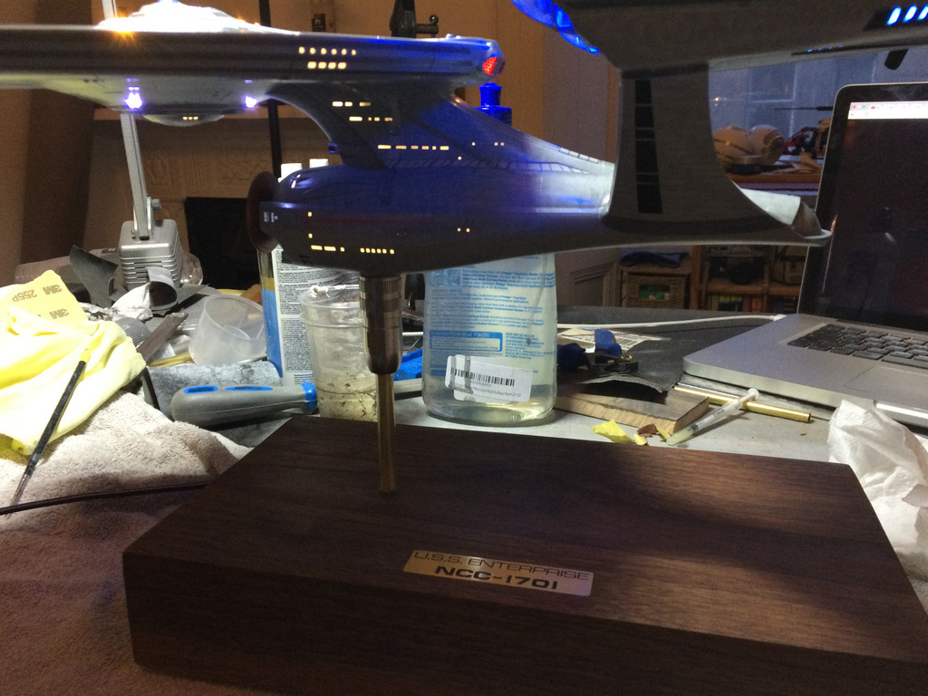

Today I started working on the base, which is going to be a big gloss black slab with a brass plaque (one came with the paragrafix PE set), which will also act as a capacitive touch sensor to switch on and cycle various modes.
Once that's​ all done, I'll take some proper photos - I can't wait!

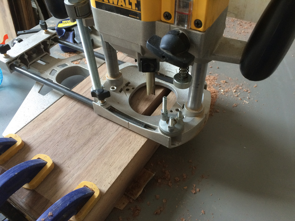

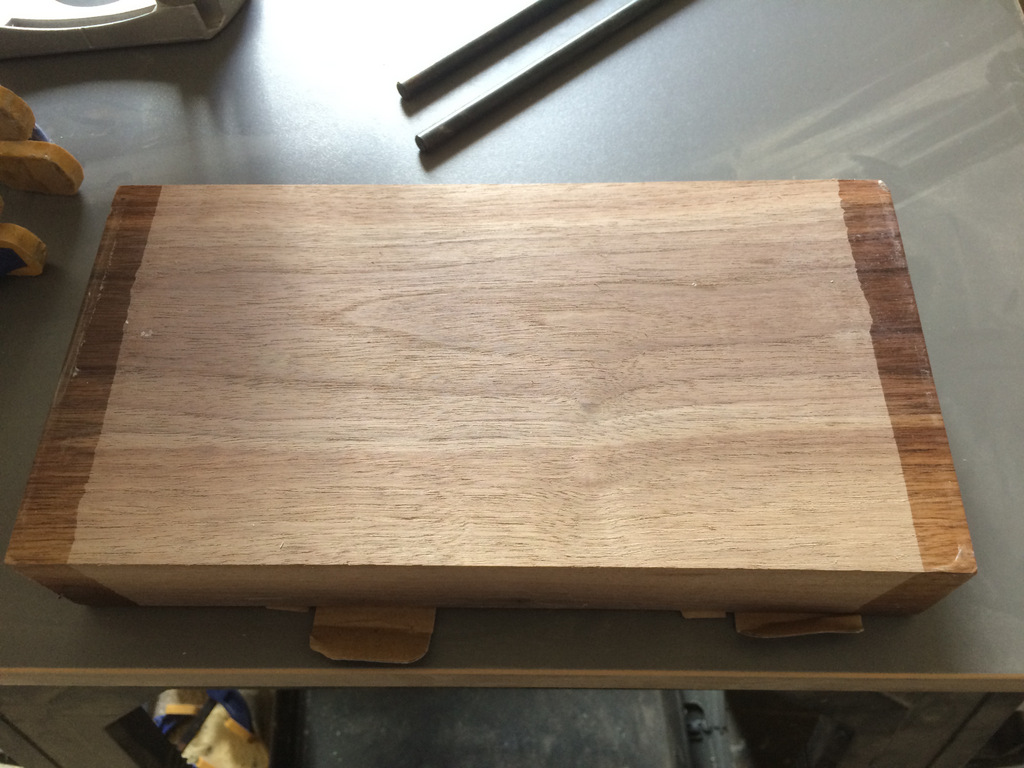

So, after mucking about with the MDF base for a good few days I decided that the look just wasn't what I wanted, so I ordered a nice bit of walnut and found a friend with a router so I could hog out the underside to mount all the electronics. Now that she's nearly finished, I'll do some proper photos with decent lighting and a decent camera, but in the meantime, here are a few iPhone snaps:
Raw walnut blank being routed out (not the neatest, but it's the underneath):
1-Photo 16-05-2015 14 45 21.jpg2-Photo 16-05-2015 15 14 52.jpg3-Photo 16-05-2015 17 22 03.jpg
Mounting post epoxied in, name plate added (it has a wire attached to it going through to the electronics cavity because it's also the capacitive on/off/mode cycle switch)
WIth the ship mounted:
and finally, in situ on her shelf, where she'll live. I might paint the inside of this bit of bookcase black, I'm not sure:
As promised, proper pictures to come soon!
