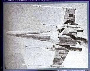

Interesting thing about Red 1. Either the hero's wings opened to the extent of a pyro, or that is a pyro when Red Leader loses his engine. The shot's doubly confusing to me, because the sparks from the blast seem too perfectly characteristic of a pyro device to be animation, yet the model remains undamaged and the shot looks like motion control, which I thought was incompatible with pyro-work.
Meanwhile, the Red 1 model that comes to Luke's rescue - standing in for Wedge's Red 2 - has got its wings damn wide apart too. Could pyros really have been interchangeable with heroes for some of these motion control shots? But how would they have mounted them..?
Well, we know that they took thier chances with hero models on occasion.
For example, a small white ball of pyrotechnics was applied to the Rebel Blockade Runner on the right side, right in front of the engine cluster (it can be seen if you carefully stop-motion your DVD, just before it "explodes" in the first few minutes of "A New Hope").
As far as I know, there was no "pyro" Tantovy IV model, and apparently that effect did not damage the model, at least not significantly. The "explosion" only has to "look" good on film (shot at high speed & played back slow to give it more scale & believability), it doesn't have to actually "blow up" something or cause damage.
So it's possible they did something similar with Red 1 without damaging the hero model. Also, unless I'm mistaken, the pyros still had a round hole in their "butt plate" which implies that they could be mounted from the back (perhaps the only rod mounting point for a pyro).
