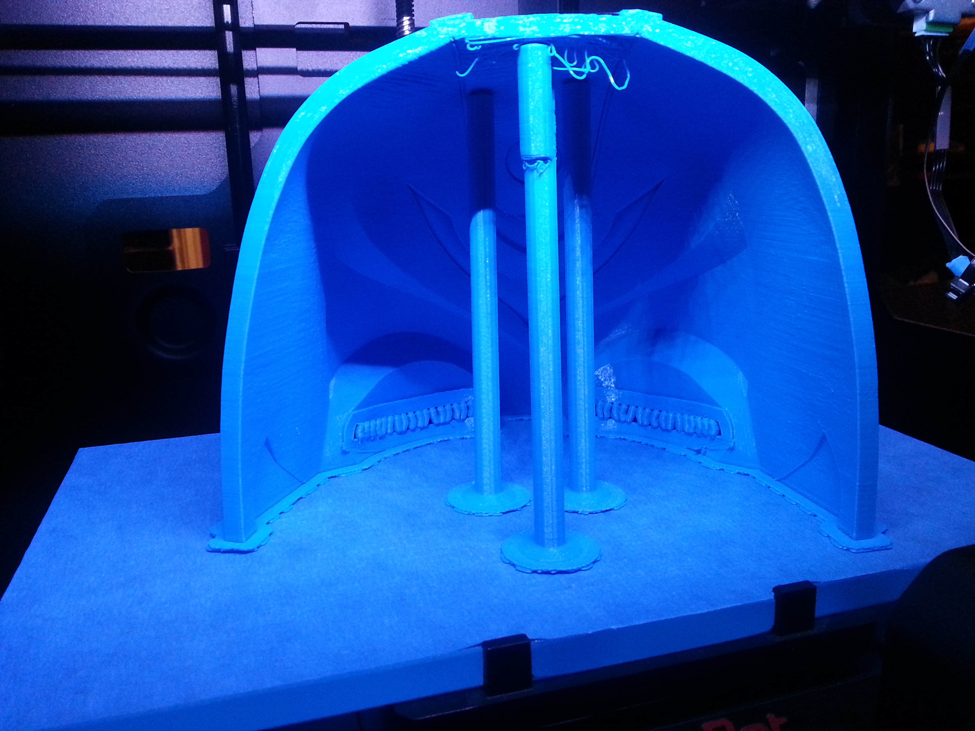

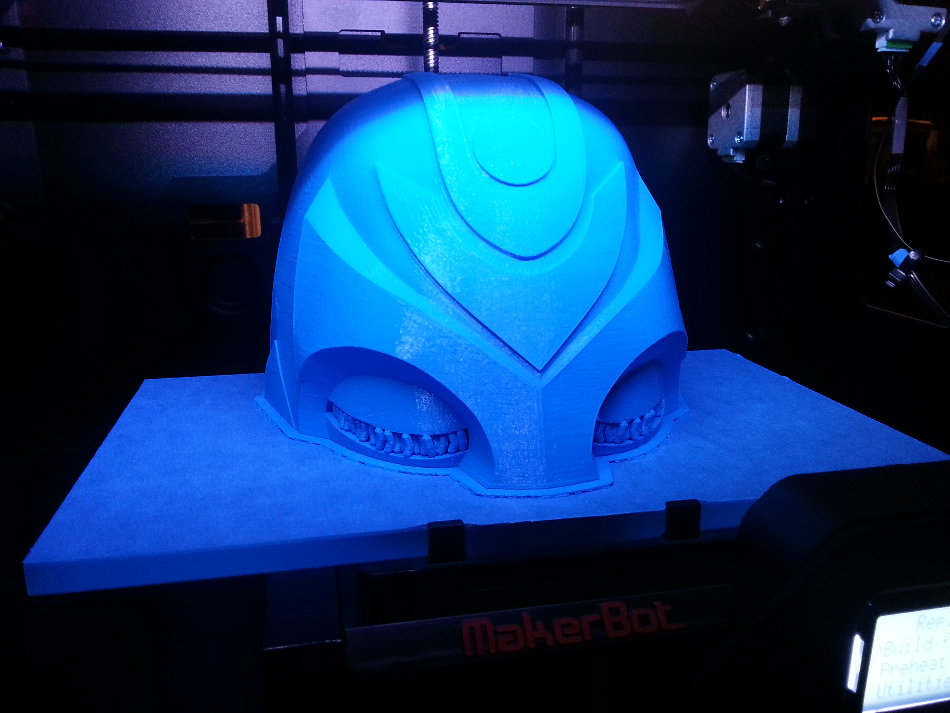

Hey everybody, just wanted to share progress on one of my current projects. I'm going to make the Dragon Priest masks from Skyrim and set up a nice wall display for them. I plan on making all nine, yes nine, even the "wooden mask". Eventually I will be making Konahrik as well as the center piece of this display.
To do so, I'm using JTM's model. Big thanks to him, and if you yourself want to 3d print or pep one of these you can find the files on thingiverse (JTM's page) or JTM's dragon priest pep thread.
[/URL][/IMG]
[/URL][/IMG]

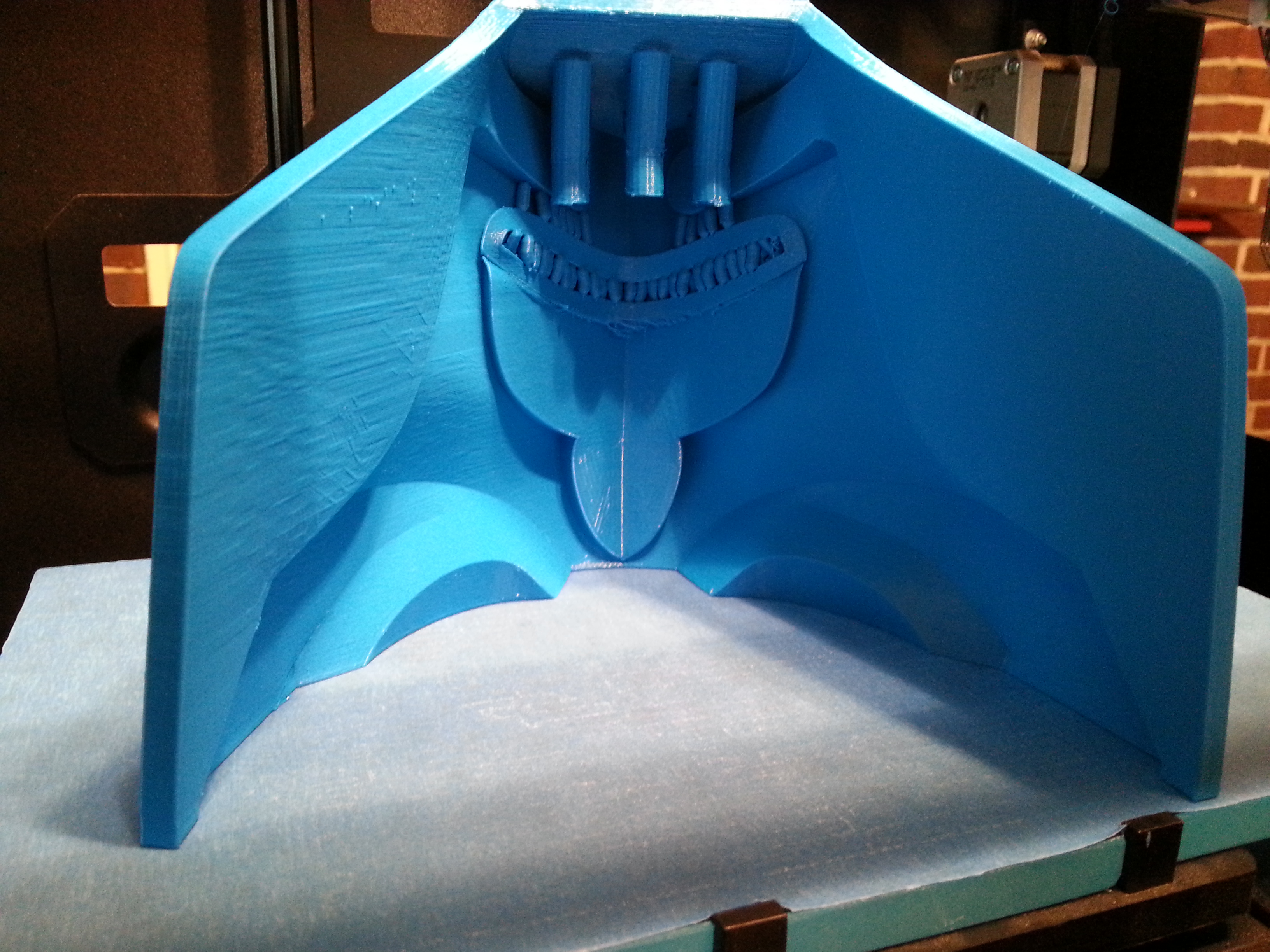

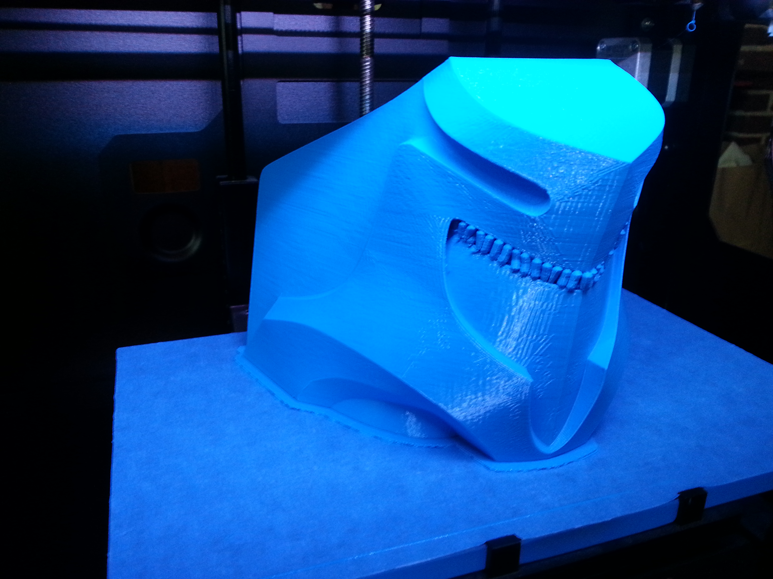

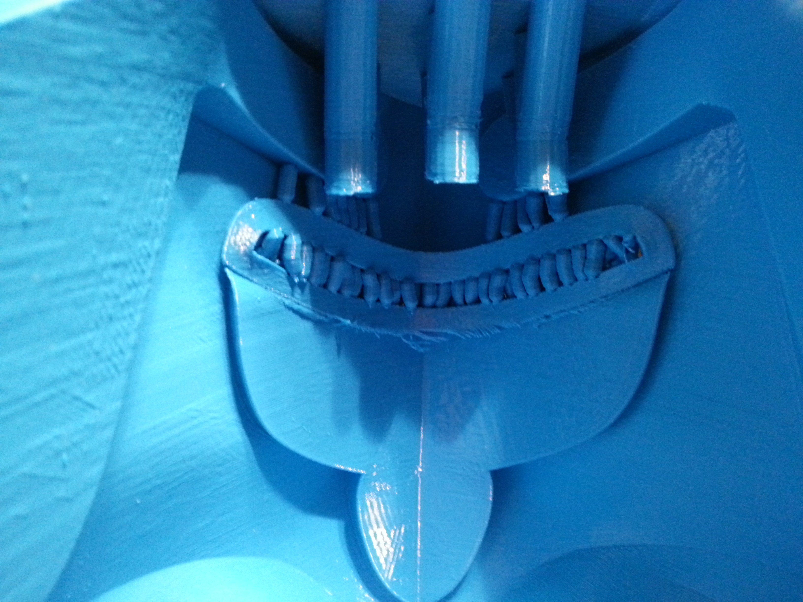

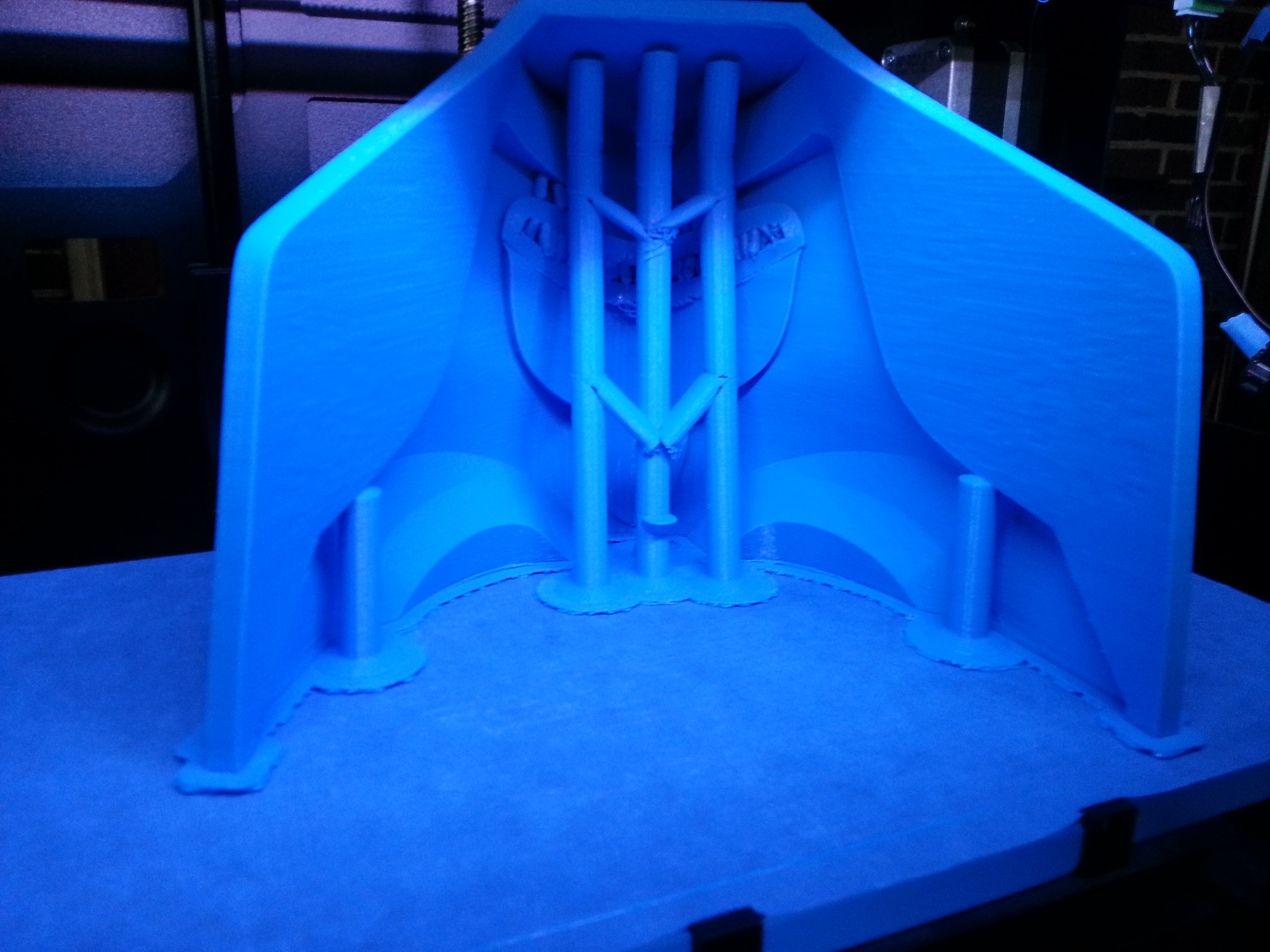

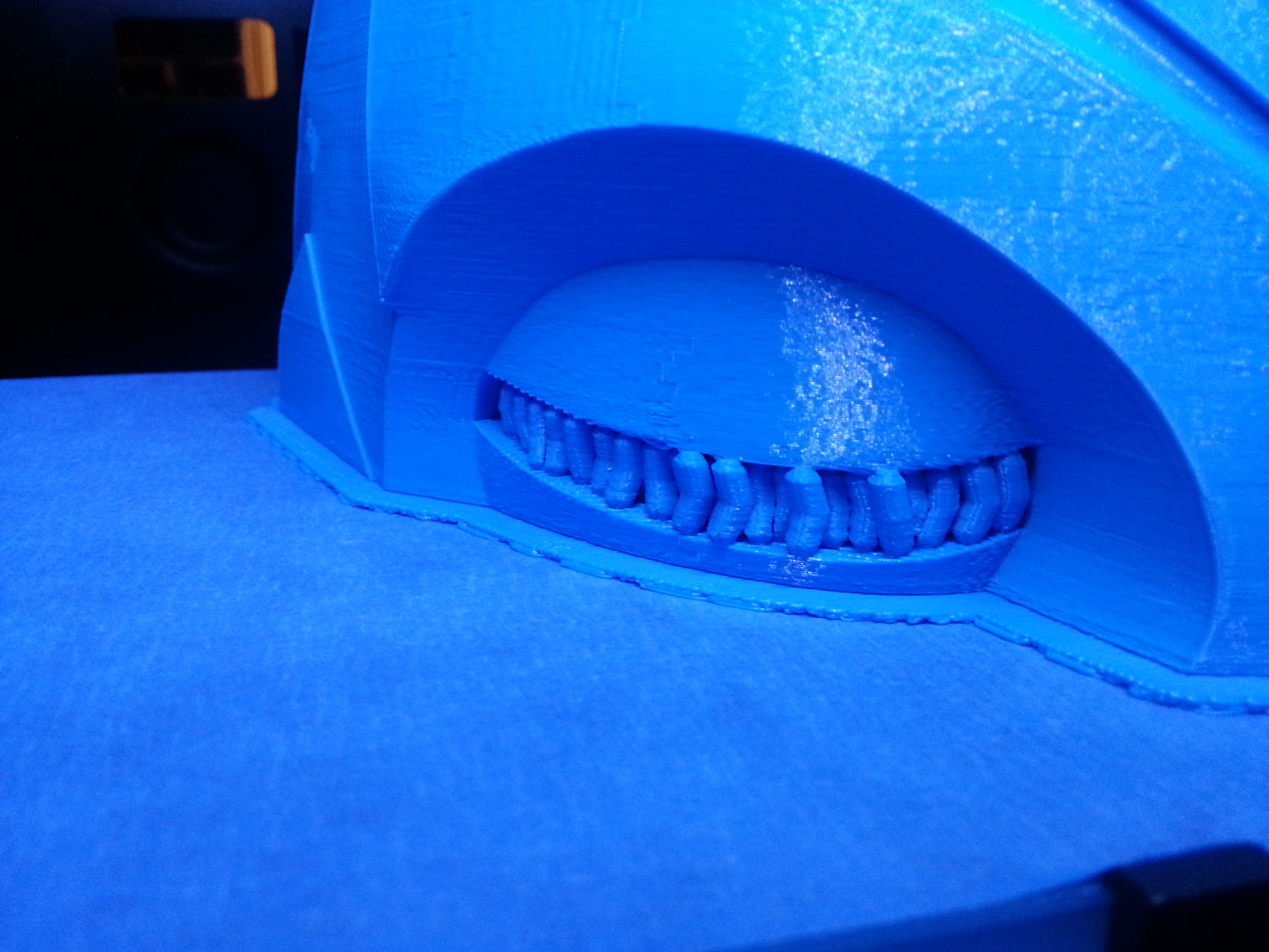

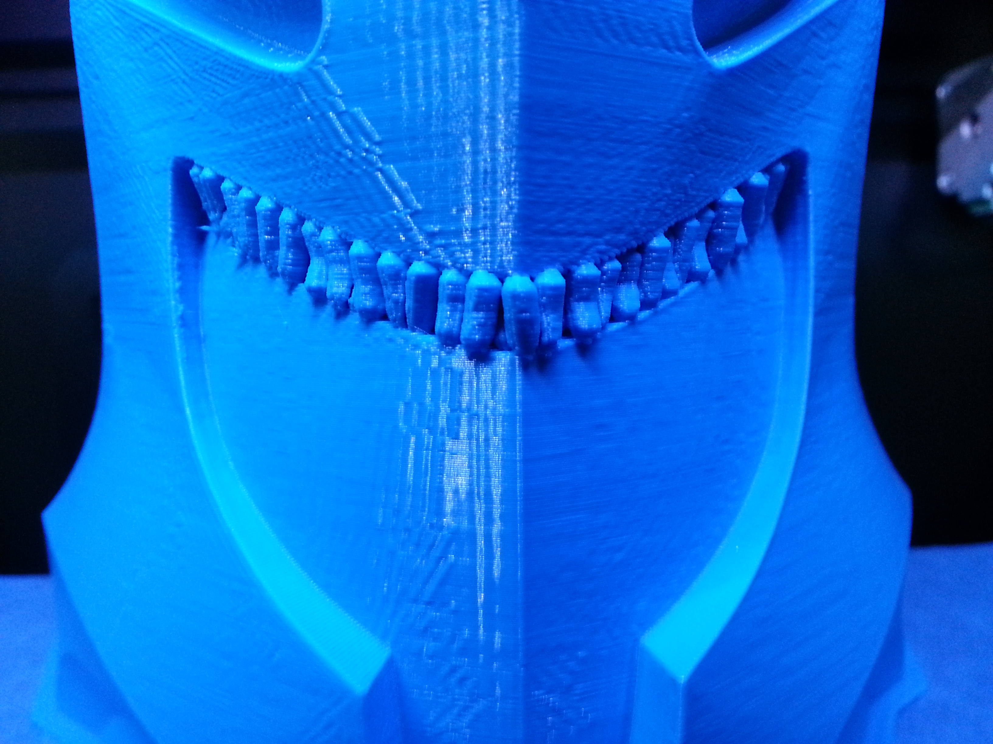

So, the plan is to print one, master it, and make a mold. Then I'll cast my nine. Here's how the printing looked, I printed the mask in two halves on my Replicator 2. I used Meshmixer to add supports in between the eye holes and the mouth hole. It's a nice program for this, you can make the little supports easy to snap right off.
[/URL][/IMG]

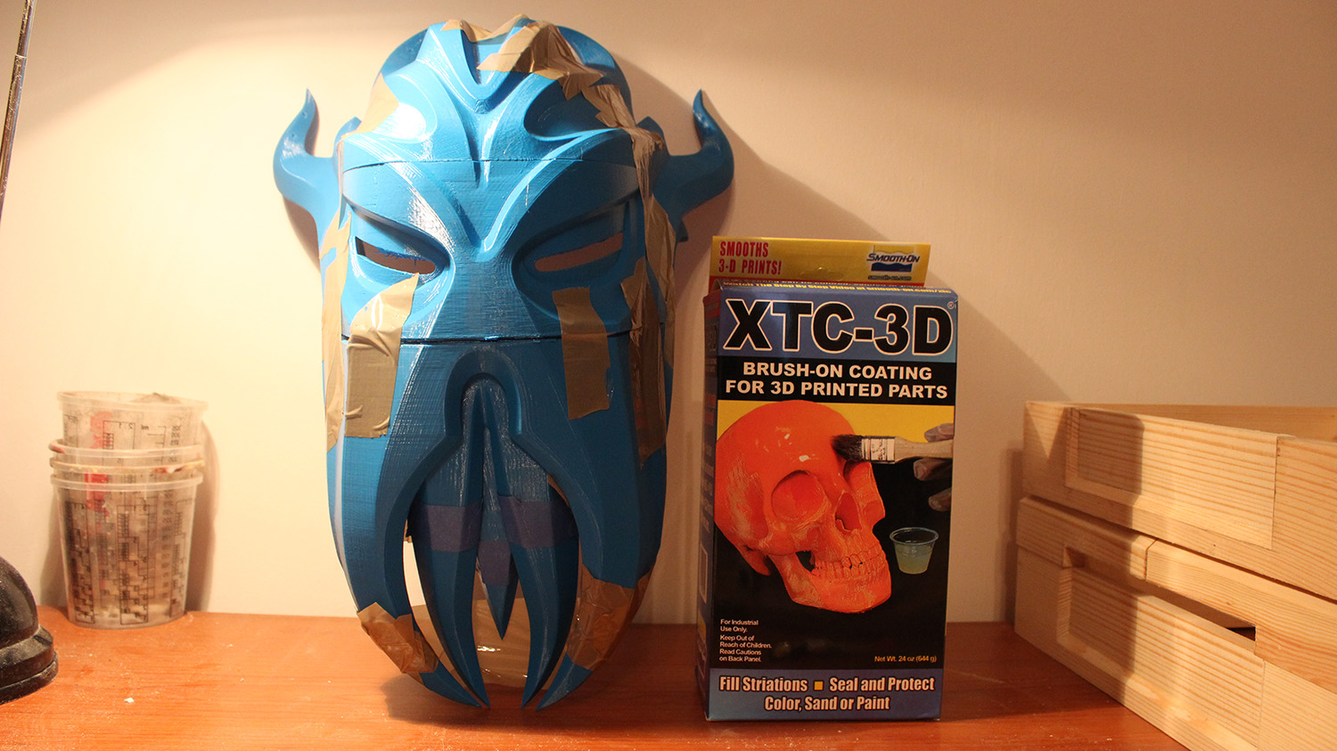

After printing it up, it was time to smooth it out. I used bondo, thinned out some with fiberglass resin, to do my smoothing work. I wanted the master to be smooth, despite the masks rough texture appearance in the game. After I was satisfied with the smoothing, I applied a few coats of primer and began to sand it down with ultra fine sand paper, giving it a polished surface.

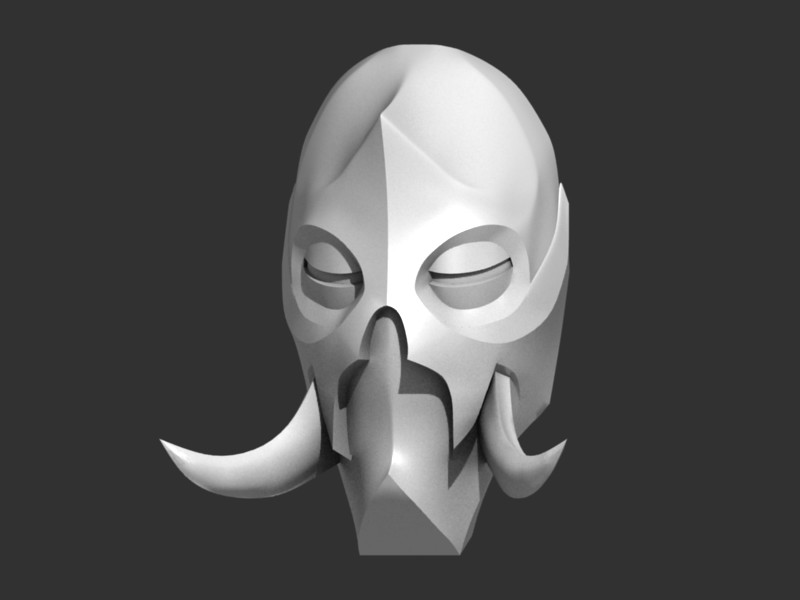

But, it's not all bad news! Check out the new KONAHRIK MASK!
JTM just finished this beauty up. I'll hopefully get it printed out in the next couple weeks. :D

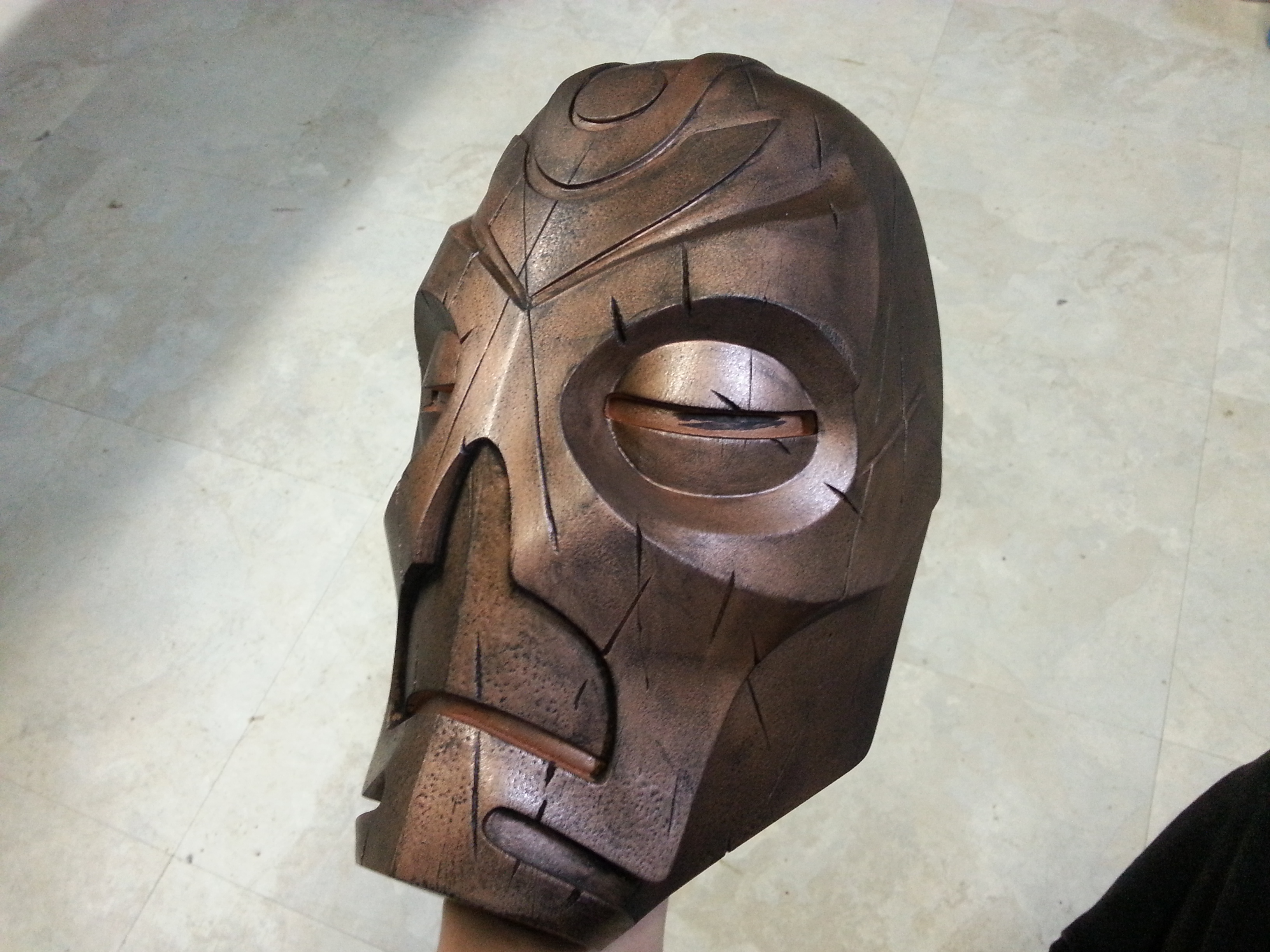

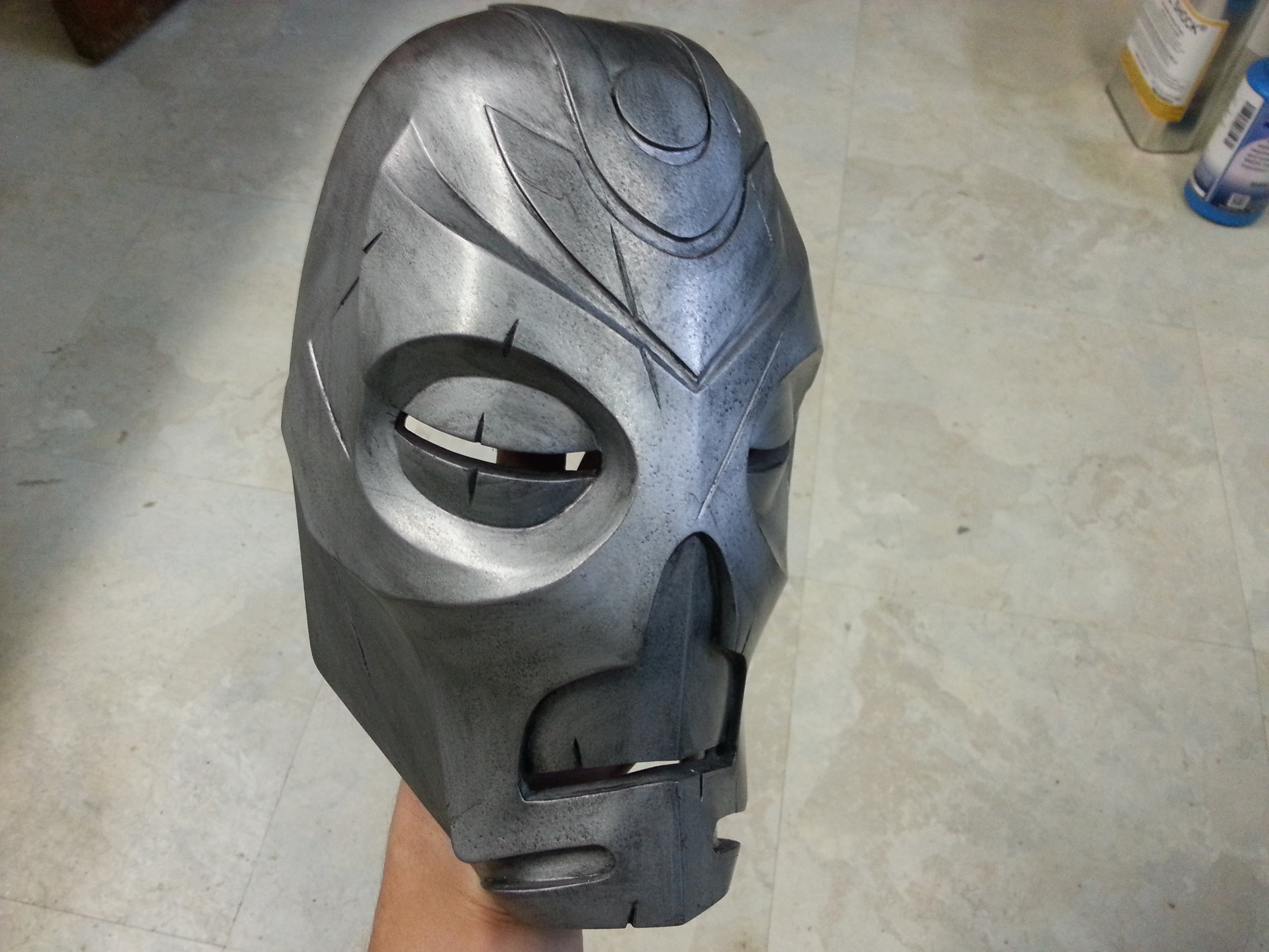

Hey guys, played around with scarring up a mask. Trying to find a good method and was hoping for some advice. I like how it's coming, but it's hard to get nice deep ones. Most are just on the surface.......
That said, what do you guys think?

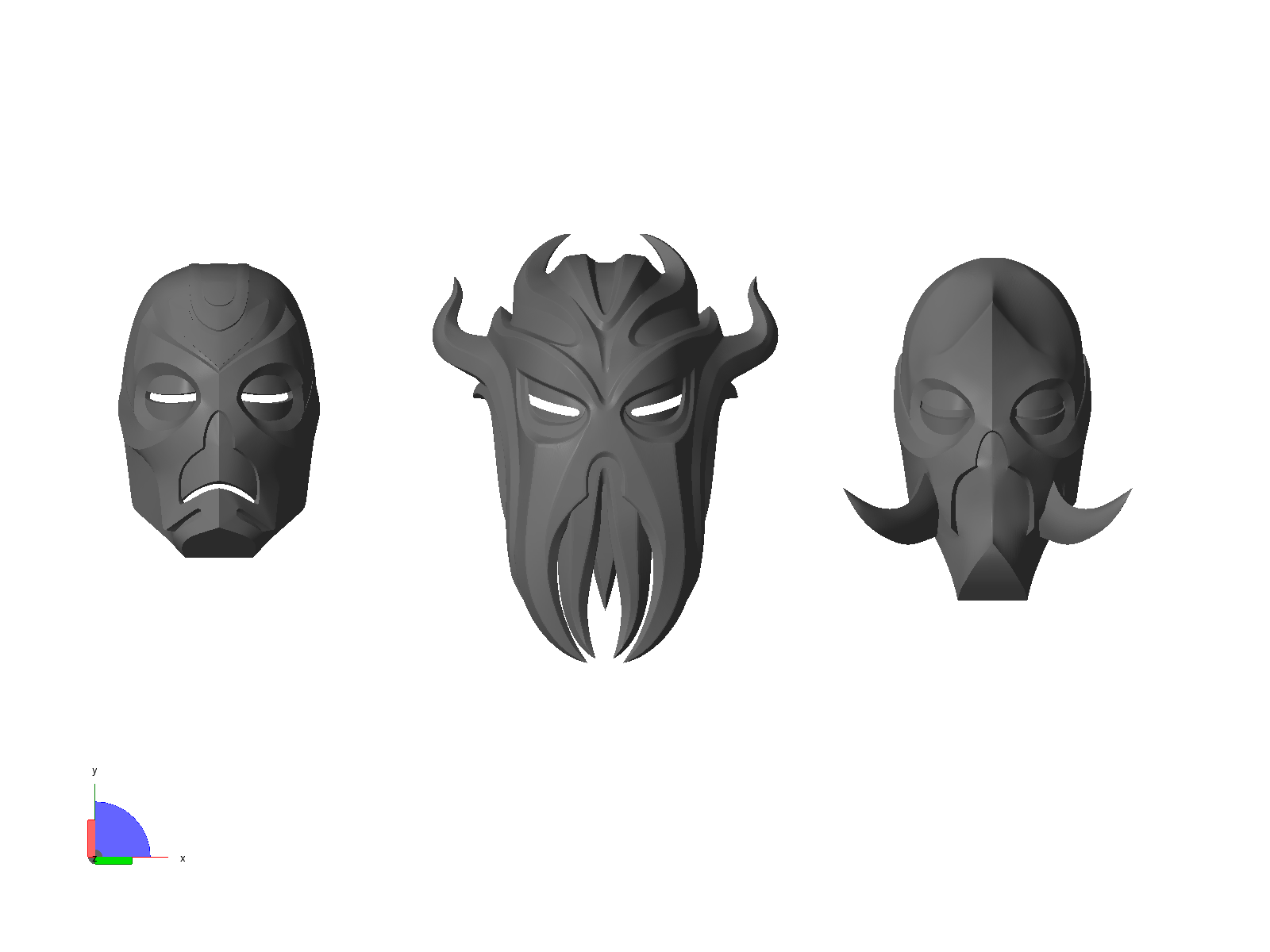

Also, wanted to show a sneak peak at the next mask......Miraak.
[/URL][/IMG]

What are you using to make the battle damage? A dremmel will get you as deep as you want to go.

Alright guys, got a little bit done on this. I've decided to forget about the enchantment colors. After studying the game models textures, I think they all are different enough to tell apart. I may still use lighting to get the effect.
Anyways, here's the current progress on Vokun:
[/URL][/IMG]
And I've got the base coat down for Volsung, gonna be griming this one up tonight.
[/URL][/IMG]
I've almost got all my casts pulled, and I have a good idea on how I will paint them. The green ones, however, have me thinking still..........
Anyway, what do you guys think so far?

The scaring looks good and the masks look amazing. I can't wait to see the rest of them.

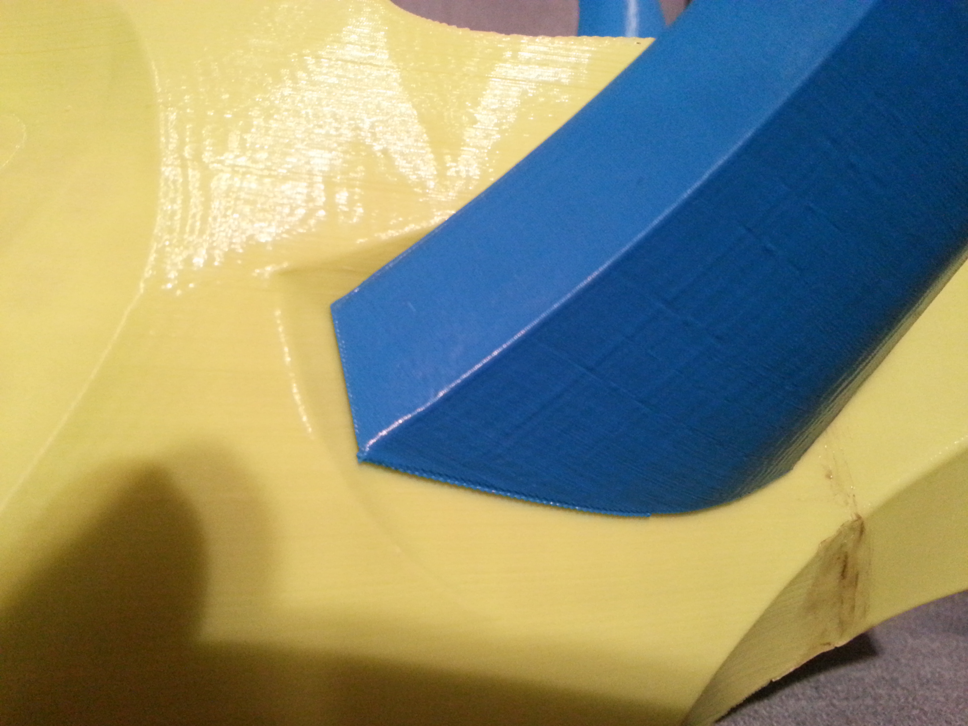

Little bit of an update. Konahrik mask printed, just need to do the tusks.
[/URL][/IMG]
Re: Skyrim Dragon Priest Mask Display--Konahrik Mask 3D Printed--
Got the tusks to Konahrik printed out today. They are a perfect fit, the shape key lines up with the hole perfectly!
[/URL][/IMG]
As you can see here, a nice tight fit. :) JTM did a smashing good job with modeling it this way.
