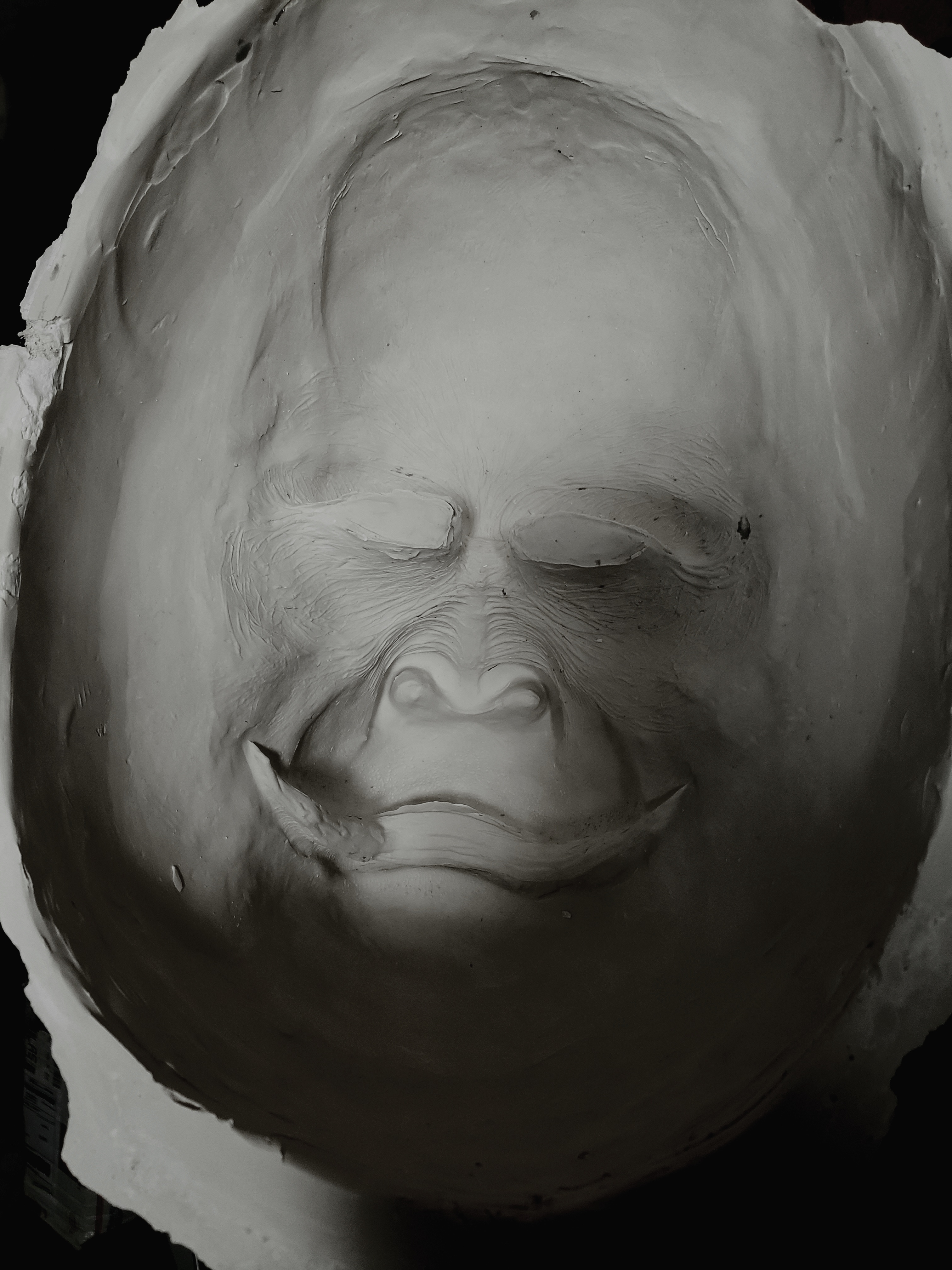

Like others have said, it's almost impossible to get your sculpt out clean from a plaster mold but if your mold is breaking, it's too thin and you don't have the proper burlap reinforcement.
I haven't used WED clay in a while and when I did, I just used a clear coat that worked pretty well. I now use med Monster Clay and use Pledge as a release.
Definitely use at least Hydrocal. I use Ultracal30.
Here is a picture of my last Ultracal mold:
