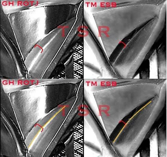

Gino seemed to have a problem before with some of the differences I pointed out between the ESB and the ROTJ. For example, the front right cheek face of the ROTJ mask has a thicker "lower lip" (half-moon shape) than ESB/ANH. The original ROTJ that Gino showed before has it as well as the GH ROTJ. If the ROTJ are all unique, why would the GH ROTJ be identical in that regard unless it originated from that particular casting shown, but that is unlikely given the number of ROTJ masks there were in the production. That thicker area is also seen onscreen. The reveal has it as well but it is sharpened a bit more. So if these came from ESB they would have to be each individually modified, possibly by sanding down the front face of that cheek...a lot of work.
Also the nosebridge on the ROTJ is narrower than ESB/ANH...uniquely so actually. One sees the narrower nosebridge on the original CIV ROTJ mask, onscreen on the stunt ROTJ, and although not shown the reveal has it too. Looks like they went through a lot of trouble to make that one feature look the same, whether to make it more symmetrical, to get rid of roughness from the sides of the bridge, or whatever reason. But it is common to the ROTJ castings, and not seen on ANH/ESB.
So the ROTJ just didn't pop out of an ANH mold. They underwent extensive changes, yet surprisingly similar ones for each helmet if Gino's theory were true.

The "thicker area" is clearly the result of painting at nothing more. Look at the red line you have drawn on "GH ROTJ" and then look where you have made the bottom line of the width bracket.
Then look above that bottom of the width bracket to see the actual crease in the helmet. That is where your bracket should end and I bet you'll find it very similar to the other helmets in your compare.
The only difference between the helmets in the top 3 compares is the painting in that area. They went outside the lines on the GH ROTJ.

The "thicker area" is clearly the result of painting at nothing more. Look at the red line you have drawn on "GH ROTJ" and then look above it to see the actual crease in the helmet. The only difference between the helmets in the top 3 compares is the painting in that area. They went outside the lines on the GH ROTJ.
No it is an edge, you see the same thing on an unpainted GH ROTJ. OMG is right.
Please show me this area on an unpainted GH ROTJ and compare it to the picture you just posted of the painted one.

Here's another comparison as requested....I see what you mean but either the front cheek is taken down or the side of the mouth is sanded down...either way that half-moon shape is deeper. You want to look at the outside edge of that shape, where the line of the front face of the cheek meets the top of the upper tusk tube. I am limited by not having a GH ROTJ, but the feature is there.
And here it is clear as day on the original ROTJ reveal...
EDIT: and back to that original ROTJ Gino showed...
