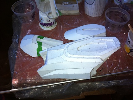

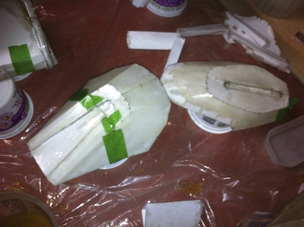

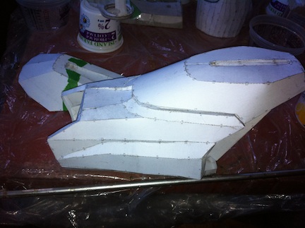

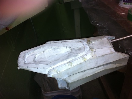

The supports, surprisingly, pretty much failed on me as soon as I started the resin.... lol... but then I never have had any real luck with supports of any kind. So I counter-balanced it... but with my resin-application method, I'm not overly worried. ;)
What I'm doing is a few (3 on average) super-light resin coats to offset any fluid weight... and then the same on the inside before I use any fibreglass to reinforce.
I'm not going the Bondo route, though... I'm likely going to keep the suit fiberglass or a similar material and cast my originals in silicone, then pour some positives from the mould (resin or polyurethane or another durable polymer) and smooth with epoxy.
Here's another pair of pics... light coats of resin on all the aforementioned pieces.
