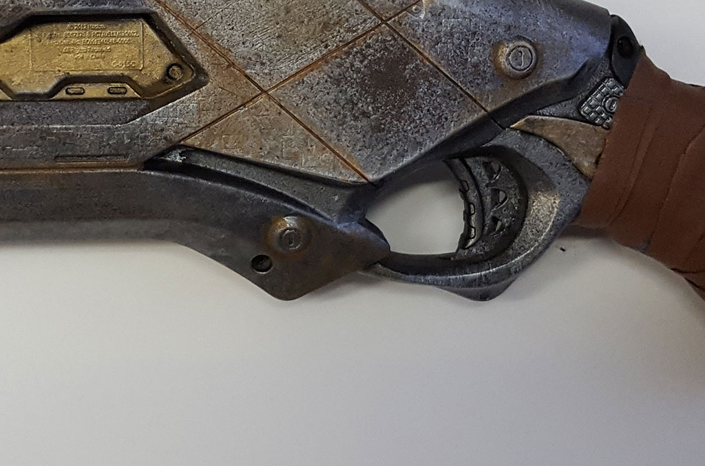

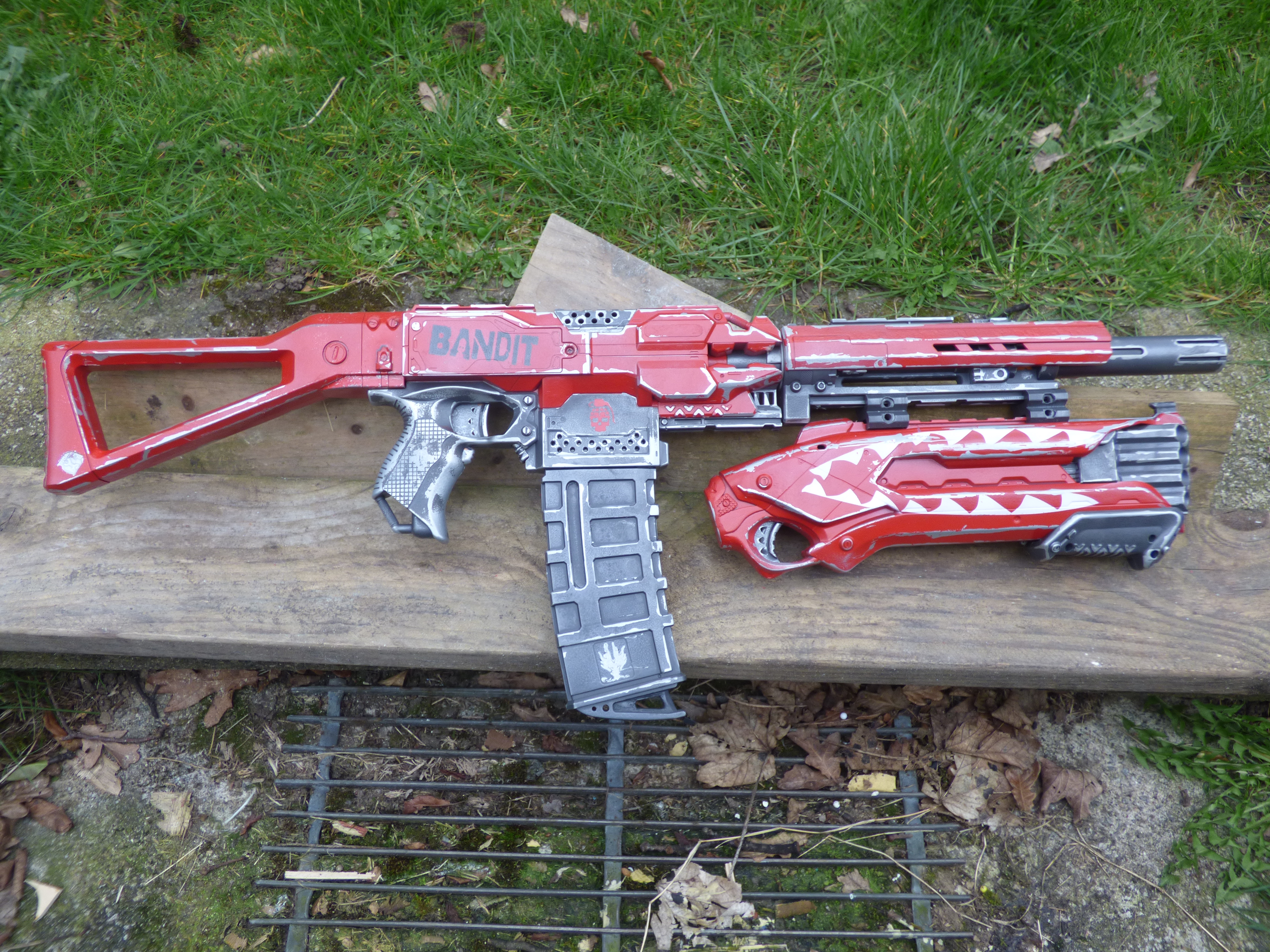

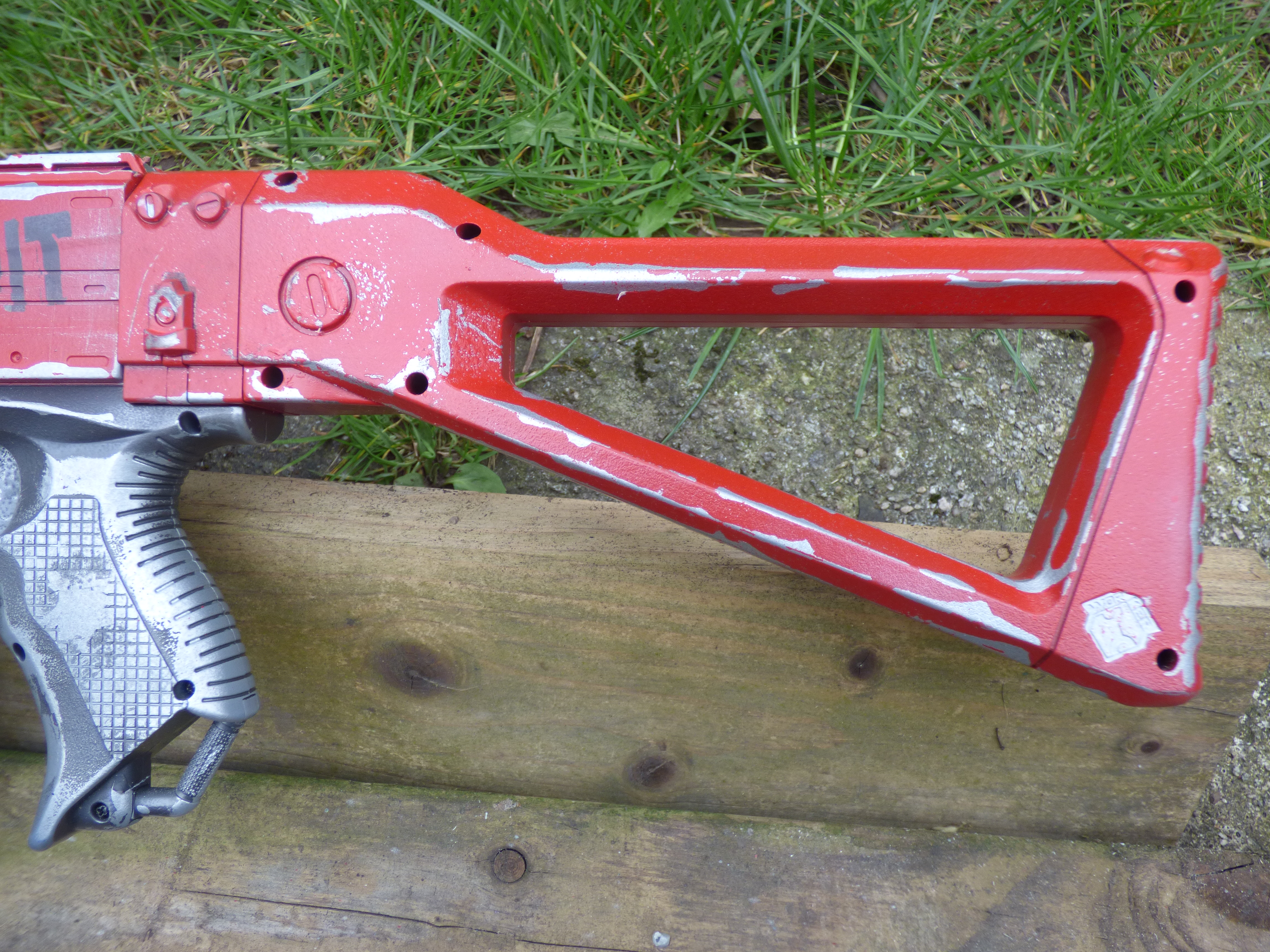

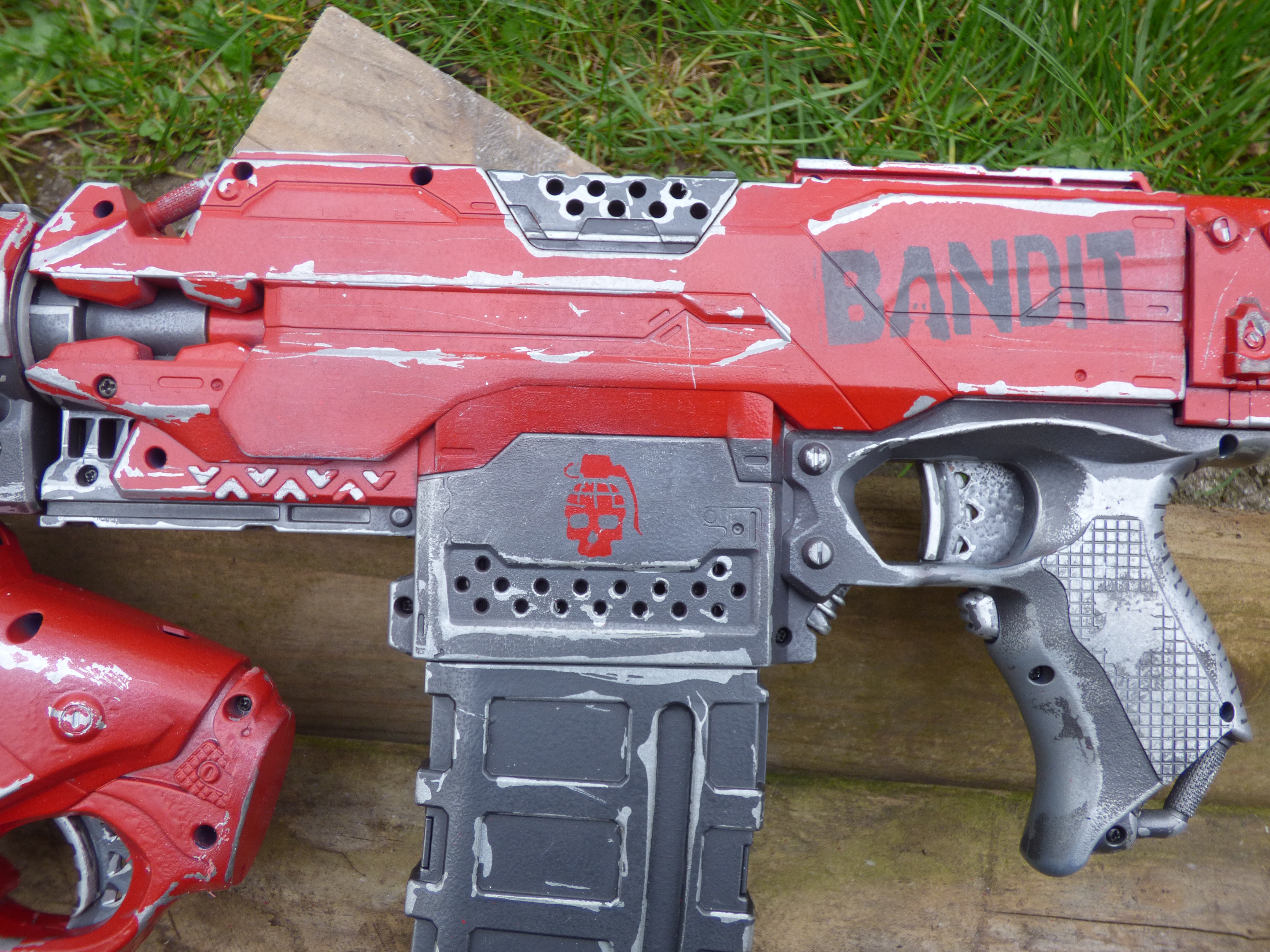

As an experiment, I decided to see just how far I could push this salt-mask rust look.
I started with an undercoat of rust brown, and then another coat on top of that, but while it was still wet, I sprinkled it liberally with sea salt from a grinder so that it set into the paint, and then a coat of matt aluminium on top of that. When the aluminium was dry I rinsed the salt away with warm water. The pitted, speckled look I was hoping for came through perfectly.
I then masked the bits i wanted red with tape, and then used rock salt in the usual way to achieve the chipped paint appearance (the more I think about this, the more I am convinced that I should have dropped the rock salt onto the aluminium while it was wet. That way it seems to give a much sharper finish, and as I found with the rust-base, it's also a lot easier to manage than the usual method of trying to affix it with water. Next time...), more masking and a bit of dry-brushed matt black for the handle and the muzzle, and finally, all of the aluminium and red parts got an all-over wash with a combination of rust-brown and grime.
Alterations to the bodywork include; the rails (mostly) removed, the dart holder was chopped out, and the redundant iron-sight from above the muzzle are all gone. I also filled in the logo roundels and the grill in the back of the grip for extra streamlining.
Another relic dug up from Nerf's past! :)

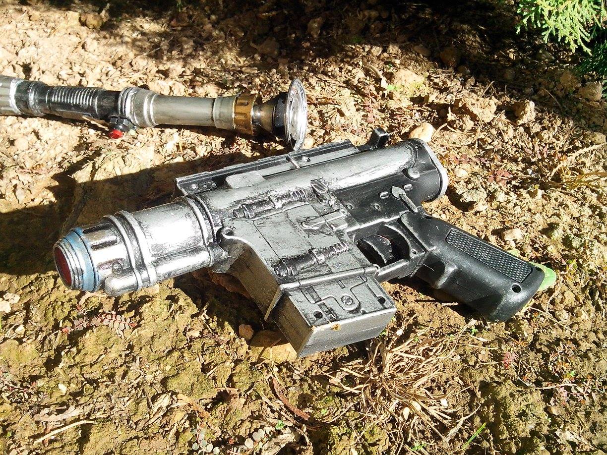

Hello there.
I just have found this thread by accident, and I really like the quality I have seen so far. Good job guys!
I am more or less starting in the prop making world, and I have made a few guns already, so why don't show them here?
First, a repainted and slightly modified Cassian blaster, from the Rogue One collection:
15994332_1417551804945544_478868182760359808_o.jpeg15994838_1417551801612211_6847031675396013938_o.jpeg15995133_1417551808278877_517056516748802248_o.jpeg15995288_1417551958278862_3607611712470177656_o.jpeg
And, it is not a Nerf gun, but I wanted to mod a cheap water pistol to give it an steampunk/atompunk feel, so I made this:
13391475_1212486435452083_5181314302226113834_o.jpeg13403166_1212486515452075_9083175589860986460_o.jpeg13433232_1212486428785417_991992266598640251_o.jpeg13433377_1212486432118750_7486423343835167742_o.jpeg
It is far from perfect, but hey, its a start.

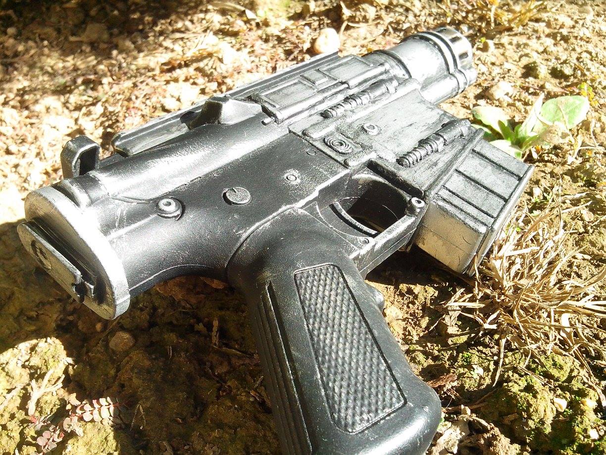

I'm still relatively new to making props, but here's the few things I've done so far. Been selling on eBay to recoup the money it's cost me to buy the guns and so on in the first place to learn with.
My first attempt. This was customised from a Nerf super soaker.
Cassian Andor blaster from Rogue One.
Original design vampire hunter gun.
Not a Nerf gun I guess, but my most recent one. ROTJ Boba Fett blaster.
Feedback appreciated :).
Thanks for looking.
