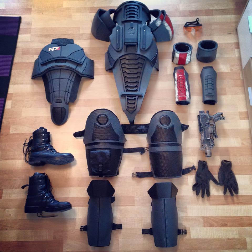

The file N7_platform (A4 or Letter sized, depending on what you use) is basically a blank canvas, sized for one sheet of printer paper. Drag each (or multiple) layers onto this ensuring they do not overlap.The more you can fit on a page, the less paper/ink you'll use.
Print it and use it as the template for your foam.
