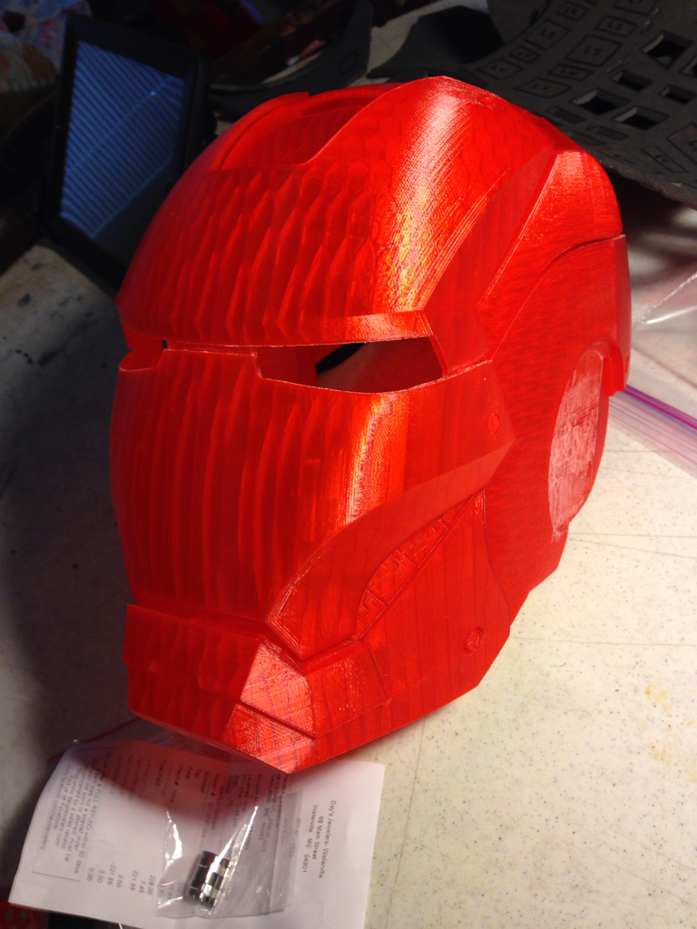

most def had to separate the back parts a bit.
but nothing a little plastic cement can't fix
Hey tommy, did you separate parts further? Or just how they were? Your prints are looking good..........need to get back on mine:cry

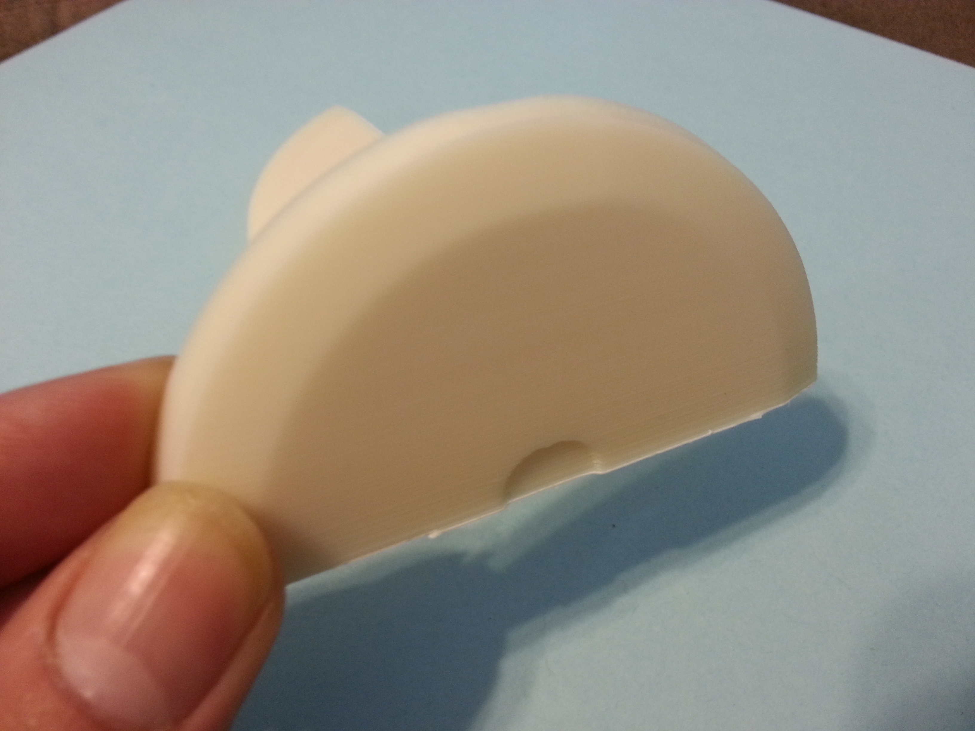

Prints are getting much better. I'm currently using ABS. And I was wrong about laying the ear down flat. It looks best when you split in half and print the halves upward. Printing jaw now!
Re: My Iron Man Mark III Helmet 3d Print Files (New Helmet available in post #1!!!)
Thanks to tommyb345 for showing me nettfabb!!!
View attachment 274278View attachment 274279
Yeah the ears warped when I print them flat. So I'm going to print them standing up.

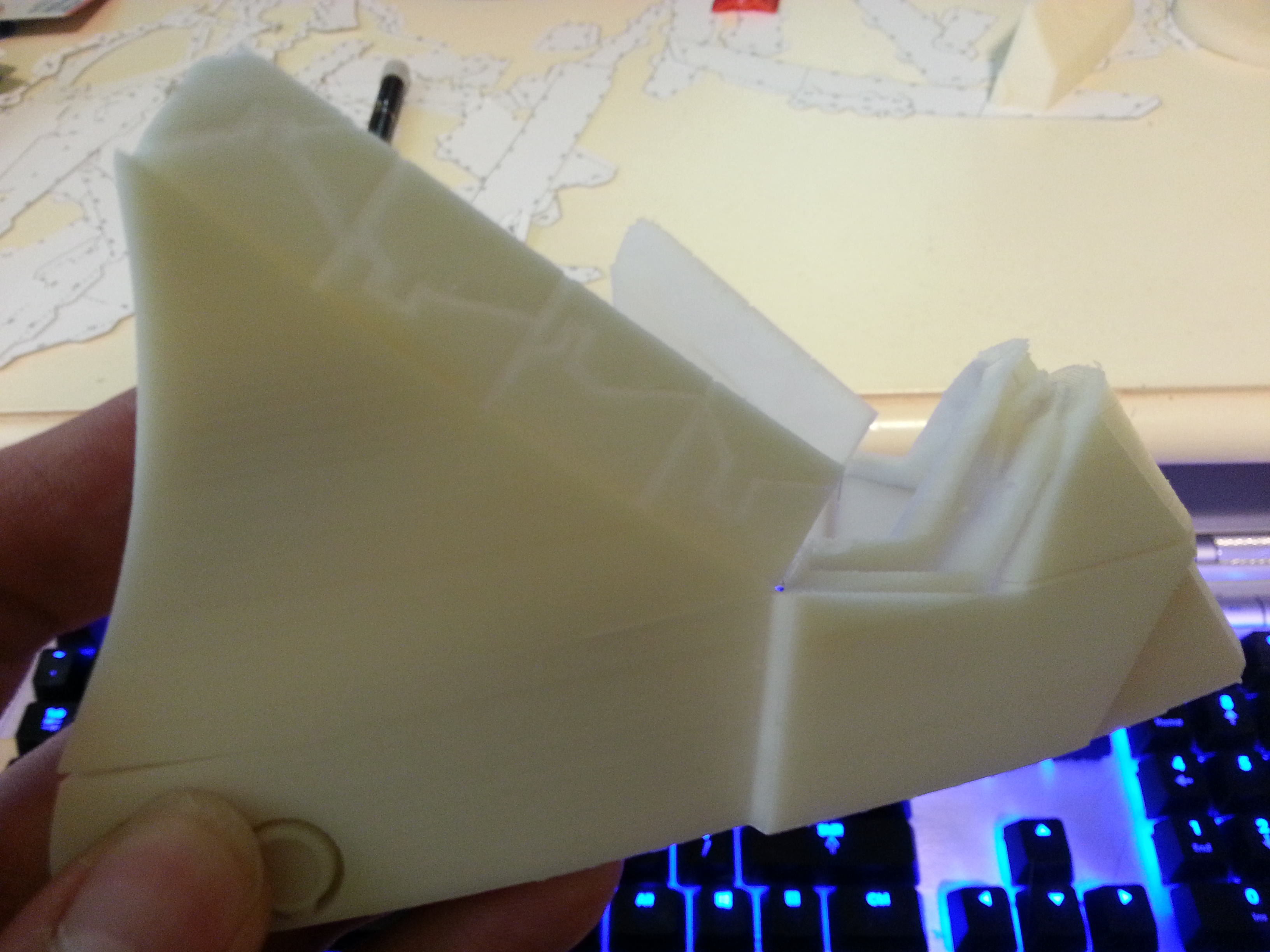

Damn bro, sorry to hear that. I hope you get everything sorted out and working okay. Don't feel bad, had a good print of the jaw going and had some delamination problems. Looked it up on the forums and possibly not hot enough tip, or because it's white filament. Apparently white abs has had this problem on long prints. Short ones, like 5 hours or under are okay.
Not sure if it's ruined though. Might be able to doctor it with some rondo.

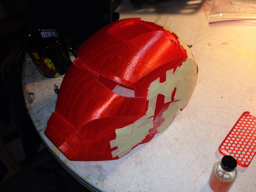

Gluing now using plastruct plastic weld. Printing the ear pods and the lower back of the helmet now.

Just wanted to point this out for the evolution of the model. Printing the jaw I noticed the left side has a gap where the other side is solid. It doesn't hinder the print, though. I was worried about weakness at the joint when prying the part off, but it was fine.
[/URL][/IMG]
[/URL][/IMG]
Just passing this along, in case drumguy wants to know.:)
URL]
URL]
Ah thank you GhostMinion !! I'll fix that right up and update the first post. Thanks for the info!
