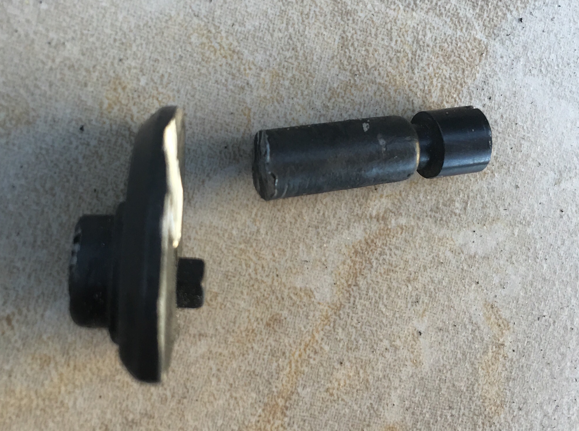

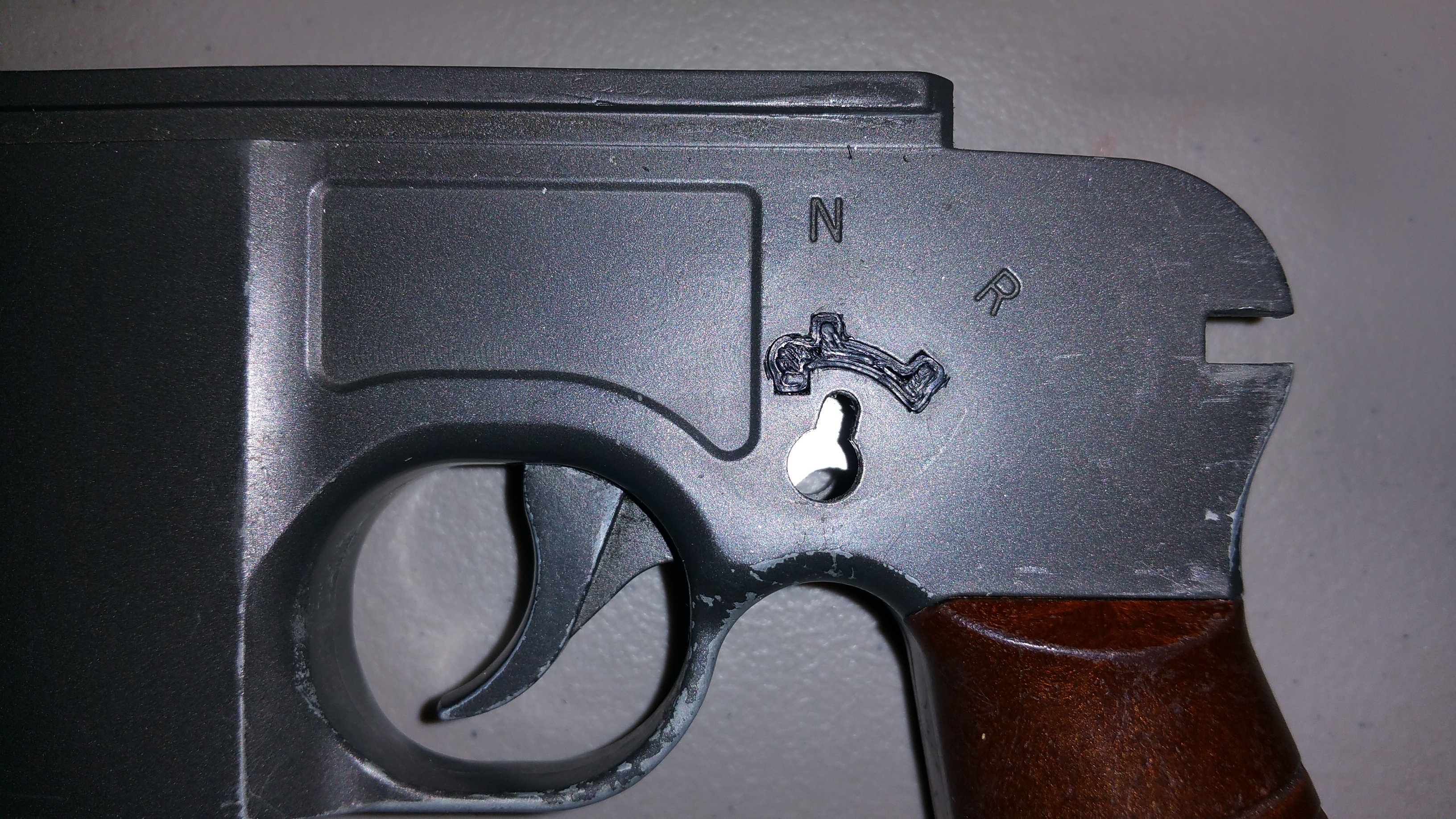

Quick update on the selector switch, the mold didn't come out well at all so I 3D printed one. Its just a pressure fit for now but I will start including this with all new orders.
If anyone has already ordered would like one just shoot me a PM. My end goal is to cast this piece in pewter which may be impossible but Ill keep trying.
Also, I have been working on a new piece for the screw to connect to. Stay tuned!

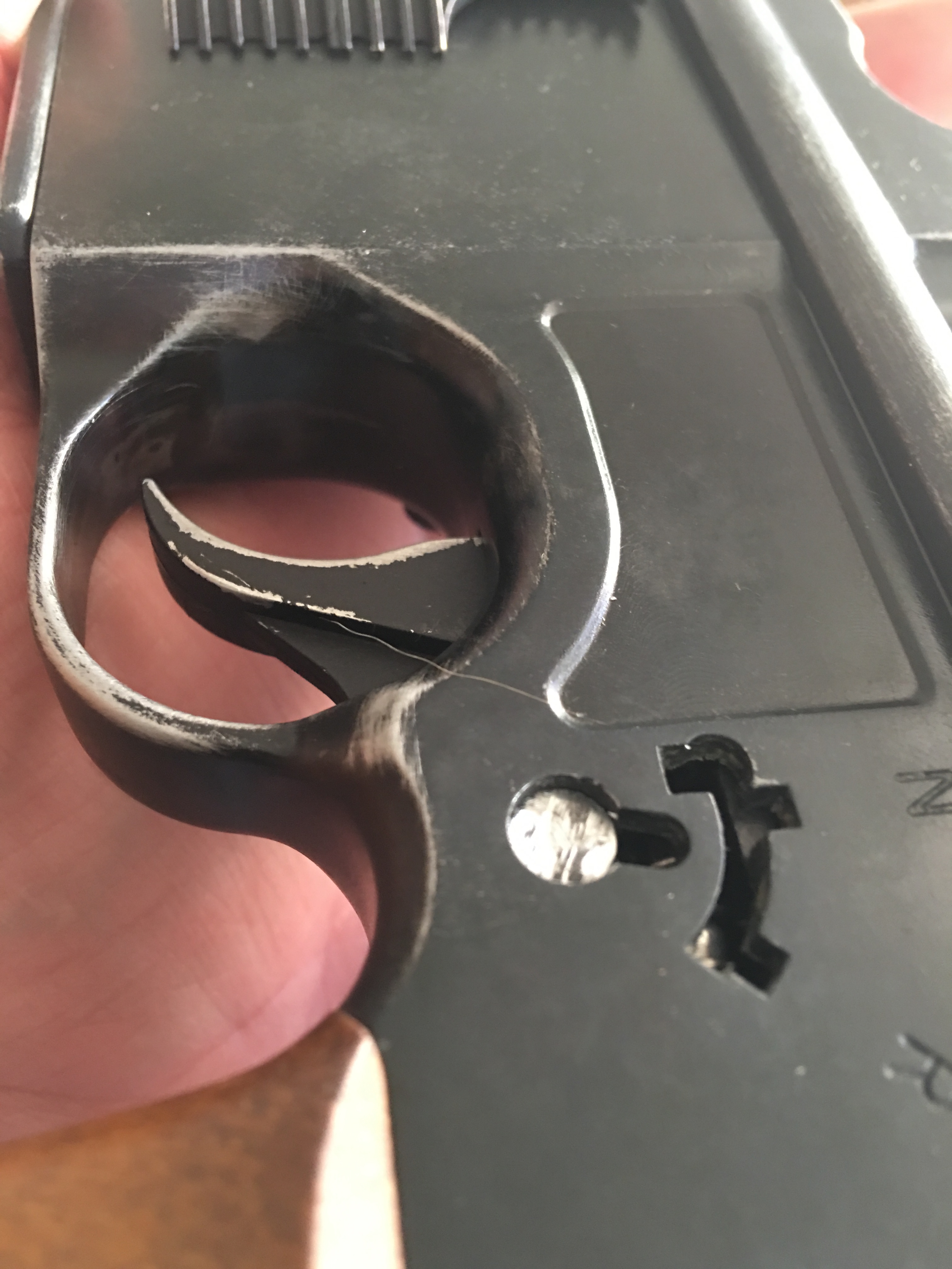

Yeah a plug for the screw post to screw into on the end where the selector was is very much needed, without having a notch to fit into that hole like the switch did, it would just rotate and slide out. Really cool that you're making those parts too!

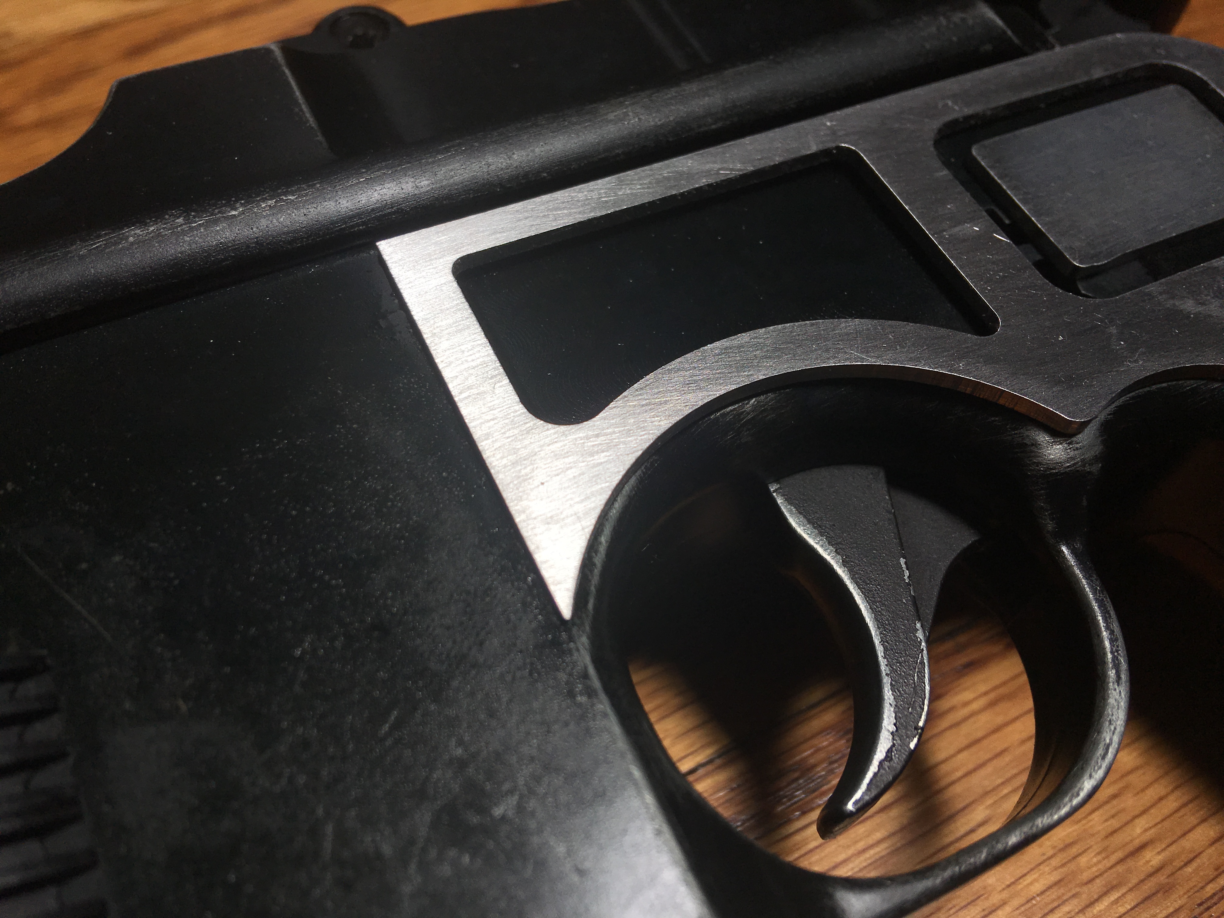

This just arrived in the mail. Very nice fit (just laying in place, not affixed yet). Well worth the cost. I am going to tinker with this tonight after work. Awesome job, thank you tomm1999!
I used a Dremel to cut the pin from the switch. As you will note, there is a gap between the pin and the screw. The screw and the pin will tighten against the body of the gun and very securely hold it in place. The pin will not fall out. I think that I am going to fill the lettering and holes with JB Weld SteelStick. Sanding it down, then hopefully bluing it (or painting that section if needed). I then think I will use E6000 to apply the metal face in place. I may not get around to this until the weekend, so any direction or advice is welcome.

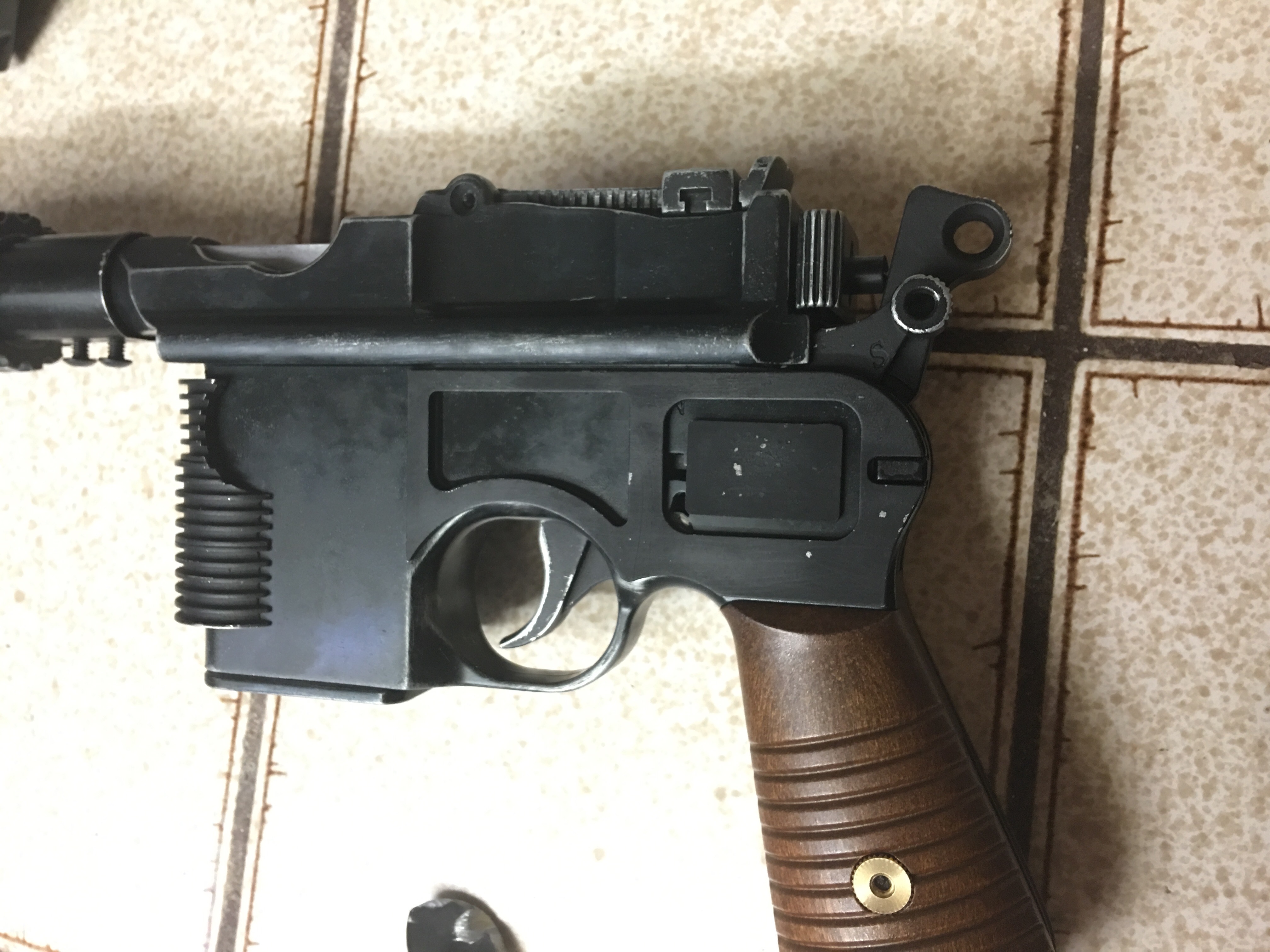

I did a little bluing tonight on the plate. I think that I will give it a few more passes tomorrow. I want to finish this project (for now...) this weekend.
That looks great! Its nice to see someone complete it. Unfortunately I have been working on other projects I haven't been able to start mine. I played around with the screw and post I got the selector switch off, just need to cut the extra length ff.

I placed it in a ziplock with some Aluminum Black, and it took right away. There was a small area that was still rather light. I leave it in the bag a few minutes while I rub it through the bag. Take it out and rinse in warm water. Wipe dry, lightly run some steel wool across it, then place it back into ziplock a second time (this time the lighter spot took better). Removed, rinsed, dried, and repeated in the bag a third time. Rinsed, then applied gun oil. I will likely run it under steel wool again tomorrow and apply more AB.

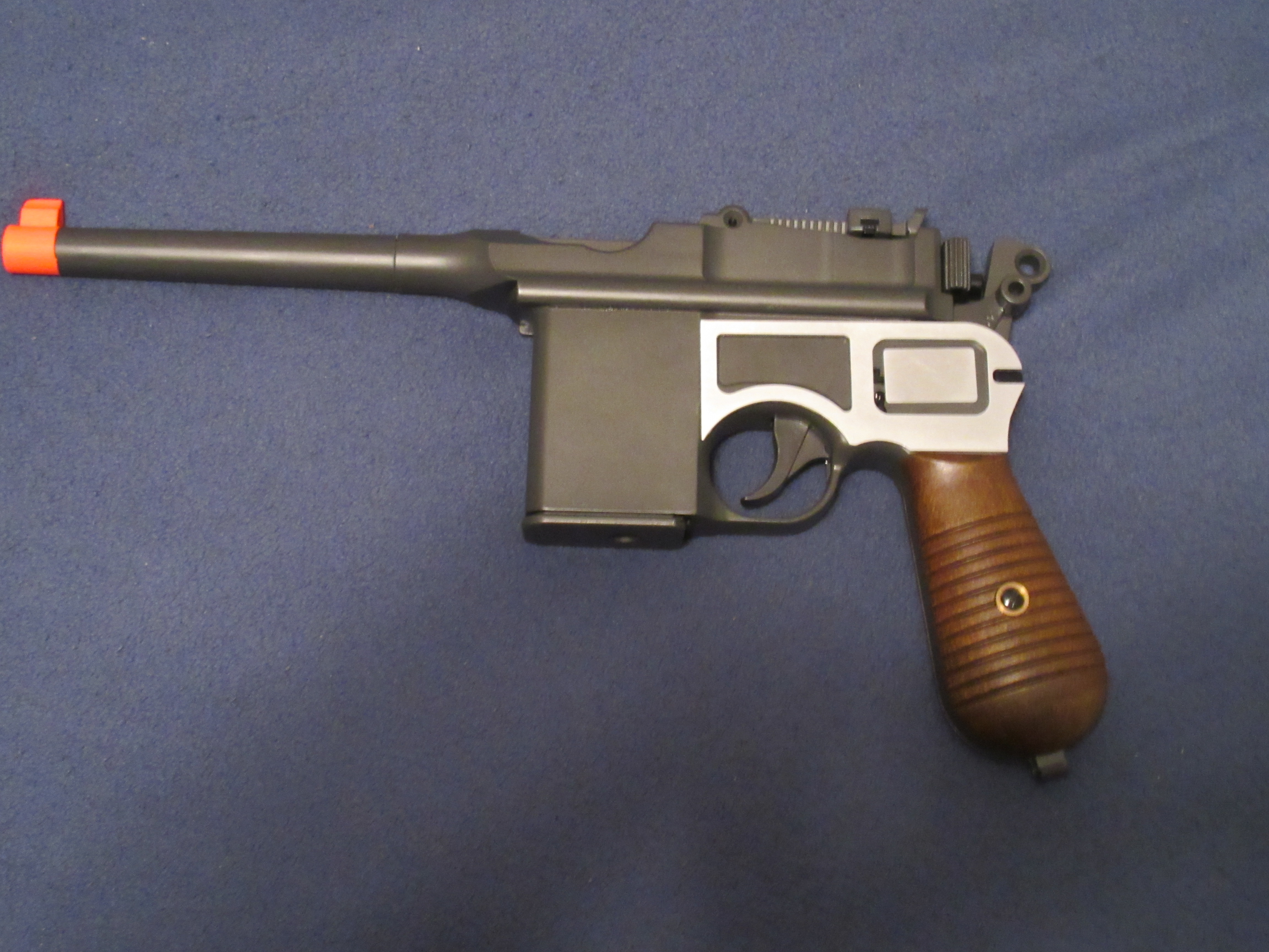

it fits perfectly! You did one heck of a job on these!
