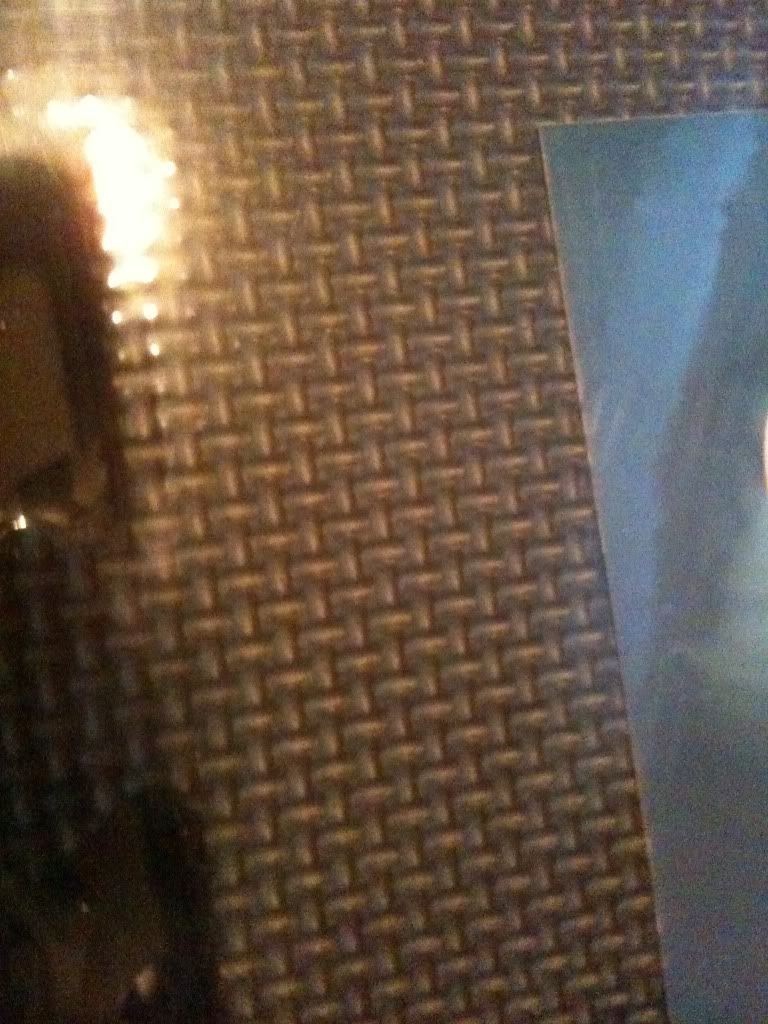

I'm loving this thread I don't really reply that much I'm more active on the 405th with halo stuff but I had to try this out, unfortunately my local Harbor Freight doesn't carry the grey so I got black. tell me does this look familiar?
