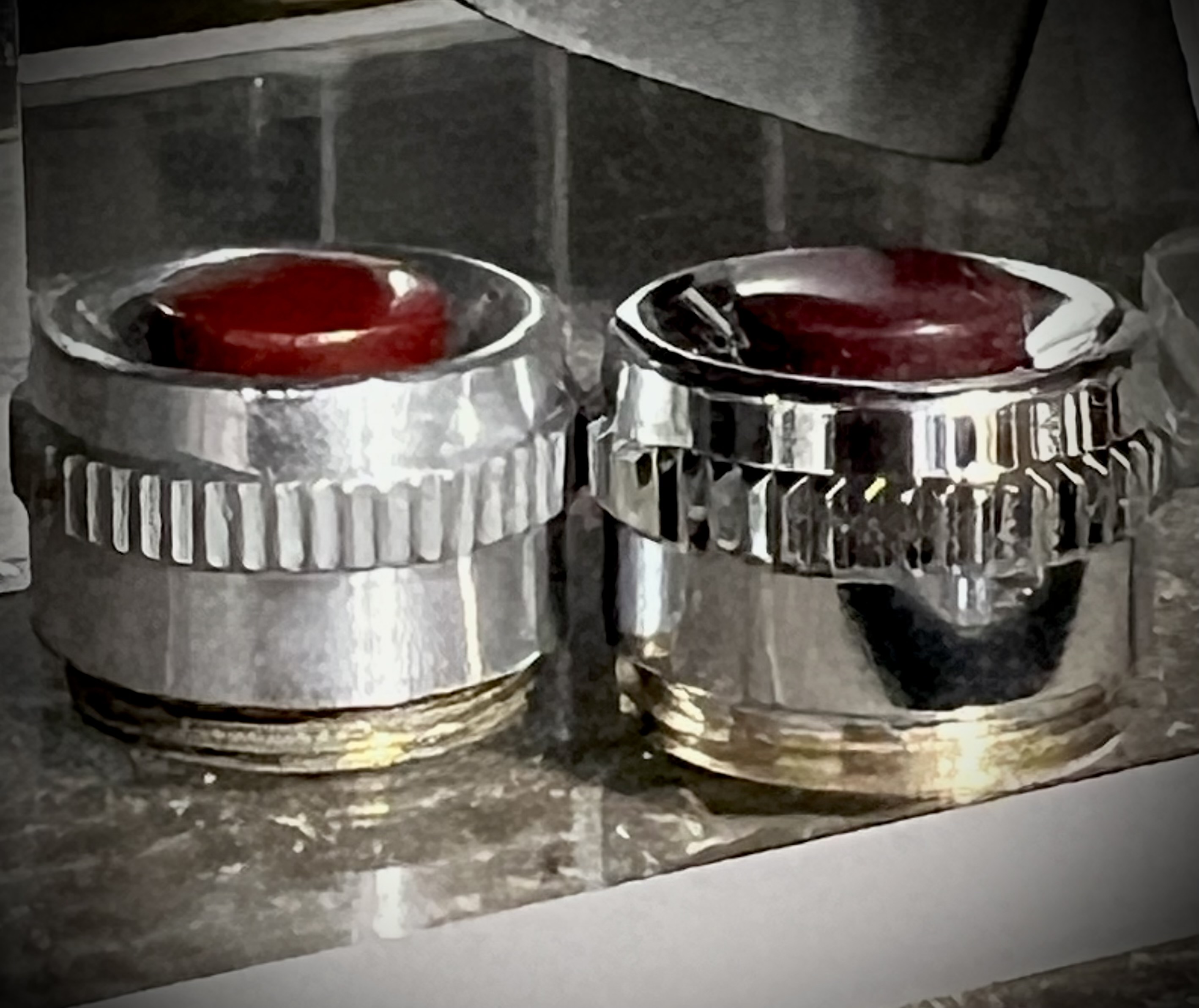

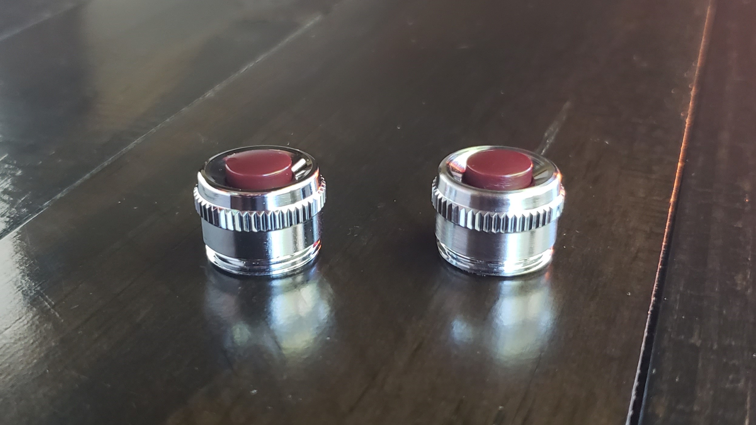

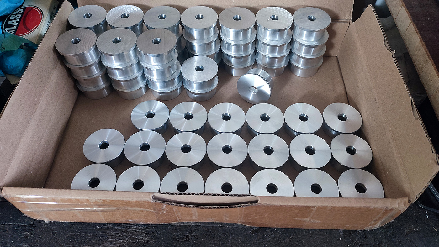

Knurled back caps are all done, that was quite a workout! but they turned out nice, so I'm happy I managed to do such a difficult part:

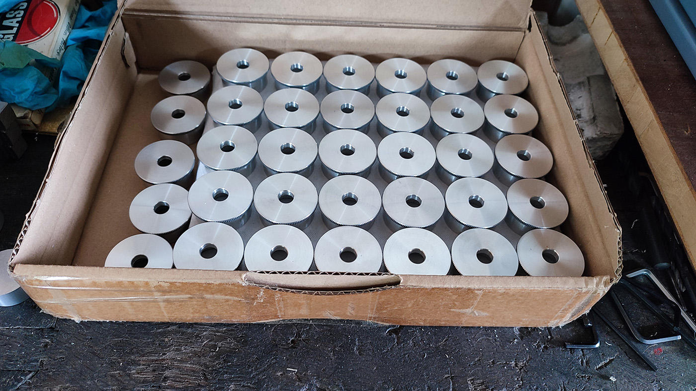

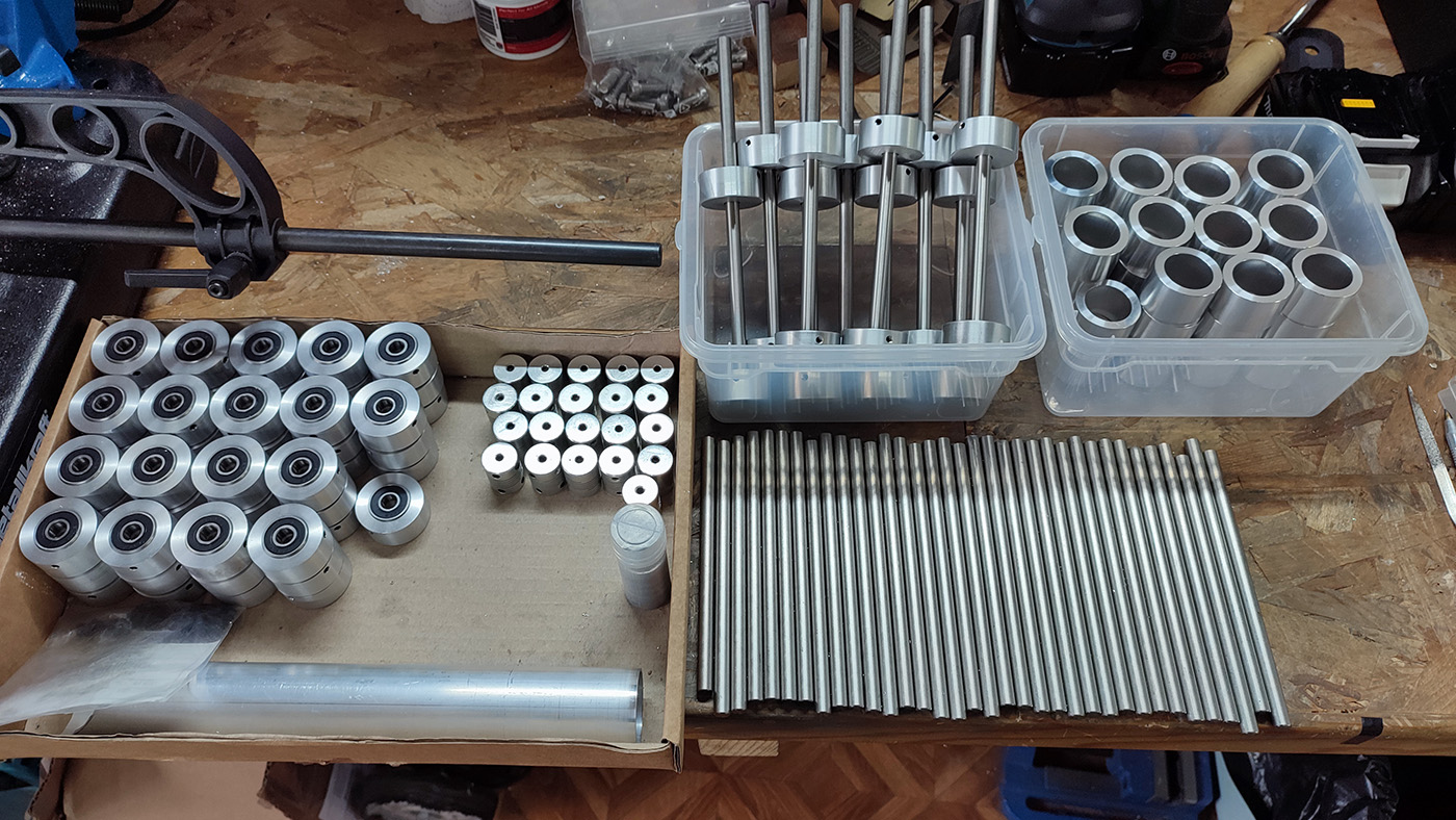

all the other parts, cores, motor couplers, "static" cores with rods, motor spacers, rods for the motorized versions:

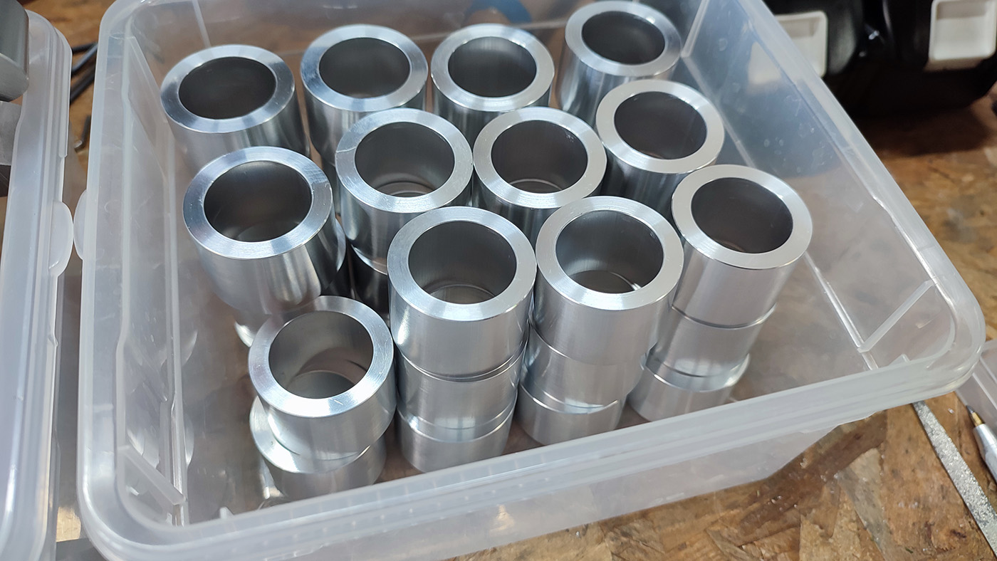

those are spacers to center the motors inside the main tubes. The idea was to go as quick and cheap as possible, so I started with a 35x5mm tube that was close to the spec we needed. The exterior was turned down slightly to fit the tubes, the inside is very slightly too large for the motors, so a bit of tape will be necessary, basically like they did for the screen-used saber:

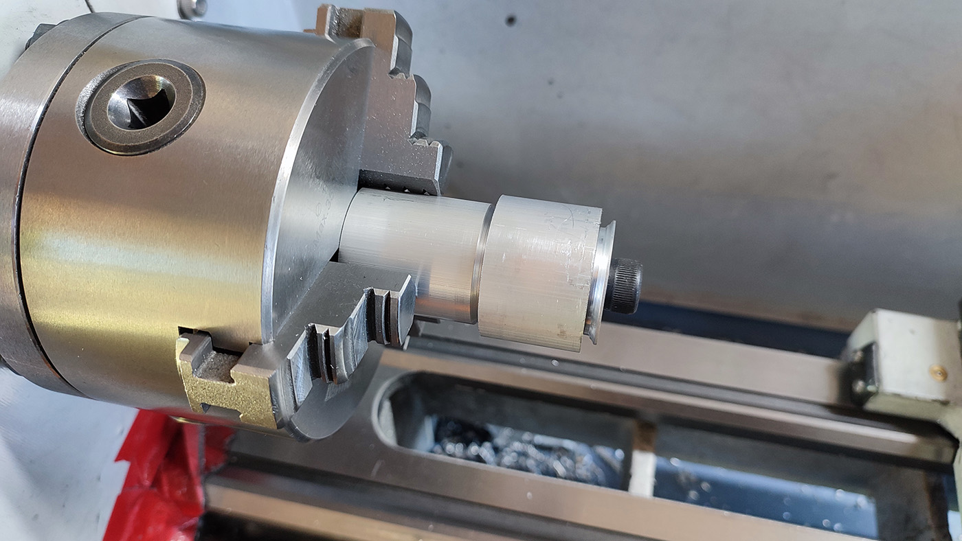

small jig made to turn the outside of the short tubes:

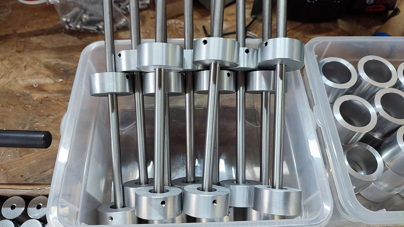

those are core/rods assembly for a "static" version i'll offer as well. it is built around two cores with two ball bearings to attach at the same position as the motor spacer would be attached under the clamp, mimic the weight of the motor and have a free spinning stainless steel rod at the emiter.
This will be a low number option and all the parts will come assembled already. Just needing the red button, glass eye, clamp and grips.
