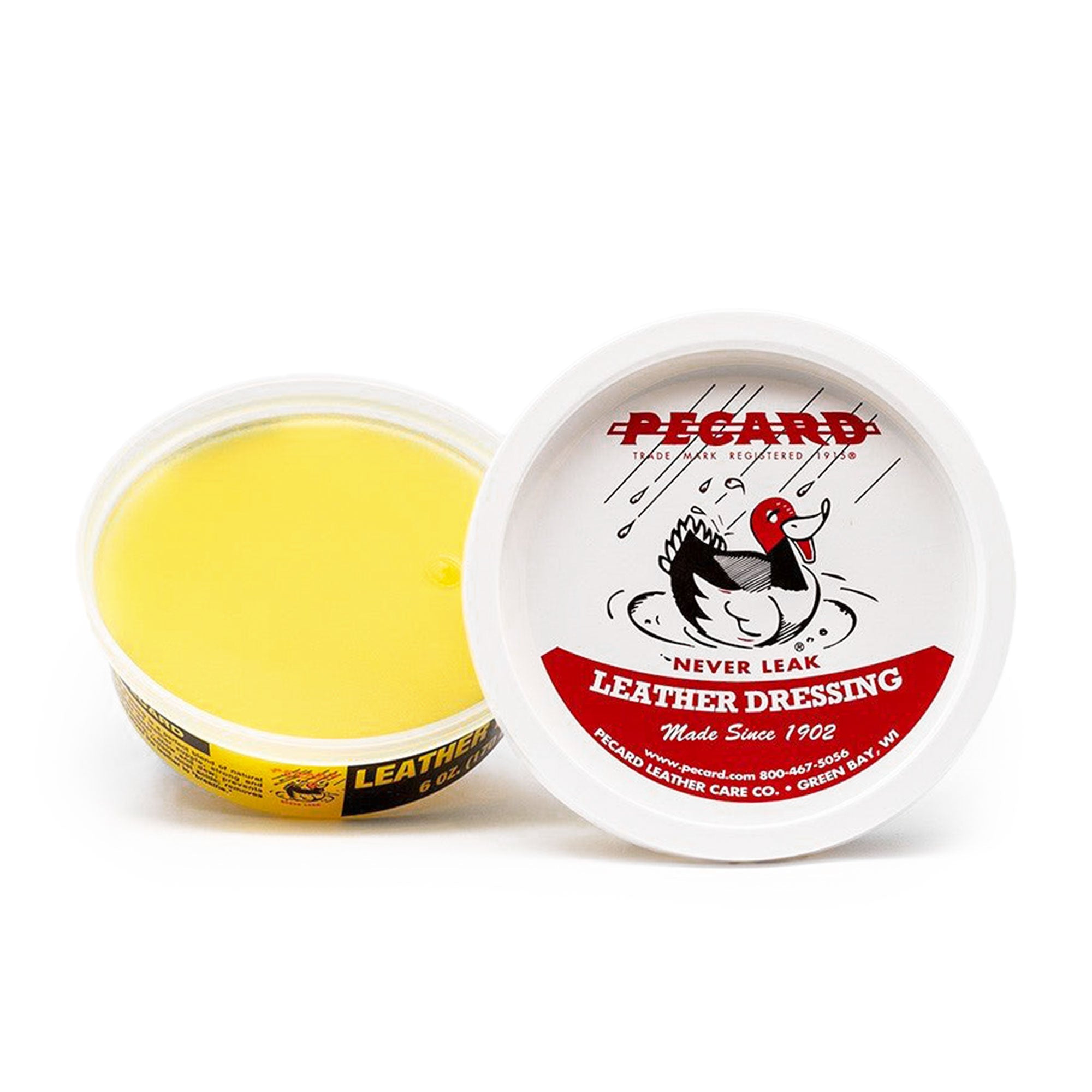

Thanks for the info, guys! I'll look into the Pecards products. If other people have other tips, feel free to share!

I use Pecard's for light conditioning and water resistance, Dr. Jackson's (Tandy) for dryer leather that needs more conditioning, or pure neatsfoot oil for deep hydration. Pecard's easily smells the best of the three.
